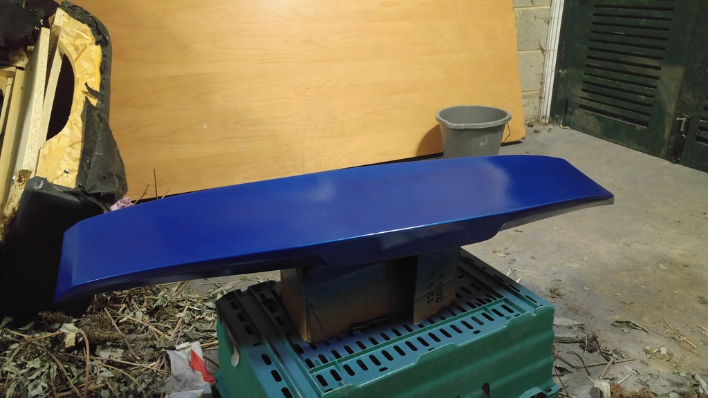

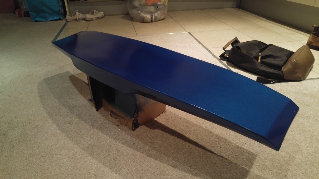

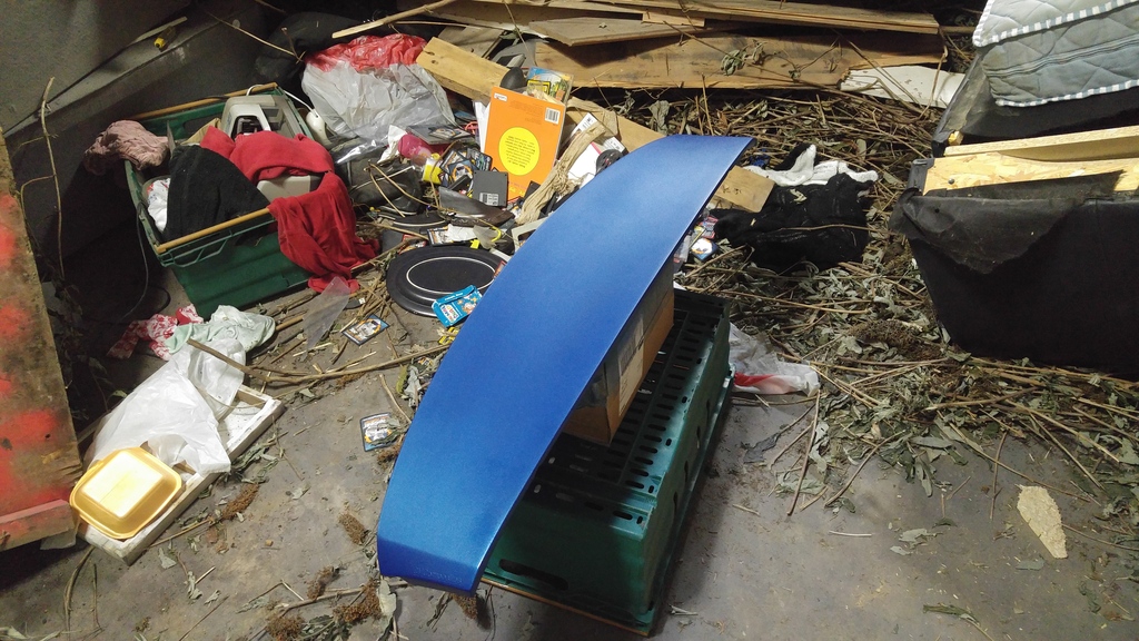

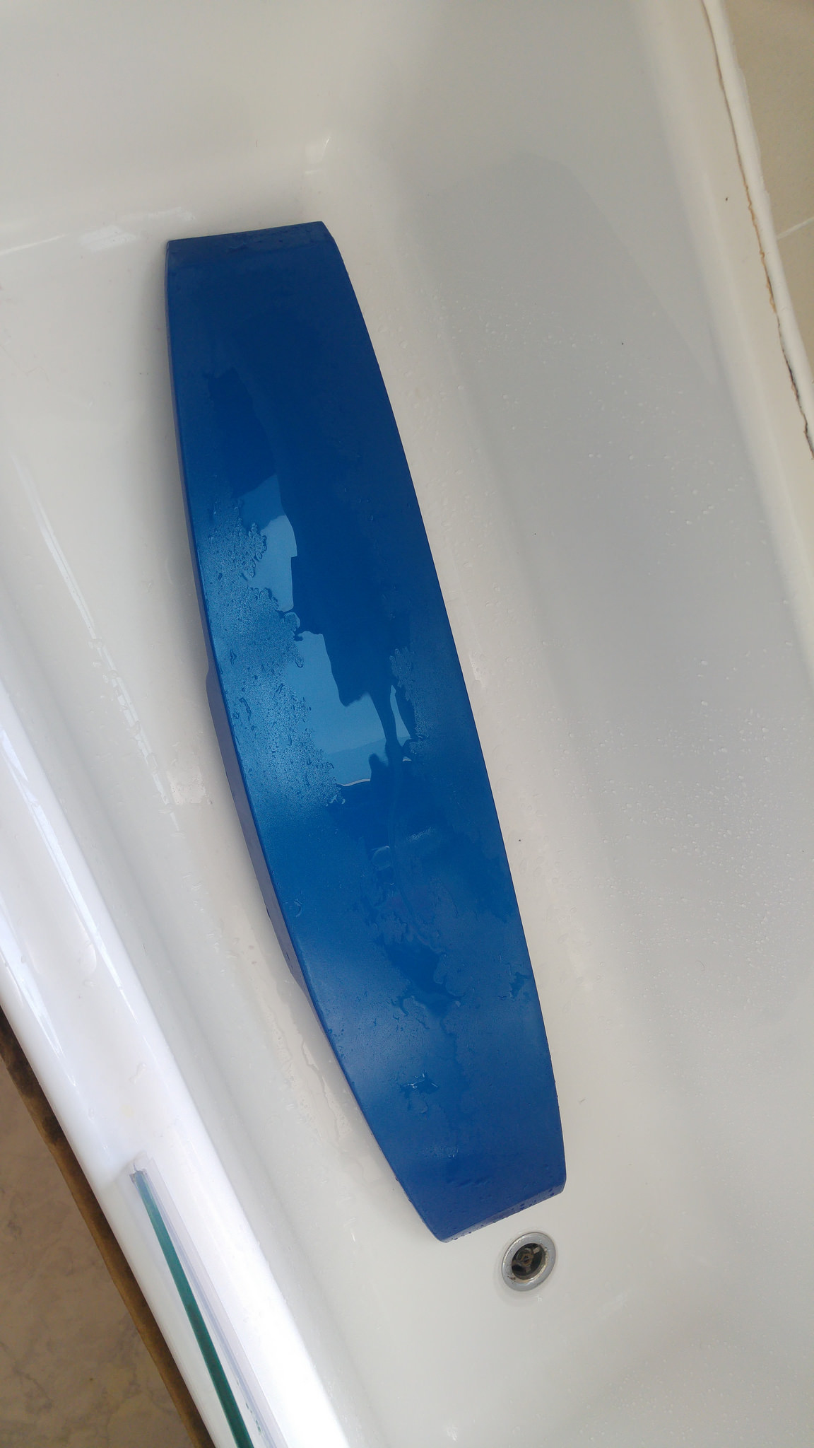

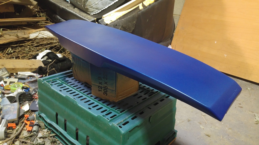

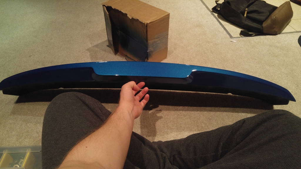

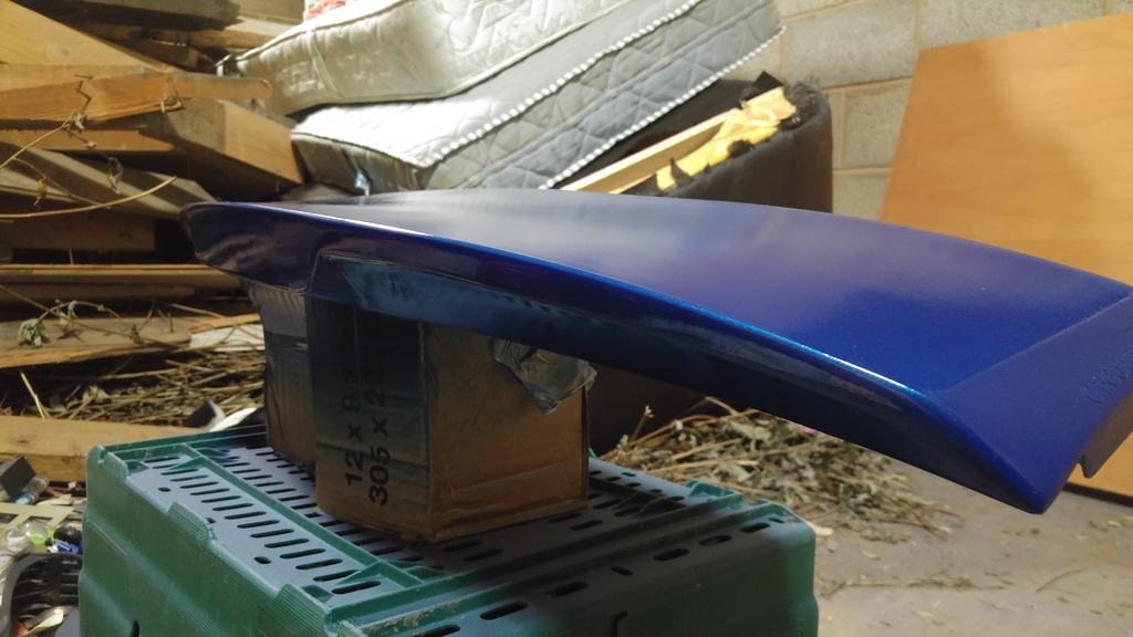

I got my new fibreglass spoiler so started spraying it
Just some mid spraying photos
Lacquer is on
And then some pics of it a day later just now. I will be flatting it and polishing it when it's fully hardened but I'm happy with the finish before that already.
I feel like I've got the hang of spraying stuff now which is cool. Yesterday was the first time I've used panel wipe and tack cloths and they've definitely made a difference to the overall finish.

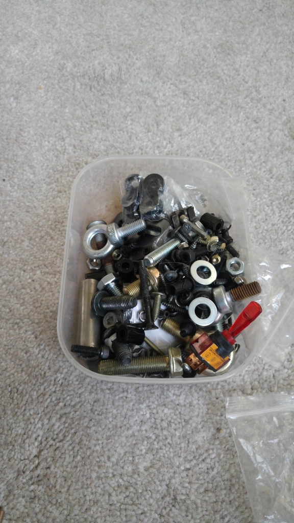

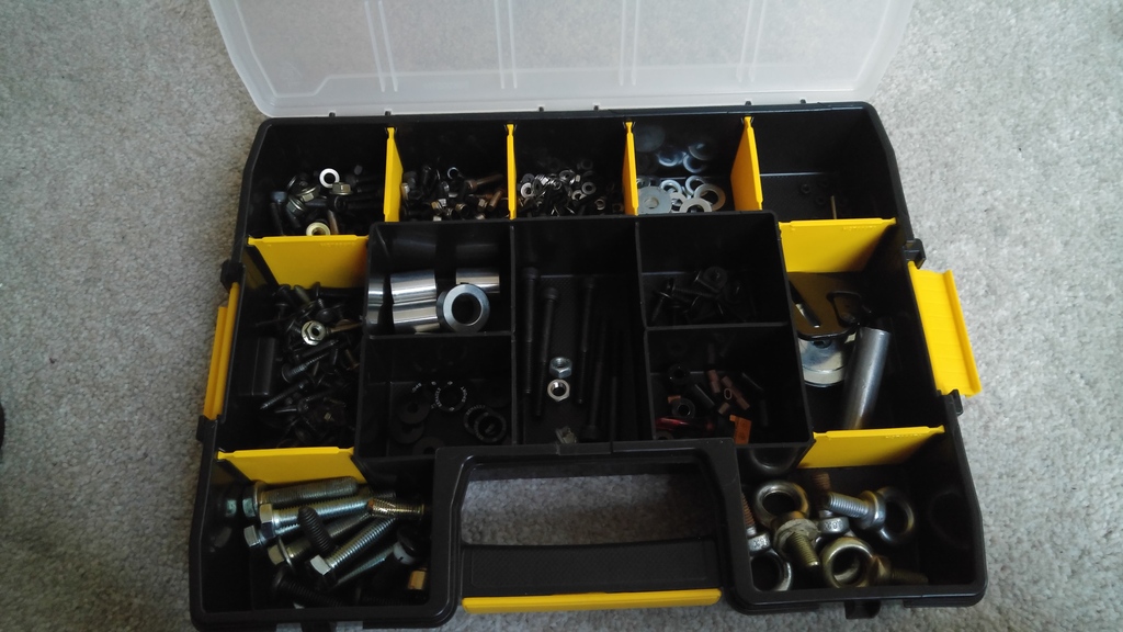

Another random thing but I did a little purchase to separate all my nuts and bolts. I used to have this
Then £7 later on amazon...
Stress and time saver for sure.

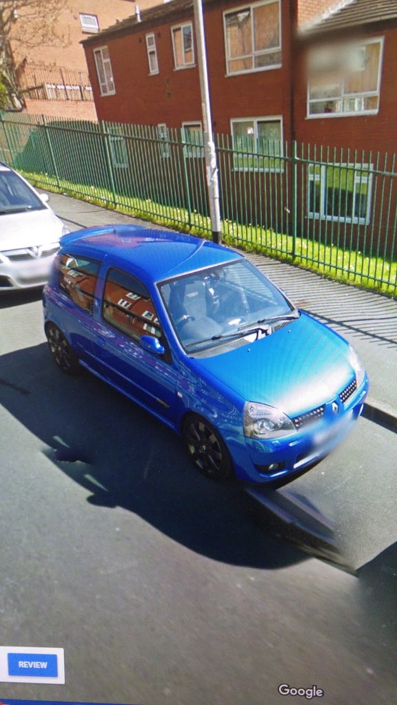

I went on Google maps the other day and I found Boris from ages ago! Crazy to think how shiny he used to be when I used to live at my parents (pic is when I'm parked at work)

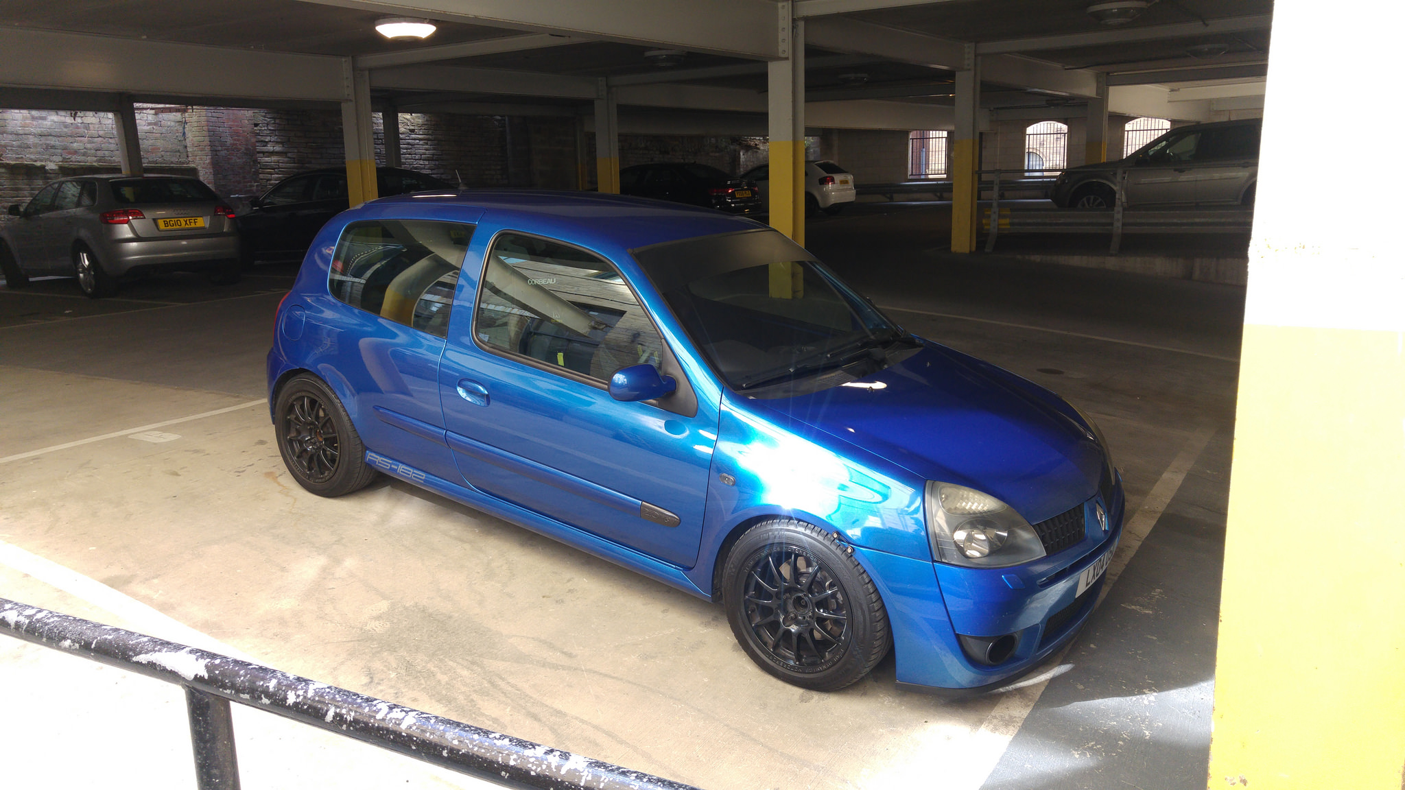

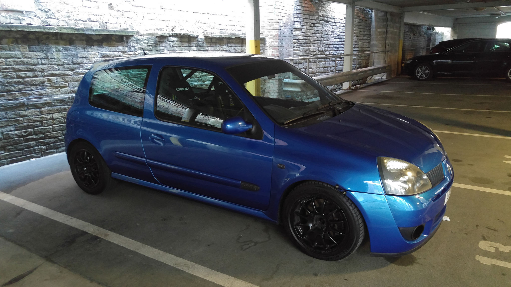

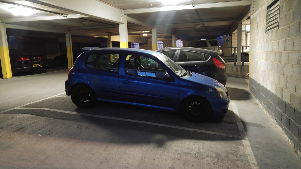

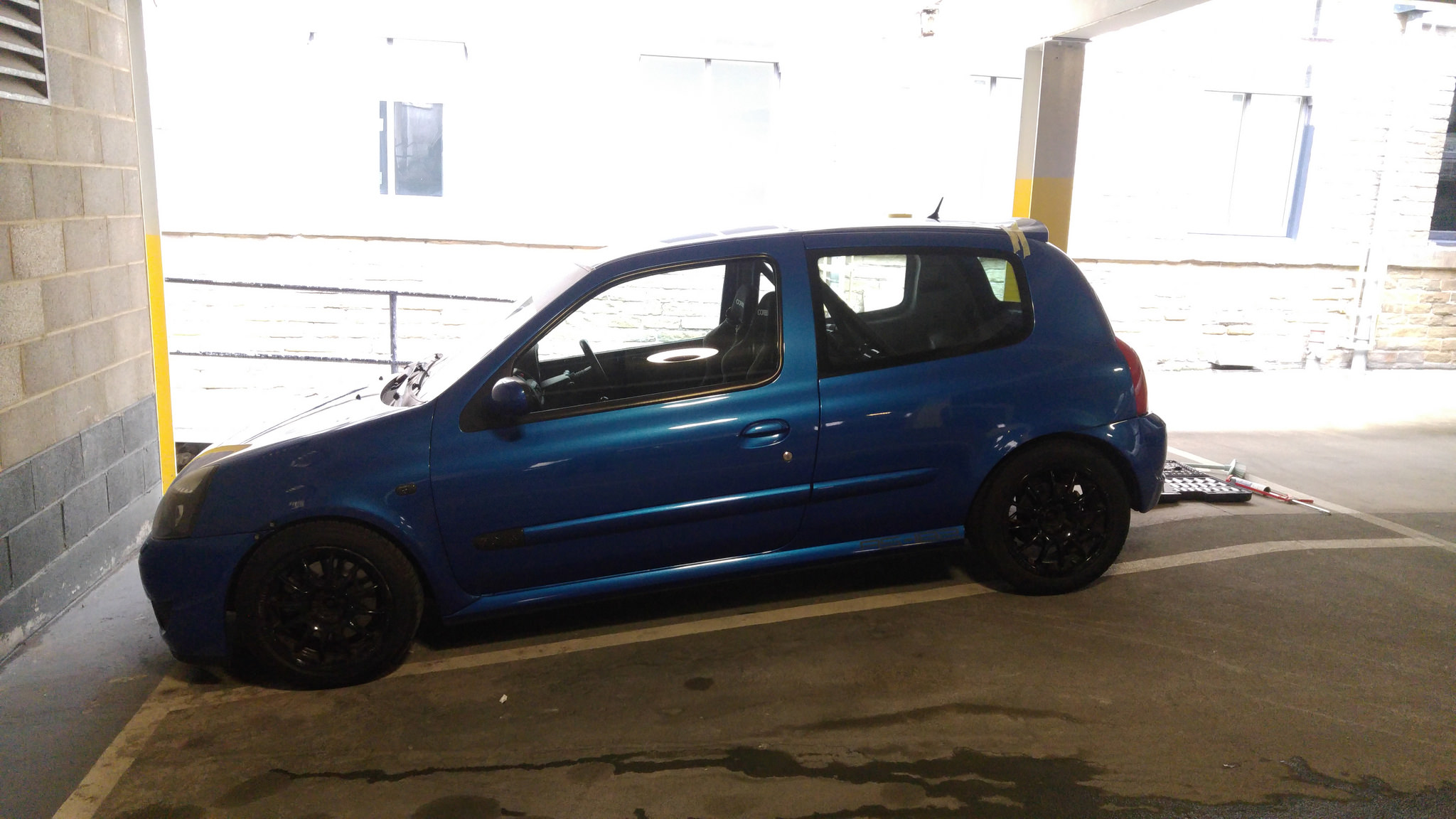

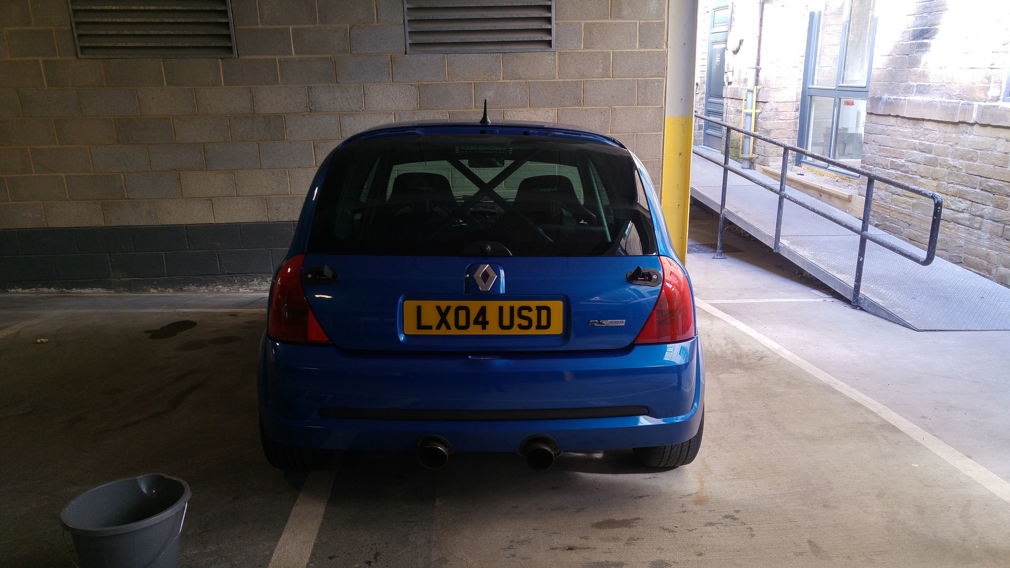

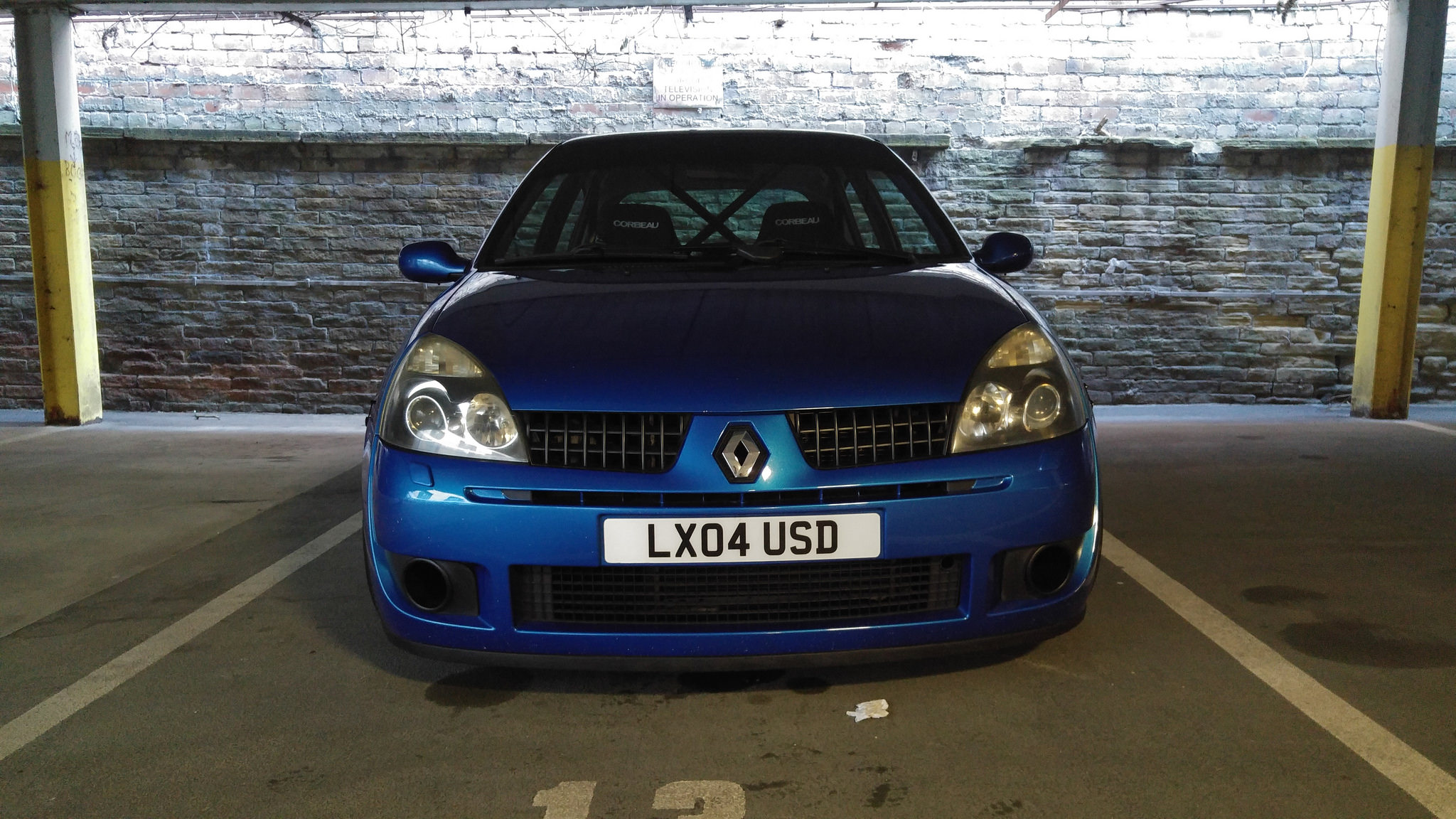

This is where I'm currently parked at my gfs. Nice to be in private parking. I haven't washed him for nearly three months now but I love the colour under the lighting here. Really makes me appreciate ab

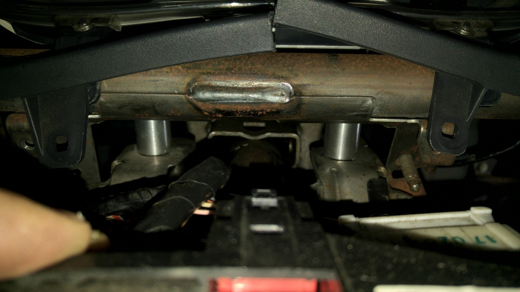

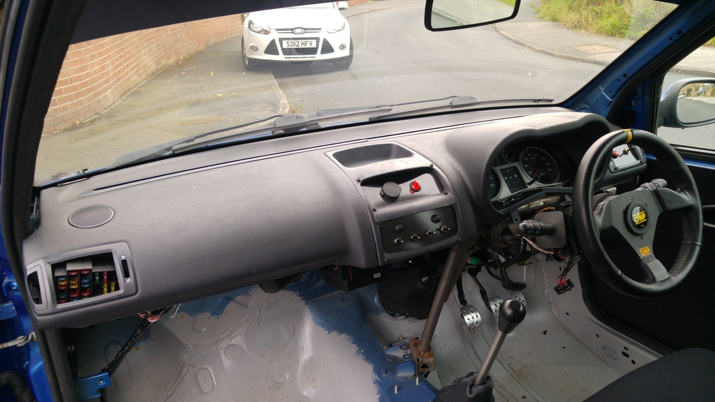

Whilst I was here I fitted some 30mm alu spacers to the steering column to lower the wheel. It's worked much better than the washers I had under there originally.
My main gripe now is that I'm so so soooooo uncomfortable driving. I'm not fully sure why but it might be because of this that I've noticed. The seat is at a stupid angle from the omp subframes
So I've bought some large penny washers to offset it for the time being as I don't have access to my Jack.

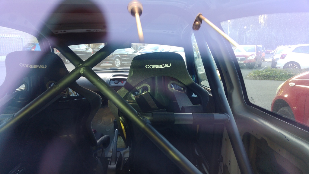

I had Johns extra low ones but I was too low without runners :(
I need to space out the subframe either with washers or a bar of metal. I don't have my jack with me until I move into the new place though so it won't be for a week.

Why not make your own seat frames?
I have homemade ones on mine and I have never had an issue. They are three peices of ~5mm thick steel in a square arranegement and the fourth bit is a part of the original seat runner. I have never had an issue with these on seating position being wonkey.
Only downside is there is no adjustment, the seats are fixed! I have never had an issue with height, and I think I am about the same height as you, 5'8"-5'9".

The OMP subframes still require you to use the black bungs from the standard seats on the exhaust tunnel side to keep things level.
Found that out when we fitted my mates ones ages ago. Washers or an aluminium spacer will do the same though.

Thats pretty cool mate, good job! It's not the height thats an issue for me now though. It's just trying to fine tune everything so im comfy!
Cheers mate. That's pretty lame though! I've ordered 20 OFF 1.5mm thick M8 washers so hopefully that should do it.

20mm spacer on the inside mounting points is all you need to level the seat subframe up. I have 20mm spacers (like the ones you used for the steering column) with my john foz subframes an they sit perfectly level

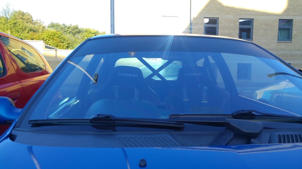

Just need some time to get the seats in, I've cleaned them and keep BioBrisking them to get rid of the smokey taxi smell but got a lot on at the moment so they've literally just been sat in the garage since I get them, other than test fitting.

    Yeah it's a bit of both actually! But mainly the paint situation was really annoying my ocd and I wasn't wanting to paint it again!

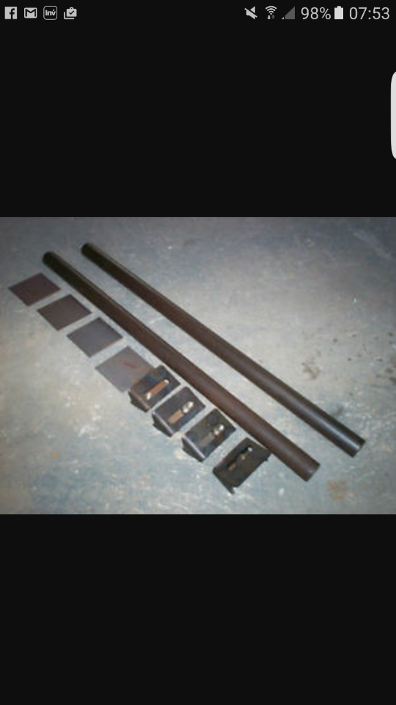

Also dan stop faffing around buying more standard subframes and get a pair of these welded in,

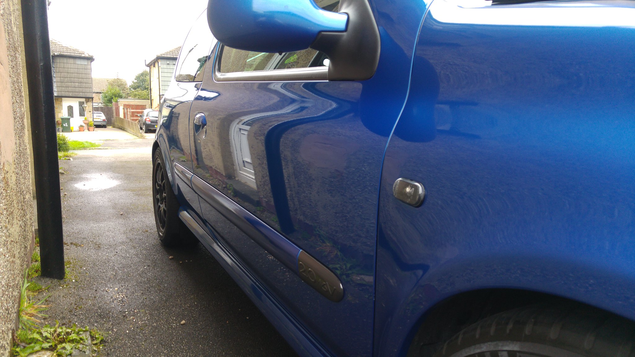

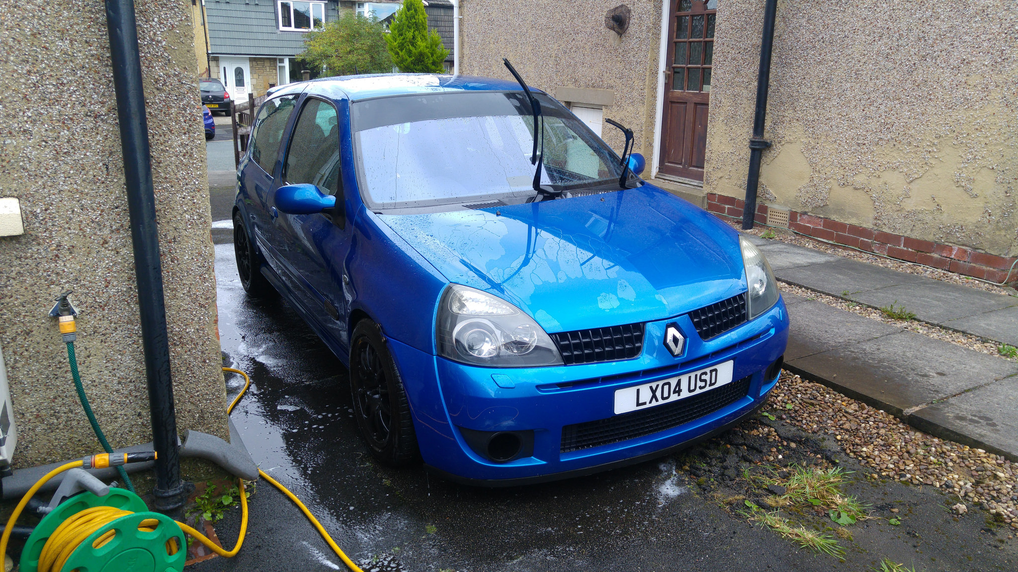

This weekend was mainly a Boris loving weekend. I have done loads of little odd jobs today and yesterday I detailed him using the G3 clay mitt. Can thoroughly recommend to everyone, I managed to clay the whole car in less than 40 mins which is so good as I used to spend around 30 mins a panel before on average. You can use this mitt 50 times over apparently too.
Some befores, its pretty hard to capture how dirty it was
20161008_130947 by dann2707, on Flickr
20161008_130954 by dann2707, on Flickr
20161008_131018 by dann2707, on Flickr
Then after a wash
20161008_132826 by dann2707, on Flickr
20161008_132836 by dann2707, on Flickr

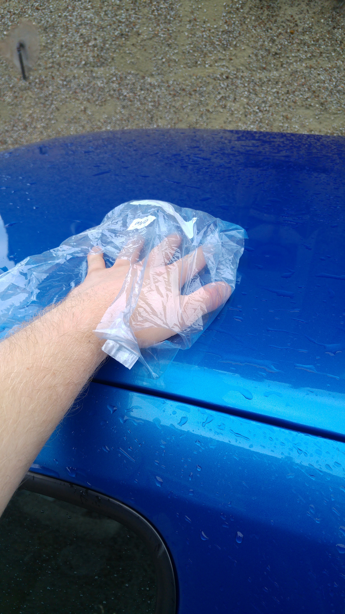

I then did the sandwich bag trick to see what the paintwork was like. Needless to say, it was f**king horrible
20161008_133353 by dann2707, on Flickr
20161008_143048 by dann2707, on Flickr
20161008_143054 by dann2707, on Flickr
Car was then polished, waxed and trim dressed. All with using the autofinesse bag I won at csf

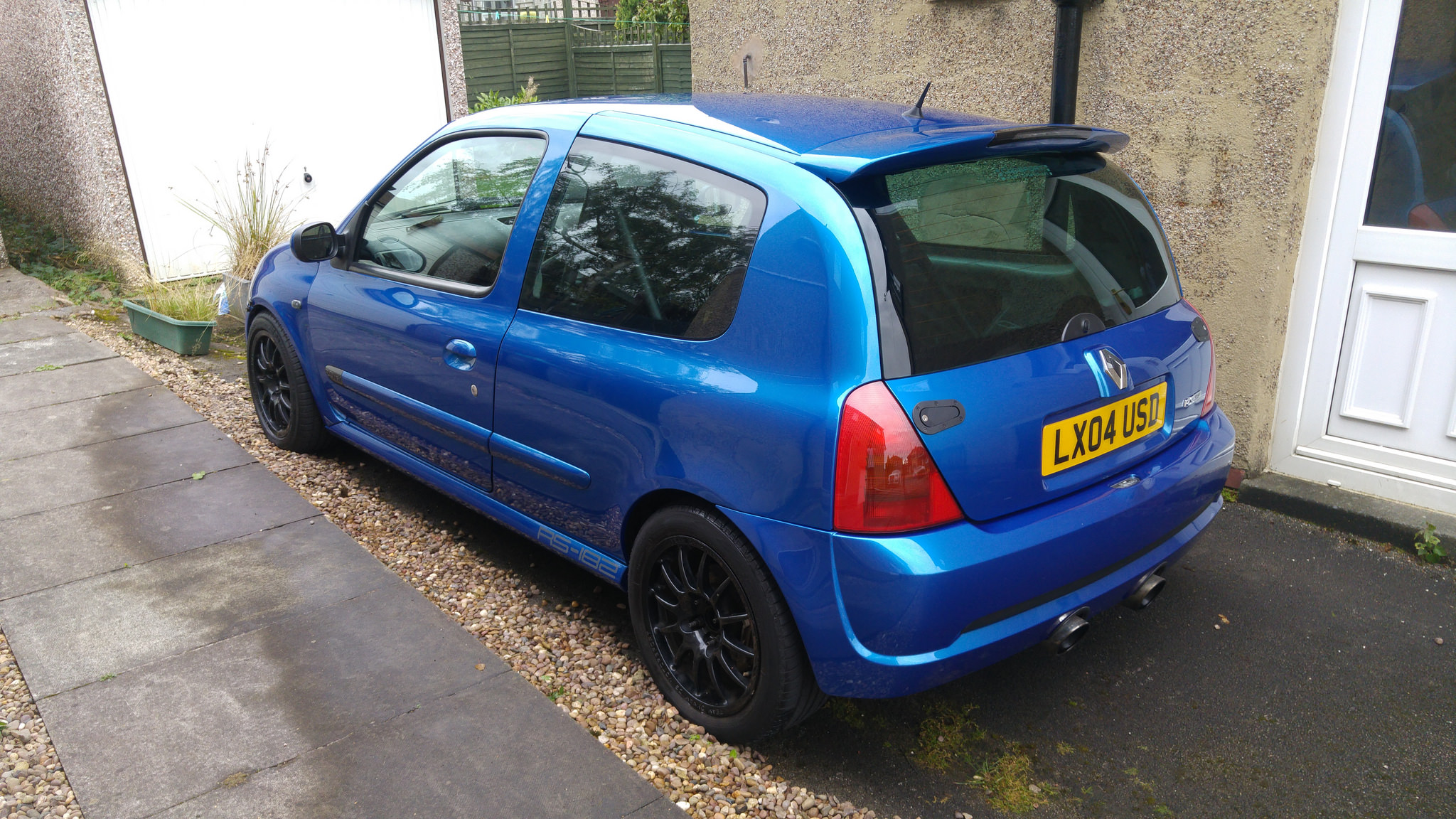

I then flatted back the new spoiler. I didn't do it enough and there is still quite a lot of orange peel but that can wait till its bonded

Quite hard to capture the shine so back to the gfs underground car park when I did some more stuff today.

Removed the old spoiler
20161009_130832_HDR by dann2707, on Flickr
And the new one is on. That setting overnight tonight
20161009_133143_HDR by dann2707, on Flickr
Had quite a funny moment too, I couldn't open the boot as the spoiler was taped to the sides and I left a few tools I needed at the back so out with abis sweeping brush to collect my goods haha

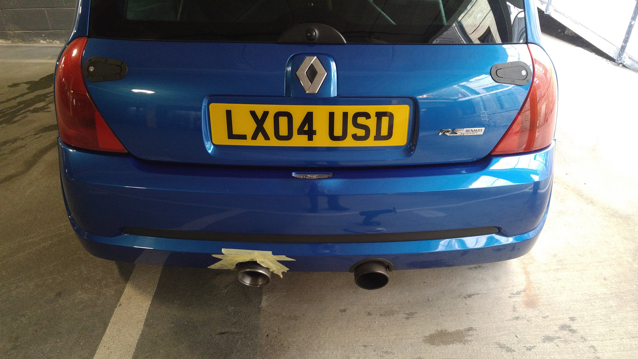

I then, with the help of @optical and his technique, went about cleaning up my exhaust. Admittedly i've never actually done this before - ever! I got a wire attachment for the drill, a polishing attachment, some autosol and a wheel brush
A before, absolutely disgusting!
20161009_142824 by dann2707, on Flickr
Before and after
20161009_143944 by dann2707, on Flickr

I can't believe the exhaust tips have made such a difference. It looks so much more fresh

- Raised the drivers seat at one side with some washers. Still not enough but I need longer bolts before I raise it more.
