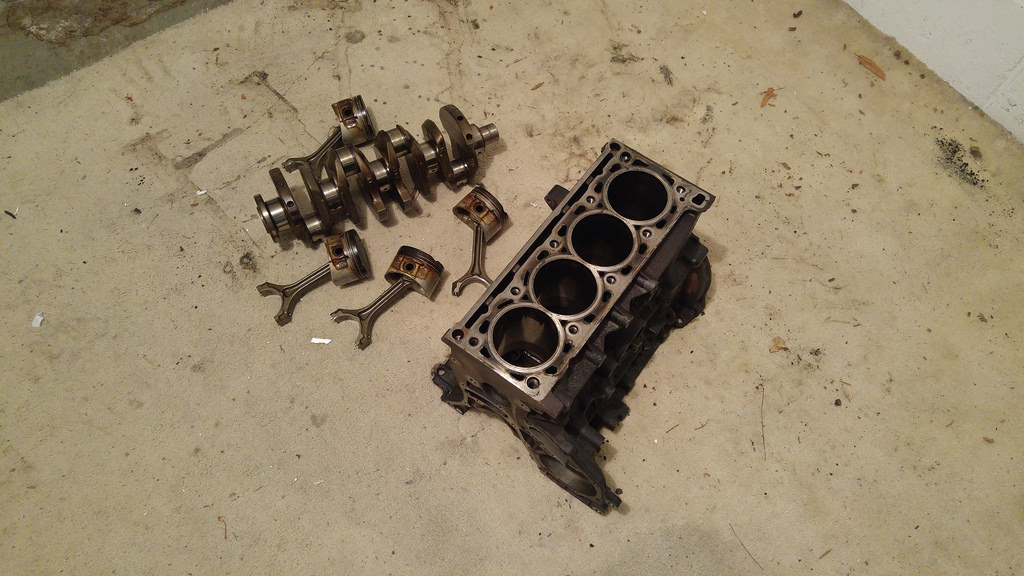

Alsooooooo, I bought a spare f4r engine the other night which I'm going to be making a table out of! Just need to degrease and paint it. Should look great.

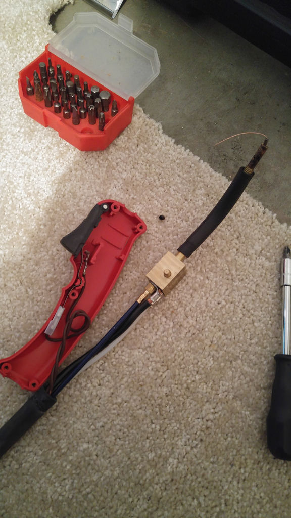

Took apart the welder to change the swan neck as the original was fucked and welded to itself so changed that along with the tips. Should be firing it up soon, just need to get some scrap metal to practise on.

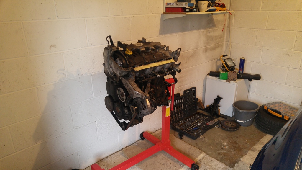

I bought an old F4R from someone from CSOC! The reason being I am making an engine table for the living room (Girlfriend is tolerant haha)! :D Me and Tom managed to get the engine in my boot when I collected it but I couldn't lift it out by myself so I dismantled it in my boot then got it out hahaha
20161019_210521 by dann2707, on Flickr
20161022_183049 by dann2707, on Flickr
That should be done in a few weeks I reckon. Got the engine degreaser today. It's £5.99 for 5L at Screwfix. Along with some silver primer paint which im going to spray it in and see how it looks.

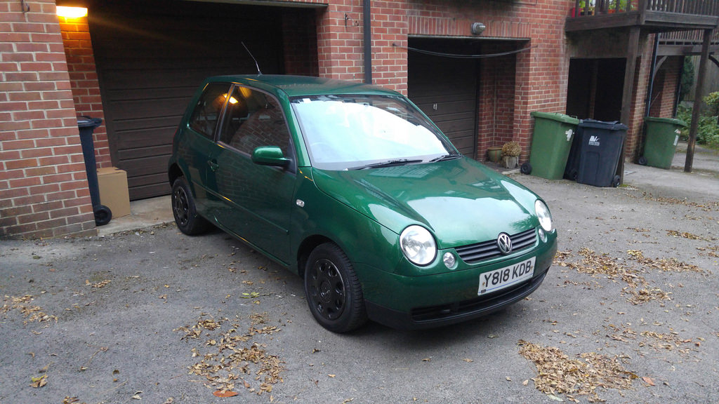

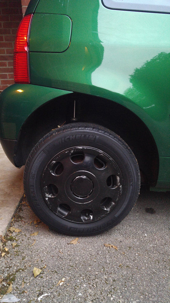

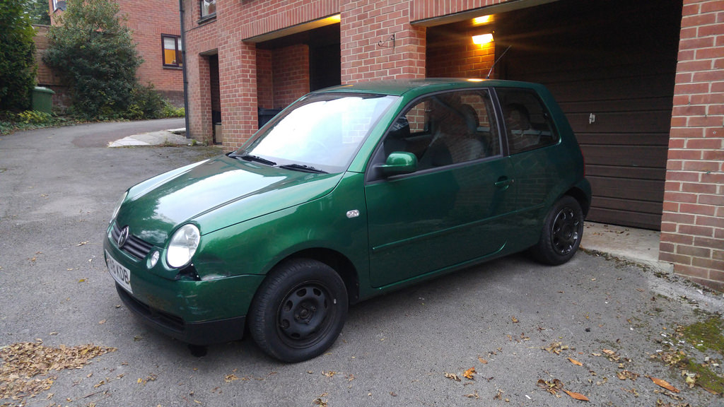

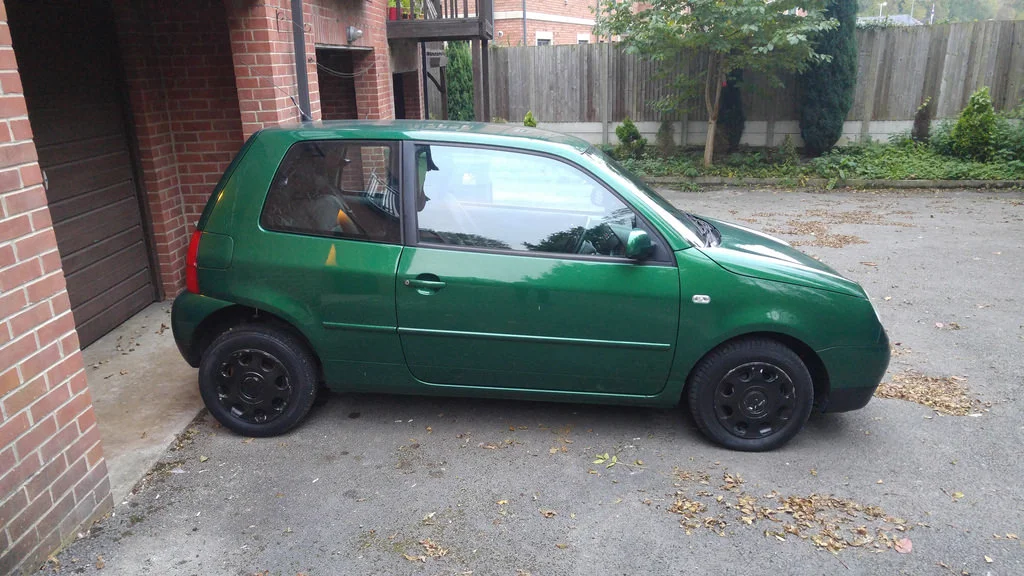

I'm picking up my daily tomorrow which is a green 1.67 sdi lupo. 65mpg all day long, slow as s**t. But i'll be comfy and its £30 tax for the year which will make the commute to work lovely.

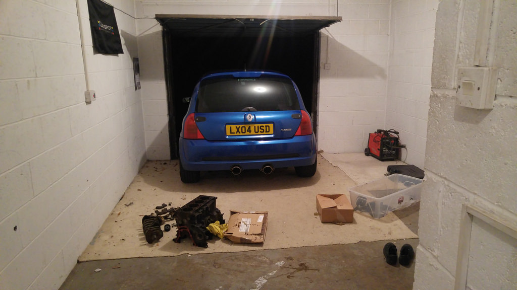

Well this is it, Boris is finally off the road!
He's tucked up all sad in the garage and will soon have his heart removed :D
I picked up the daily yesterday. It's so slow its hilarious. it's a 1.7sdi so its diesel with no turbo. £30 tax a year and 65mpg all day long which is amazing for my commute to work.
Seat belts are a novelty!
It's got a few issues but nothing that I can't fix easily. One being the massive f**king huge gauge out of the wing

that arch gap. In all honesty, as long as it gets me from a-b with no issues im happy

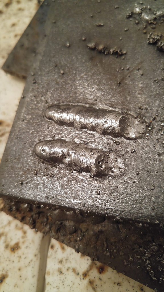

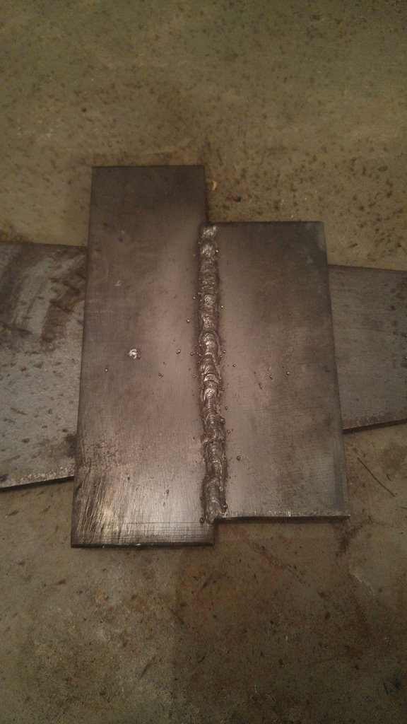

Got my welder fired up tonight. To be honest i'm really surprised at the quality of the weld with no shielding gas!

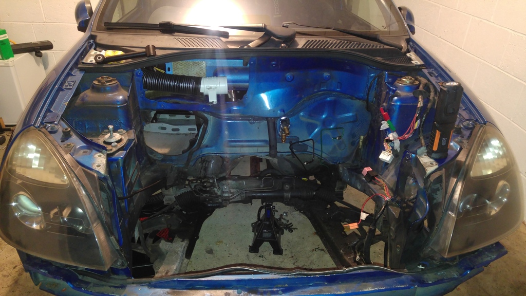

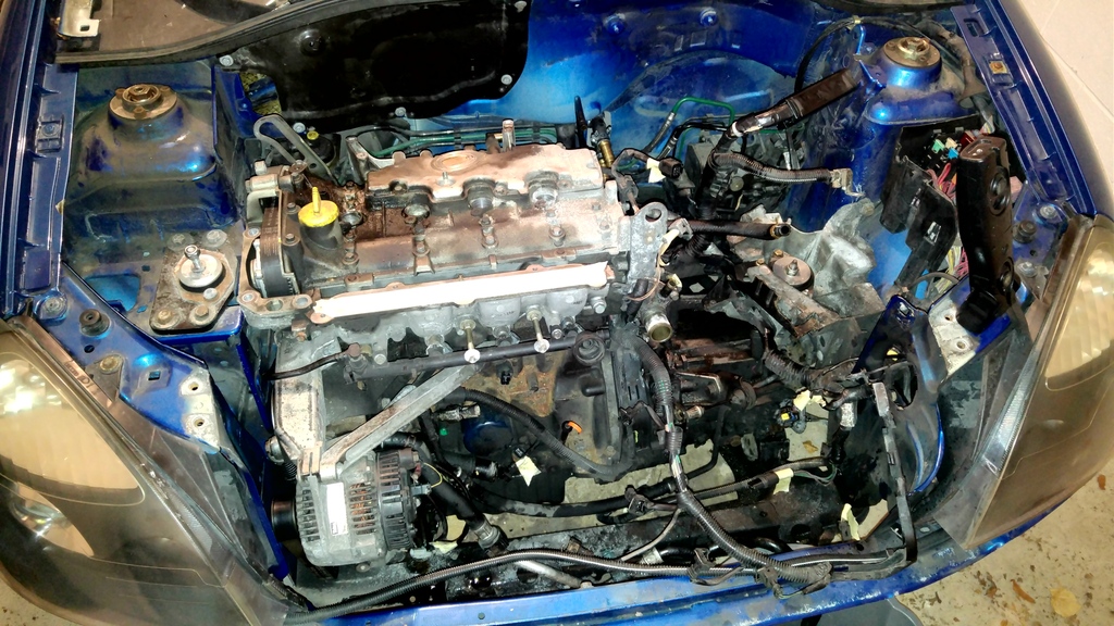

Haven't done much lately as i'm still settling in - I have however removed the bonnet on Boris so I can access everything. Next step is to remove the loom and label everything accordingly.
Will remove the bumper too to gain access to everything. Got some 200W bulbs on the way thanks to @optical giving me the idea. Also will be spending lots on insulation so that its warm in the garage as screw working in the cold!
Had some more fun with the welding. I'm getting the hang of it a bit more

Engine is nearly ready to be removed. Only took me an hour and half to get to that state and that was me leisurely wafting away!
hour and a half to get the inlet off, f**king hell!

Only just seen this, that Lupo is bad boy, looks like it's on stilts.

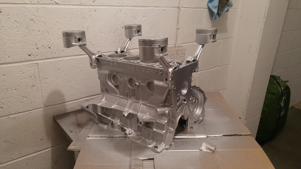

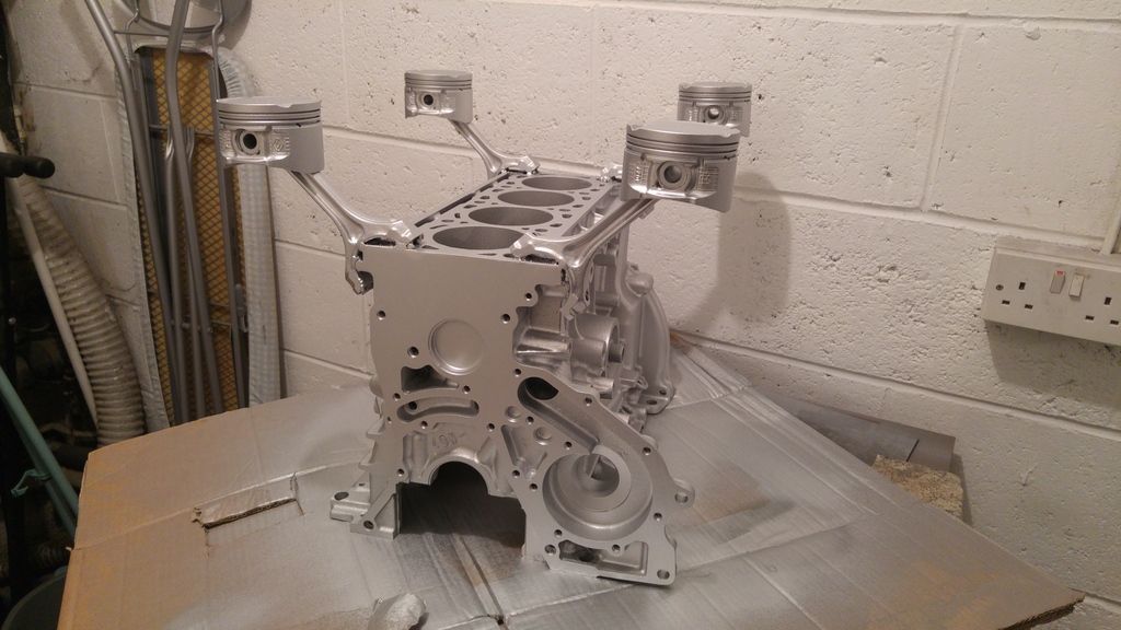

The engine table is pretty much ready! Just got a quote for some glass ready to be made from a company just near me so i don't have to pay the ridiculous postage fee... The last place I checked it was £80 for delivery!
Really happy with the outcome however welding the alloy conrod to the cast iron block, for a newbie, with limited knowledge and equipment deemed interesting! It's on there pretty solid though.
I just had to heat the block up with a hot air gun prior to welding to stop it cooling down instantly and cracking

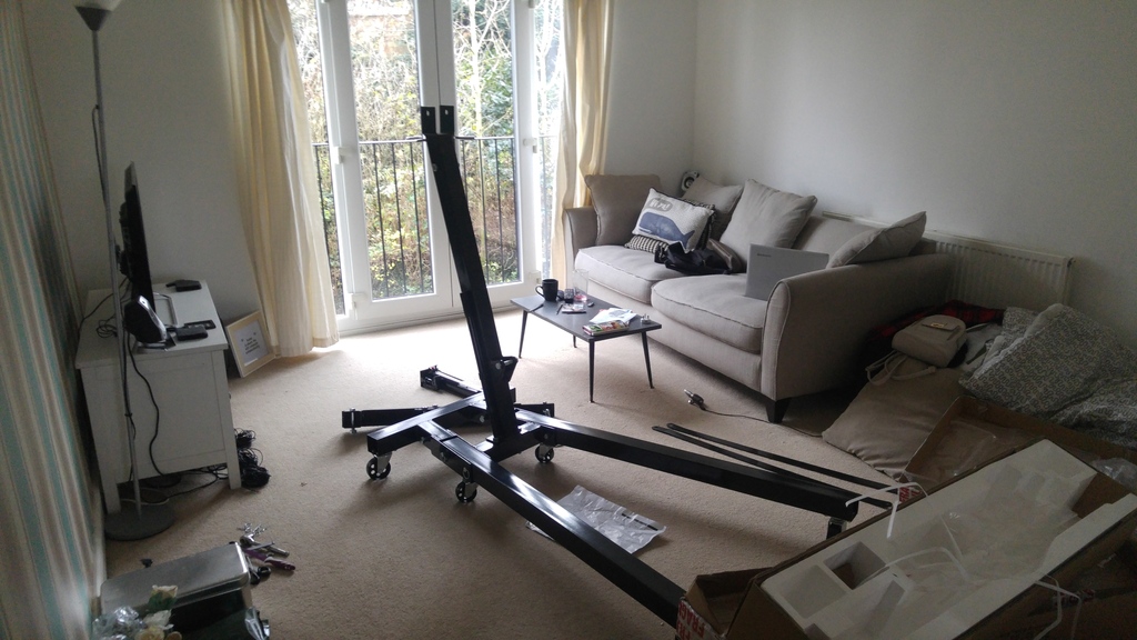

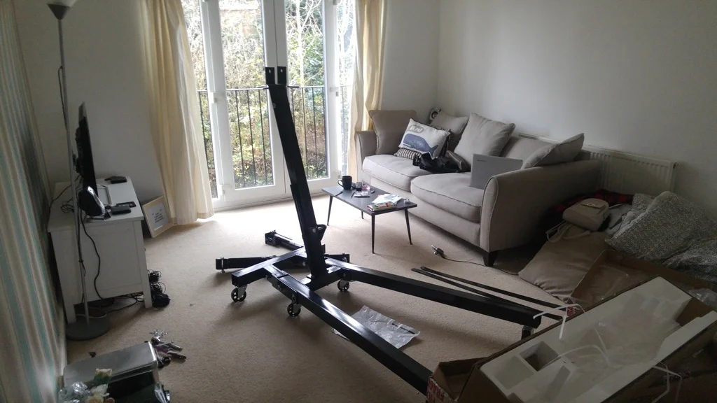

I also received my engine crane for taking the engine out of Boris, got an engine stand on the way too
Had to test build it last night haha
Was very interesting trying to decipher the chinglish instructions!

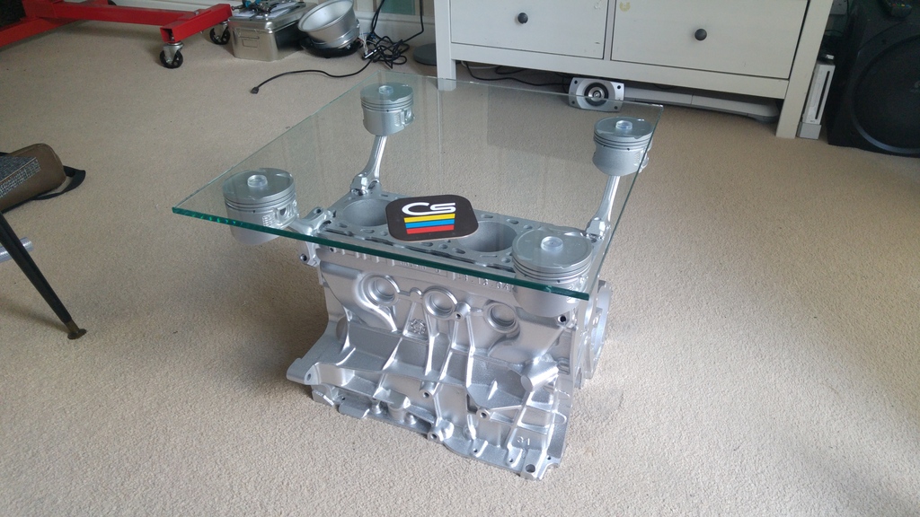

First of all, the engine table is done. I'm really chuffed with it.

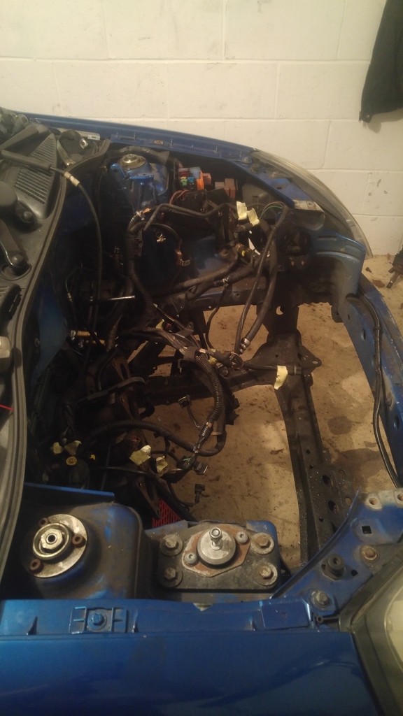

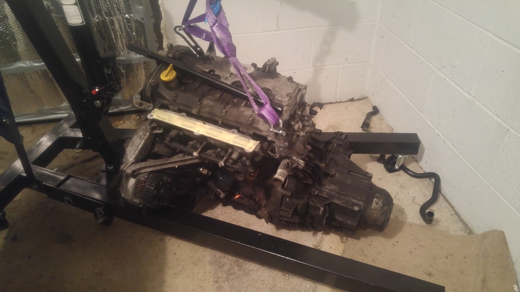

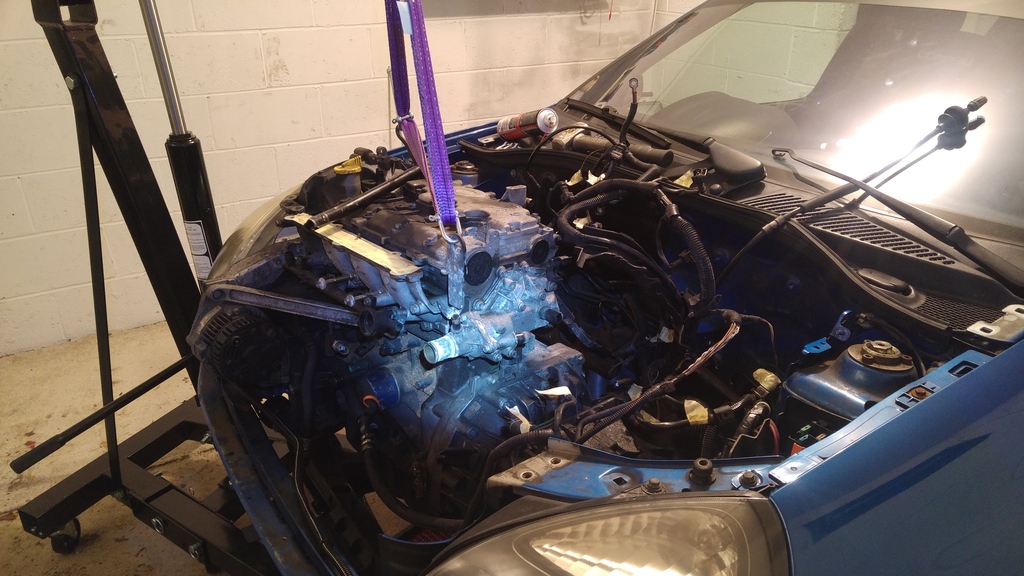

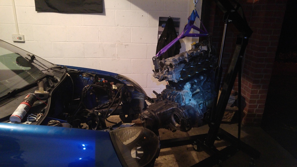

I got the engine out! All went really smoothly. Took me about 2-3 hours with food breaks and taking it easy which isn't bad for my first go!
That was just me by myself too, tomorrow I'm going to remove the loom and make a start with the abs removal and all the pedals as I'm going to be running a pedal box with no servo or abs.
Will give it a clean up too as it looks f**king minging!

Serious garage envy
When you tucked the wiring away, passenger side, what did you do with the washer pipe? I was just gonna pull it through to the 'bay/scuttle and bung it up
dann2707
Serious garage envy
Washers for the headlights? If so I just snipped it off and cable tied it back on itself so it couldn't leak. If that's what you mean?
Thanks about the garage, I'm really lucky to have the room if I'm honest. @leeds2592 and @Louis' will tell you what my old place was like in Huddersfield - full of bad manz and druggies. Now Id happily leave my garage open all night and feel so safe to do so!

what size is the garage? (width)
Thank you very much. I'm not sure off the top of my head but I will find out. How come?
Meant in the rear, guess it's the same principle really. Need to drag the car out and do the wiring on the pass side, drivers side is loads better with it tucked away.
Table looks great too, wish the wife would allow something similar .
Be good if you could get some lighting into the cylinders... even some little battery operated led packs would work tbh.
