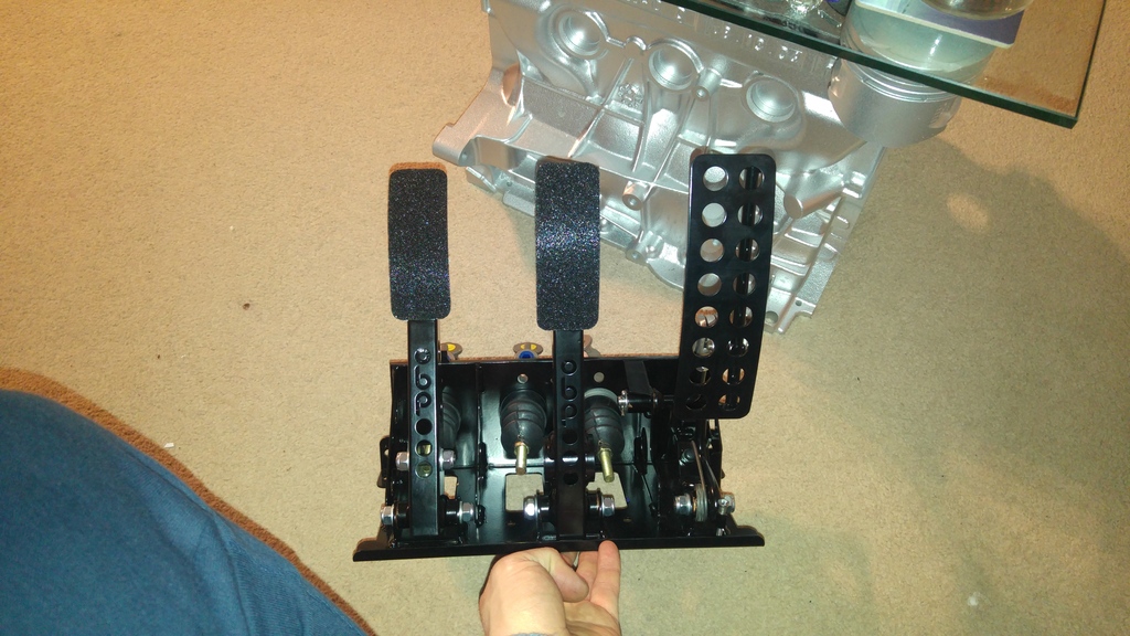

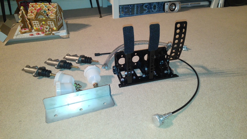

I bought a pedal box just before Christmas as a present to myself.
It comes with the master cylinders, reservoirs etc.

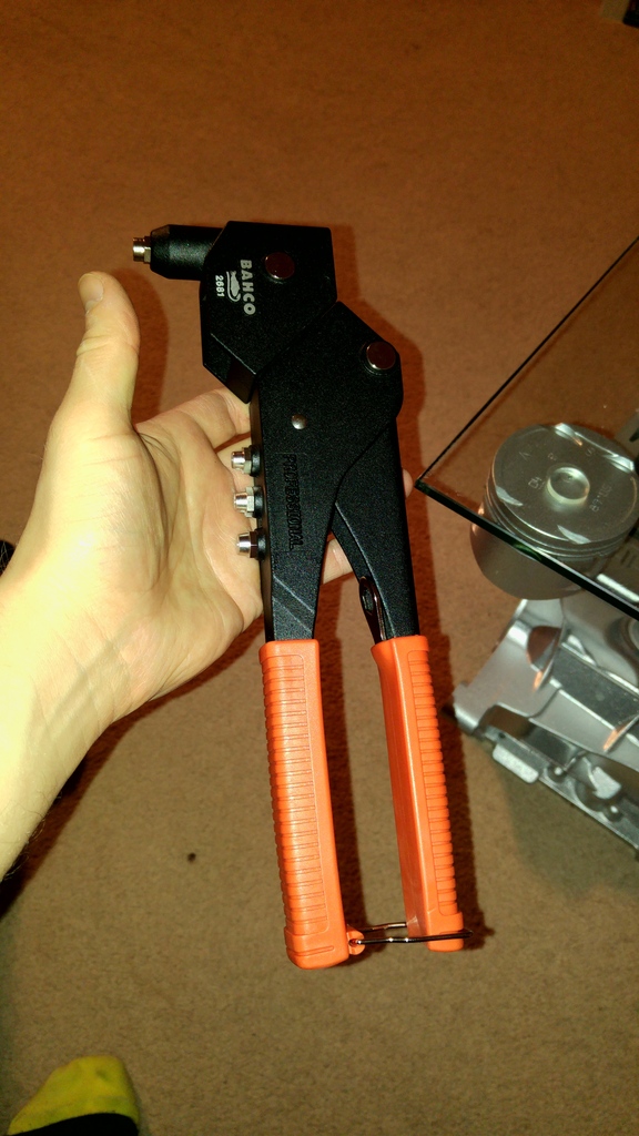

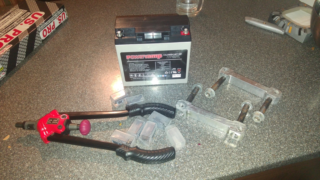

Also treated myself to a decent rivet gun and I've got a riv nut gun on the way too.
Above will be great for the p clips to hold the brake lines to the car.

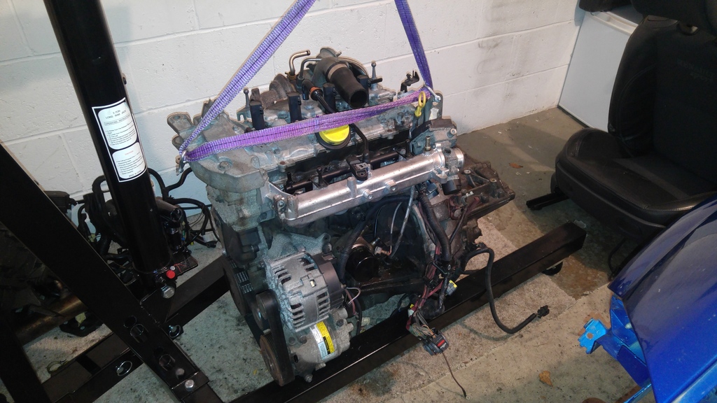

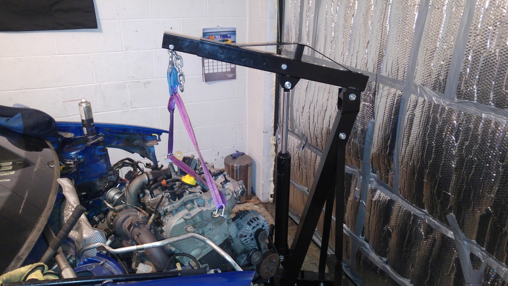

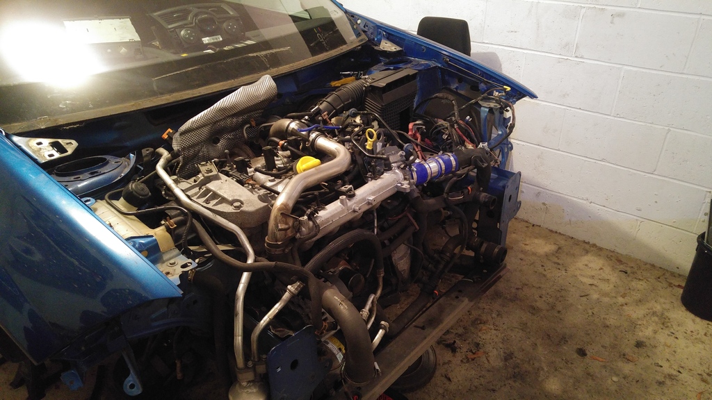

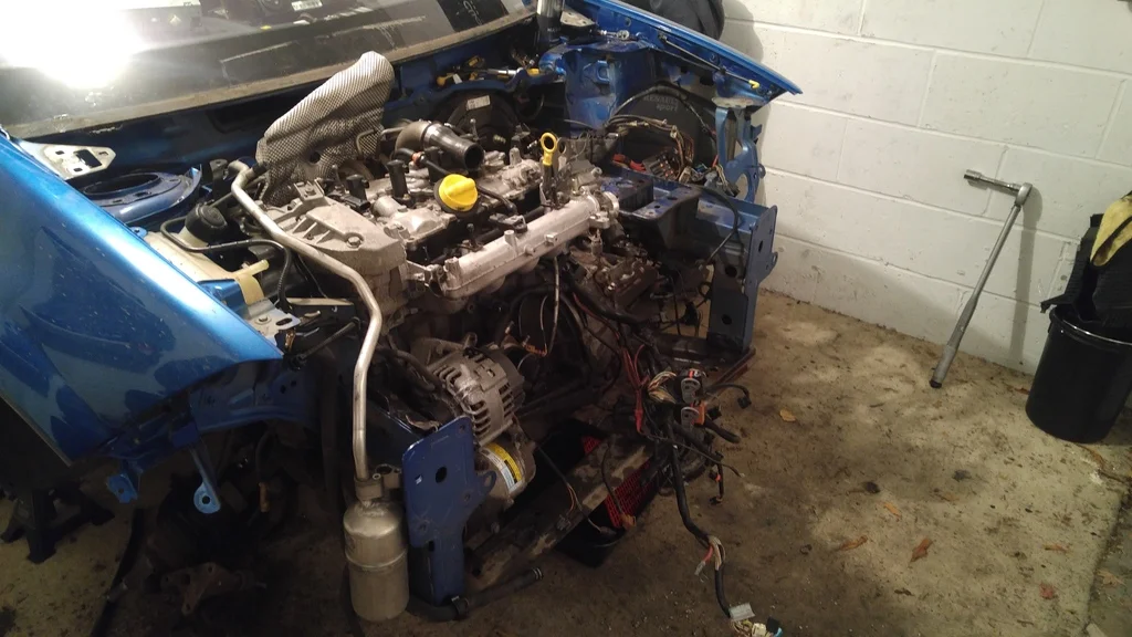

Had an hour to spend on the car tonight so got it from this
To this
I just need to disconnect the driveshafts and exhaust, mounts and it should come out.

Talk to me about the pedal box :laughing:
Is that one of the Clio direct fit ones? If so what's the quality like?
It's a universal one from demon Tweeks mate. Going to have to make it fit with some washers/standoffs. Should be too hard and a fun thing to fit and learn how to connect up.
