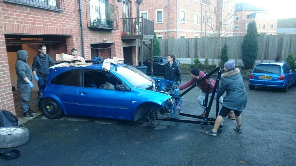

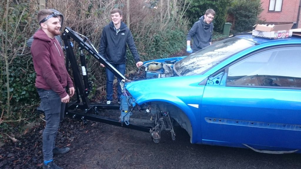

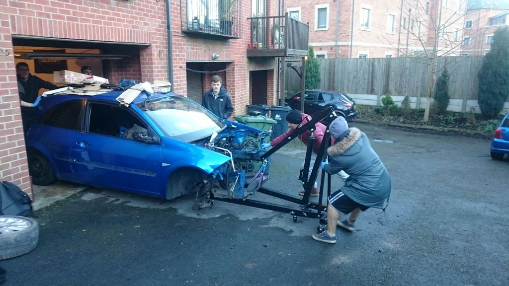

Managed to get the Megane out of the garage despite it not having front wheels. Used the engine crane. Loads of random pics

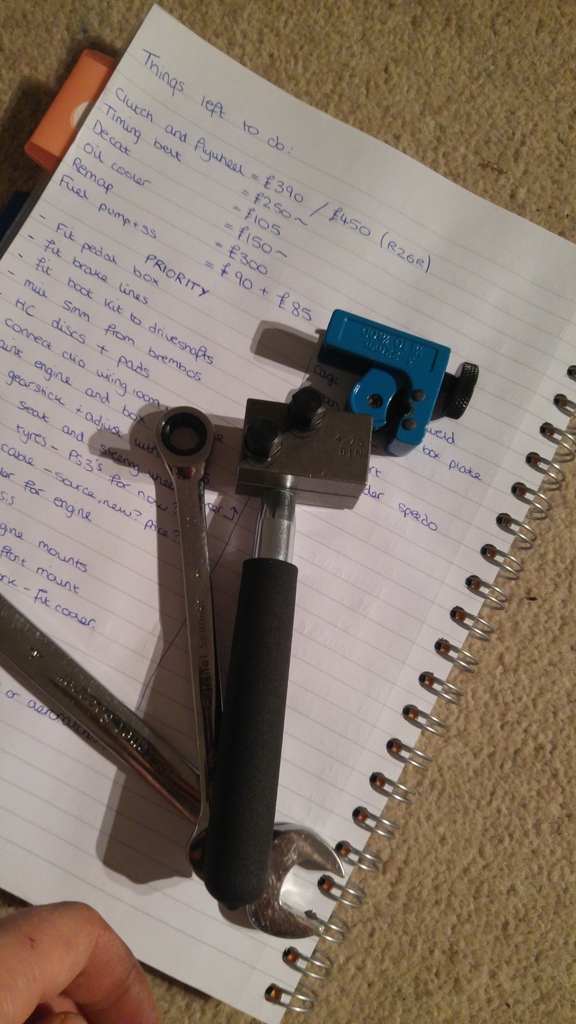

Ive made a list of things I need to do to get the car completed. It's quite a long list of smaller jobs, some having more priority than others.
Missed off a few things too as I realised last night.

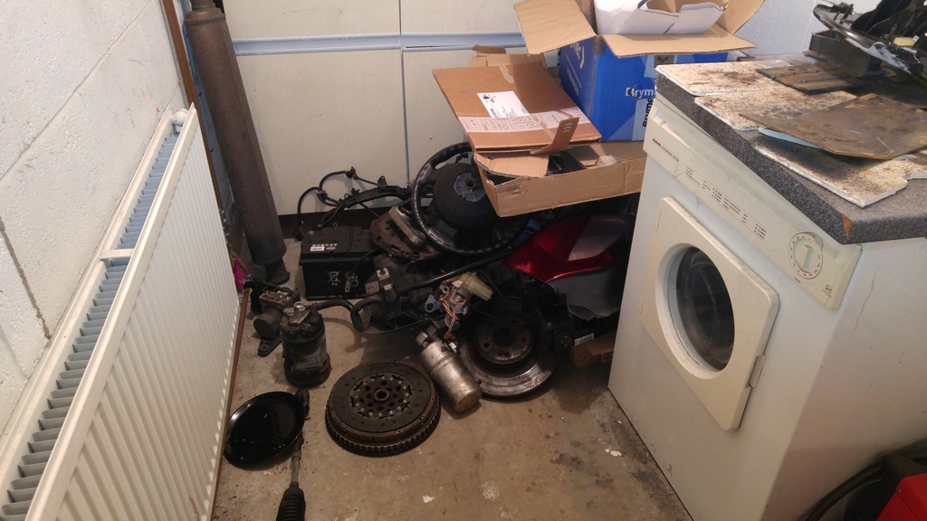

Got a collection of Megane parts at the back of the garage which I need to list and sell.

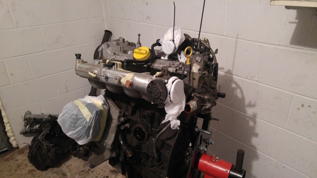

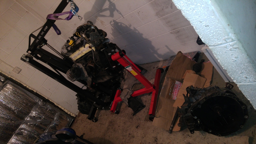

The engine is on the stand and I've dismantled it to get the cambelt cover off
Ac compressor is off now and I'm waiting on a stretch belt to arrive so I can fit the 182 pulley with it.

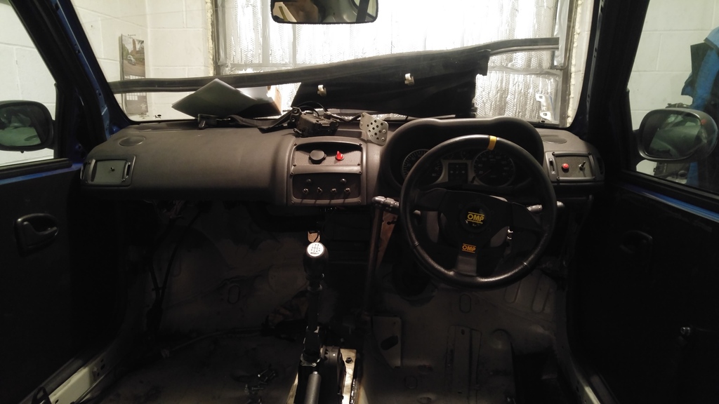

Forgot what the inside of the car looked like for ages

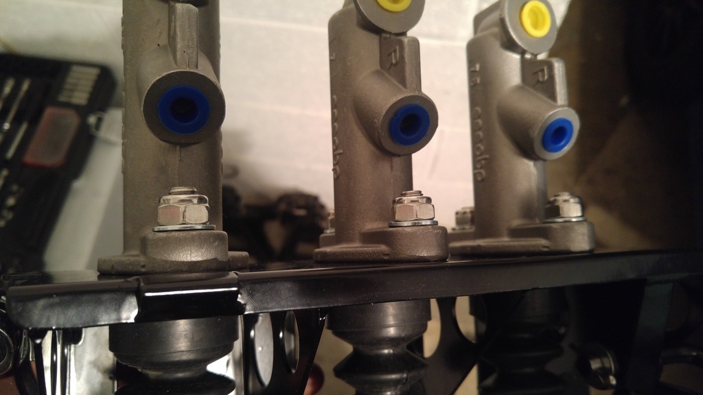

Fitted the master cylinders to the pedal box with new bolts and washers. Something so so satisfying about having new ss fasteners.

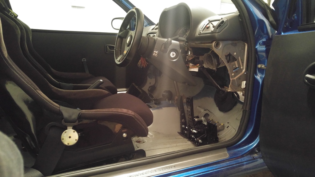

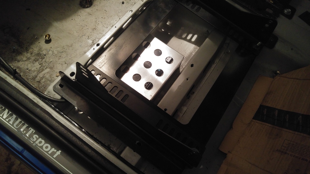

And my next issue is... Pedal box position.
Even with the seat the furthest it will go on the side mounts and subframes its not a comfortable position at all. I need to think about how I'm to solve this as the pedal box wants to be up and back where the original pedal box used to be ideally...

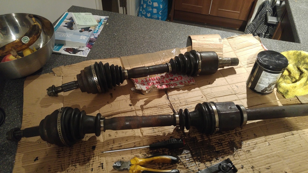

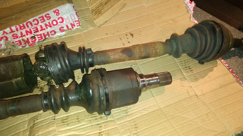

Got the fabbed driveshafts for the box conversion and tonight after Harry Potter I removed the cable ties holding them on, regreased them and fitted new boot clips.
Before
After
Going to black Hammerite them when I get chance.
Nice to have crossed something off the list!

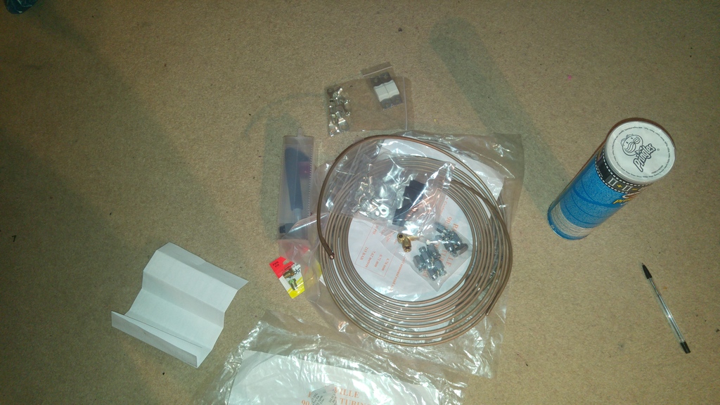

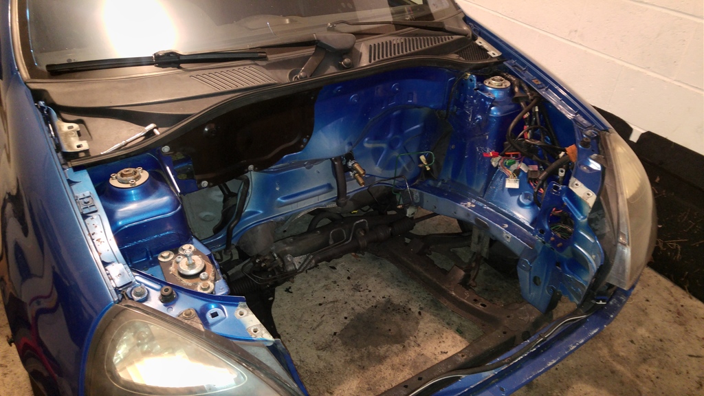

Next step will be getting rid of the shell and doing all the brake lines as I received most of the parts for it on Friday. 11 parcels arrived on one day Hahaha.
Brakeline, unions, t pieces etc and a massive thanks to @Matt555 for helping me with the very confusing brake line bits (din flares, imperial measurements are not something I've dealt with before) so cheers mate
Waiting on a brake line cutter and pipe bender, p clips and a bulkhead adapter for the rears as I want to do it neat and as properly as possible.

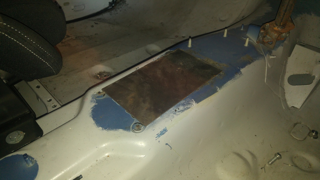

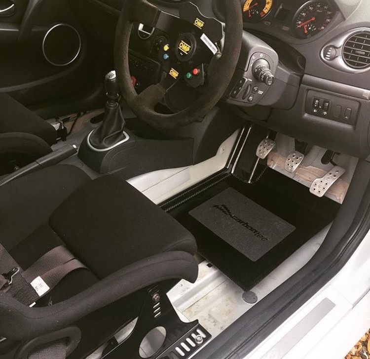

Fit a false floor plate to mount the Pedal box on, you need it a little more level with your Hips,
That Banana needs chucking out too.
This sounds expensive!
Yeah it's been at the bottom of my bag for ages, I'm taking the good one today! Haha
haimsey
  ph2 172
False floor for the pedal box could just be a bent piece of sheet welded in place. Or go fancy and make some bosses, weld them in place and have a mounting plate with a series of holes in for moving both plate and/or pedal box in any direction

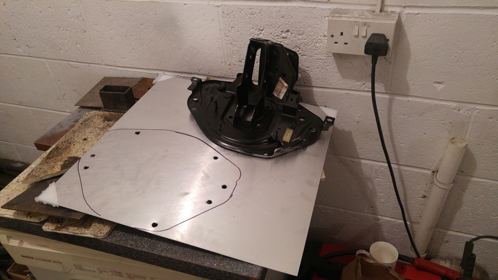

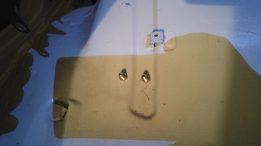

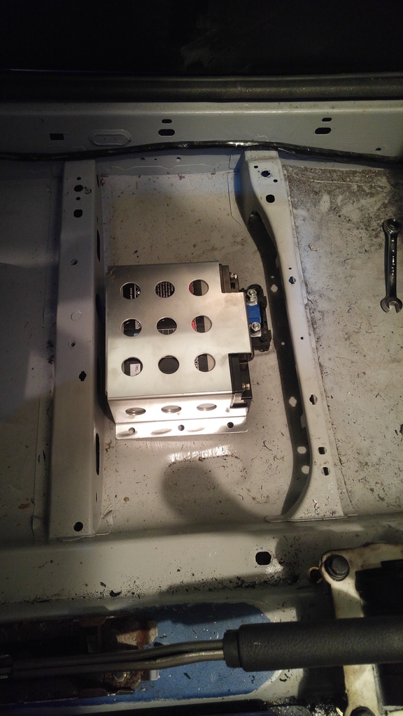

Aluminium sheet arrived so stenciled around it with the original brake servo box. Drill holes and now I'm waiting on some tin snips from Amazon.

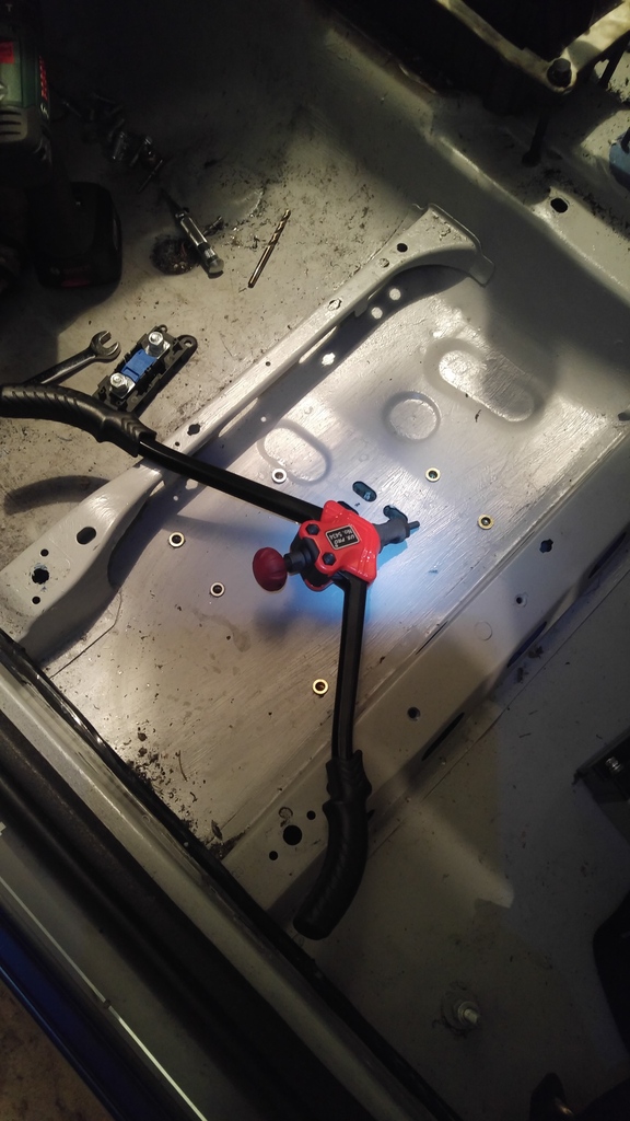

The bolts in my car that are black are suffering with surface rust so my aim is to replace them all with stainless.
Got to use my new sexy riv nut gun too.
Before
During
After

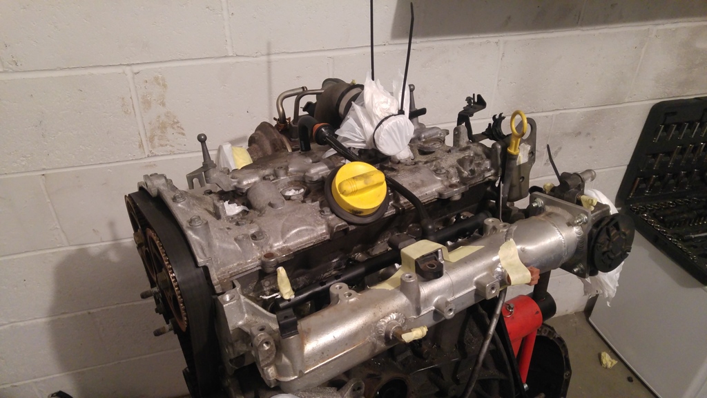

As I'll be spraying the engine I want to degrease it first. So I've wrapped everything up where water can possibly get in.
I'll degrease then remove parts and mask up and spray. Going for a nice zinc etch primer colour. Much like my engine table.

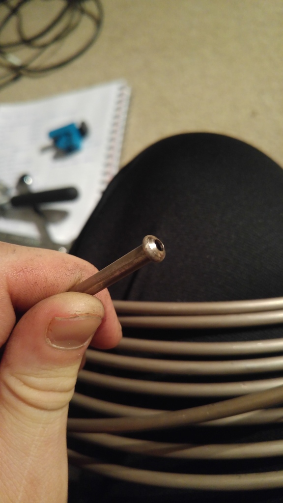

Got to use this lovely b*****d the other night.
Coupled with a brake cutter it gave me a nice finish.

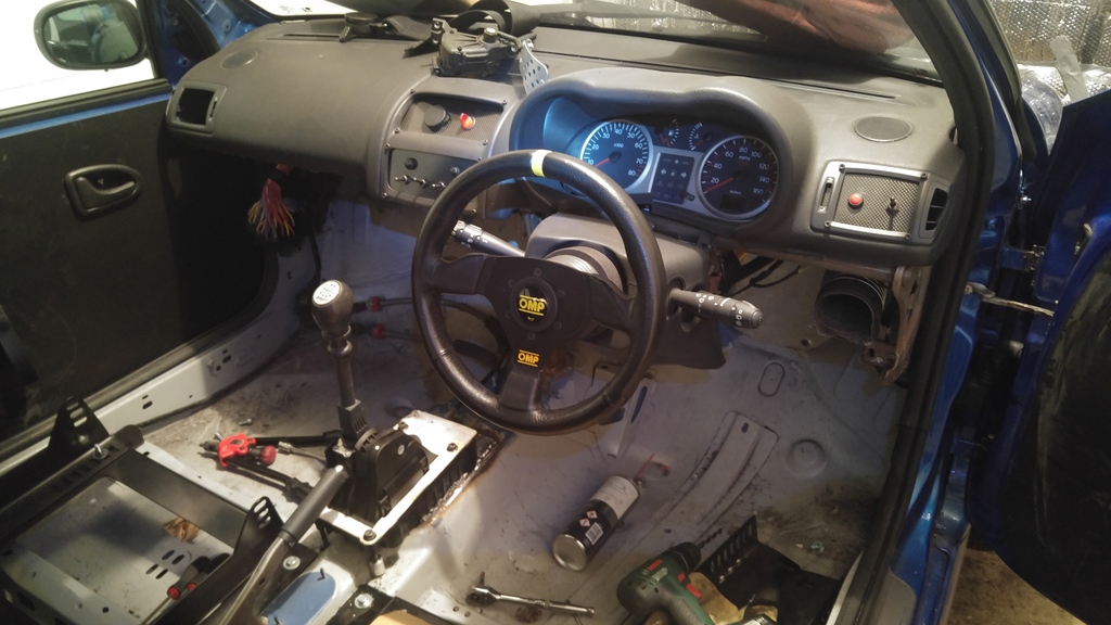

Made a fair bit of progress this weekend weaving in and out of going out.

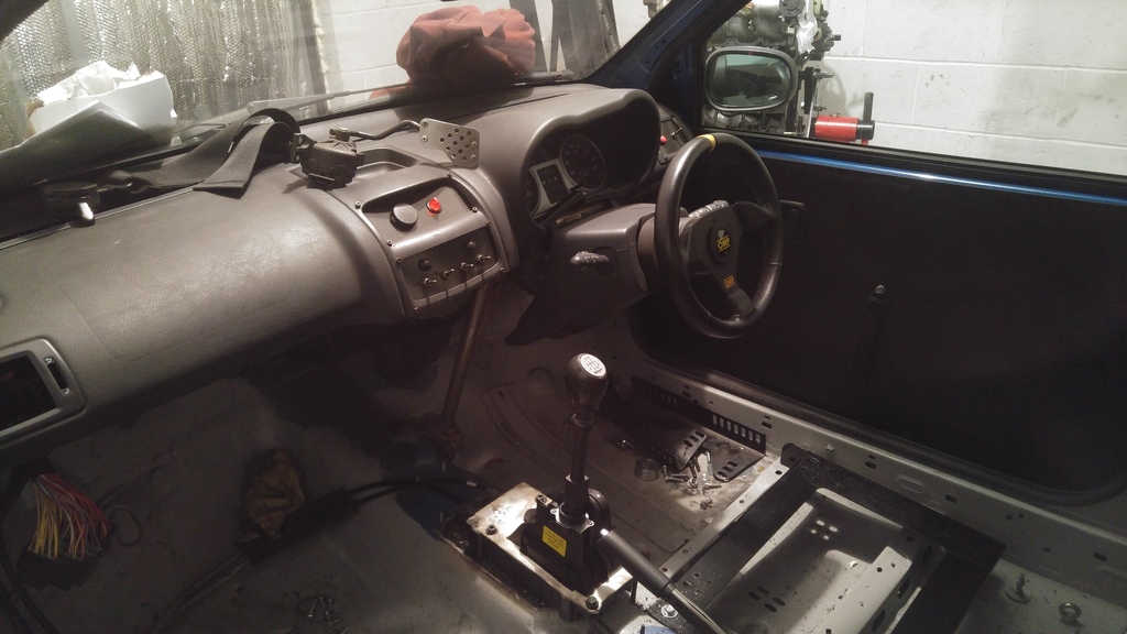

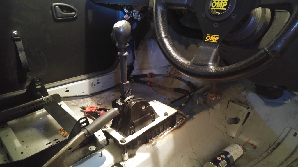

Found some steel in the back of the garage and cut it to size to fill this void.
As i'm moving back the gear stick and raising it up I needed to put the bolt directly where the hole would be for the original gear stick
Welded that in (still got no gas and using the gasless setting so the welds are so sloppy) Works though. Still waiting on some alu tube to act as a riser for that.

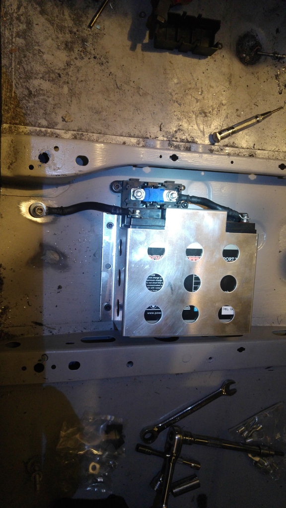

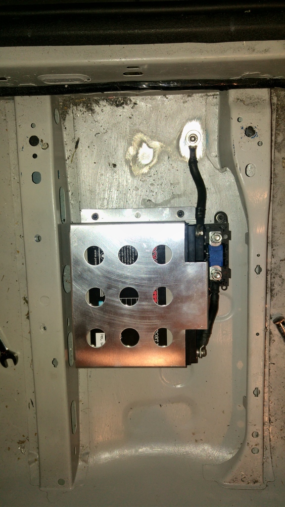

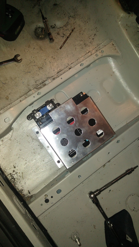

Next step was to mock where I want my race battery.
Rivnutted them. Best invention ever!

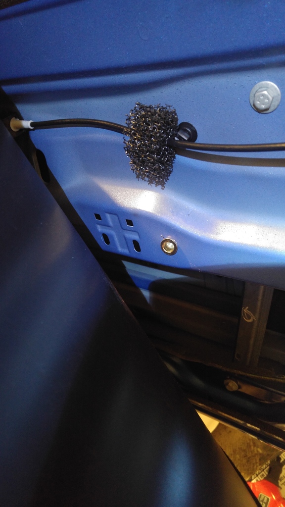

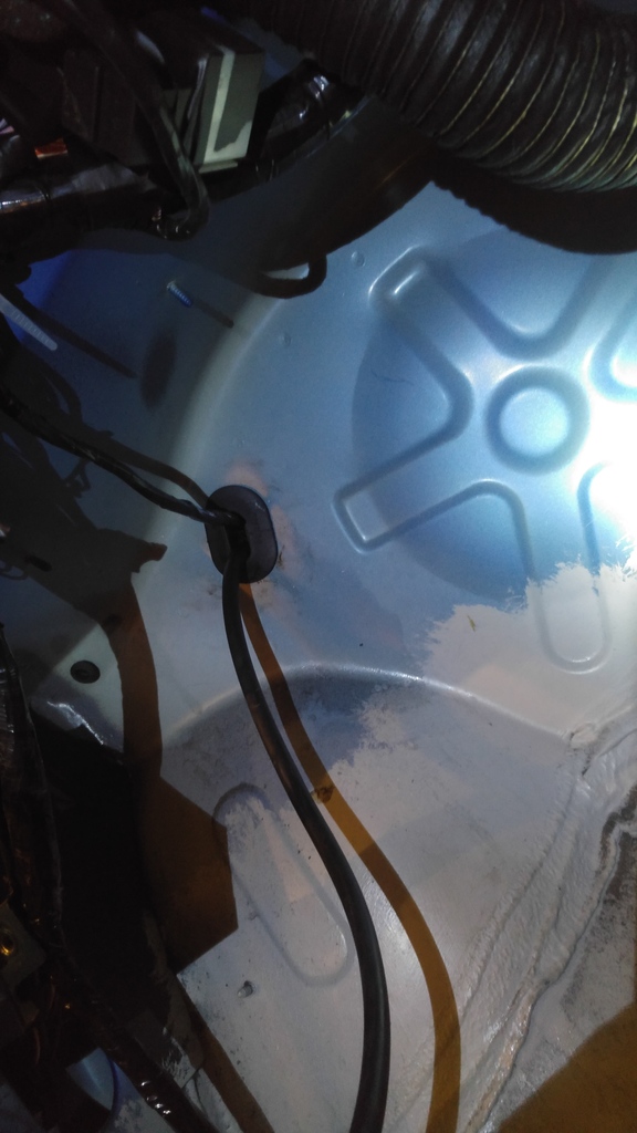

Earth in
Nicely got it in the grommet where the bonnet release usually goes

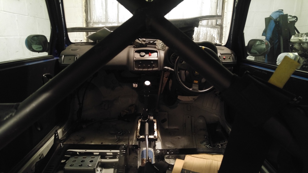

Final pics. Going to remove that horrible foam that sits on the gearstick at one point.

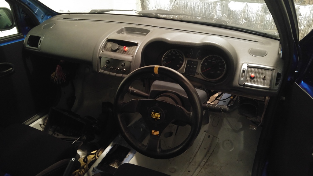

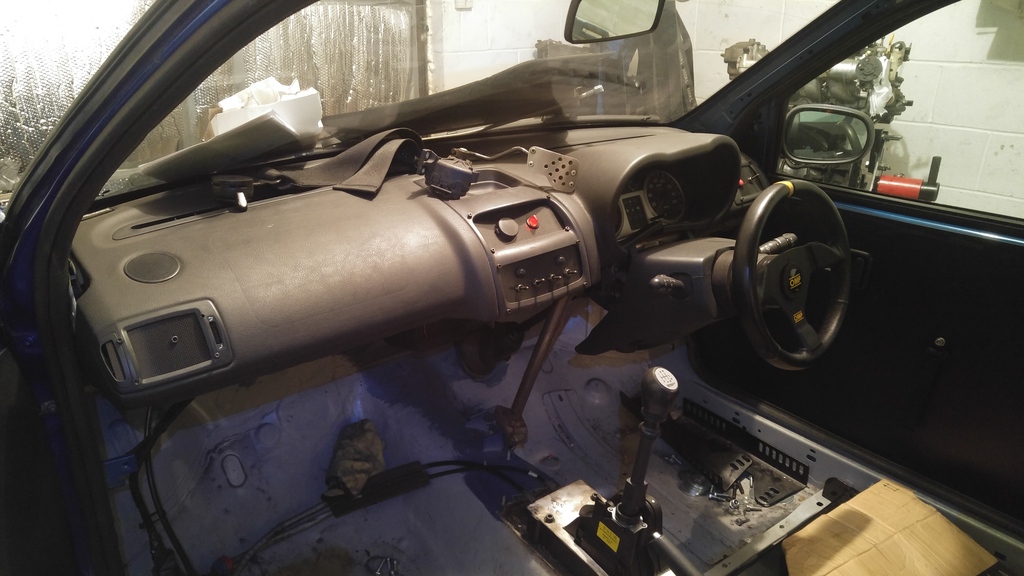

Finally had an hour or two to myself tonight so sorted some random jobs.

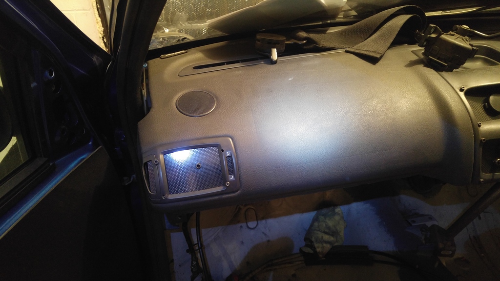

The dangling fuse box you can see in previous photos was doing my head in. So with the spare carbon fibre I had I mounted the fuse box to it with an m5 bolt. Got some new bolts on the way that are stainless to tidy things up.
It now matches the rest of the dash.

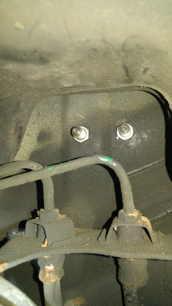

Fitted the bulkhead adapter through the back of the car for the brake line to pass through
From underneath

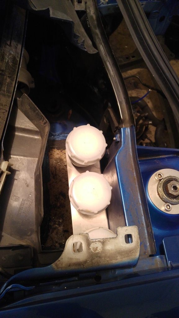

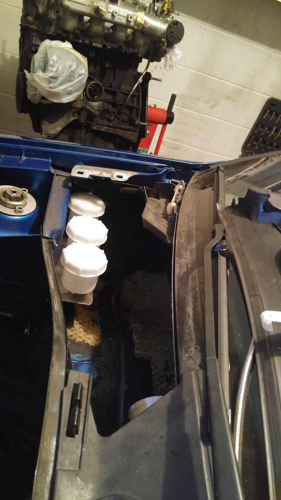

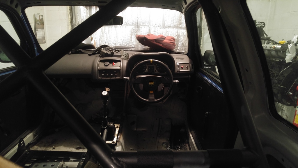

Mounted the brake and clutch res bottles by riveting the bracket underneath the scuttle panel
Starting to take shape now...

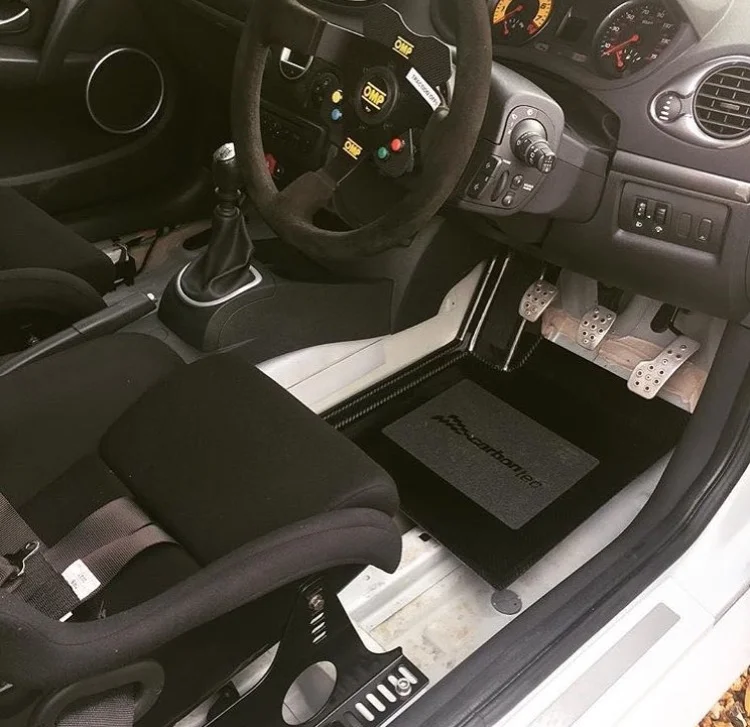

Dan, foot plate for the pedal box...this one is carbon fibre, but along the lines of what I previously suggested
