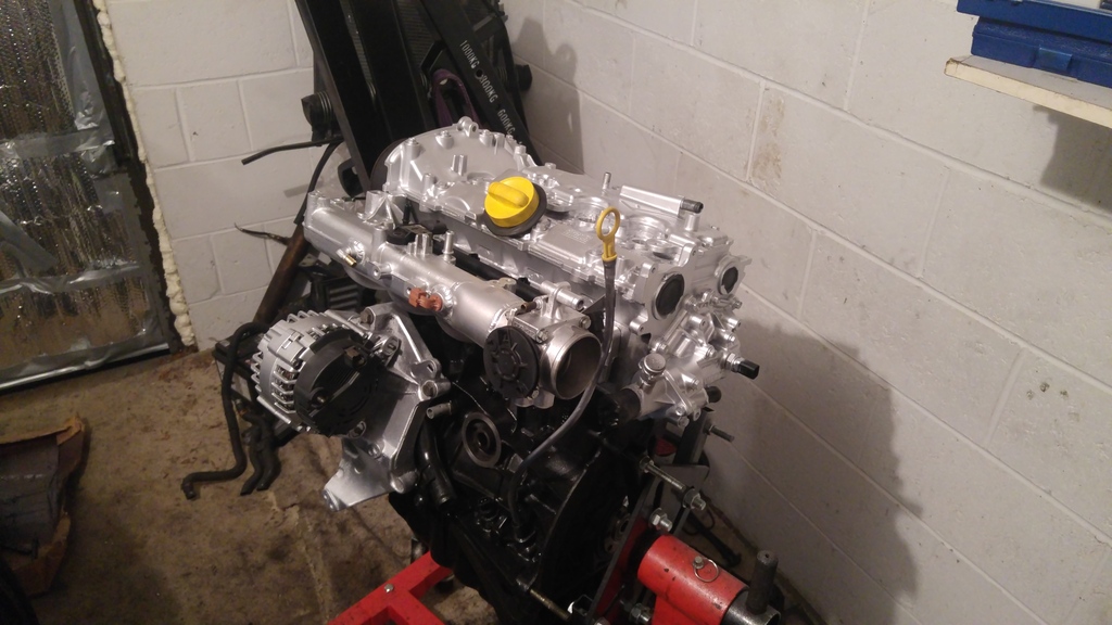

Painted the engine last night.

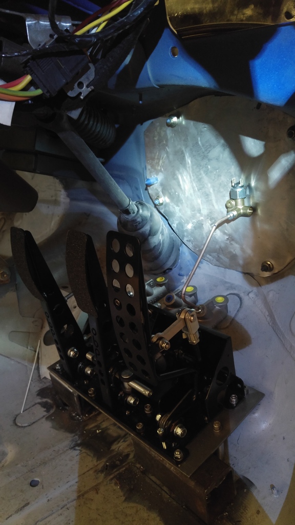

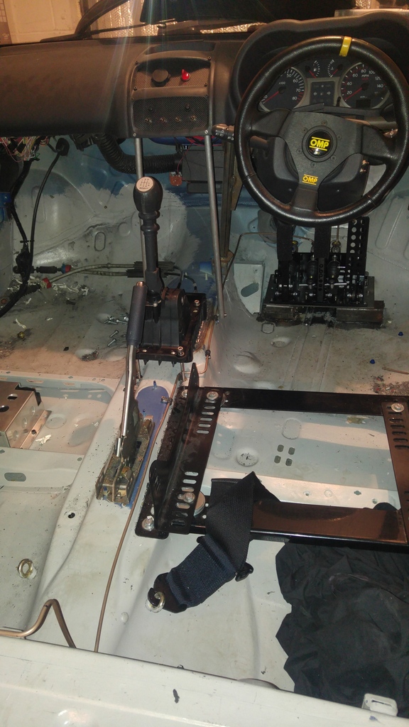

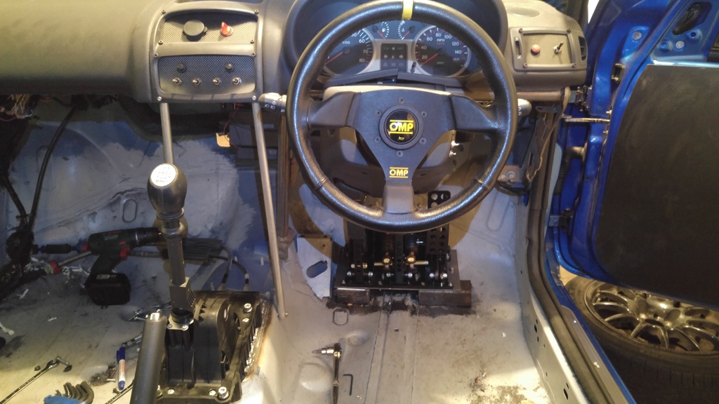

Think I've nailed it! Had a productive weekend and got a few days off work to get more stuff done. Need to tidy up the man cave too as it's absolutely filthy with grinding dust et. Al

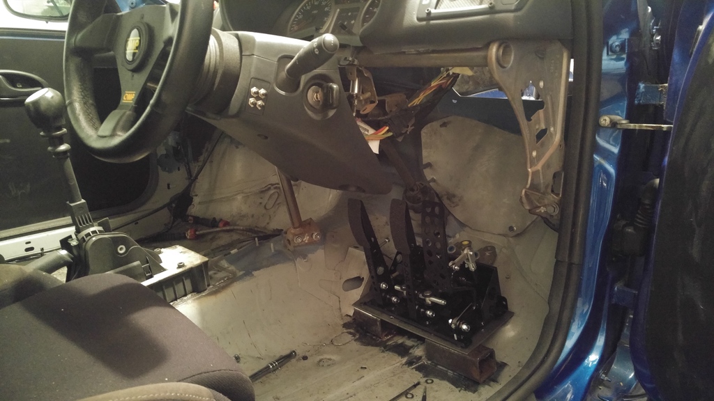

First of all, the pedal box is in! I attempted at welding some box section in for a support but that went absolutely tits up as I blew through the floor a bit and set a bit of underseal on fire.
My h&s head kicked in and realised I shouldn't be doing this in the garage underneath the house so I resorted to m8 nut and bolting it. Then got a 3mm sheet of steel on top as a base for the pedal box. Held in with some alu stand offs it's absolutely solid.
Tried pushing it with all my force on it and it didn't budge only gave my seats a f**king horrible creaking sound. Going to tidy it up with paint obviously but in terms of position it feels good

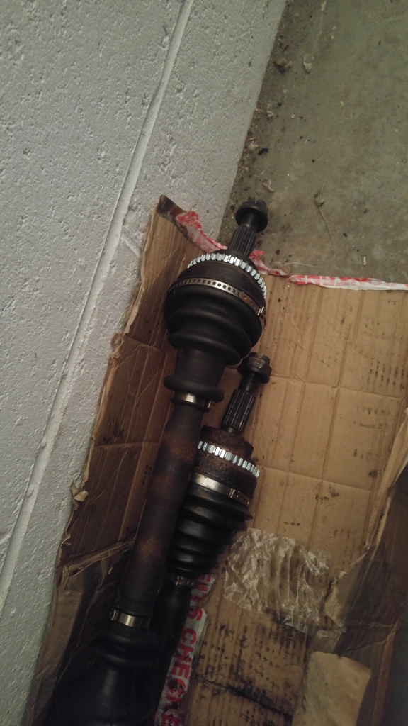

Abs rings fitted to the driveshafts with copper grease

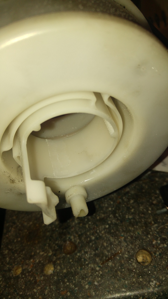

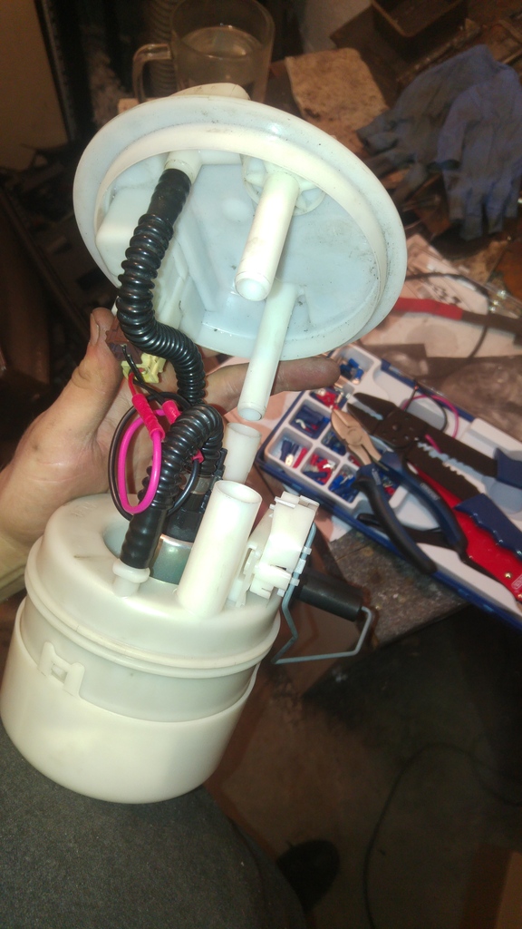

Then began dismantling the fuel pump to fit the uprated one.
Had to Dremel three ribs out, one already done on the picture.

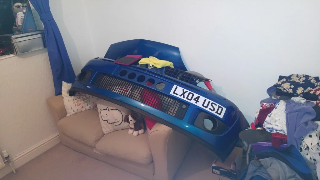

Also drilled my bumper and fitted a sticker plate which I think, despite being the same size as the 3/4 plate, looks wayyyy too big so that'll be going smaller I think. No loss though.

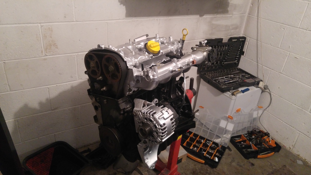

Hey Dan,

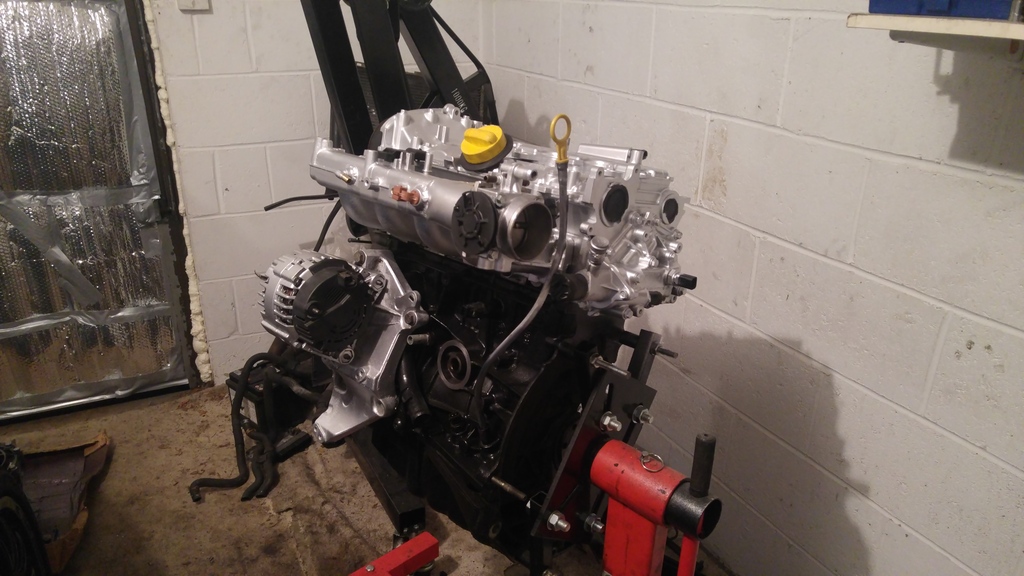

That engine looks spectacular. how did you paint the alternator or is it new. Are they easy to open up and put back together again.
Amazing workmanship !

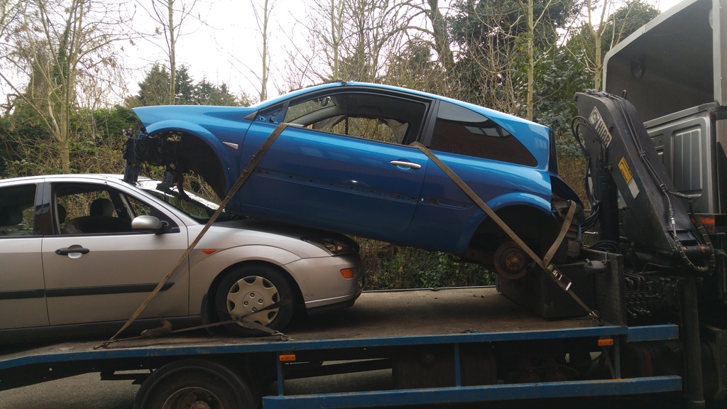

Actually had a really funny thing where this guy said he wanted it, ensured me to the high heavens he wanted it. He even came massively out of his way to drop off two wheels for me for free so I could move it out of my garage. I then arrange with him and absolutely nothing, just keeps ignoring me over and over and over. So @optical called him for me on a different number to mine and low and behold... he answers. So weird. It wouldn't have been an issue at all if he just messaged me saying no I don't want it, plans have changed. People are very strange.

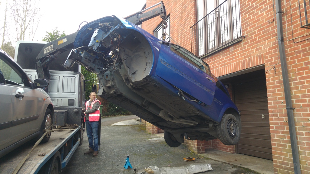

Anyway, last night I listed the shell on gumtree and some bloke messaged me saying he can pick it up with his hiab lorry. Winner!! I didn't ask for any money for it. Just wanted it gone.
So long! It's a massive shame as the shell was pretty mint tbh. Actually nearly held onto the car.

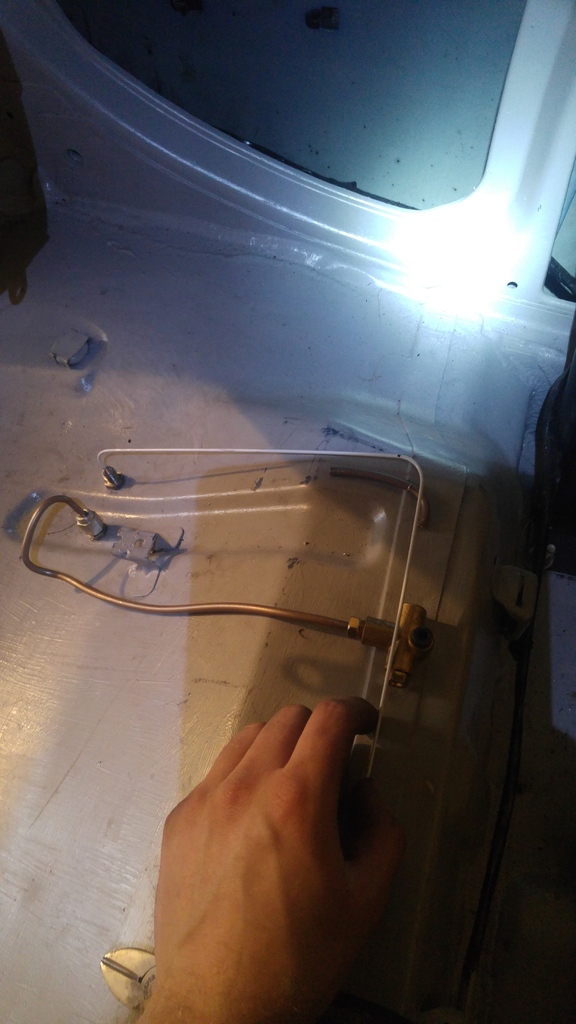

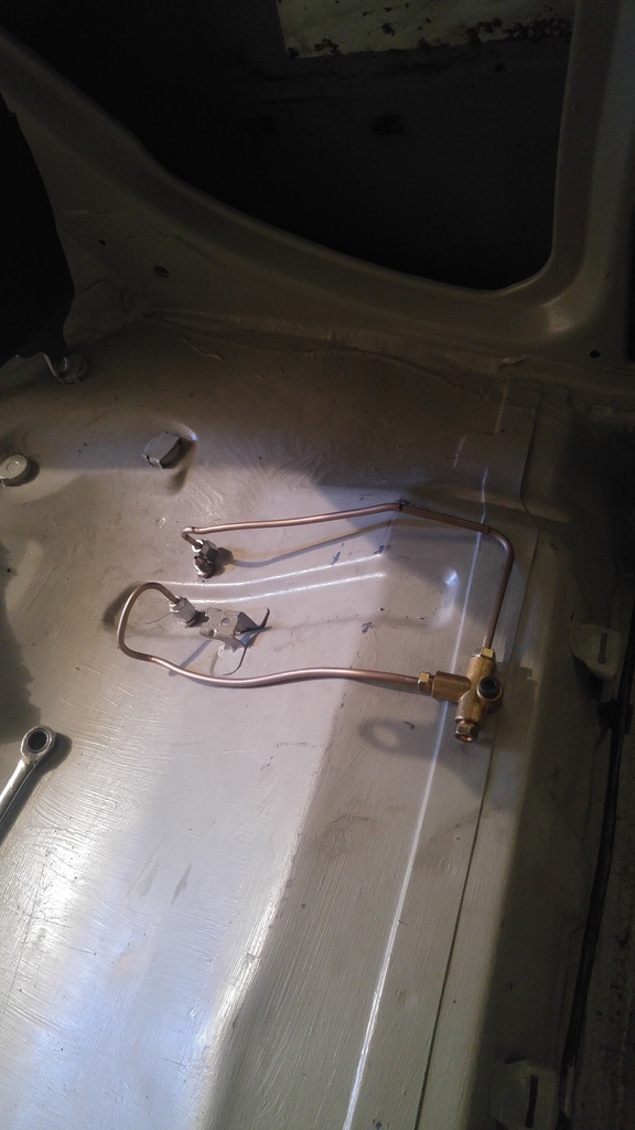

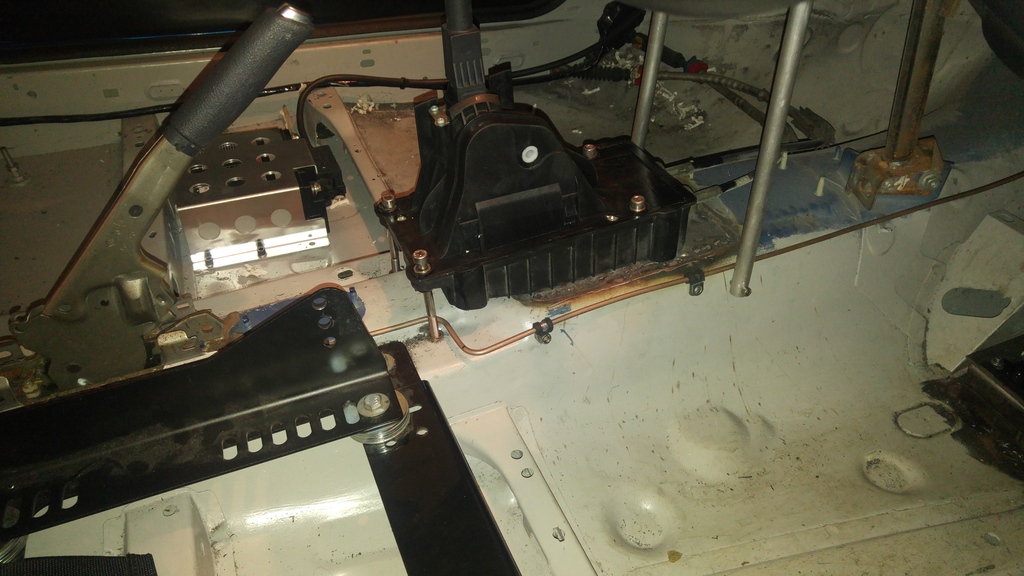

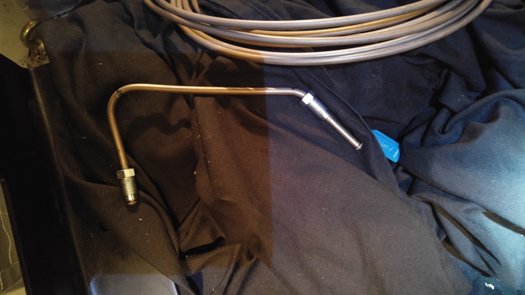

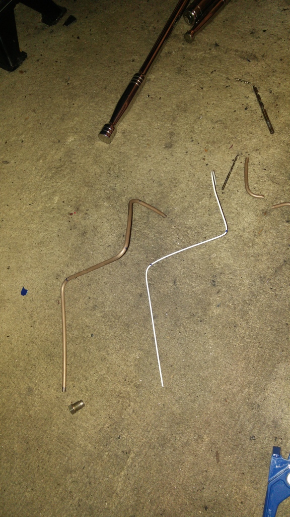

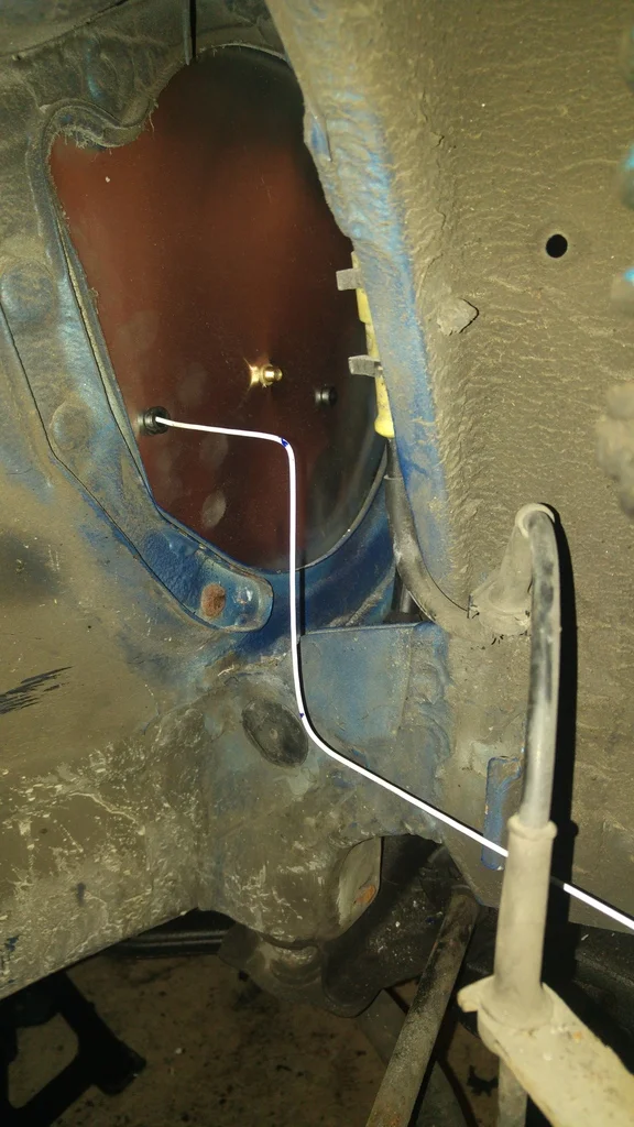

Made a start with my brake lines on the rear in the week.
The one on the left was my first attempt, ended up getting it wavy and it really stressed me out. Up to a point where I threw my toys out of the pram, turned the lights off in the garage and went upstairs to rant to the Mrs about how badly it was going. It obviously still works etc but I NEED it looking perfect.
I decided to chill and read online for hints and tips and found a really good idea. My main issue was that when you bend the brake line, you need to know where to bend it to find out where it ends up. It's very hard to explain the issue! But if you get a small offcut of brake line, sharpie a line on it and with your bending tool, bend it where the sharpie is 90 degrees you can then offer that up against your new brake line to be bent. Then you can use this as your template for other bends later on if that makes sense???
I also used a coat hanger to practis/ce on the second attempt which imo made it look much much better!
First attempt bottom, second attempt top!
Using my sexy lil template thing below. Got another one for 45 degree bends
I'll redo the other one before the car is ready for sure.

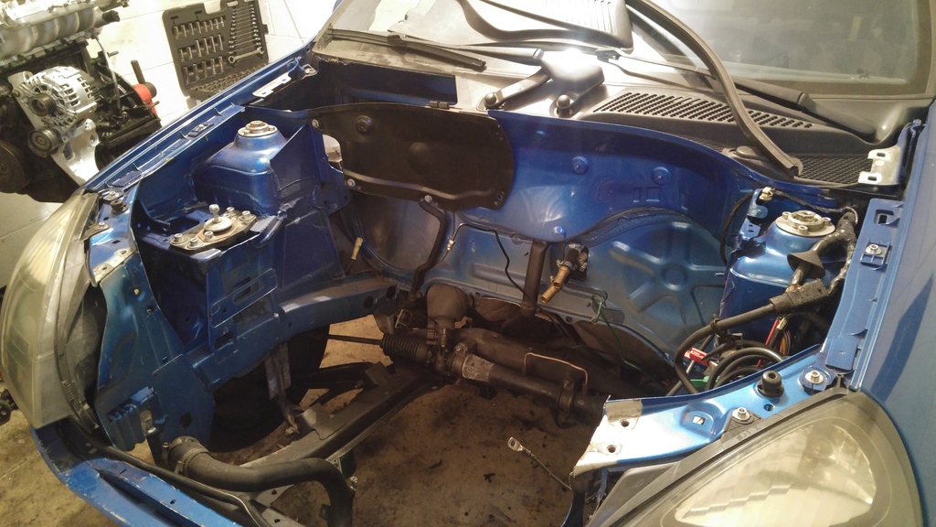

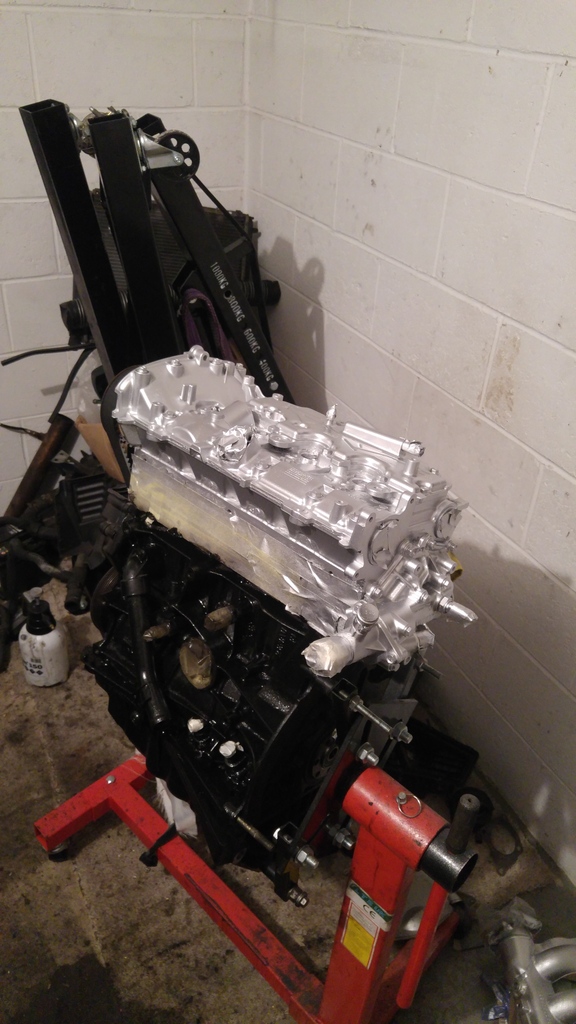

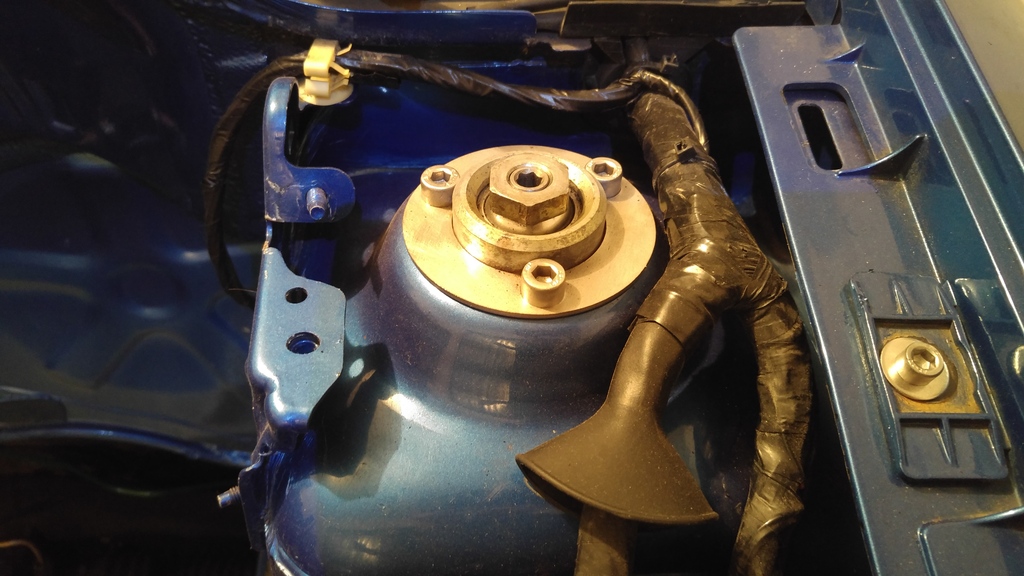

I've started to revamp the engine bay whilst everything is out. New bolts with spec c m6 washers. Meaning m6 bolt hole but wider outer diameter.
New bolts for the top mounts.

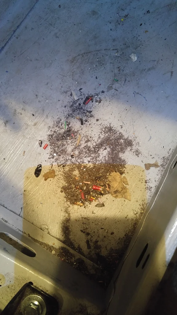

Now back to the inside of the car, it's collecting a metric s**t ton of grinding dust, welding sparks, bits of wire and allsorts haha.. Need to clean it soon

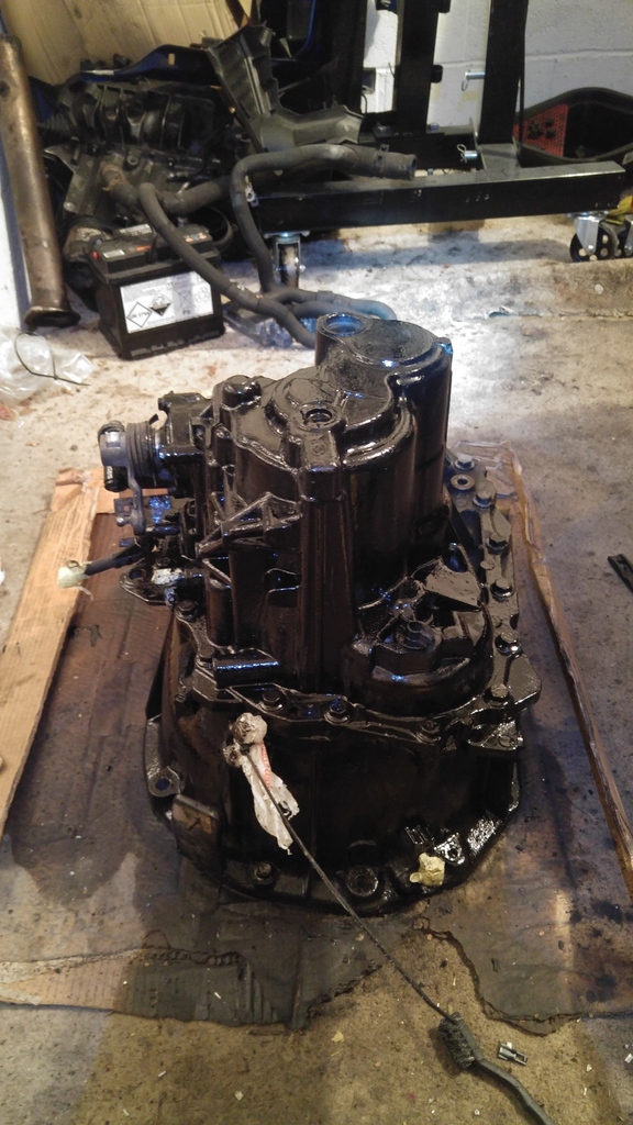

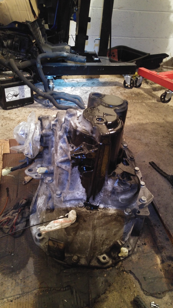

Another piece of the puzzle was to paint the gearbox, done the first coat on that tonight.

Did you hand paint the engine and gearbox ?
Replied to you on whatsapp earlier I just realised after quoting this but i'll quote you anyway

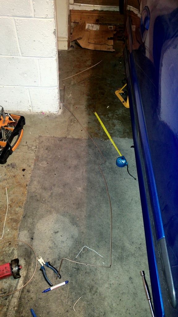

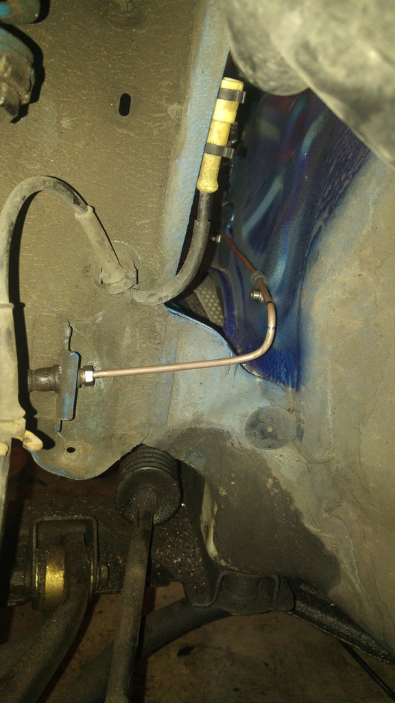

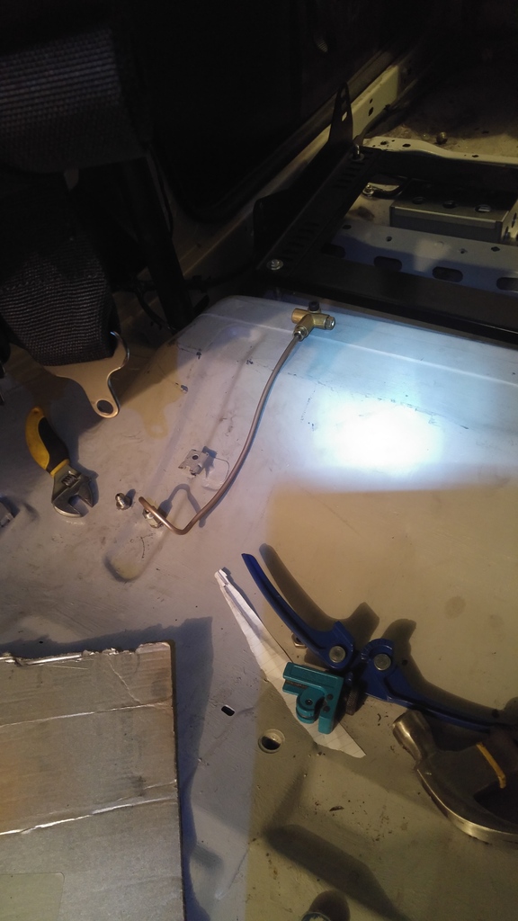

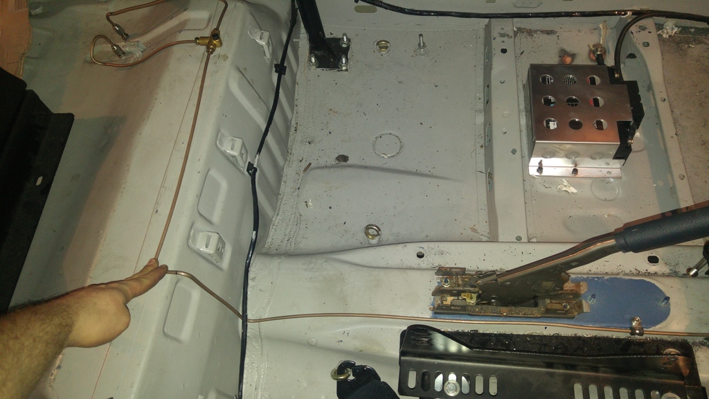

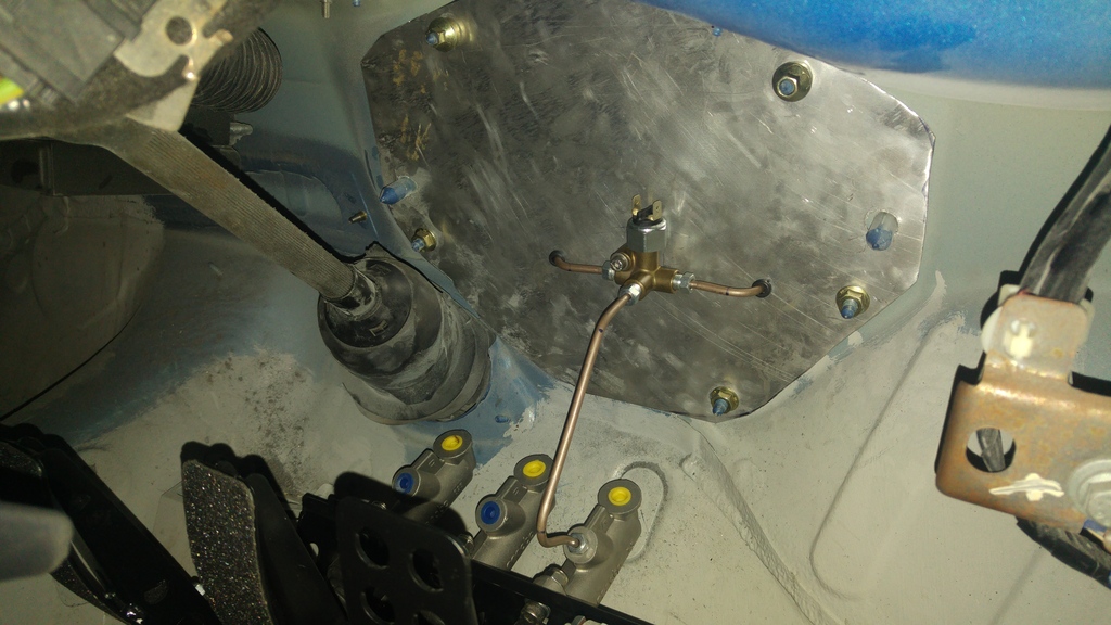

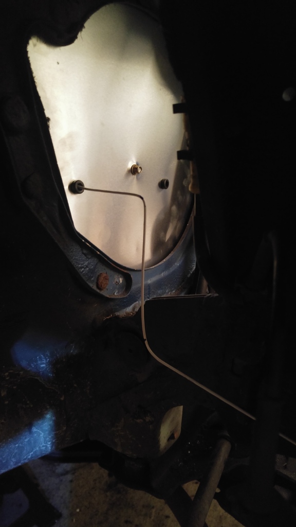

In other news, made more progress today with the brake lines. Decided that today i'm going to make a start on them and stop putting it off, pretty much done them all! Just a few P clips to install now but that can wait for another day.
Getting the hang of this pipe bending stuff now

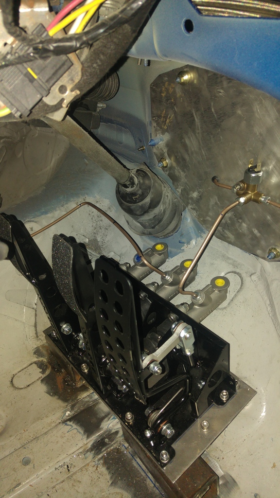

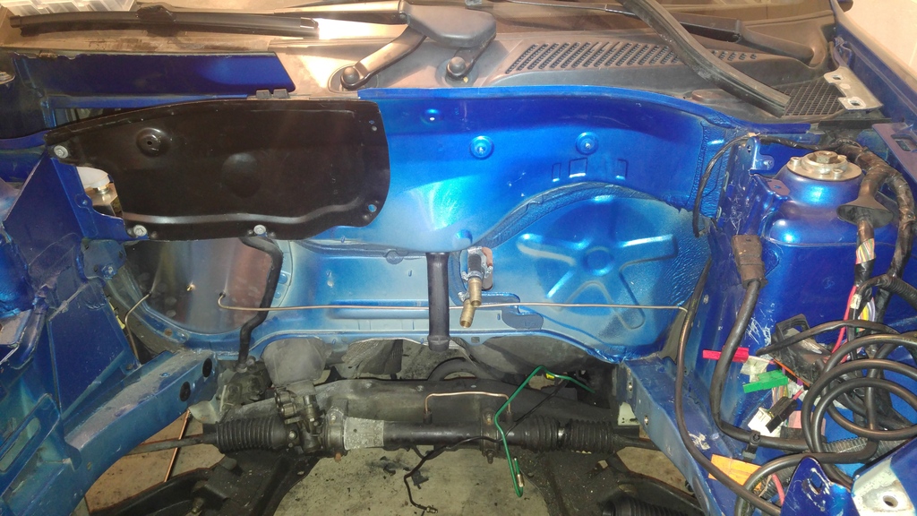

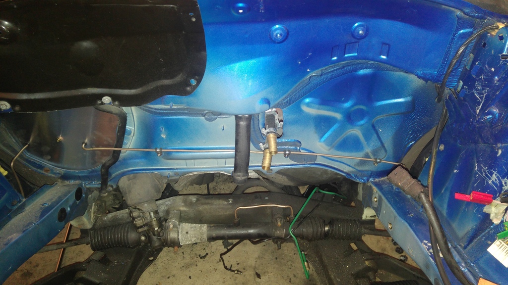

So the fronts...

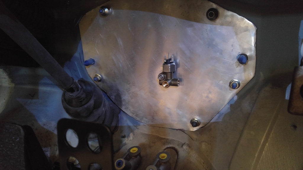

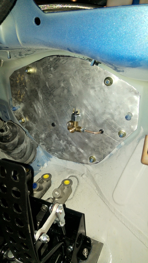

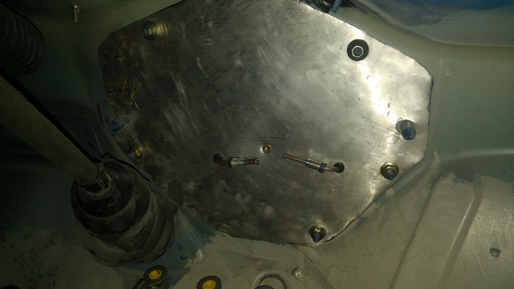

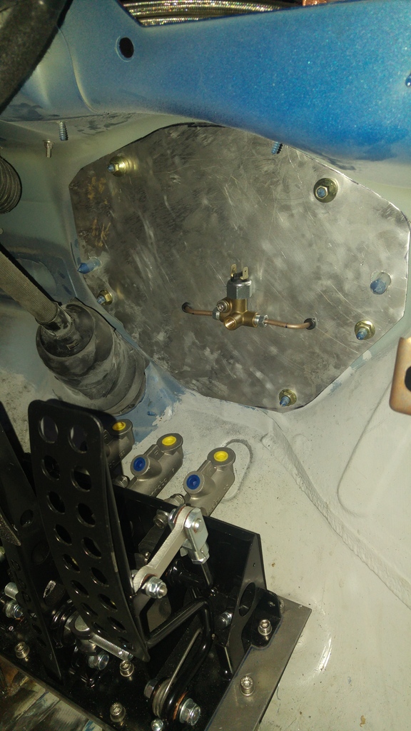

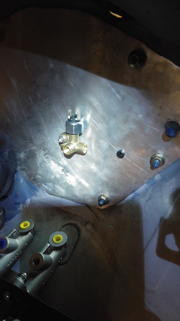

Fitted the 4 way brake connector to the alu sheet on the bulkhead, has to be 4 as one comes from the pedal box, one for a pressure switch for the brake and one for each front brake.
To allow the pipe I made earlier to fit nicely
I then required two holes, one at either side for the brake line to go to each brake. They were drilled and used grommets to stop and chaffing
Then using my trusty coat hanger I mocked up where I wanted the brake line
Flash to give some kind of reference haha, this is for the front o/s
Then pipe bend time
And in
Then I did the same for the other side
I then fed that along the bulkhead which you can clearly see at the back there
and we're in
Secured absolutely solid with P clips

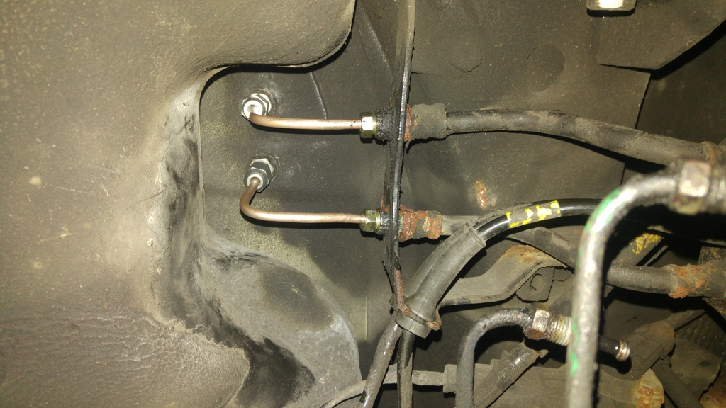

And going to the n/s brake hose

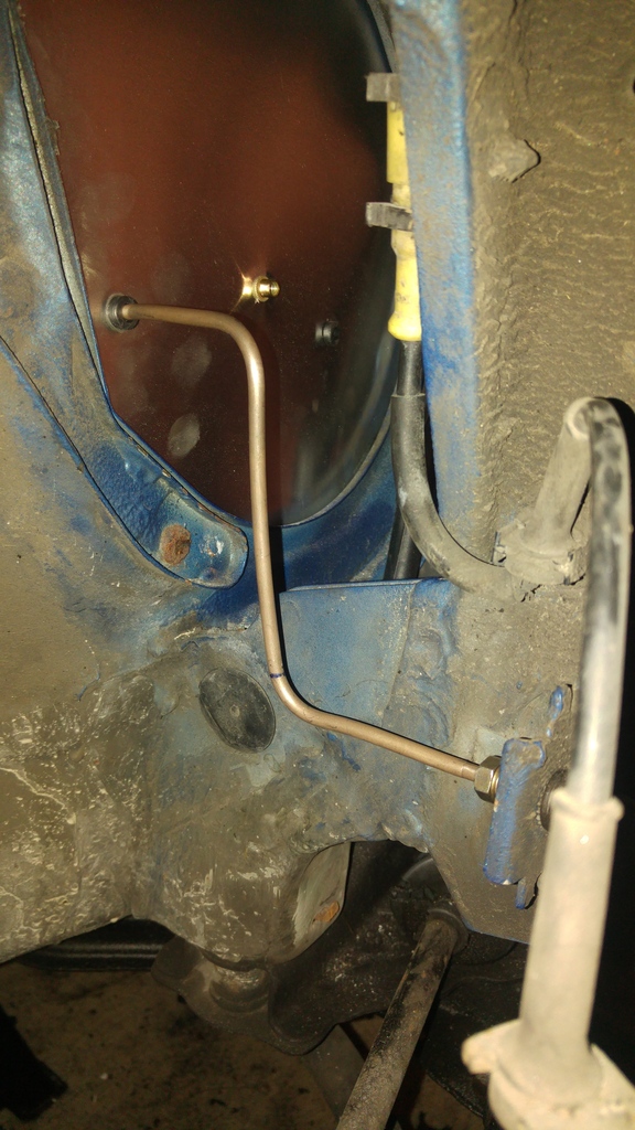

At this point I was going to call it a day but I as on a roll so I decided to do the rear one too. This was going from the pedal box to the T piece at the rear... containing many angles and many bends. I didn't have a coat hanger long enough so had to use the same piece three times, just required lots of double measuring to make sure
Worked really well though
P clipped in

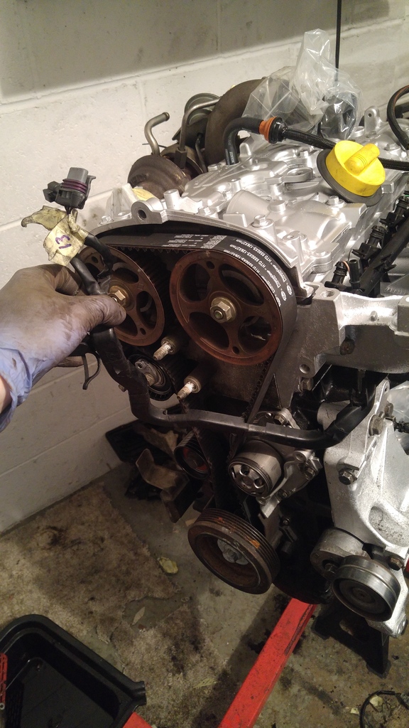

@bashracing came over last weekend to do my timing belt for me. The guy is an absolute whiz and he managed to do it in an hour or so. Thanks again mate!

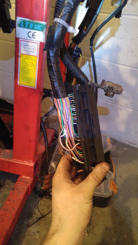

We then began to wire up the engine with the clio harness
And found some discrepancies with some connectors. The clio phase 1 throttle body uses a tps as it's cable operated so that was one of the issues. Also the Tdc sensor in the gearbox was different, as was the map sensor connector. Fairly simple fixes though.
Popped my wheels on and rolled Boris forward so I could get a washing machine in around the back. Got me excited to get it sorted as I'm sick of driving a slow car for work.

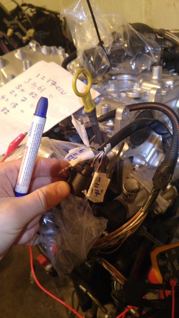

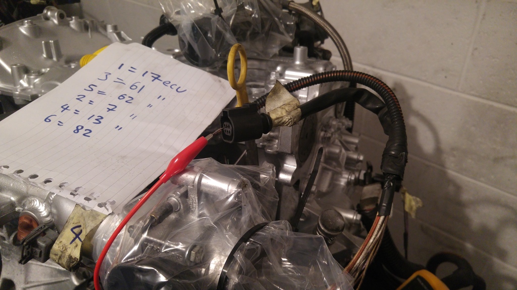

The next step was to change the throttle body wiring so that it runs with the phase 1 tps. Massive massive thanks to @barnesautos for his relentless help with me pestering him for wiring diagrams and help. Thanks Jason
Had to find continuity in the wires of the ecu to the original 6 wired plug,
Labelled up

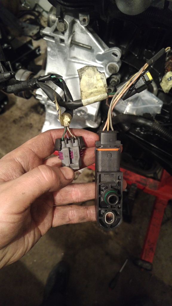

The next issue is wiring the map sensor in. I'm using the clio loom and the map sensor on the Megane is a different connector so I want to use the Megane map connector on the clio loom. However the clio is 123 on the wires and the Megane is abc or vice versa. I need to get the Megane 225 wiring ecu pin out so I can find out which is 5v, signal and earth.if anyone can help me that would be awesome!
Clio on left Megane on right

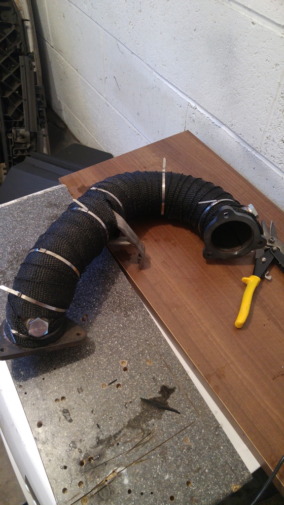

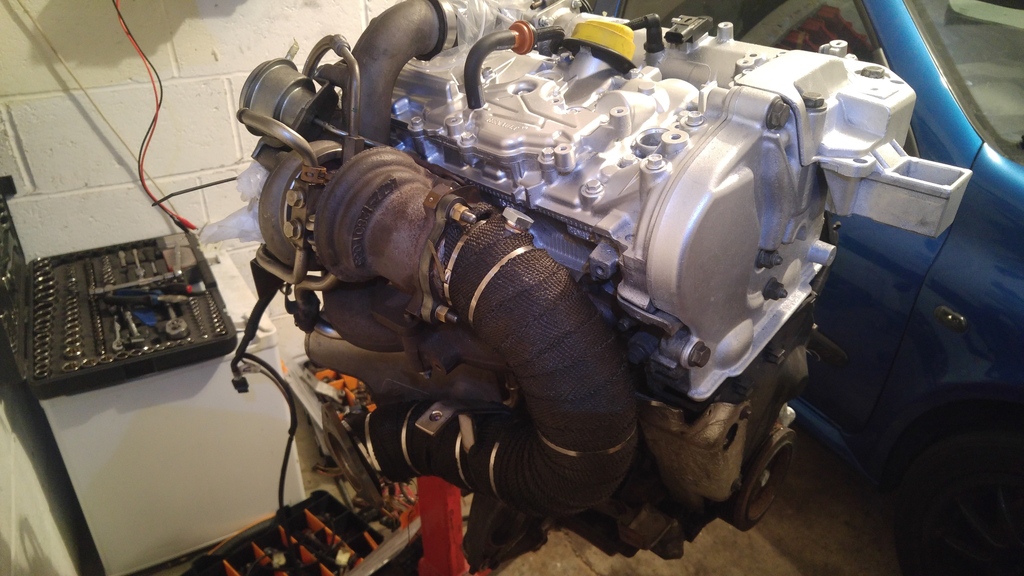

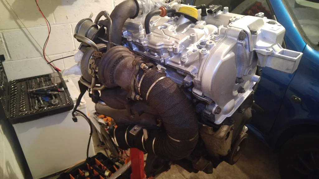

The next job was the wrap this bad boy
Not bad for a first attempt..
Followed some advice online and wet the wrap first. Didn't find any advice online telling me it's fibreglass based so that was hilarious itching like f**k all evening..

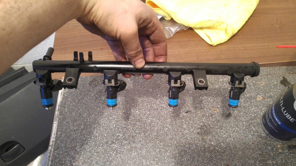

I then fitted the uprated 630cc injectors

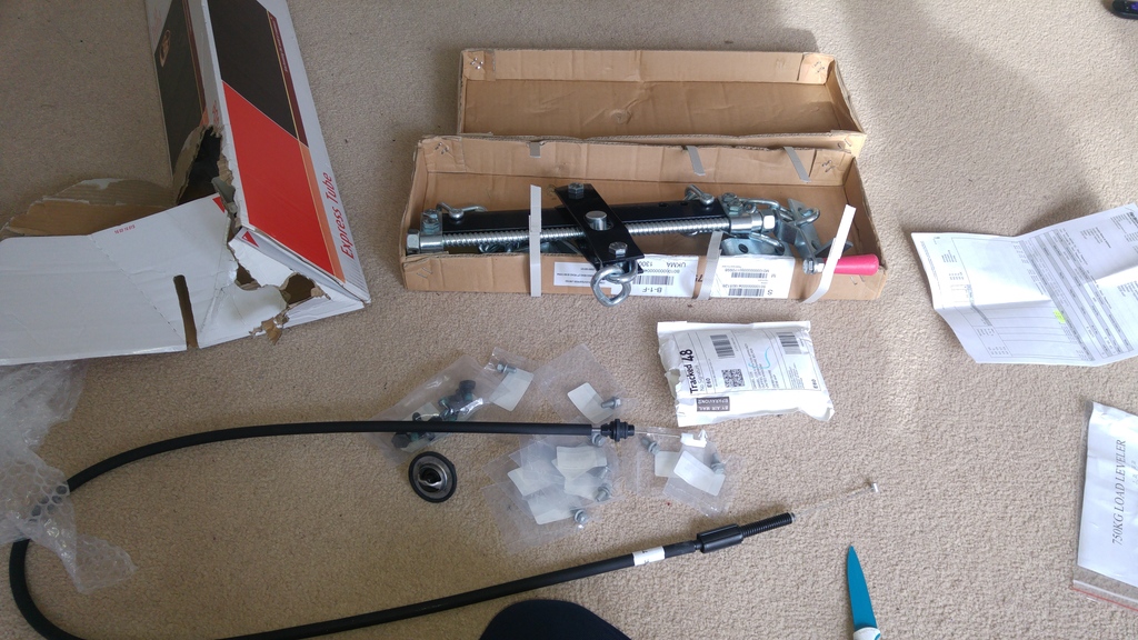

And a parcel of goodies arrived
Load leveller for the engine and box

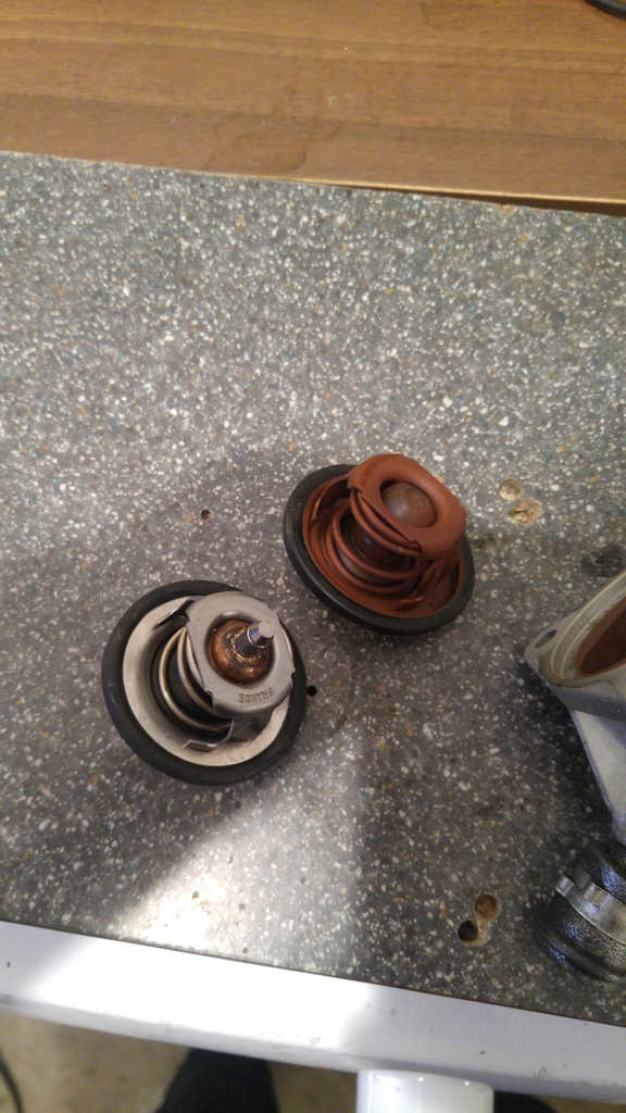

197 thermostat
Phase 1 accelerator cable
Flywheel bolts

Changed the stat

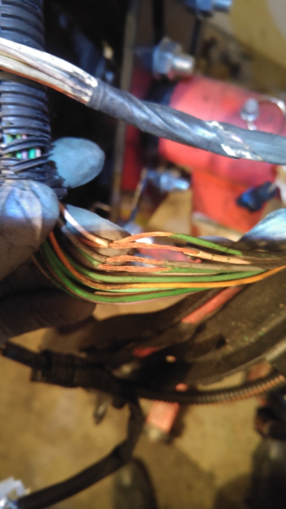

When locating the wires for the carbon cannister I found this! The insulation around it was also very brittle.
So I taped them up, wonder what they were causing to go wrong.

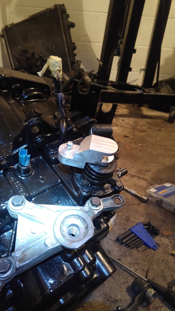

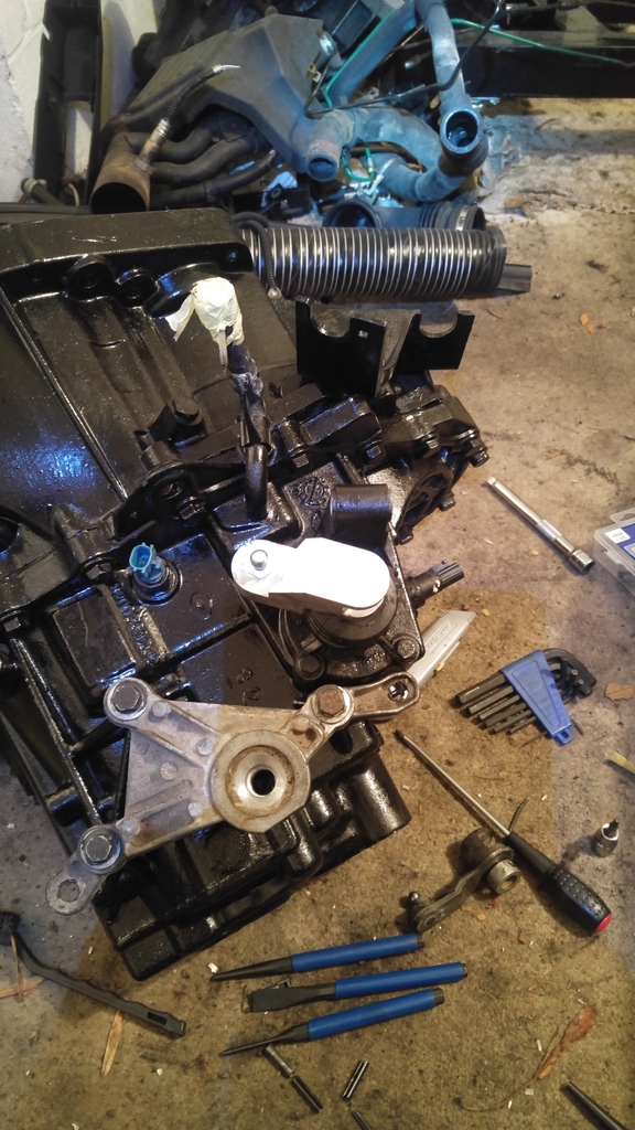

I fitted the short shifter today too. That started to become a bit of a ballache.
You have to punch put a roll pin which decided to teach me NOT to use a Torx screwdriver to do said punching. Finally came out after much swearing and abuse. I spanked it to Halfords to get a roll pin kit, two sets of vice grips (long nose and normal) and a punch and chisel kit.
Got it on though. Not just waiting to be told I've got it on the wrong way... Haha
It was fitted like for like for the original so should be correct.

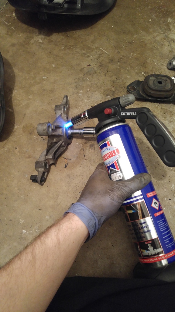

I then started to remove the stud from the Megane gearbox mount. Turned out I could have just used it but I'd have to take apart the clio solid mounts and I'm not sure how they come apart after much head scratching. Turned out I can just remove this stud. And fit with clio stud.
It was a b**ch to remove even with heat but finally cracked it off.

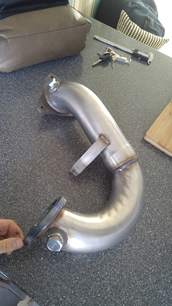

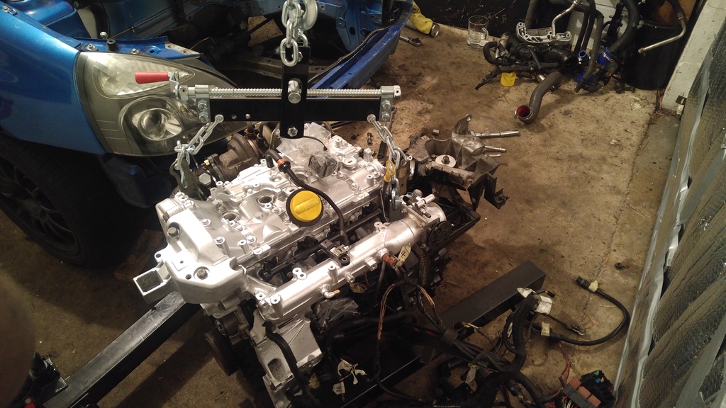

I then fitted the decat to the engine and started to take it off the stand ready to fit other parts

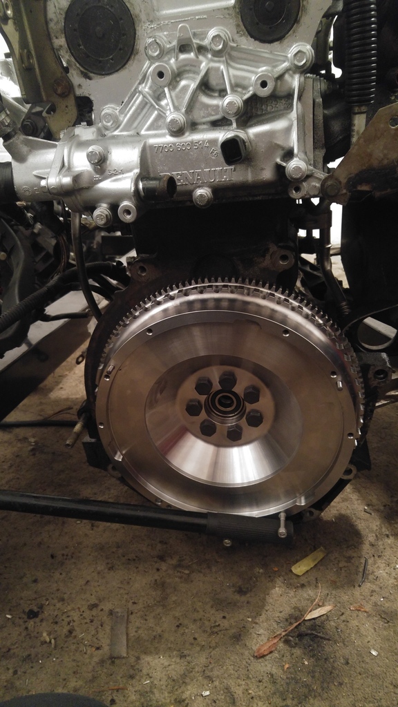

Flywheel fitted with the new bolts
Clutch on..
Then mated the gearbox up with a few bolts to bring it together. Need to clean up the surfaces where the bolts go as I'm not fitting them over painted areas. Finally stuck the load leveller on and called it a night knowing I've made fairly decent progress this weekend.

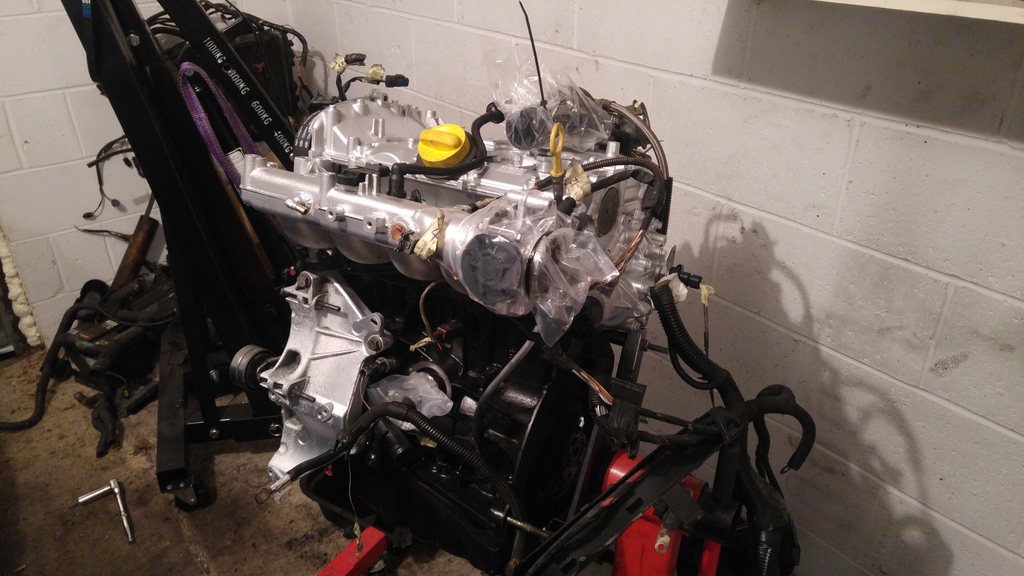

Should be getting the engine in next week after work, I just need to fit the starter motor too. Then I need a few more parts, oil cooler for one and an alternator.

Cheers mate. I think they're really loud with no silencers but the decat gives you some nice pops and bangs apparently. Would love to get flames.

Pretty sure that the turbo will actually quiet it down so the decat will help aid hooning noises!

Also, that heat wrap stuff is horrid. Fiberglass dust on your hands for days 😧
