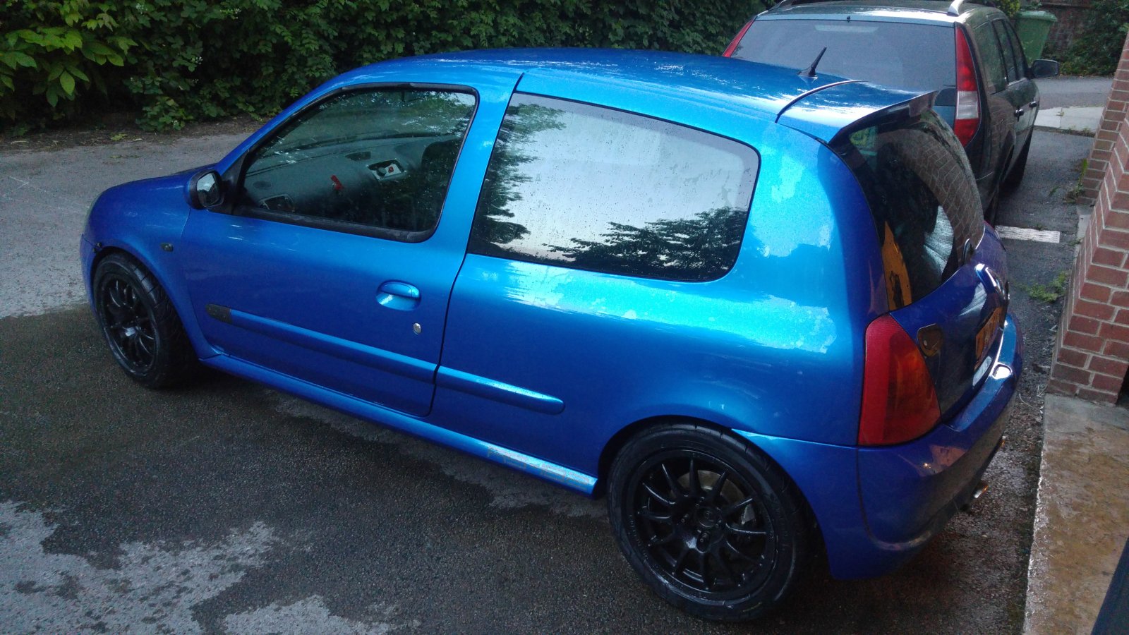

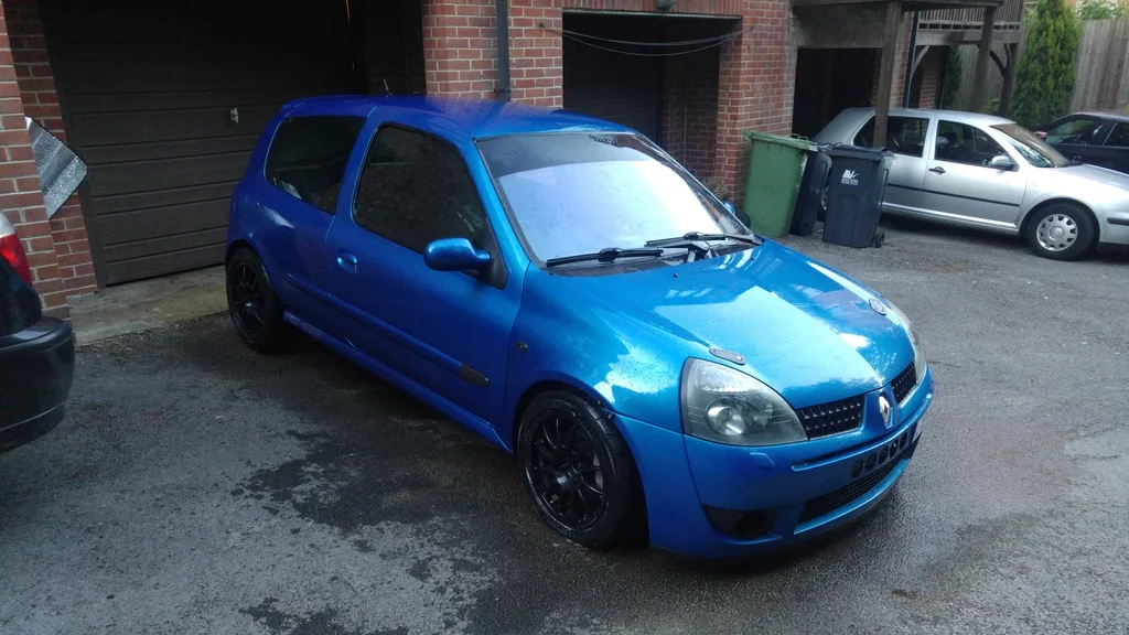

Daniels Blue 182.
Looks better Dan.
Your airbags gone off!
Thanks dude!
Nice colour bud.

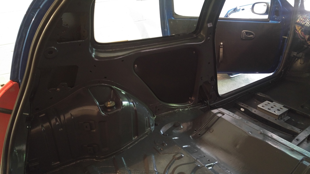

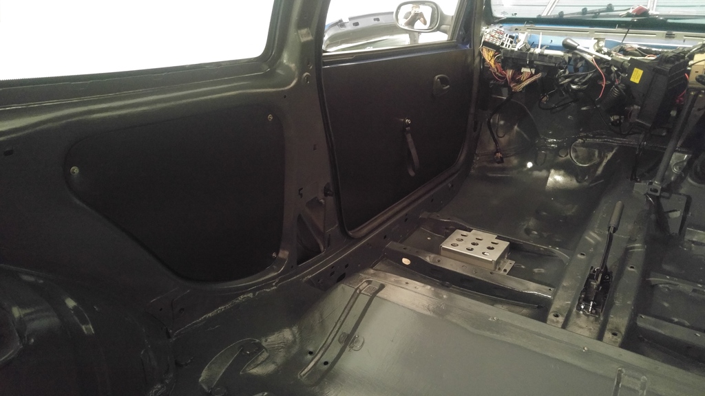

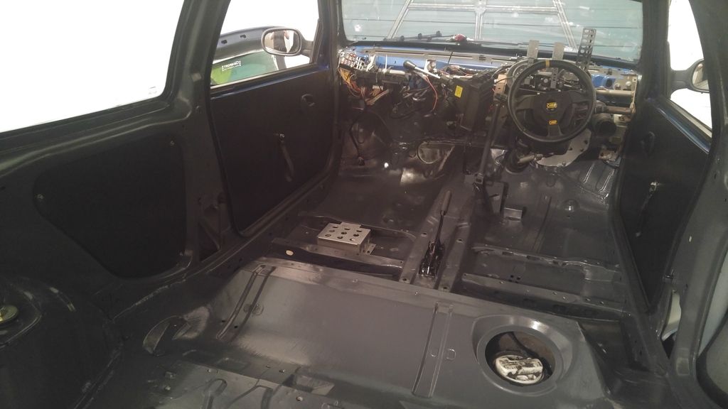

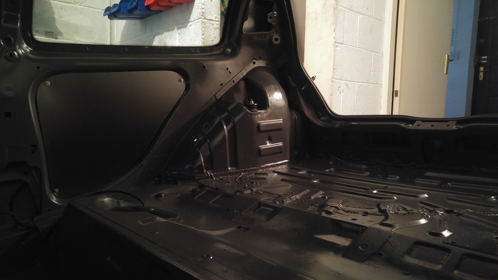

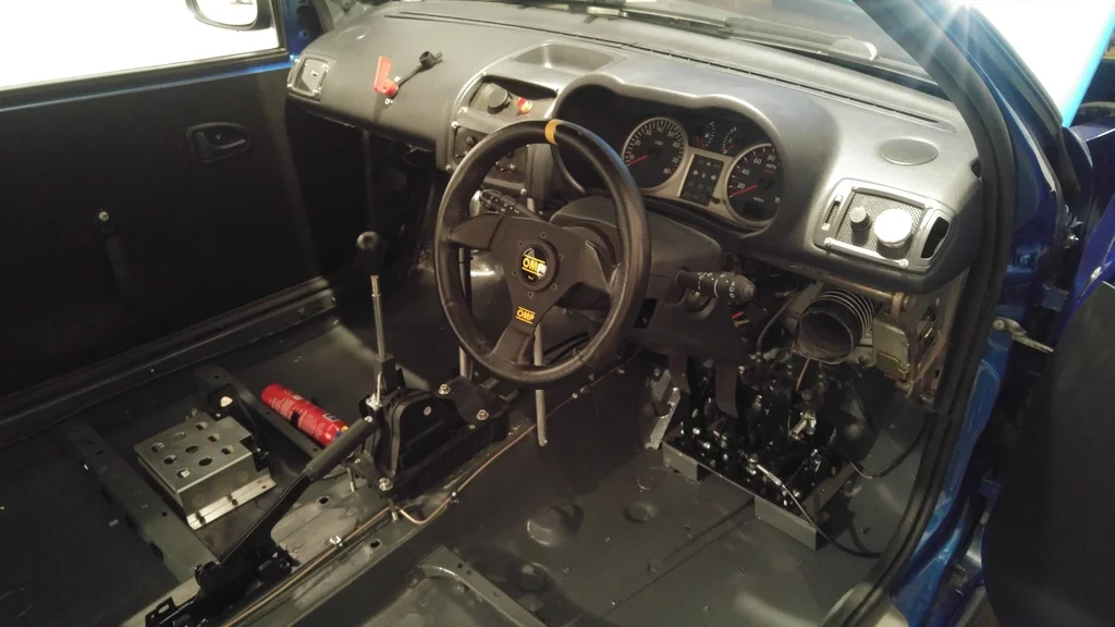

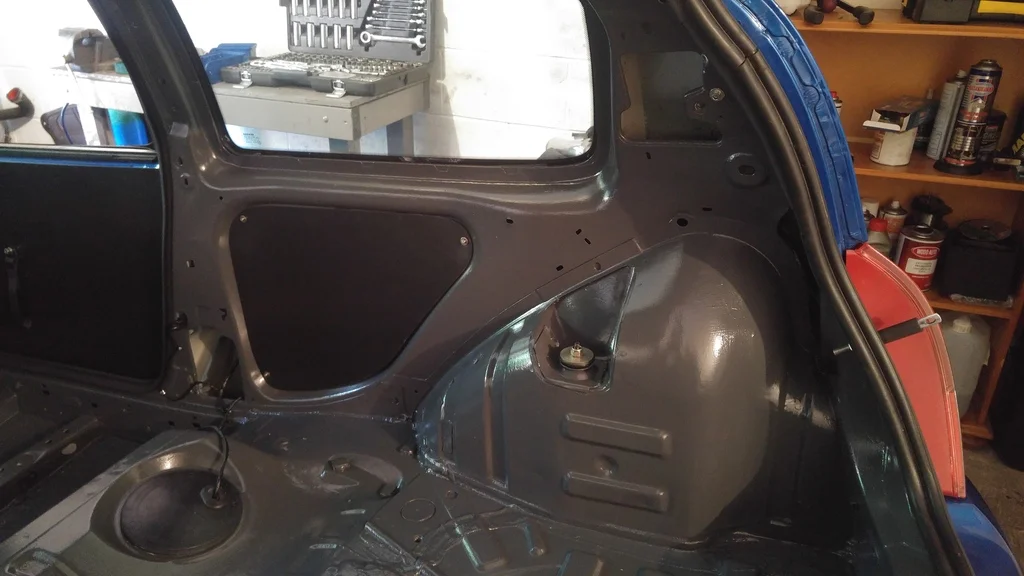

Will you be painting the insides of the inner skin panels in the rear or leaving them as it Is?
Ive got rear door cards to go over the big bits then I might make something out of abs to cover the other bits but I'll see! Thanks

I used number plate fixings to hide the screws on my dash might be an idea not sure if you can since yours are bolted rather than self tappers.
Hmmm I'm not a big fan of them haha sorry. I much prefer the bolt look.

Interior looks miles better in that colour!
Cheers mate. I think so too. Actually happy with this colour.

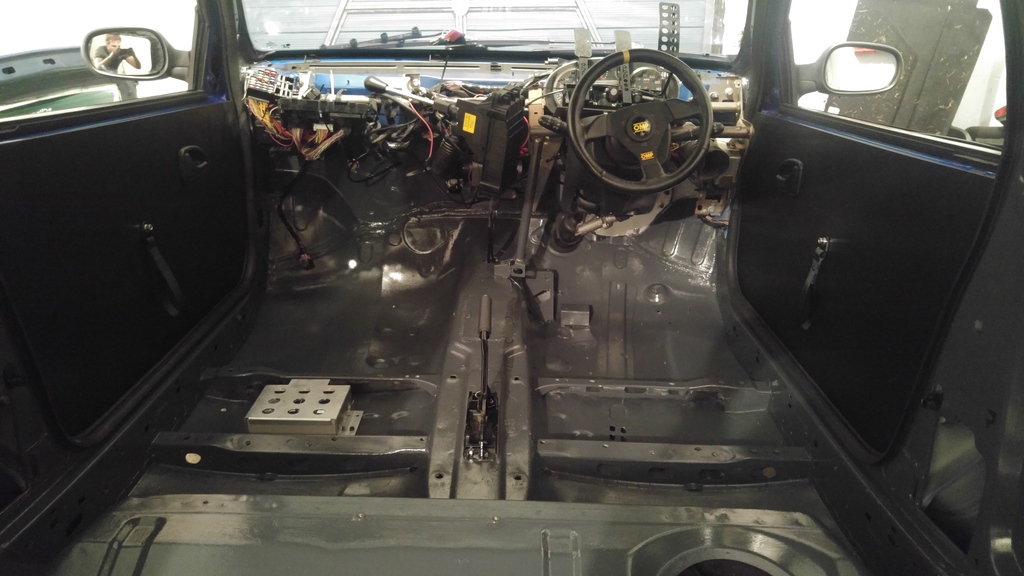

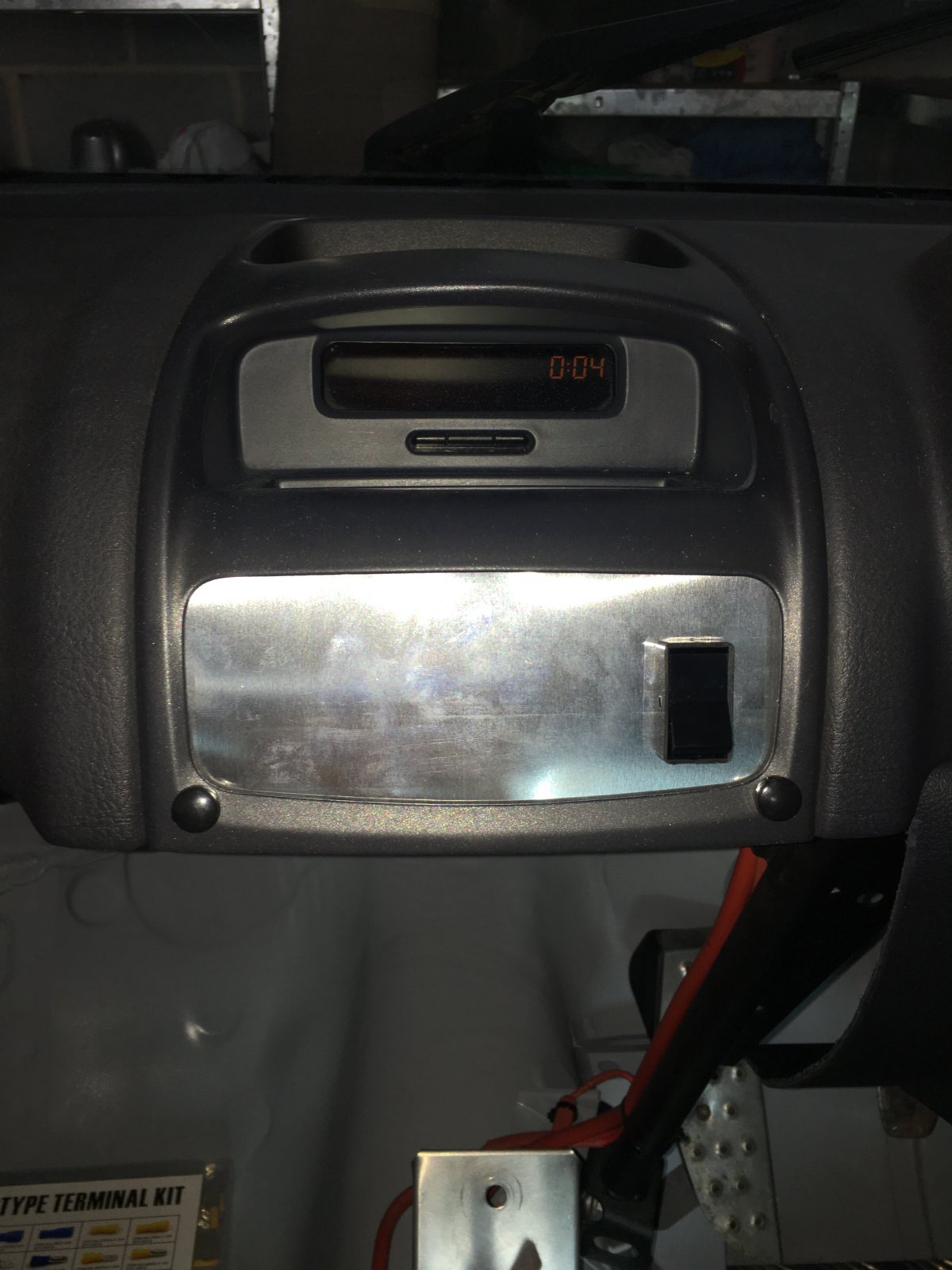

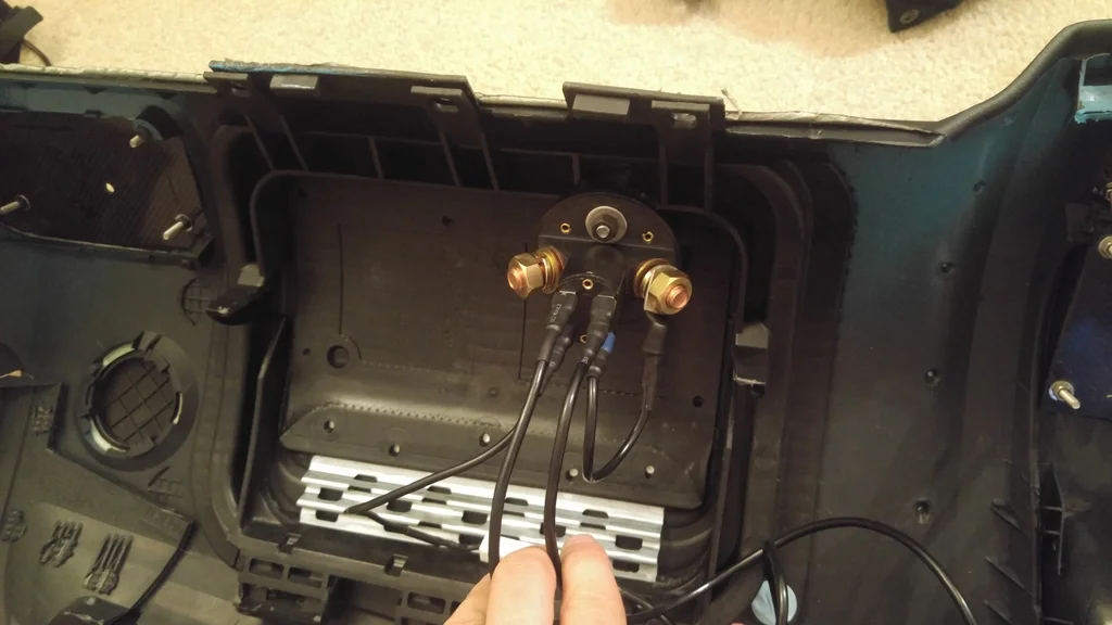

Tonight was a wiring night
Wired up the cut off switch properly. Wires will be going to ignition barrel as per fia requirements. I'm obviously not racing but I'm doing it properly.
Also playing a game of when will she notice...
Probably taking the piss a bit here haha.

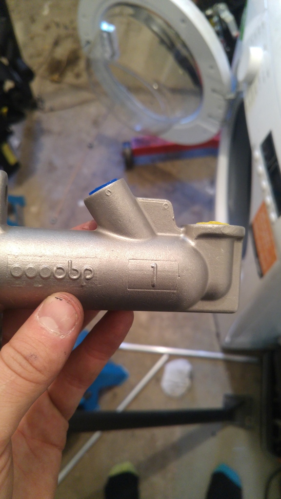

I'm going to clean up the seats as best I can as they're a bit dirty then start fitting everything back in the car. Got myself a 1" master cylinder for the brembos too. Hopefully it will remove some sponge from the fronts.

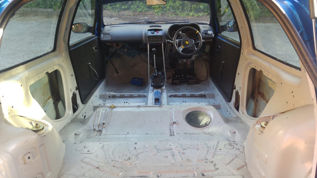

Had a really productive day on the car today. Got home from work and nailed a load of jobs that were on my list.

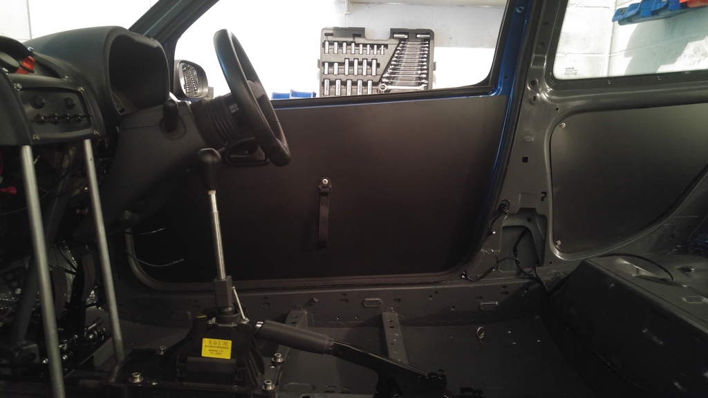

Fitted the front and rear door cards (actually this was the other night but uploading pics)

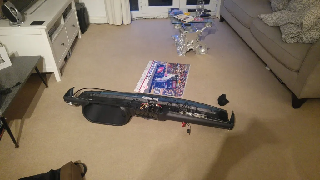

Received some more fuel hose as i think the stuff I have may be too small in ID. Also found science on my living room floor.

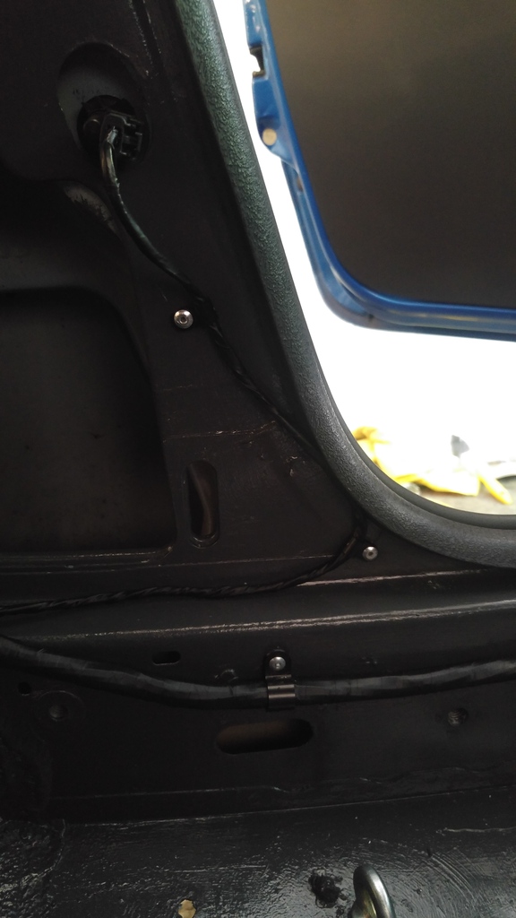

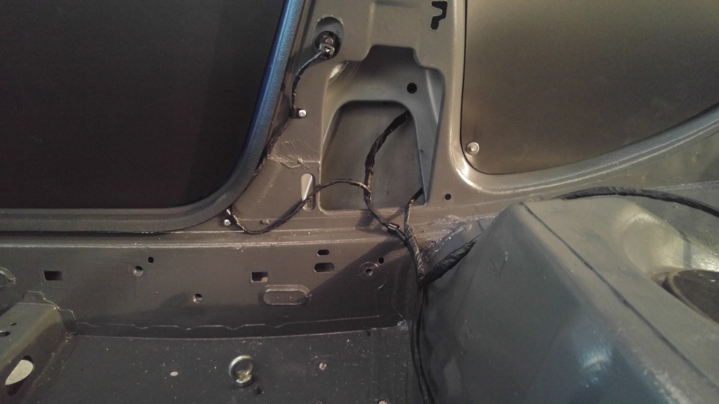

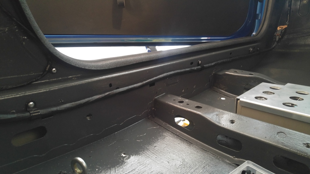

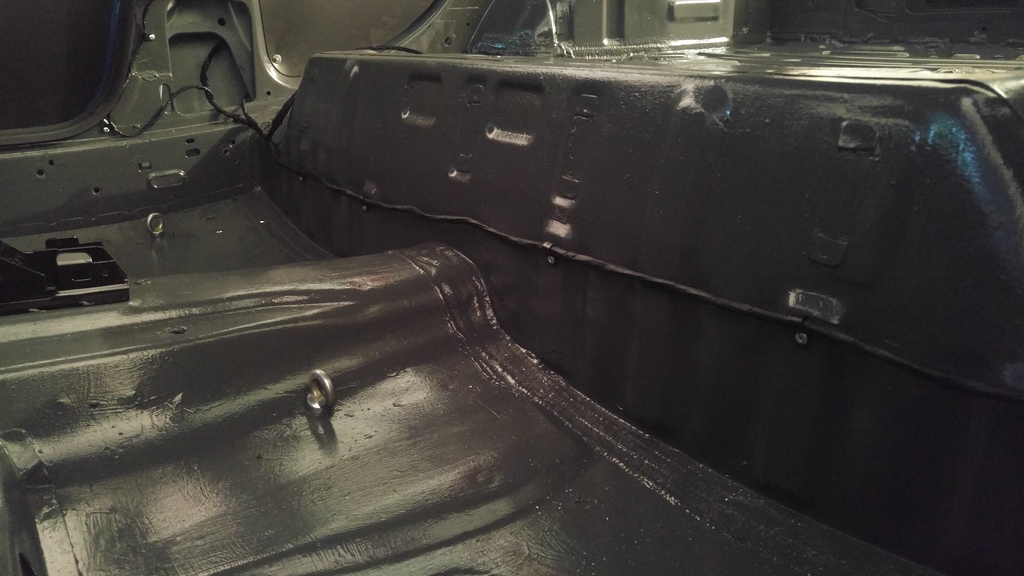

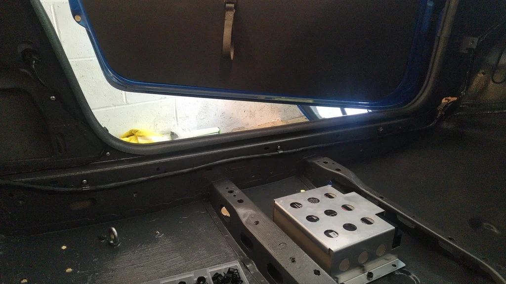

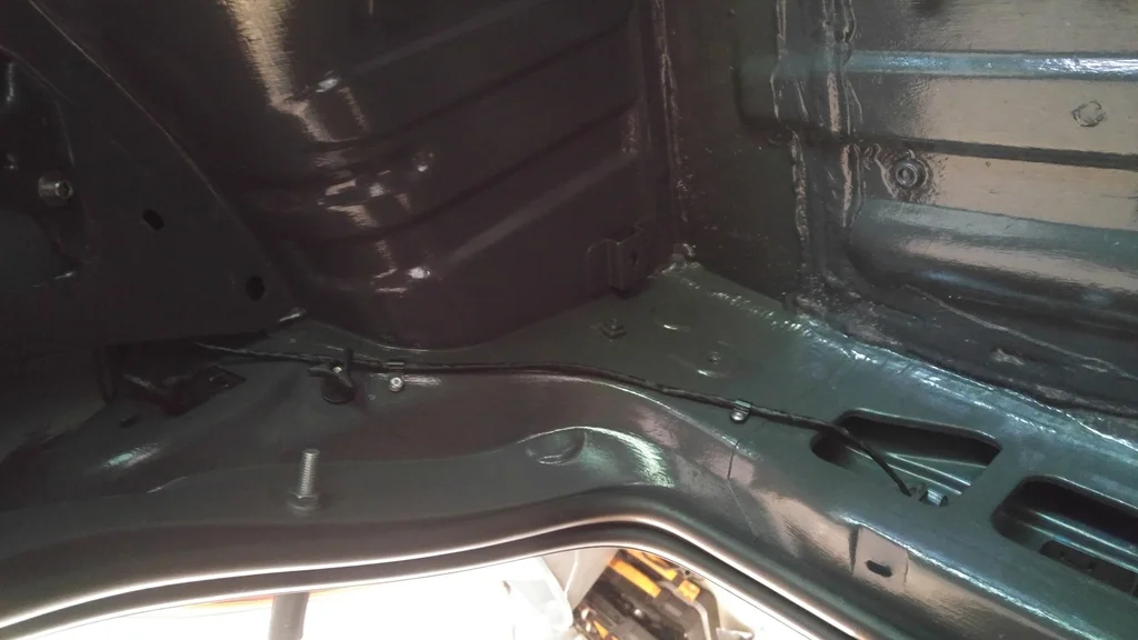

This is something i've always wanted to do. Really tidy the rear car loom with P clips and rivets as before it was a half arsed job. Off I went to make some holes!
I tidied up the door sensor loom too and P clipped that.
I then fed the rear loom through and tidied it up.
Everytime I see the colour i'm more and more happy with it
P clipped the rear number plate light too
Lower B pillar on drivers side

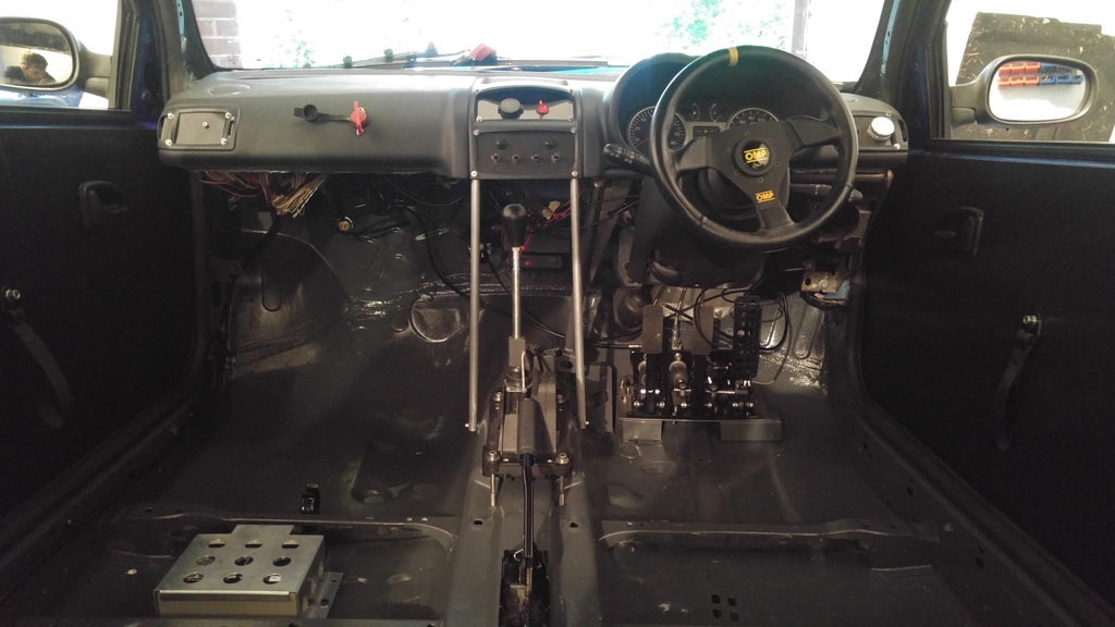

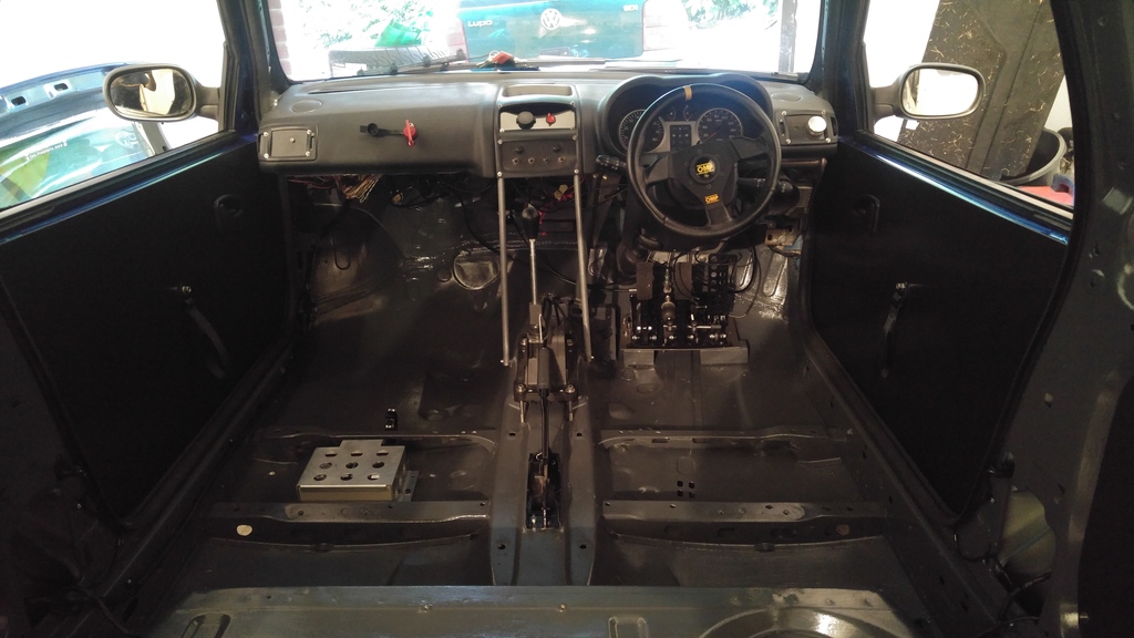

I then fitted the pedal box, with the new master cylinder. Big 1" jobby
Pedal box in

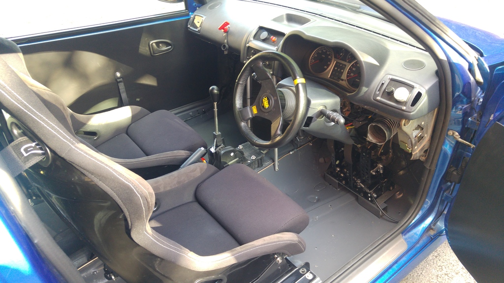

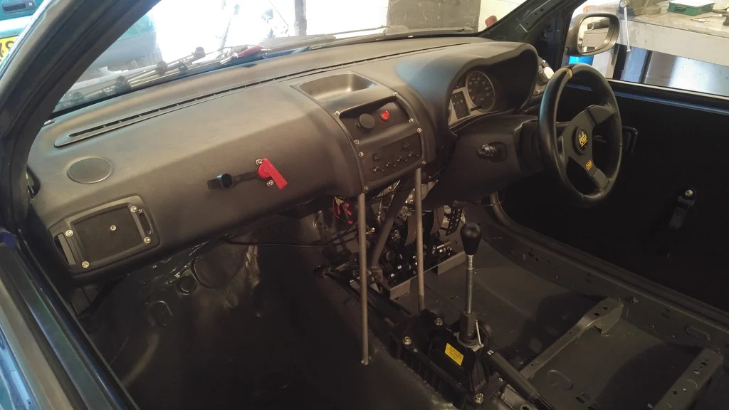

I then fitted the dash and made a start of wiring it up but was pretty happy with the progress tonight. More to follow tomorrow through the day. Final pics from tonight..
More p clip pics haha
Got to say, its looking absolutely amazing mate. That is the nicest interior I have seen.
Great work Dan
Can you reach the kill switch once you're strapped in ?
Sent from my SM-G955F using Tapatalk
I haven't tried yet but I really doubt it. I didn't really think about it for when I'm strapped in stupidly. It was originally just so I didn't have to go under my passenger seat to disconnect the battery everytime it was in the garage haha

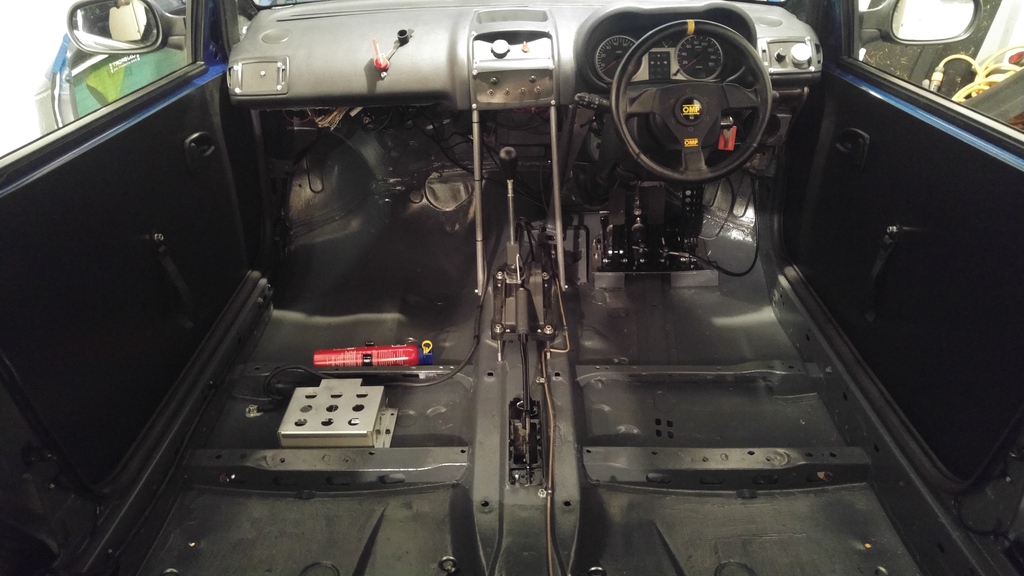

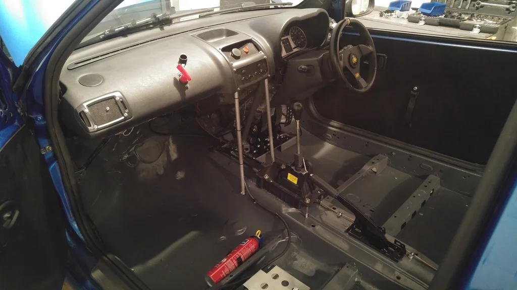

looking good Dan,
get a second clip or strong rubber band on that extinguisher clip as they tend to pop out and turn into a flying weapon of mass destruction under enthusiastic driving.
looking good Dan,
Haha thanks for the heads up my friend! I will sort that out this week.

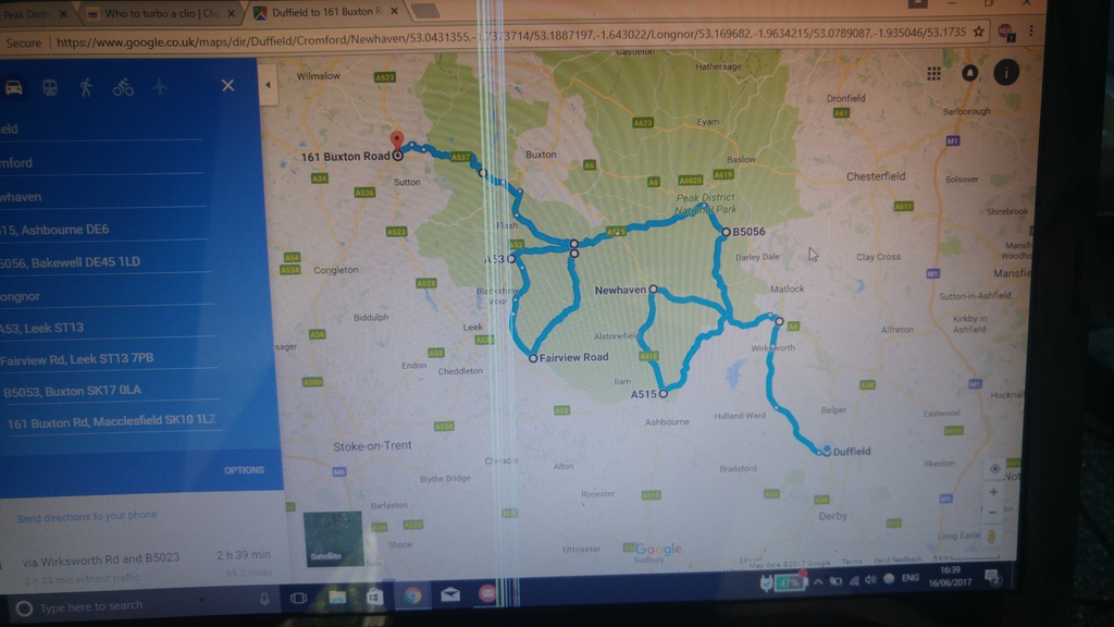

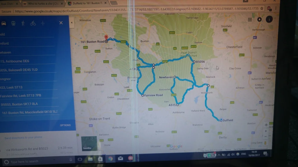

I've organised a drive around the Peaks next month with the guys I went to Wales with last year. Got my manager to show me all the decent roads around here so he kindly brought me in a map and went through with me the best roads for driving on..
I then came to this plan. 90 miles of pure epic roads finishing on the cat and fiddle. If my car isn't ready i'm just going to buy a 172/182 for this then sell after haha

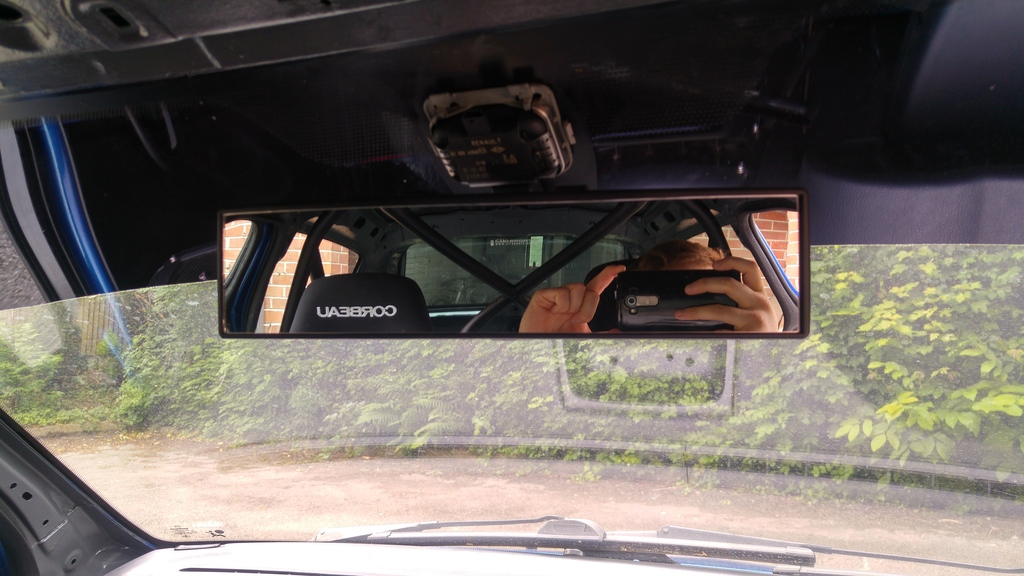

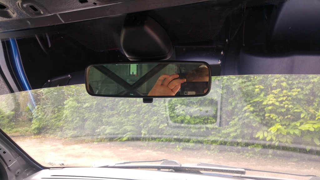

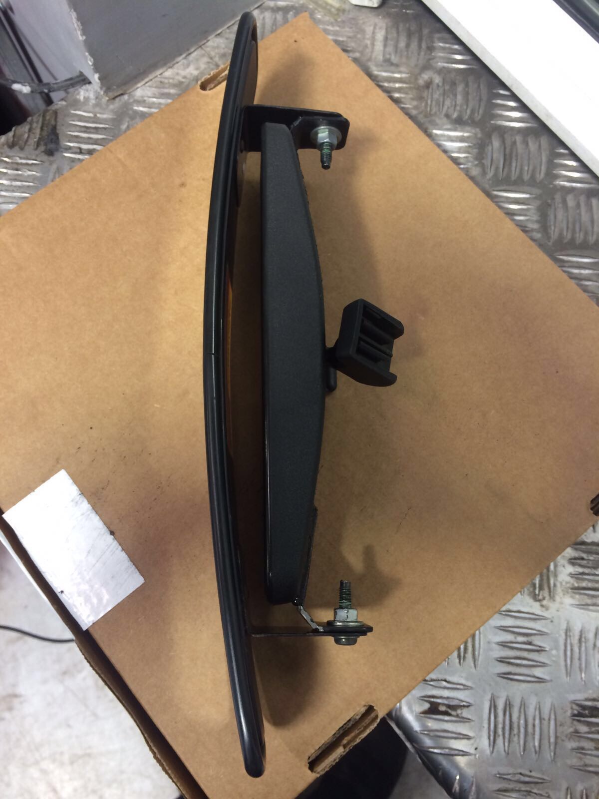

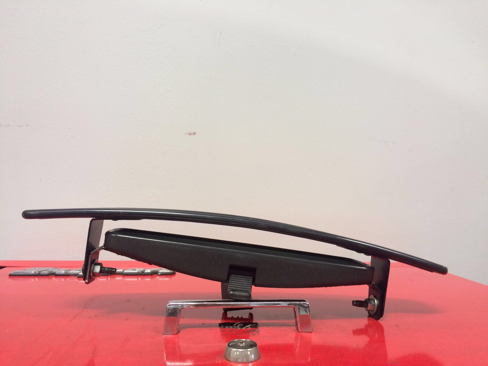

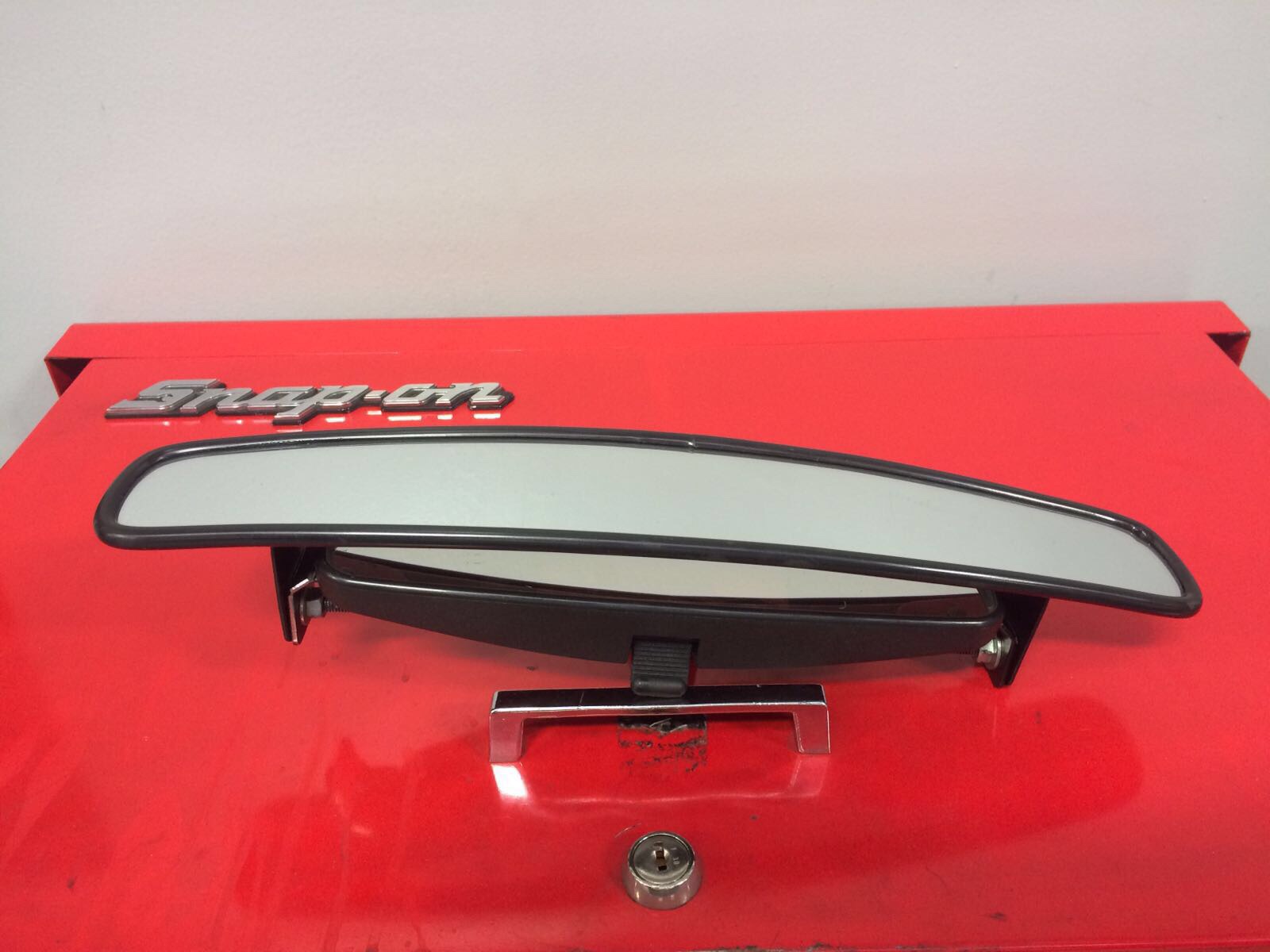

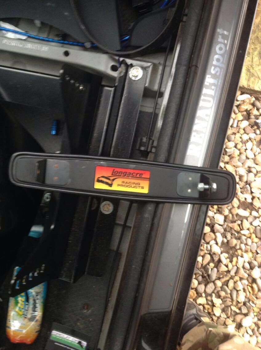

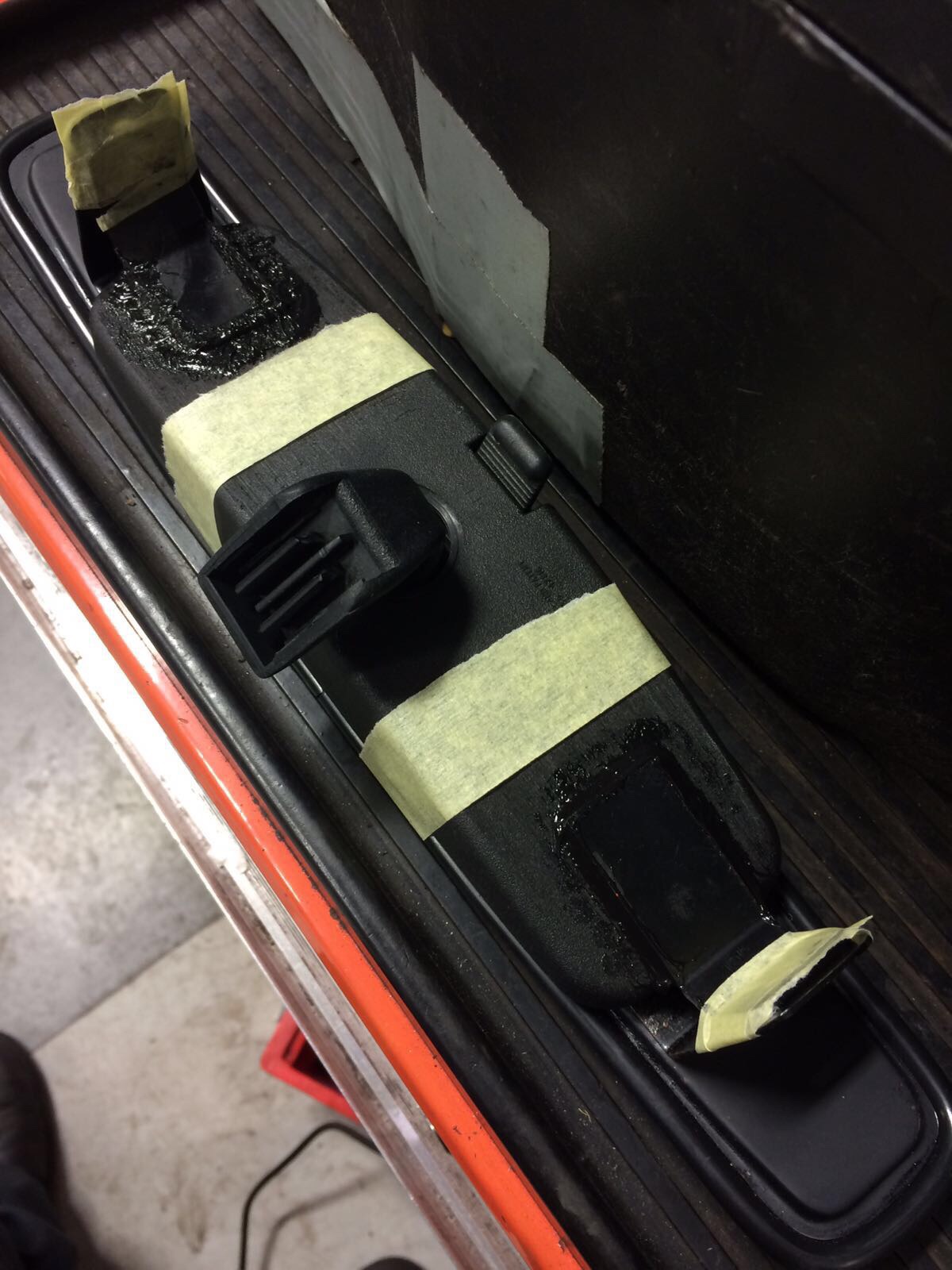

I received a new mirror after seeing @Matt555 's however I went for the cheapskate version at only £7. Seems to be okay though.
Before
After

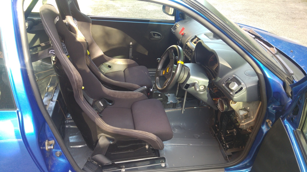

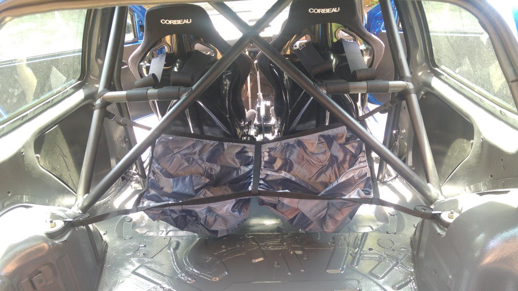

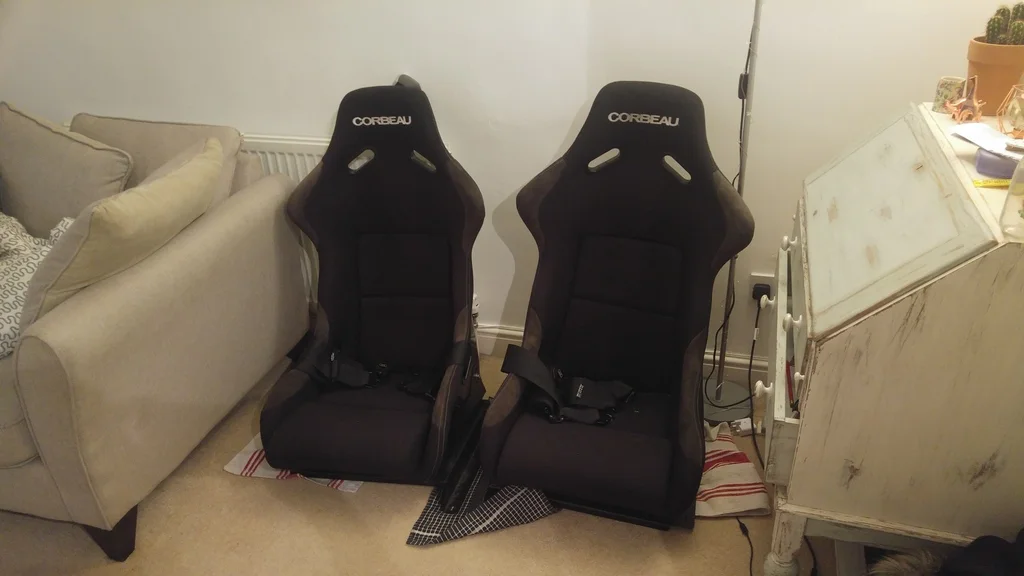

The seats and cage are now in, really happy that it's all pretty much sorted.

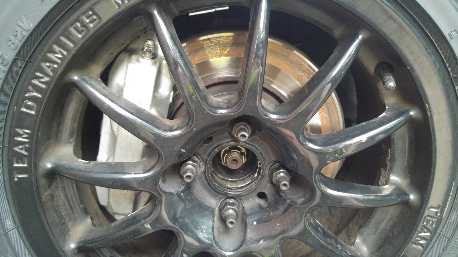

The front brakes are f**king horrendous. Like really bad. But I am running them on 3 year old discs and the original pads that came with the Megane. There is a huge huge patch of rust where they aren't touching the disc at all. That's a MASSIVE priority. So will get them sorted as I need brakes...

Have you got a link to that mirror bud? I fancy something that shows a little more in my gti
https://www.amazon.co.uk/gp/product/B00Z68I9OK/?tag=cliospnet01-21

As above, link for the mirror?0

those brakes are seriously wrong aren't they!!! were they that bad on the megane?
No they were epic on the Megane. Really bitey but these discs are from my clio and bedded in with other pads.
