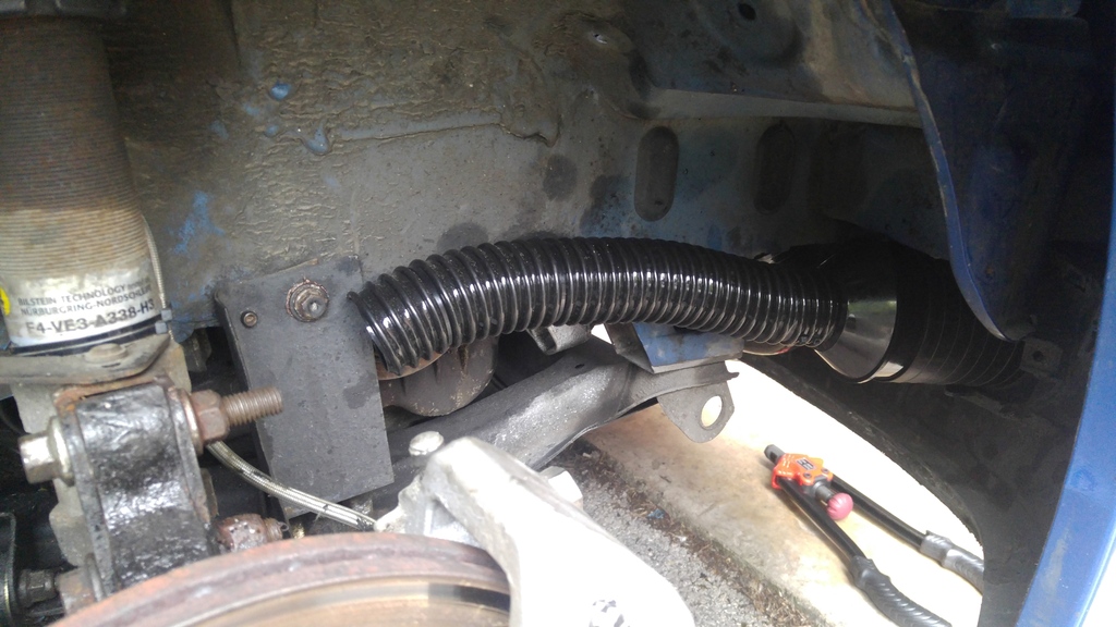

The next thing on the back of my mind was the brake cooling duct. I originally bought 100mm ducts but didn't want to run 100mm ducting purely because of the size of it. So with a 100-50mm reducer and some 50mm tubing it's all secure. I want to get a laser thermometer to see if it actually makes a difference, and consequently have a play with different sized deflector plates if it doesn't.

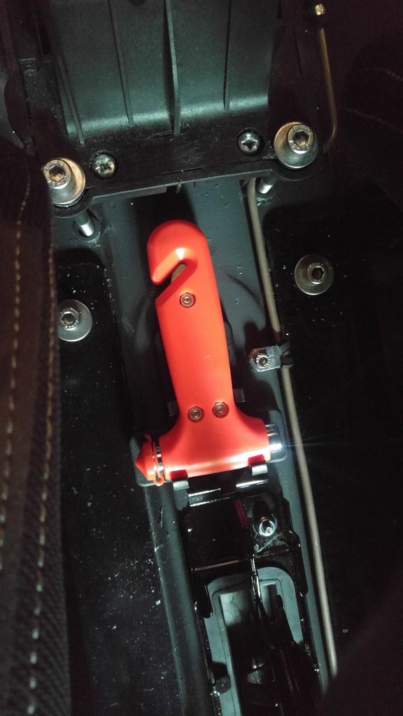

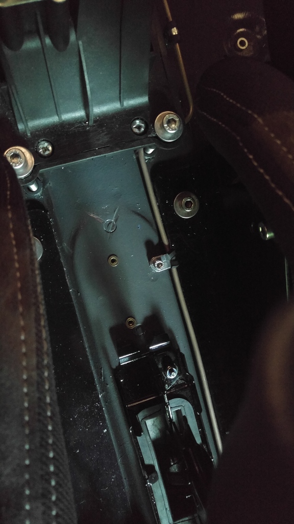

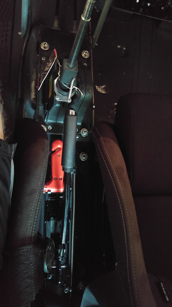

The next thing I did was install the emergency hammer and seatbelt cutter. I've opted for this place as it's very easy to reach when strapped in tight in the harnesses.

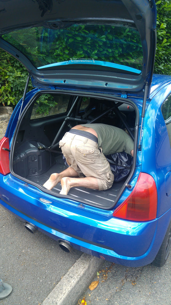

Started with my favourite invention, the riv nut

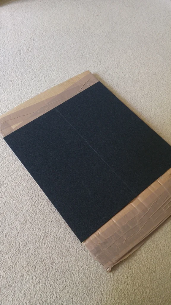

I made a better more secure false floor out of 2mm steel plate and some grip tape. It feels much better now compared to the fake carbon fibre abs plastic I had in there before.

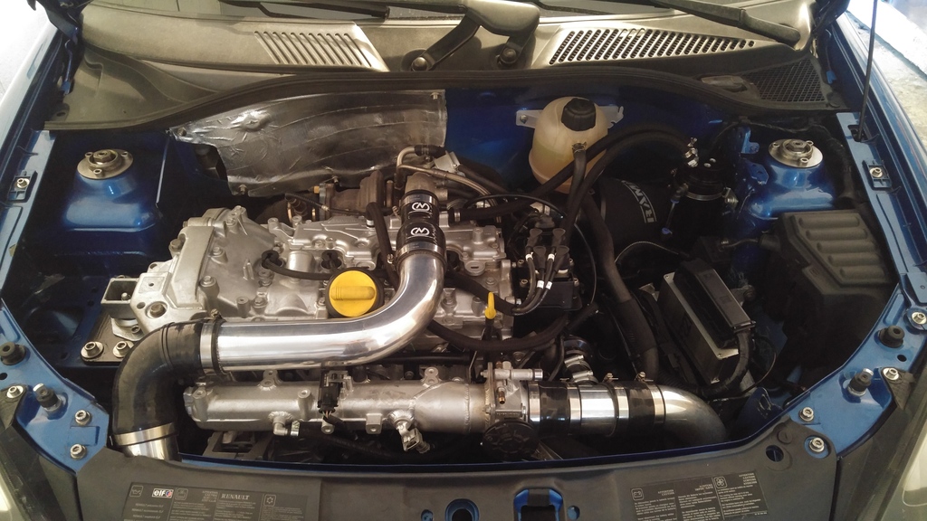

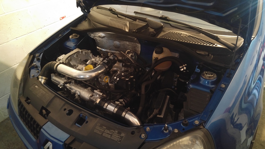

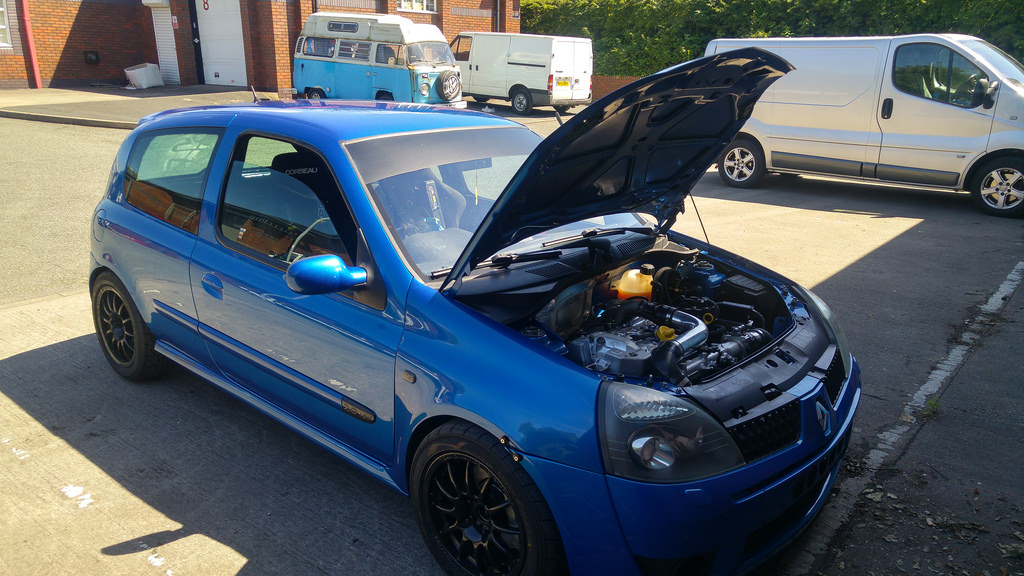

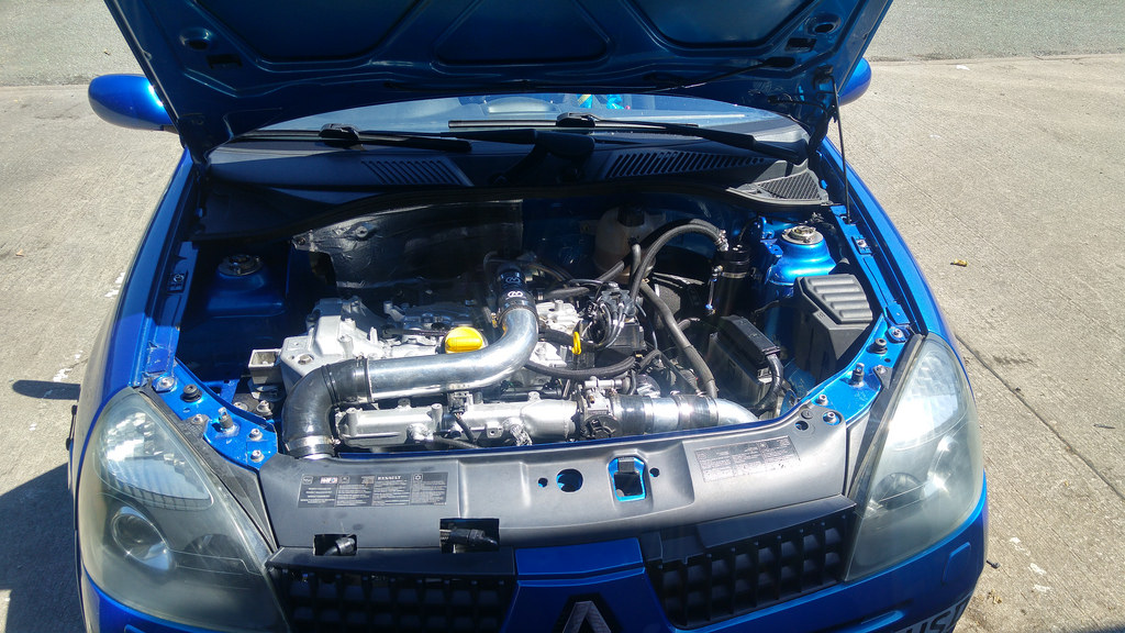

Engine bay pics now it's all finished...

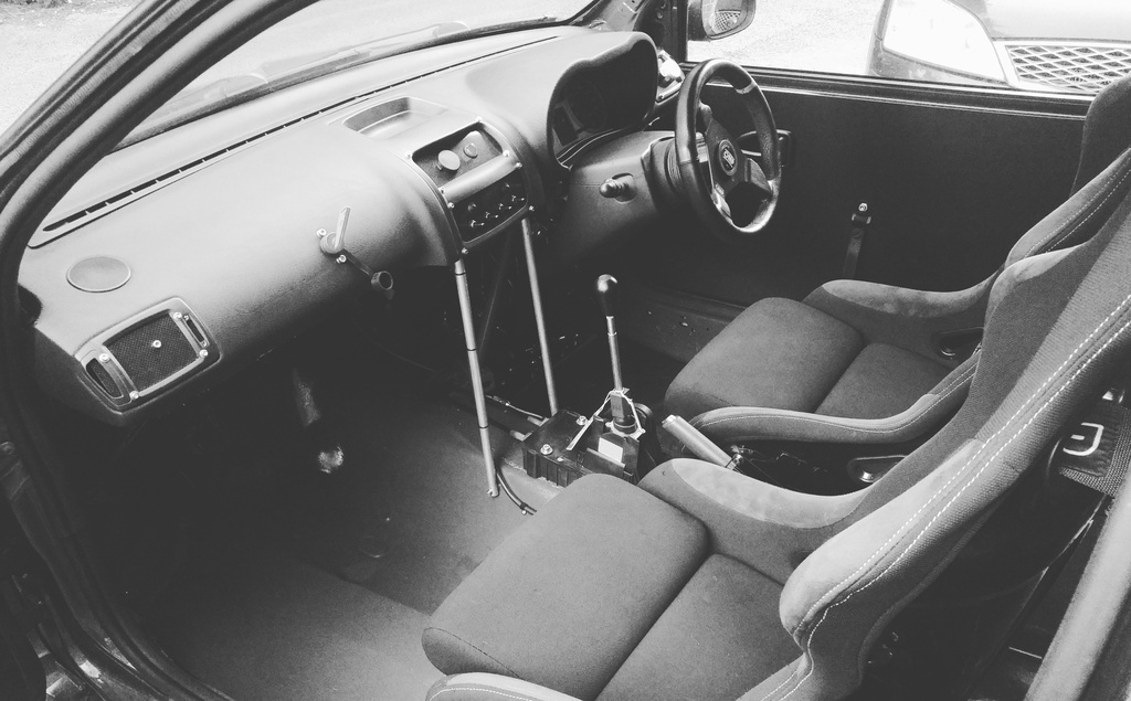

Edgy interior pic to finish

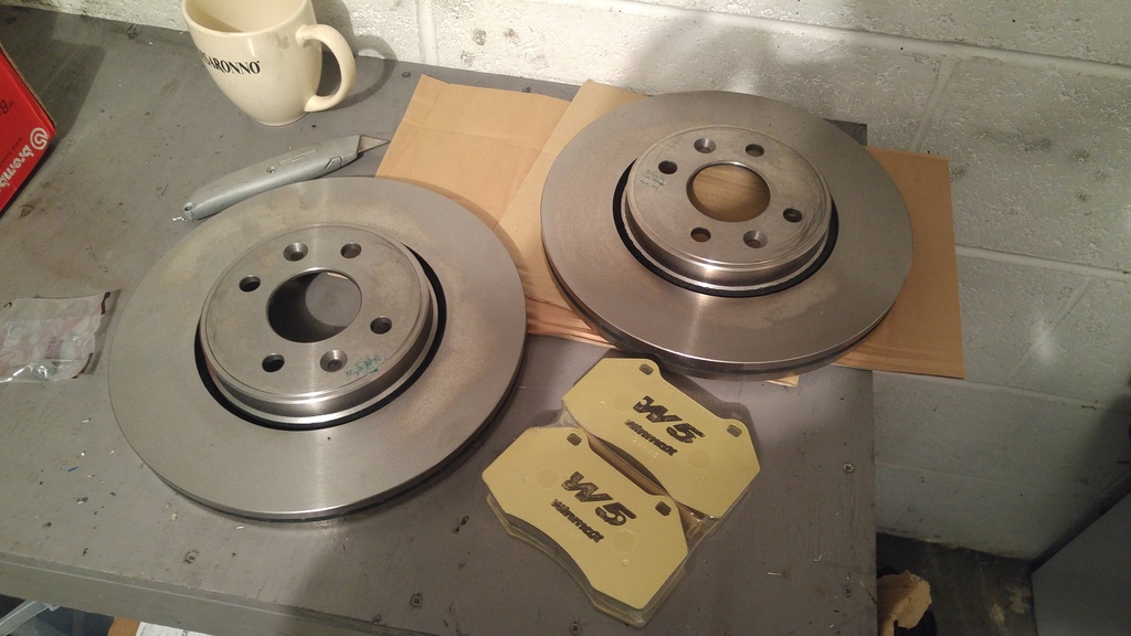

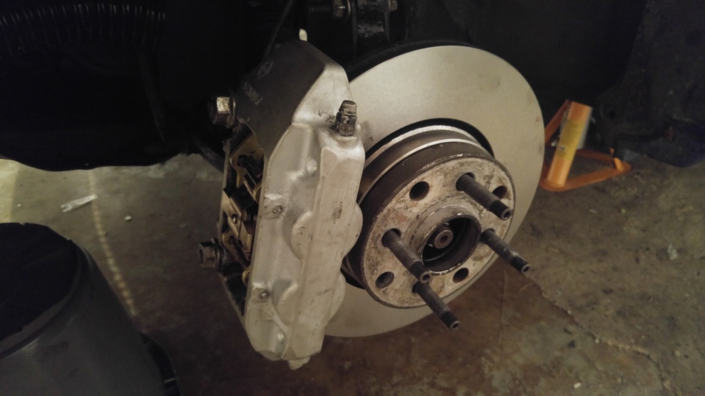

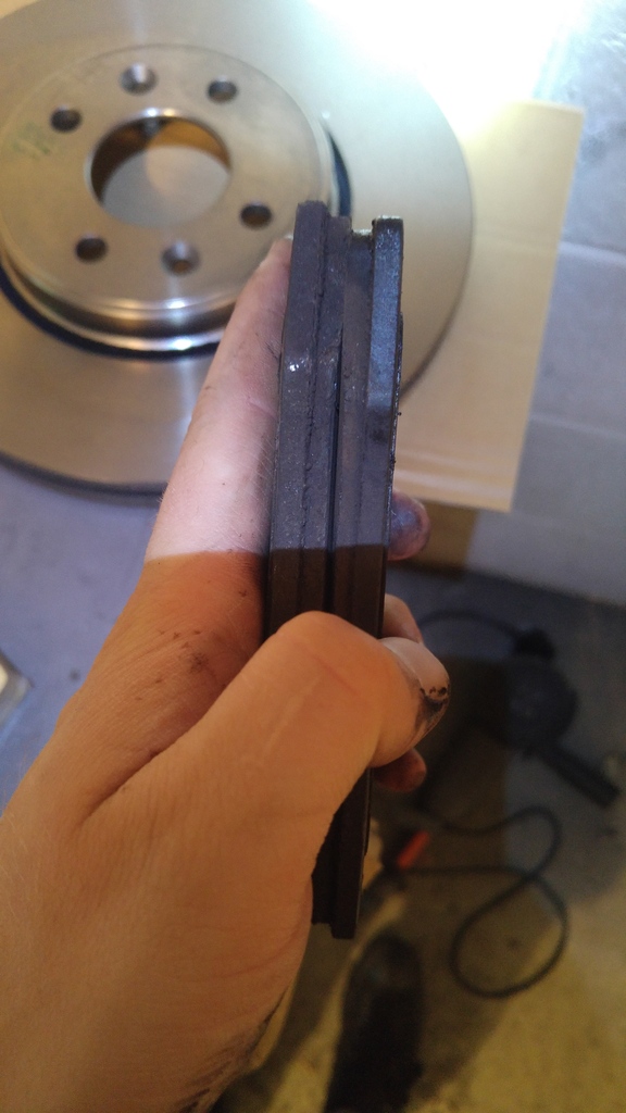

I'm buying some front discs and pads tomorrow (£250!! fml) ready for delivery in the week then fingers crossed i'm all pretty much ready for mapping mk2.

Haha you're too Yorkshire for your own good!Previous pads were dead?! There's another 20k miles in them at least :wink:

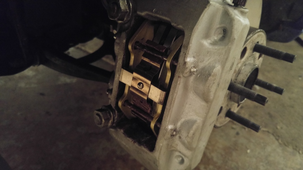

You can choose to use clio discs or Megane discs based on the adapters. I've gone for 280mm as they're mega cheap.280mm discs? Aren't they 312mm for the Brembo calipers?
Haha. Nah Meganes also fit under fine.Who's too Yorkshire now[emoji23] [emoji23].
Don't you run 15's on track? You'll need 280 discs for 15's anyway.
Main problem is you need 16 inch wheels to be able to run 300mm scenic discs. Megane discs are 5 studs anyway.Nice easy upgrade if you find you need a bigger setup down the line then. How much difference in cost is there to step up to the Meg rotors? Would be nice to just get it done while you were at it, but if there's a considerable expense then it's understandable!
Final piece to the puzzle has arrived.
Hc 280mm discs and winmax w5 brembo pads
I got them from kam racing for £200 a pair!I fancy some of these @dann2707 , where from and how much please sir .

I am going to be running the same callipers and size discs. Let me know how they feel with those pads in [emoji1303]

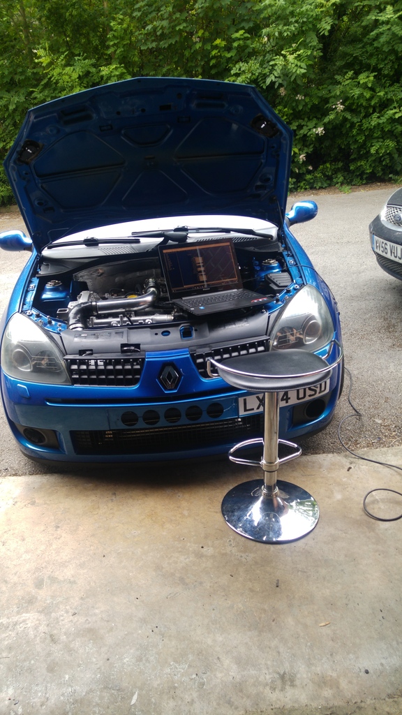

TODAY'S THE DAY ARGHGHHHHHHHHH
woken up early as I can't sleep, too nervous
Thanks mate!Good luck mate.
Cheers broski!Hope you have a more successful trip this time mate. If I wasn't stuck in the garden digging, I'd of driven up to meet you as it's not far
Good luck mate
830190153Good luck with today mate!

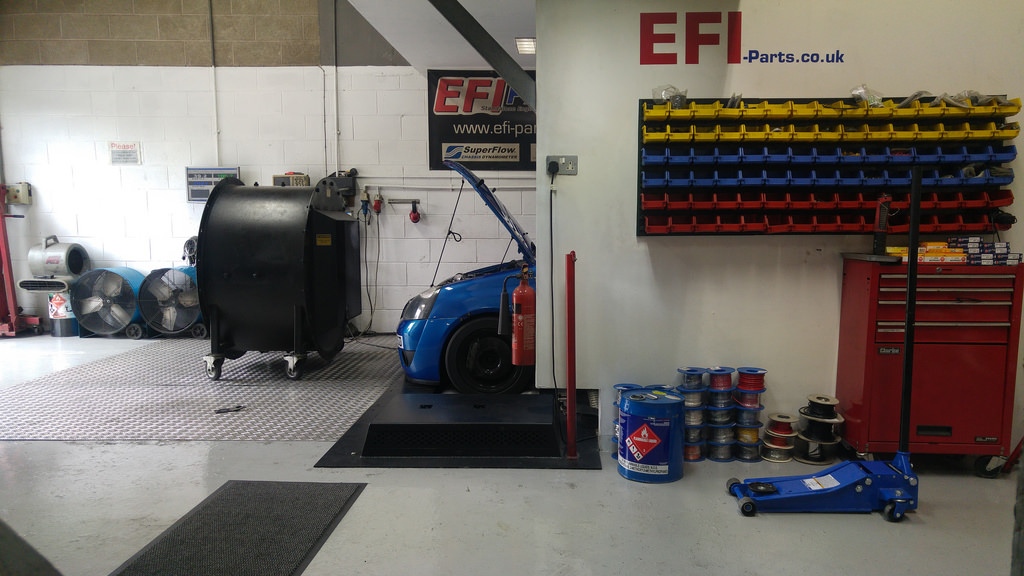

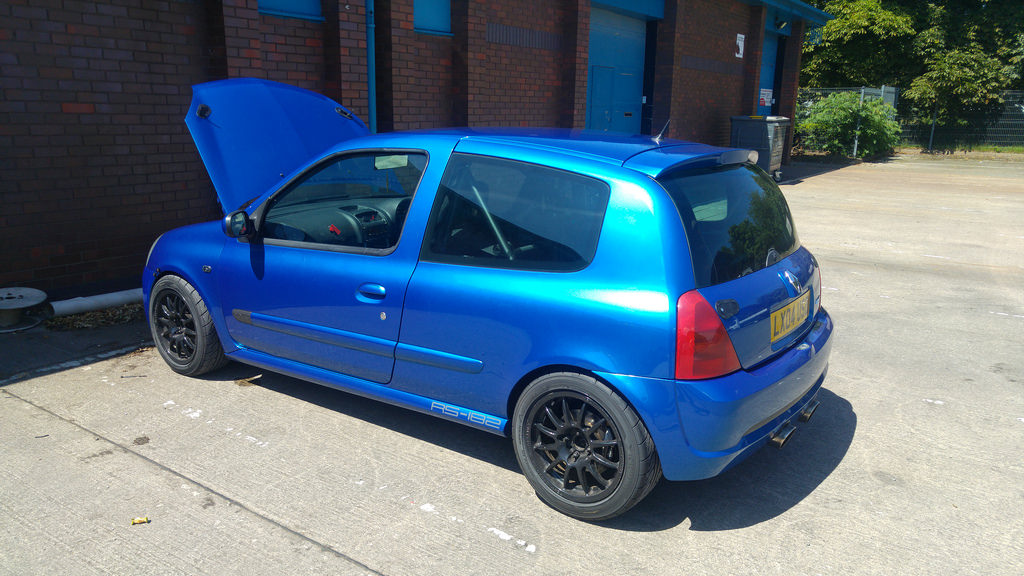

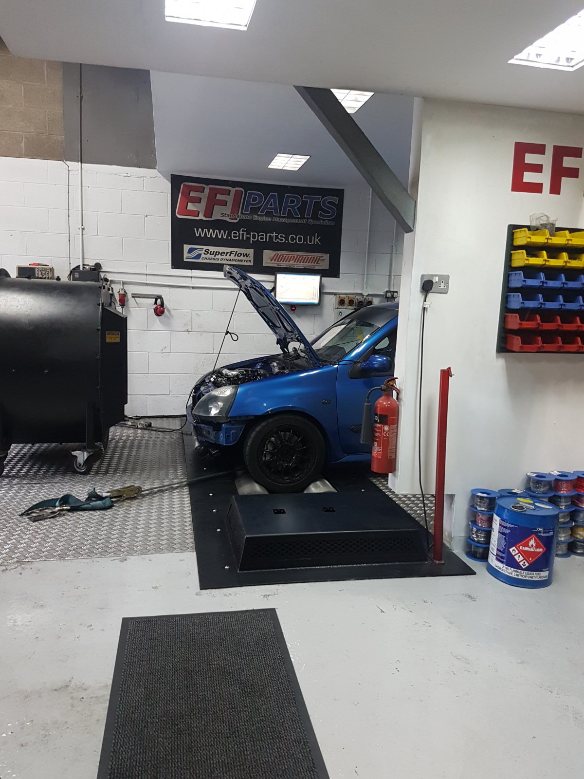

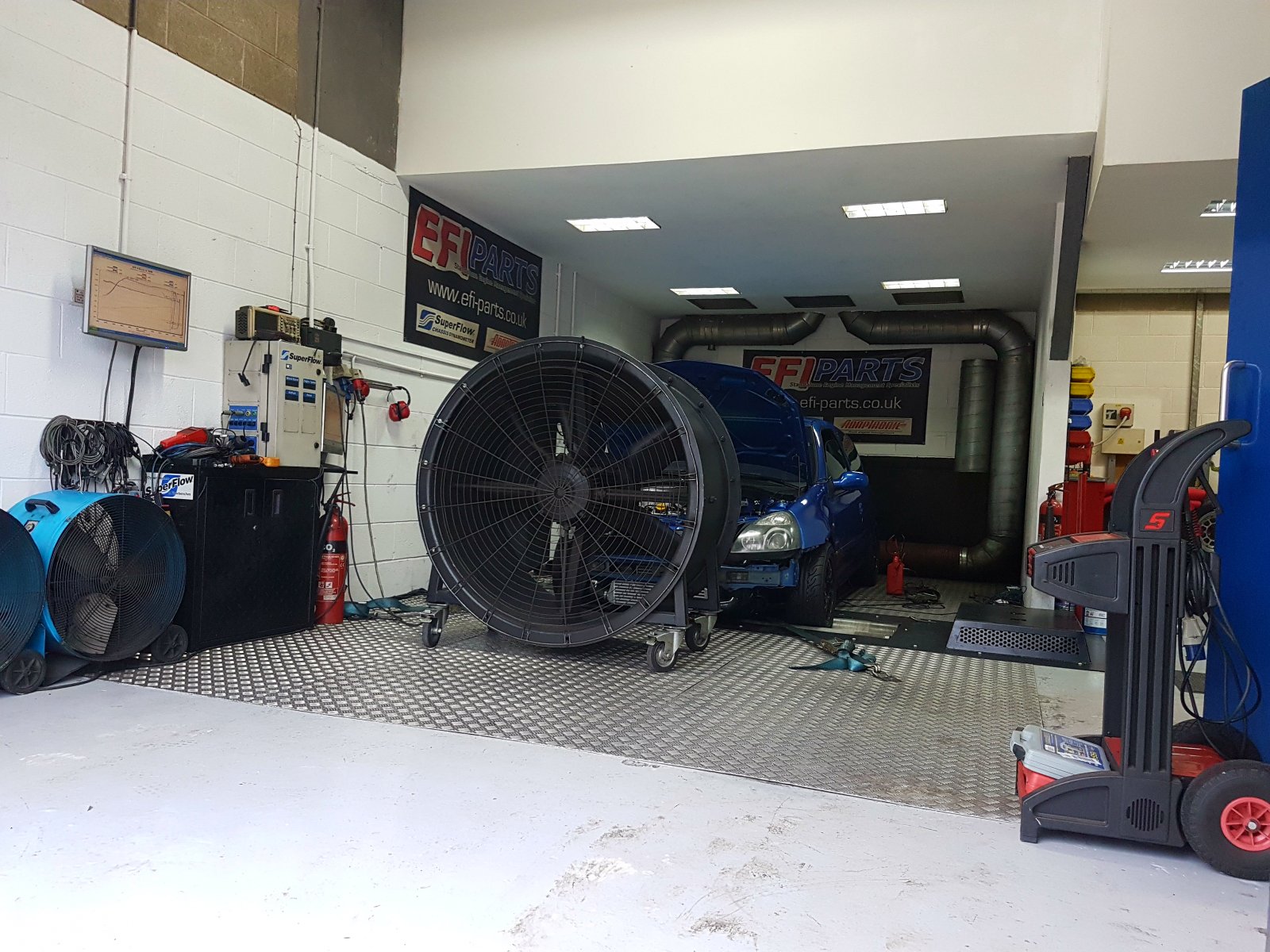

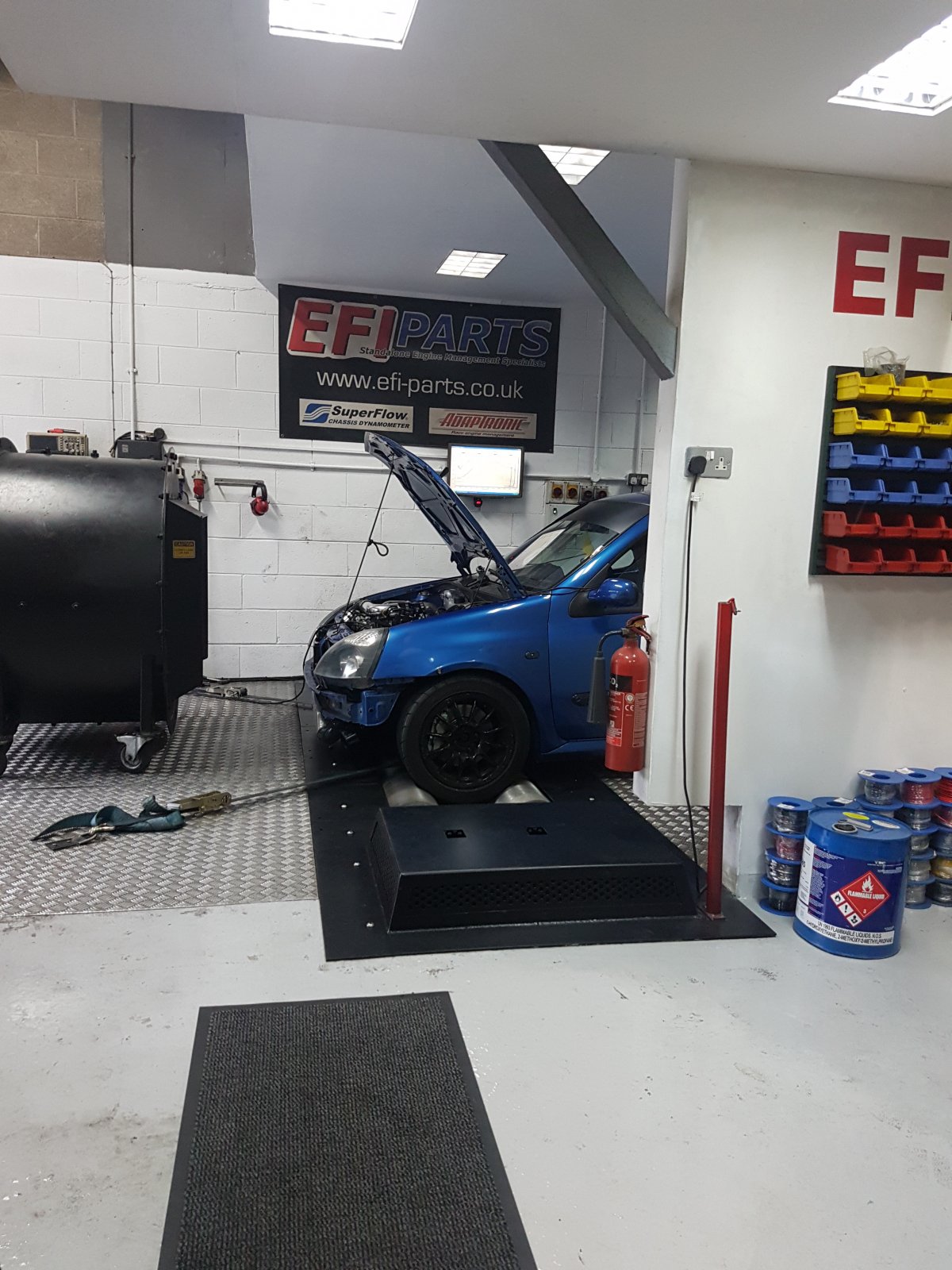

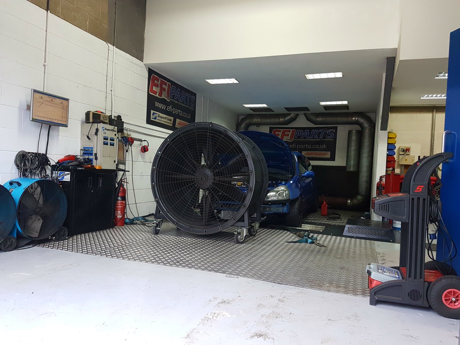

Cheers mate! And thank you very much for coming with today, it really made me feel a lot better! It was horrible being there by myself last time hahaNot going to steal Dan's thunder, I'll let him fully explain how it went today. Didn't go fully to plan but the end result is still amazing.
Car feels like a weapon, I couldn't stop smiling on the short spin we went for afterwards!

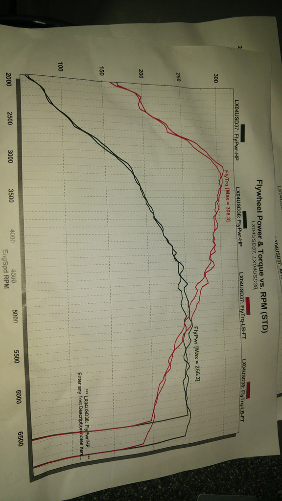

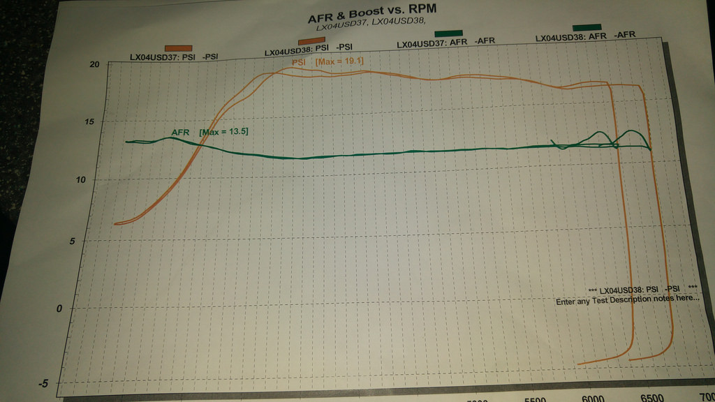

Yeah to put it in perspective Dan, my RA may have 320bhp but the torque is also 320ftlb, and I'm sure it's fair to say your Clio weighs a good deal less!

Loved seeing this today. Sound absolutely mental inside and everythings done really well, spot on mate.
Great ftlb figures mate, are the rods safe at this level?
Chris aleays try's to lower the torque on mine because of the rods.
I doubt you would really notice 15hp on the road mate but i know you and this will be bugging you until you figure out what kept the hp figures down.
Hey mate, not all bad! Do you have a pic of the graph? Quite like to see, 300ftlb must be nuts in a Clio!
Great result mate. Even if it's not the figure you were after!
Most importantly it's at a safe level, and there's no mechanical issues. you have plenty of scope to increase it once the intercooler has been rectified.
Like you said the best thing to do now is enjoy it as it is, get used to a completely different Boris.
Regardless of the power result bud you should be proud of what you've achieved, and I personally can't wait to see it in the metal at CSF!

My old Meg F1 had 256 bhp and 260ftlb and that was fast so I wouldn't be too upset at those figures in an anorexic clio! Get some shakedown miles in before hitting the track though, it'd be a shame for something simple to ruin a track day.

That graph is nuts! Chris is a legend, I swear he runs on petrol fumes, never see him eat!!
