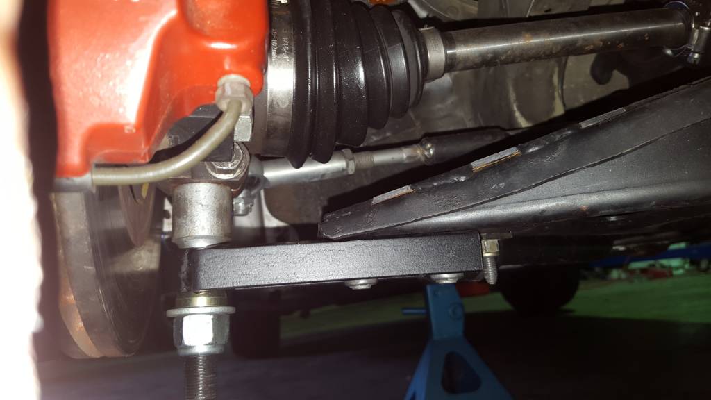

I had some drive shaft binding on mine after one of the custom shafts came back longer than expected (although not as bad as yours). My solution was to make some control arm ball joints that were longer than factory - as a bonus I got more track, roll centre correction and don't need bolts to get the camber I want!
