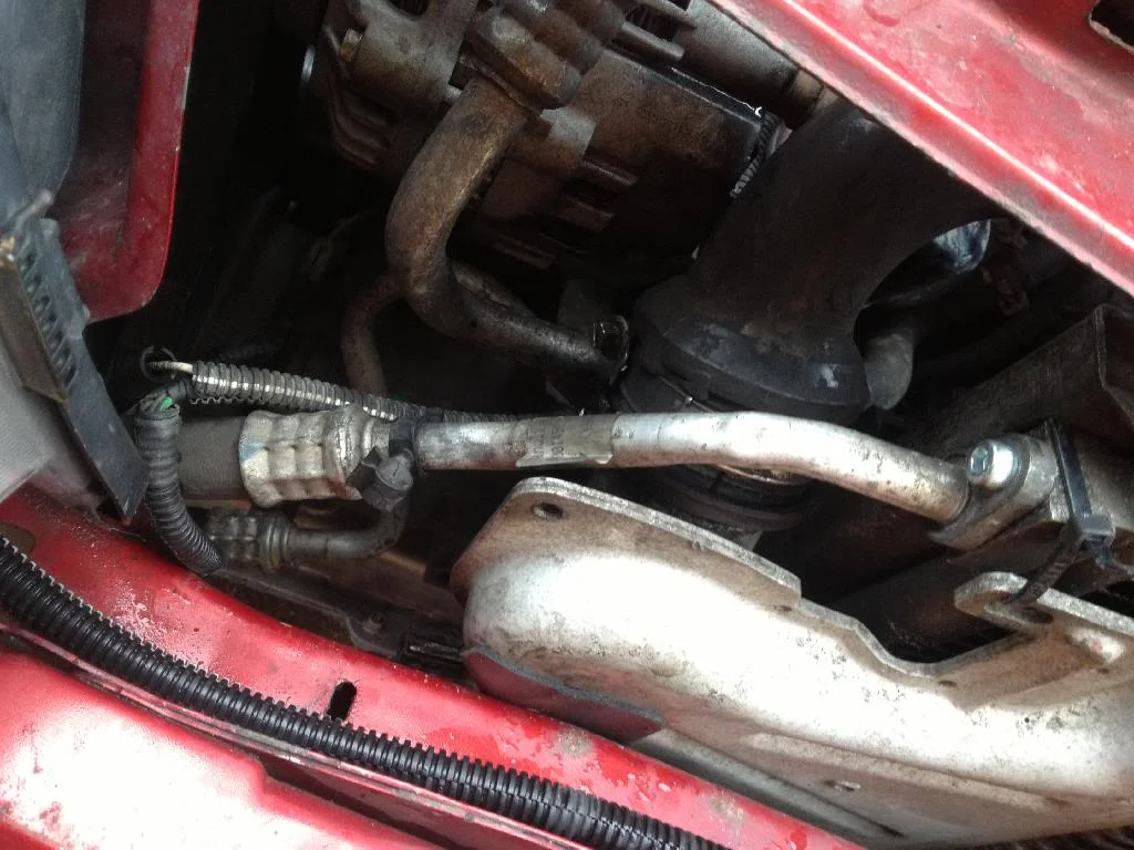

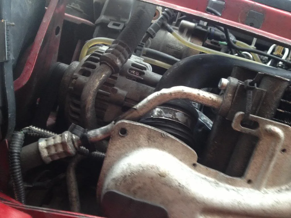

Heres how mine is bodged.
Had a look at it today while I had the front bumper off, intercooler sits too low, but thats because I need the proper brackets etc, which I think will be impossible since my AC rad is part of the coolant rad. But Anyway, I bent the top pipe really carefully, as I have a spare if it broke, so had nothing to loose!
Not ideal, but it works, Plan to change the intercooler sooner rather than later too as its devloped a leak I've noticed!
Hope this helps anyway.
