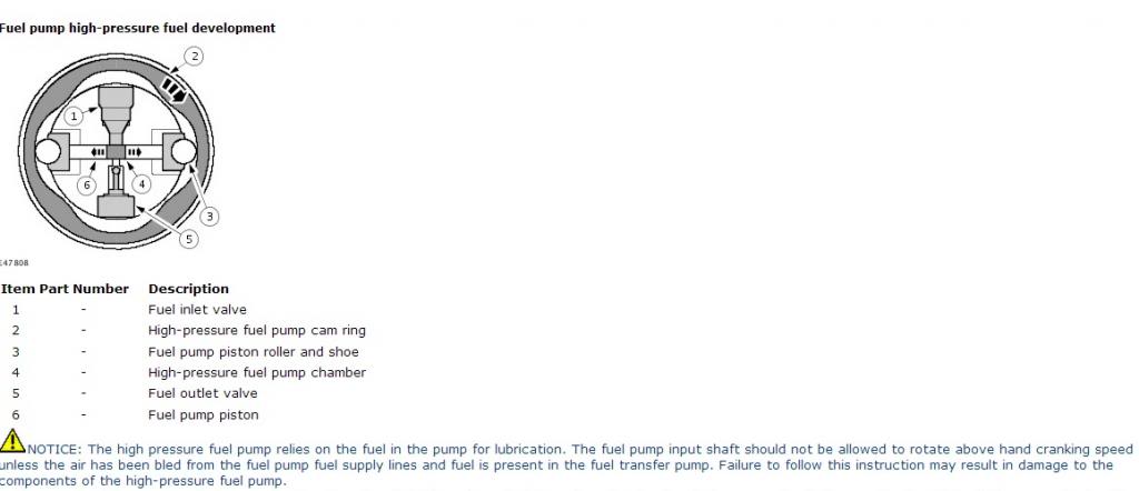

HP pumps are really simple inside aren't they, crazy to think them tiny little pistons make 2000 + bar at times.

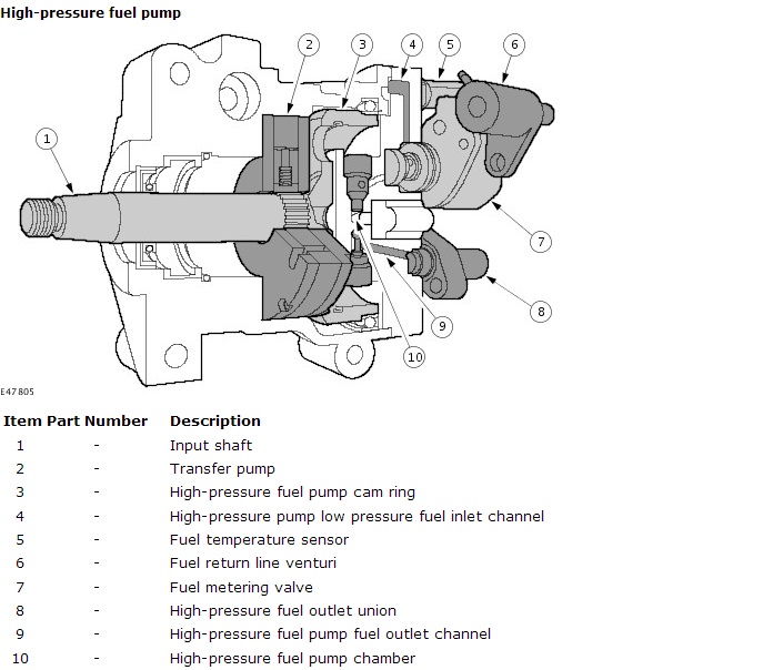

Wow, that's great news mate! I have bought a 2.0 pump and what i've come to so far i think swapping the internals will be easy as f**k.
So 1 old 1.5 dci pump and a good used 2.0 tdci pump will give you a pump which never needs altering anymore!
My guess is the tiny little pistons which are 5,5mm in the dci would probably be bigger in the other pumps.
2 interesting images of the pump:
Pump detail
