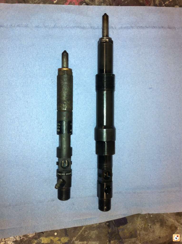

bob had to put washer/shims in the injectors. Unless he was doing someone else's injectors by accident lol.
yeah Im looking at the nozzles but we the electrode thing with the correct pin pattern for the nozzles
Dr HMS Derv Destroyer
  MK1DTi/vivaro/corsa
Erm yeah, mk2 120ps Mondeo injectors are massive in length not width.
  R5 gtt, R27 F1 team
Hhhmmm, if i see it correct the nozzle is longer! What code off injector do you have as there's supposed to be 2 different nozzle lengths.
wonder if it fits fysically and icw the valve though!
  R5 gtt, R27 F1 team
looks like you have one of the 3xxz series and not 5xxz, by comparing on ebay it looks like the 3's have the long nozzle....
