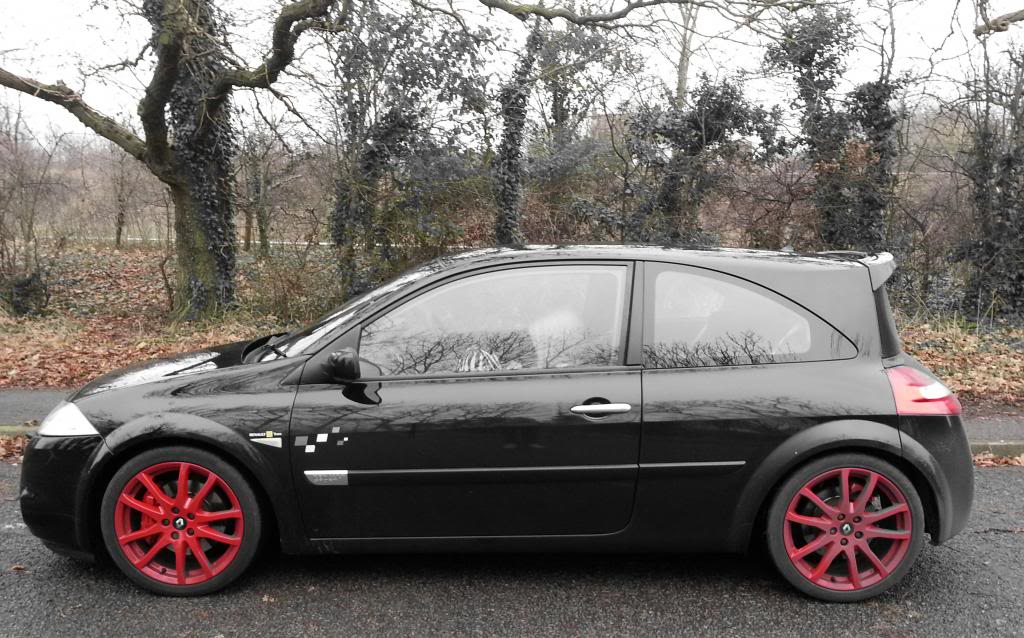

Deep Black R26 Project.
  E46 M3 + Ph1 172
Just written this up for another forum, so may aswell paste it in here :)

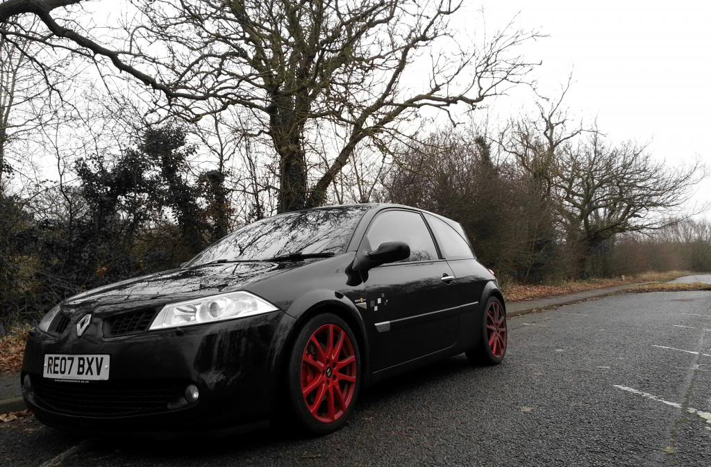

Day I got it.

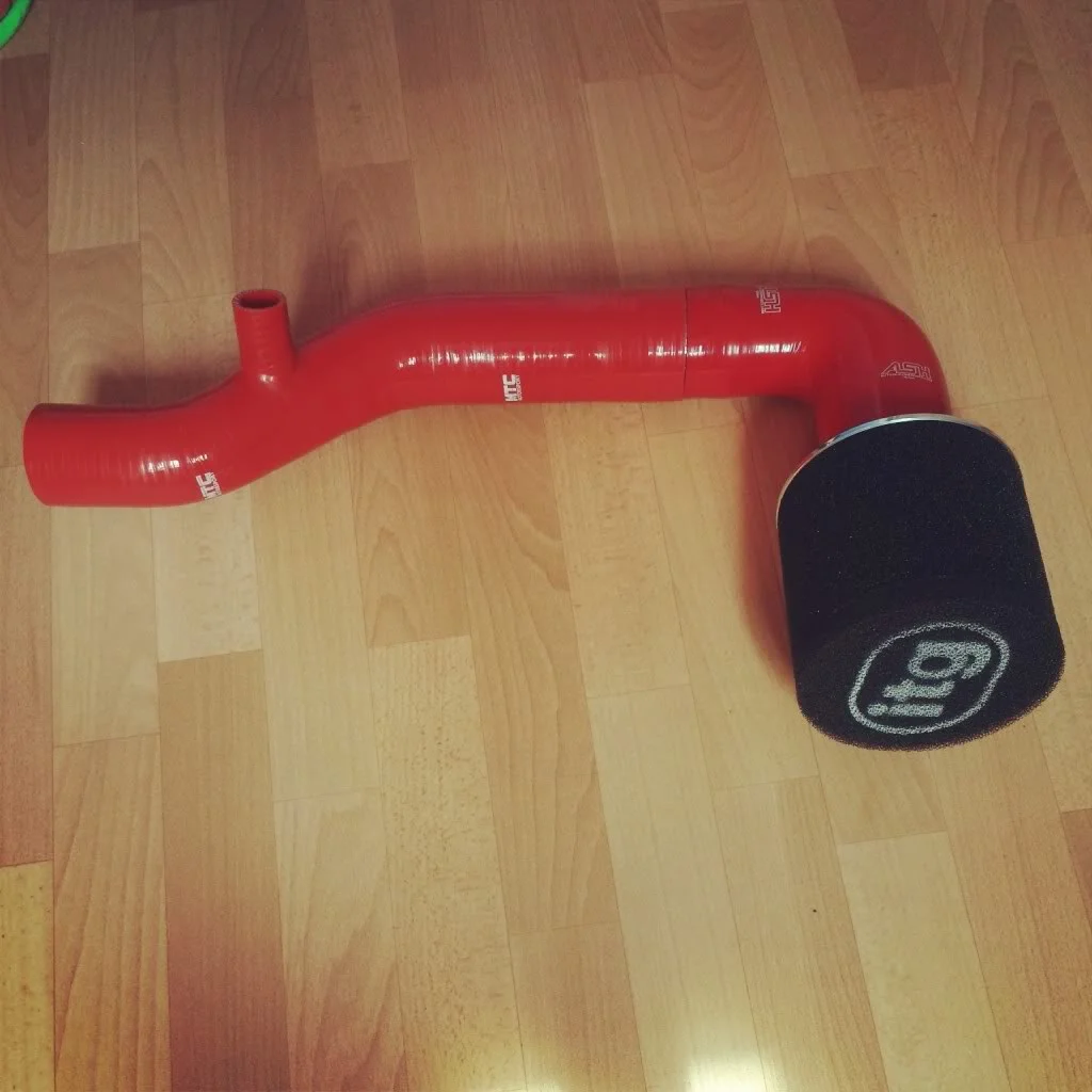

Airbox mod with ITG

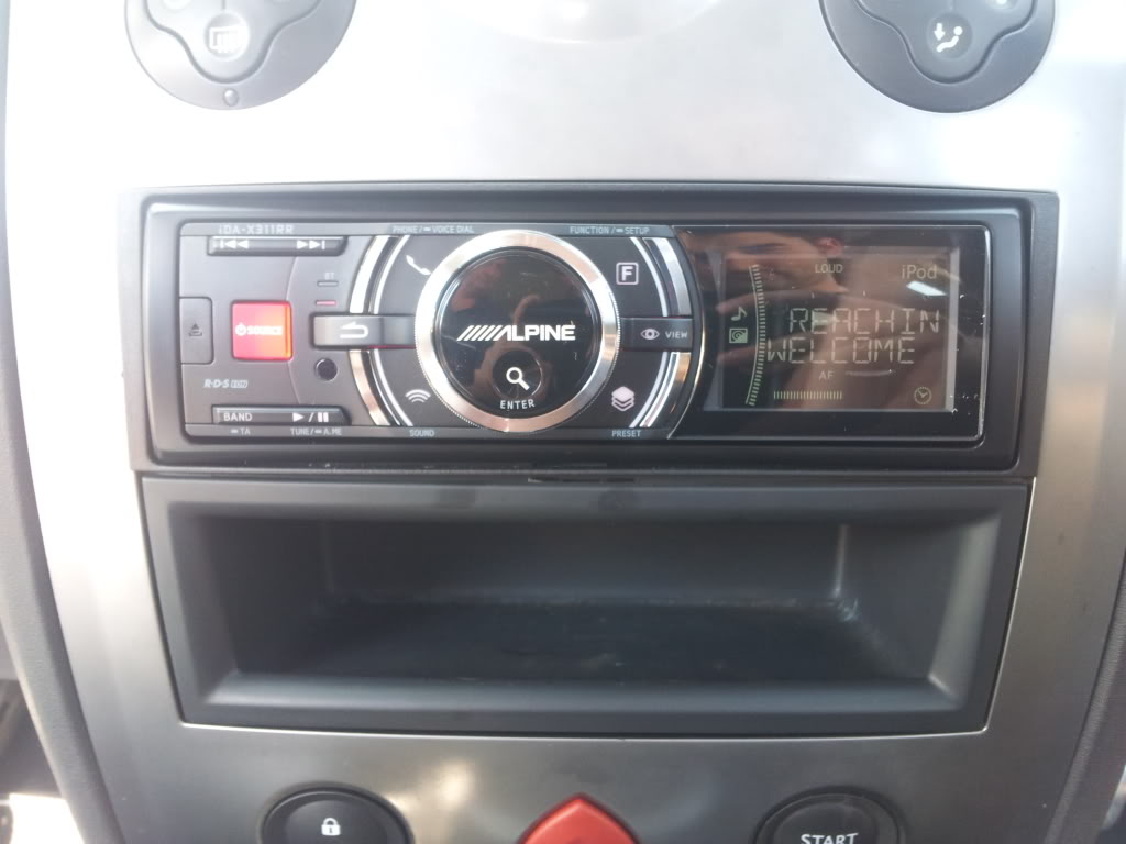

New headunit

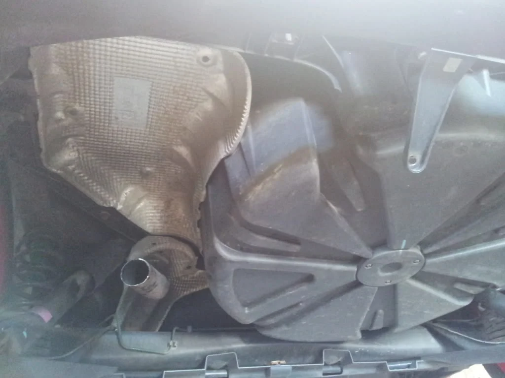

Backbox chopped
.R wheels
Proper wash and machine polish

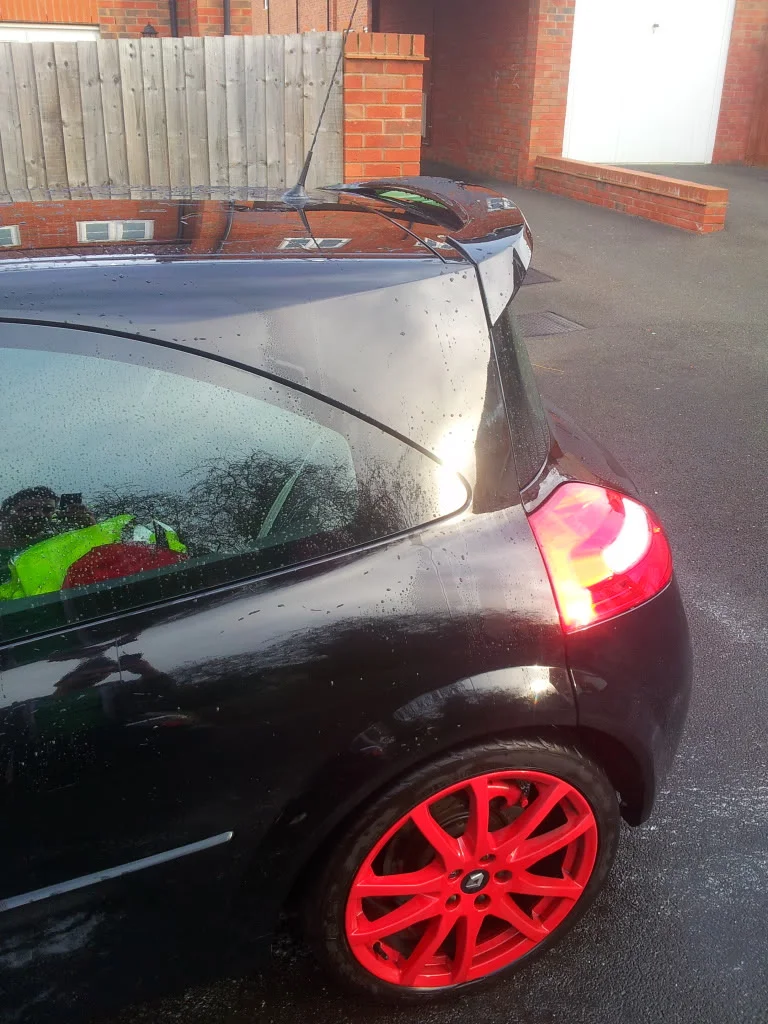

.R spoiler
Cooksport springs and 36k service by Mr Black

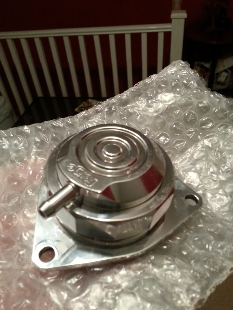

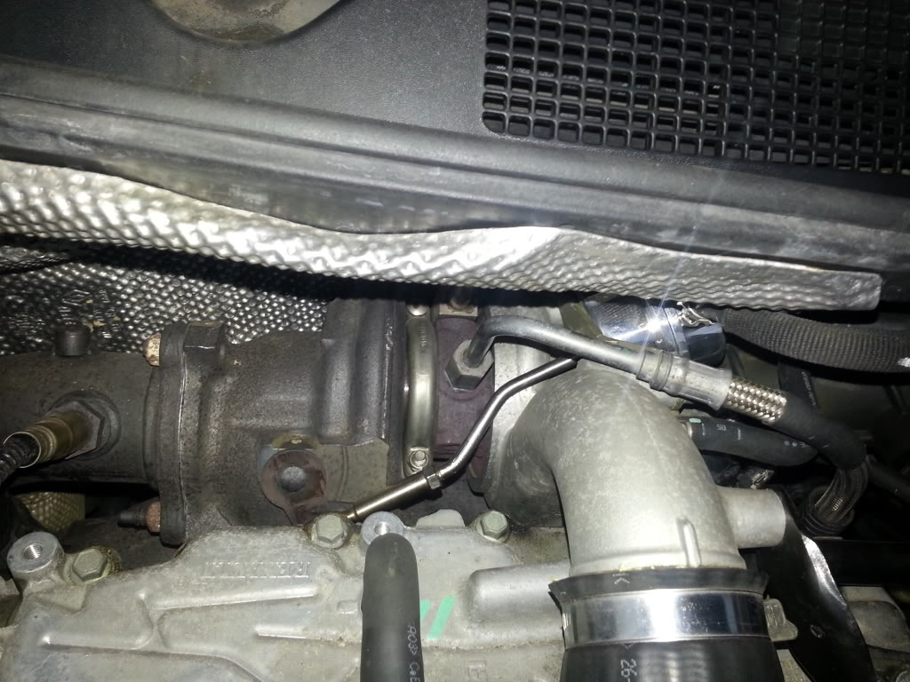

Actuator and Recirc

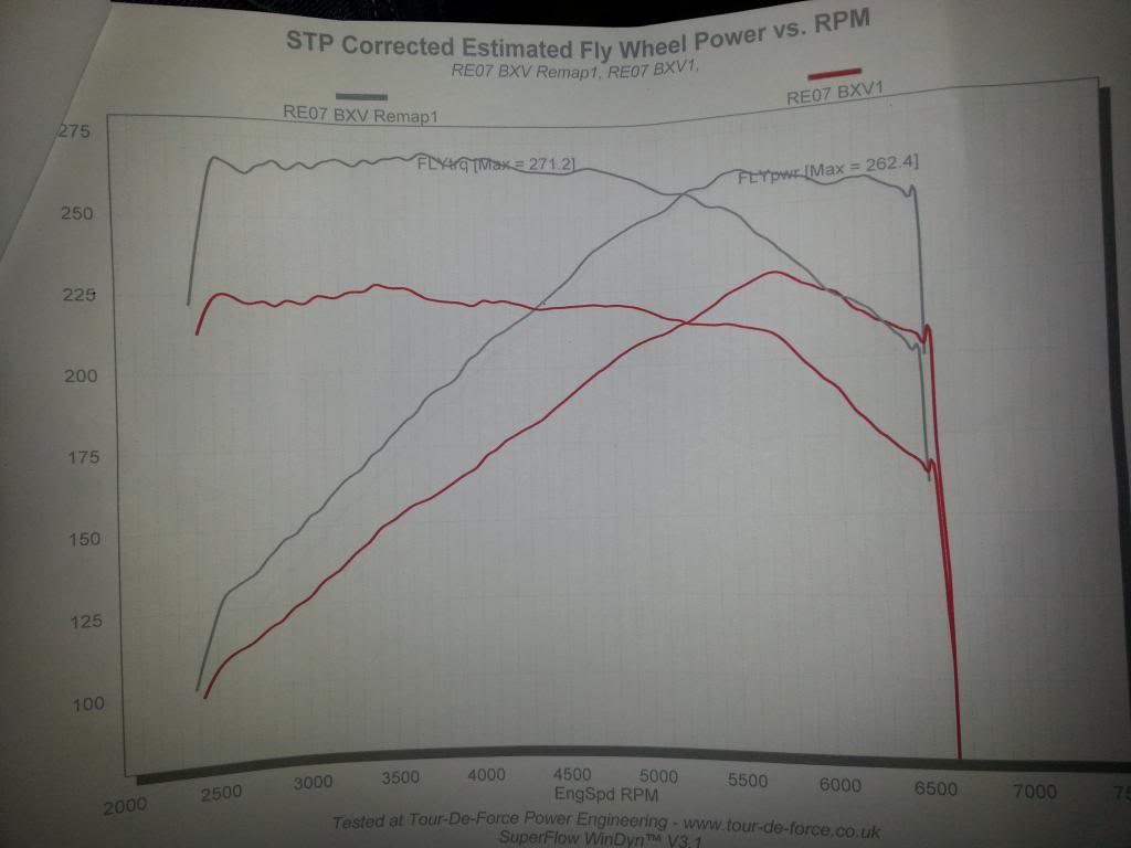

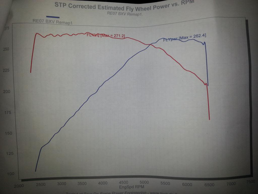

Stage 1
  E46 M3 + Ph1 172

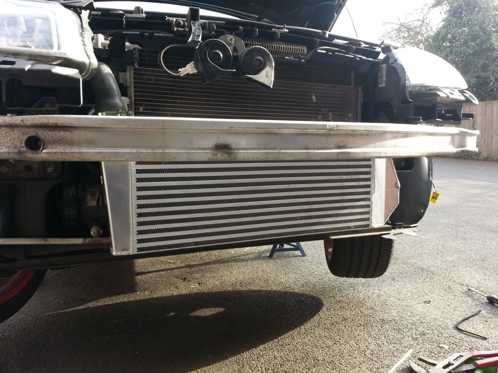

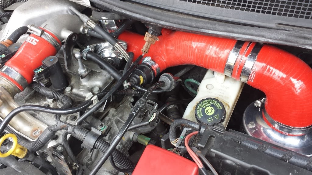

​Intercooler fitted
ITG kit fitted

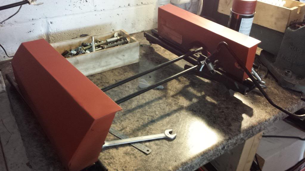

Lowered subframes fitted

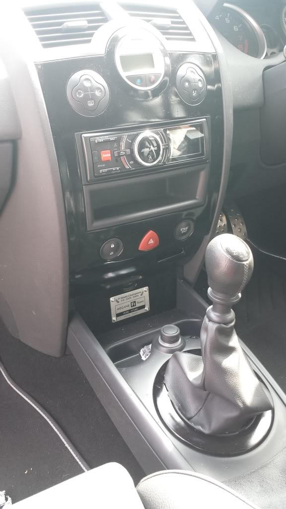

Console sprayed black

Never heard a midbox chop so cant comment on the noise, but its alot easier chop than the backbox, due to not needing any hangers making, and the pipe is straight...
If you chop the midbox, you wont have any whistle noise, which I lovee...
I never noticed any difference with the recirc valve, only fitted as I got it very cheap, it doesnt give the flutter like you hear in my video unless you have the ITG kit (not filter)
However the itg panel filter and blanking plate does flutter...
  E46 M3 + Ph1 172
Really, mine has a yellow spring, and only did it when the engine was cold with the standard airbox..
Am I right in thinking your have stage 2, and a hybrid?
If you stick a blue spring in, itll flutter more
  225 Cup & Williams
