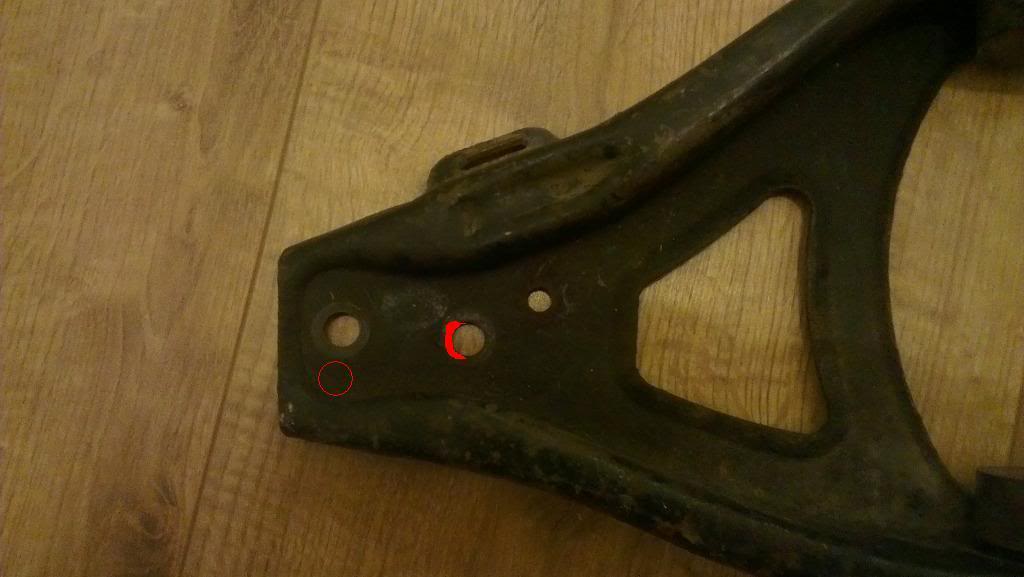

This is that I am going to try out.
Outer hold slightly further out and moved further forward, inner hole I will just slot by a couple of mm to allow the bolt to still go through.
Hang on..... Wouldnt that be the wrong way for more castor? Shouldnt the new hole be above the existing outer hole?
Nope, bracket for the ARB is at the back of the wishbone so that is correct.

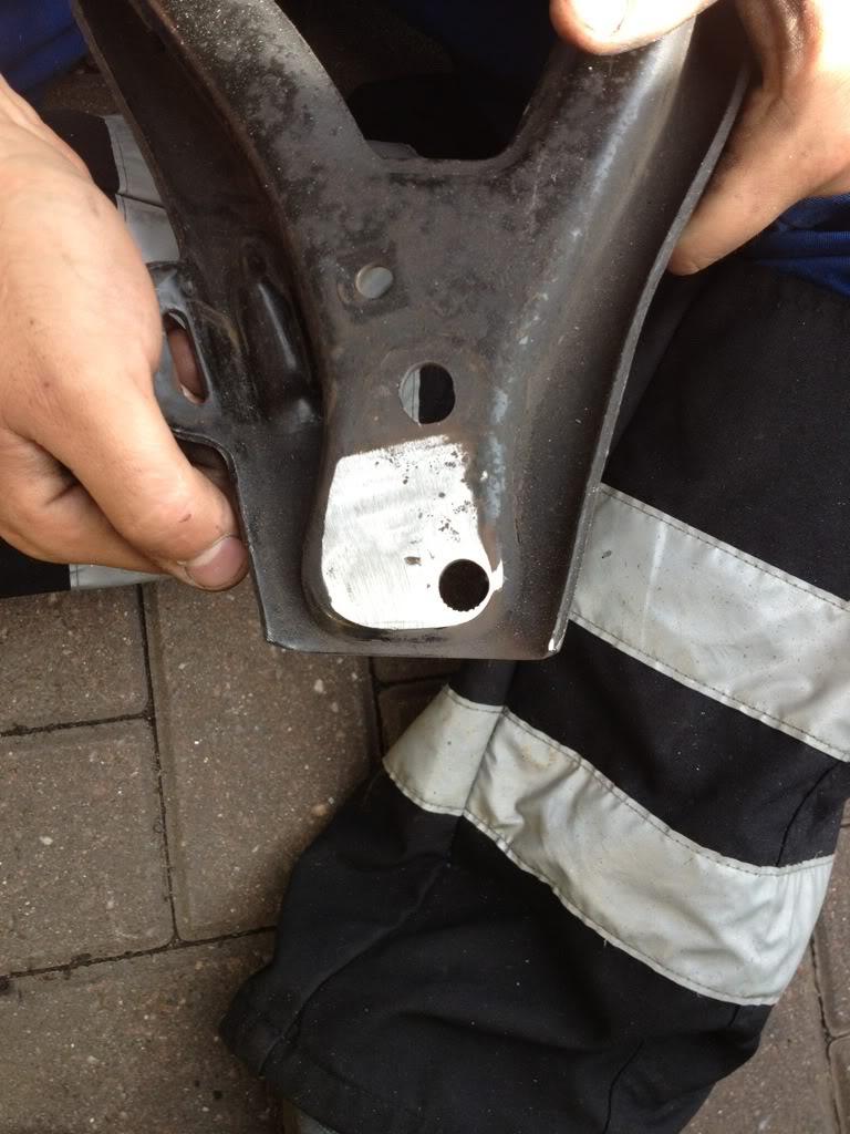

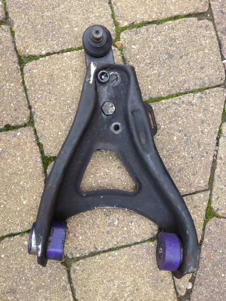

Got some pics now I have done it.
It gives 35mm more caster done like I have done it, compared to a ph1 wishbone.
However, you could actually add another 15mm to that if you accepted slightly losing some track, by elongating the inner hole backwards instead of outwards but I didnt want the extra caster enough to compromise a few mm of track width to get it.

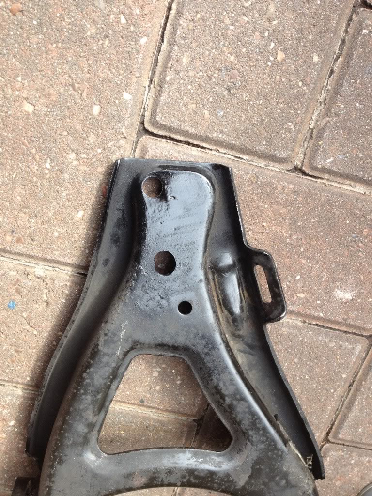

This is how I did it:
Drilled a new outer hole, and elongated the existing inner one slightly, and trial fitted the balljoint both there and in the original place so I could take some measurements.
Then I plug welded the original outer hole (TBH you really dont need to im sure, there was quite a bit of meat between the holes but I can so I did)
Then I used a power file to make sure there were no highpoints that the balljoint might touch and not sit flat
Then I gave it a quick paint just to stop it rusting
Then while I was stood around feeling quite pleased with myself with how it had turned out (Im no fabricator TBH, just do bits and pieces) Mike from MWM who is staying with us this weekend proceeded to do just as neat a job (better if anything) of the other one in half the time, damn him and his expert welding skills, lol
We're just refitting it all now, but wont know about how much it has improved the handling or not till I can get it tracked which wont be till next weekend as tomorrow we're doing some work on Daniels Mk1 and Im then off to london for the week to work.
TBH though, you'd have to REALLY want the extra caster to bother versus the cup setup, the difference is actually pretty minimal, just under 10mm in fact.
And you can ONLY get that if you swap to a caphead bolt, as the normal one wont fit anymore.
Good "free" mod though

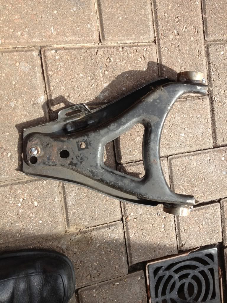

I managed to get a pic of the racer arms, I never took any pics of the hole pattern before fitting mine( note the strengthening plate, Im sure I can remember seeing similar plate on lower model phase 1's maybe someone could clear that up)

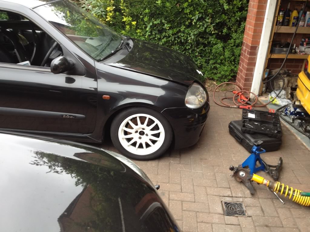

I'm considering moving my ball joint position forward while I have my subframe removed. My main concern will be clearance between the bumper bracket and the tyre.
  Ph1 172 & Clio DCi

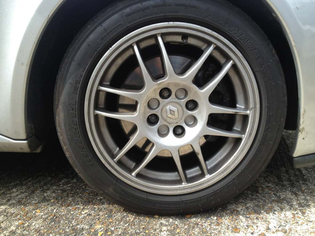

This is my front wheel on my ph1 172 with the cup wishbones fitted.

Now I'm confused, doesn't this show the cup ball joint as being further back, ie less castor?????
There are pictures put up previously by p@blo
Cup:
Non Cup:
This is the difference in the arms, ignore the fact thats not running a standard balljoint, those arms are the standard non cup 172 arm versus the standard 172 cup arm.
Like I said, you can see that all that has happened is that the outer mounting hole has been drilled further forwards.
