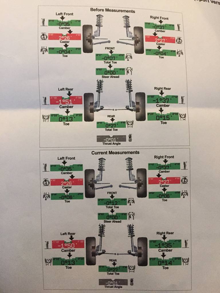

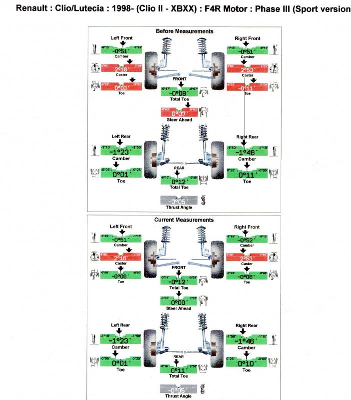

Just looking at my alignment sheet on my cup packed 182
1°59' one side and 2°19' the other.
I guess I ought to check whether it has the correct wishbones fitted, but if not, I I guess I can simply redrill the front hole as Chip has done.
  182cup & 172 racecar
That is a small difference, you would get that to change just by undoing everything and doing it back up again.

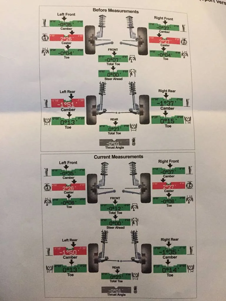

Looking at my alignment below, would you say I could have the wrong wishbones fitted? Car is 182 Cup FF. Brakes and goes in a straight line, steering wheel is straight. 16" Turinis.
Had it checked for accident damage, albeit it briefly, nothing obviously bent.
  182/RS2/ Turbo/Mk1
From that it looks like non cup arms but ride height effects it. Stripping rear for example loses caster unless you correct the height after. So can't tell from a printout. Just look at them!
