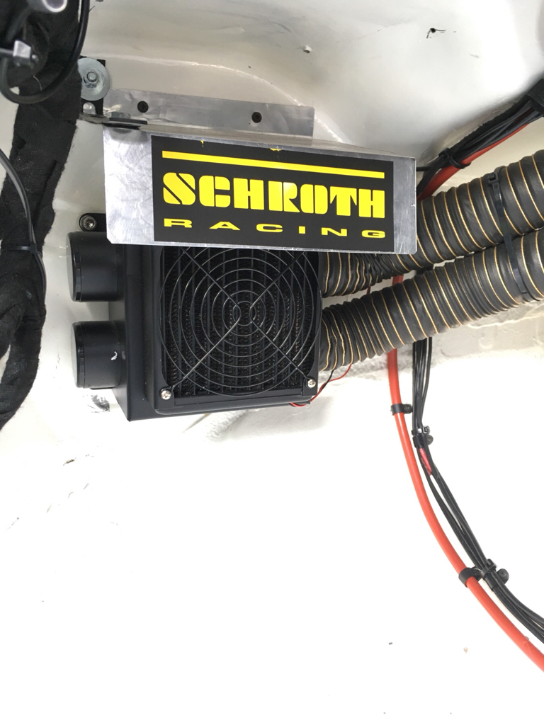

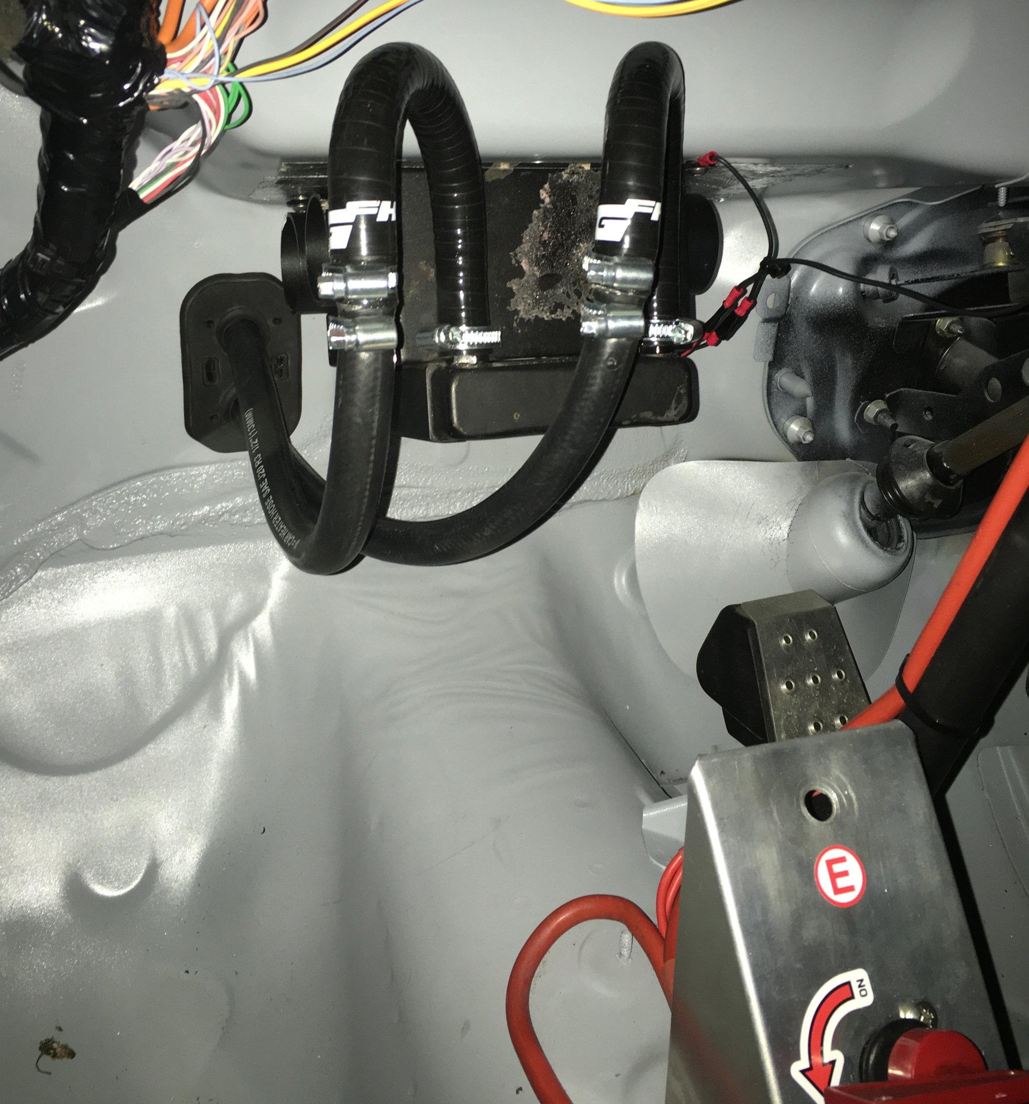

I want to do something like this

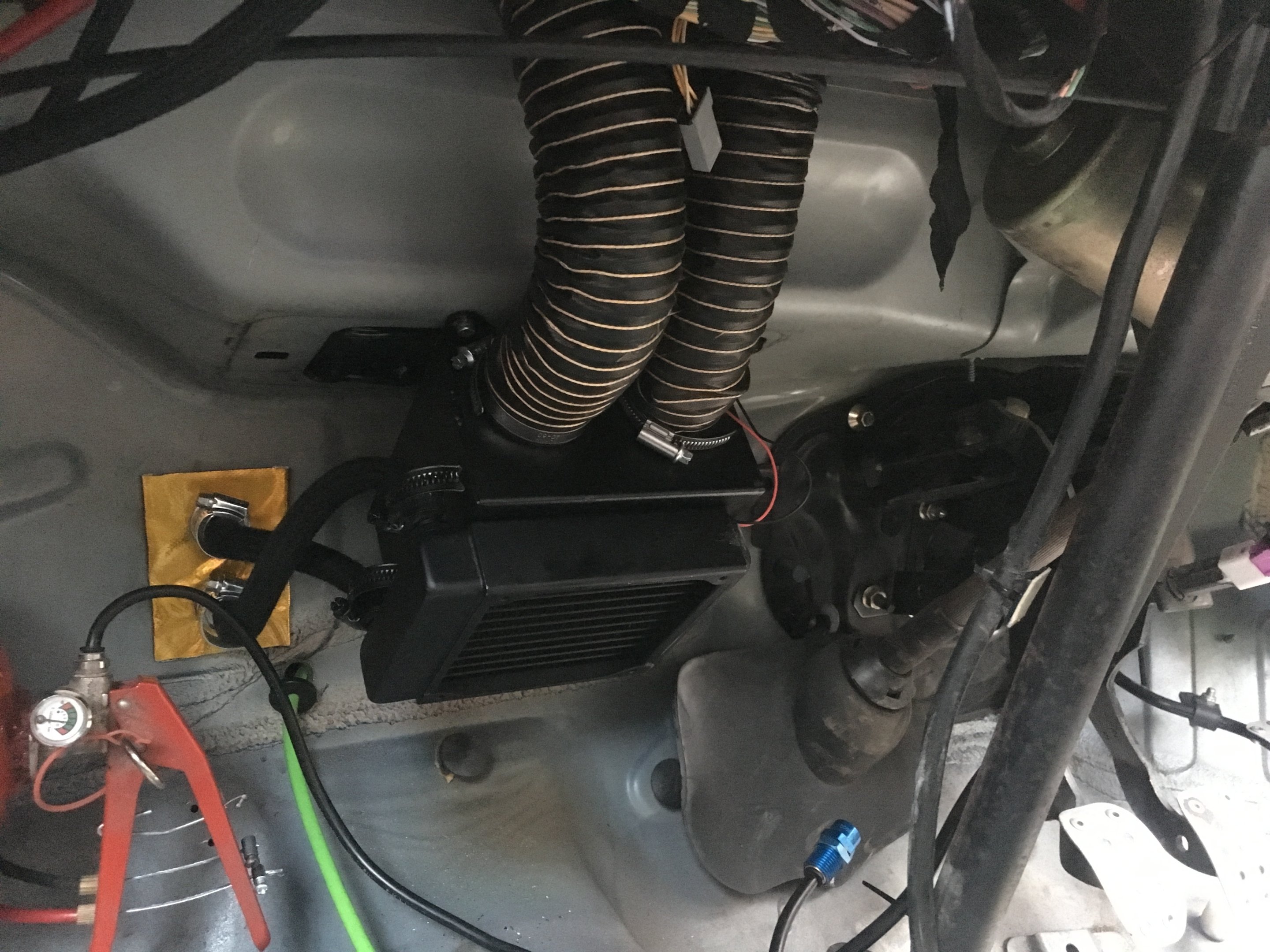

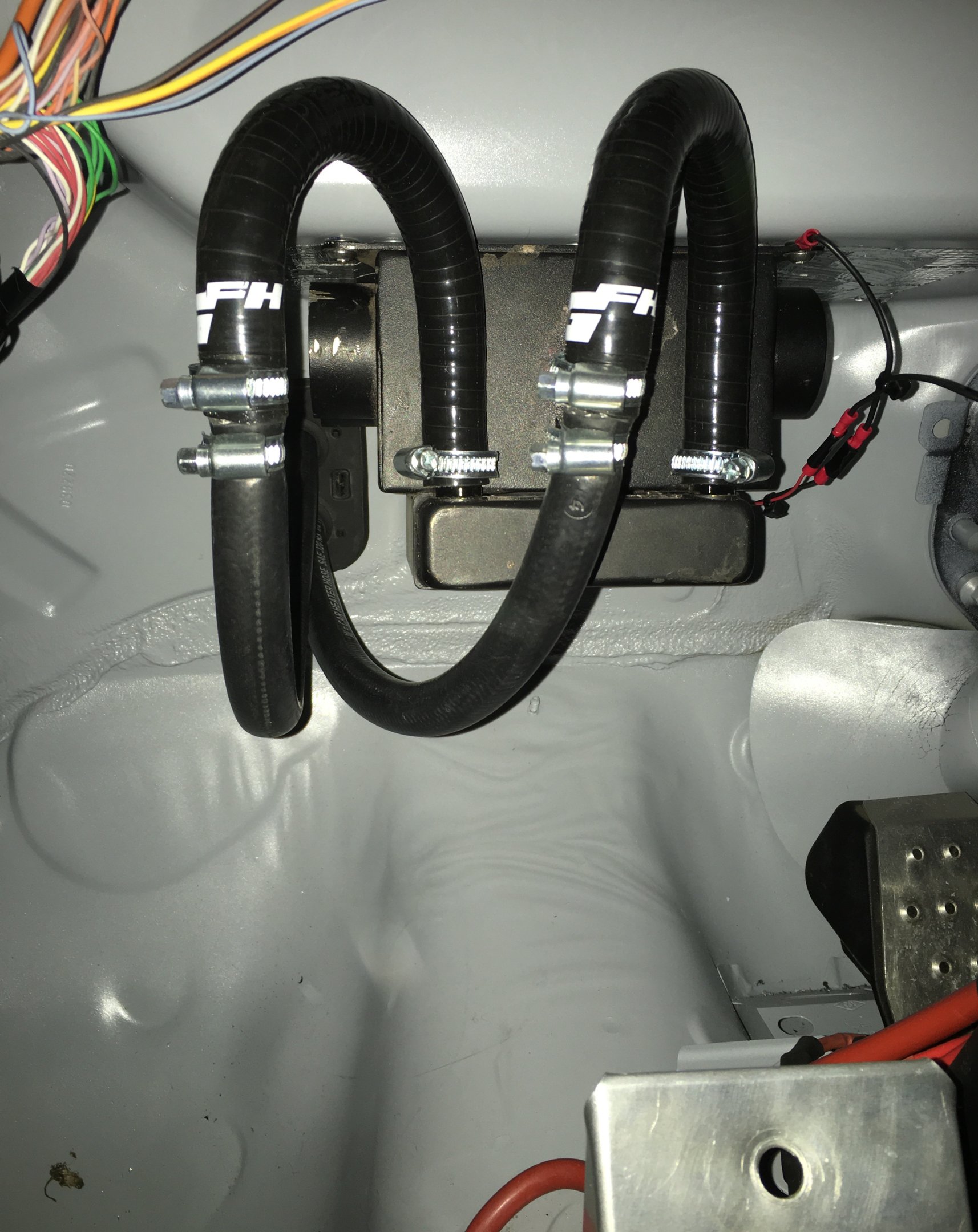

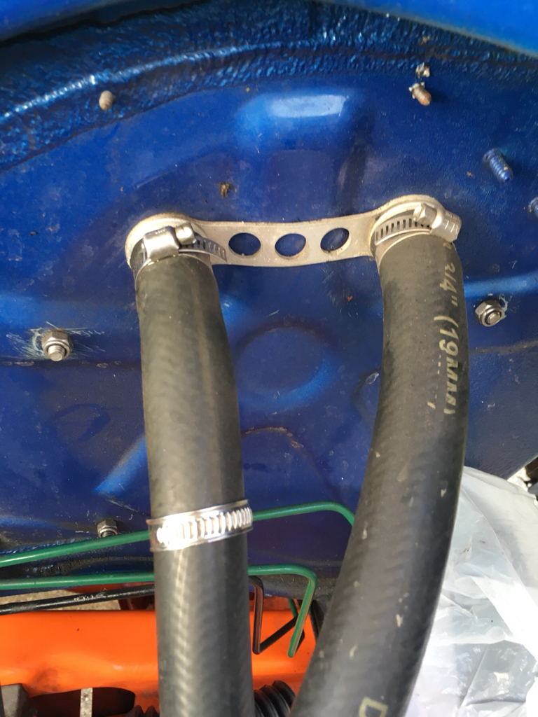

This is my setup finding the correct fittings etc was a bigger job than you'd think, ended up making my own reducers at work. Need to buy some ducting for the vents.

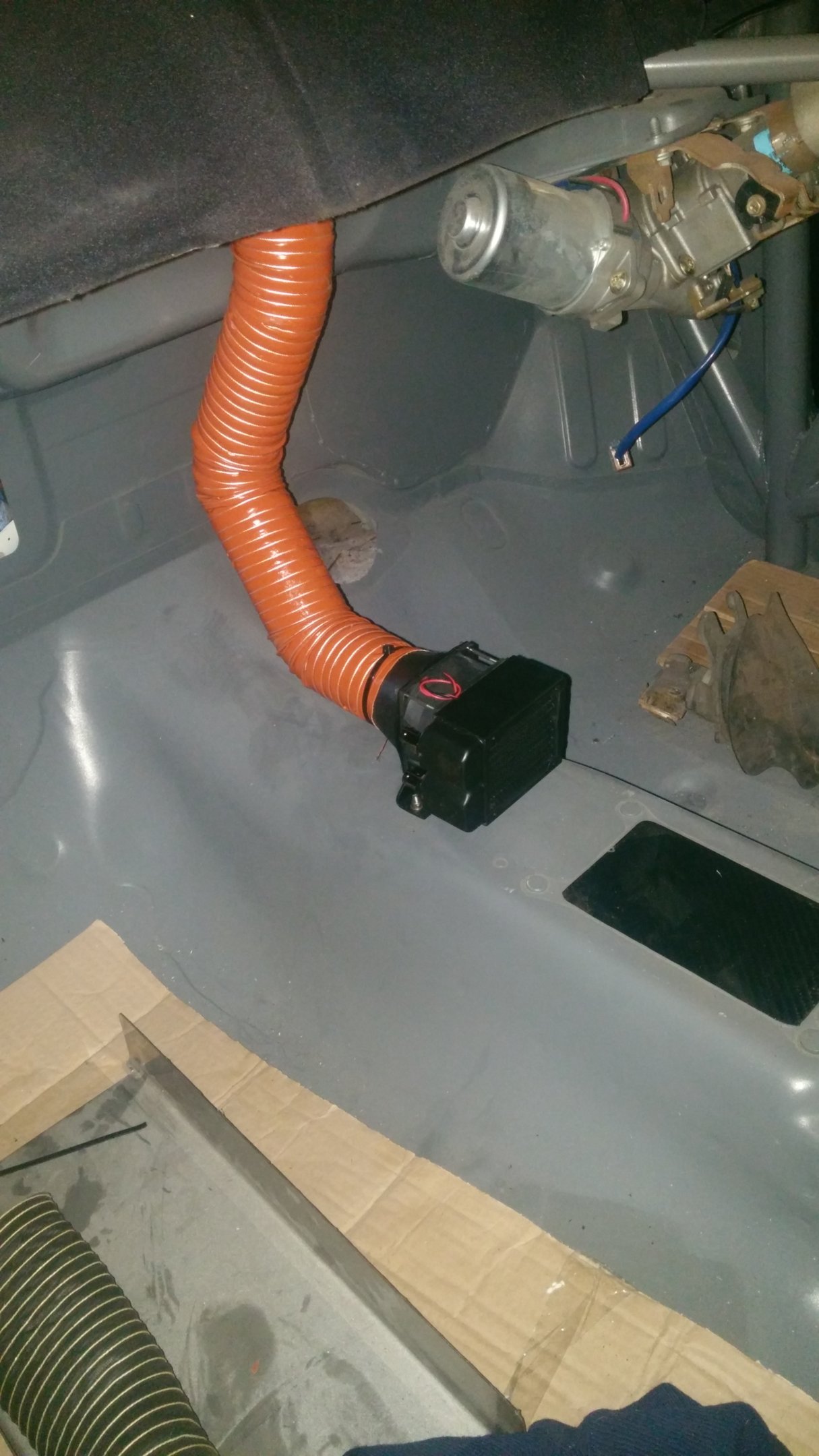

Did that just blast up the screen, or blow through the standard dash vents for the screen? I've hooked mine up so it blows through the factory ducting in the dash and onto the screen. You can hardly feel it with it on though, so worried it is going to be cack!

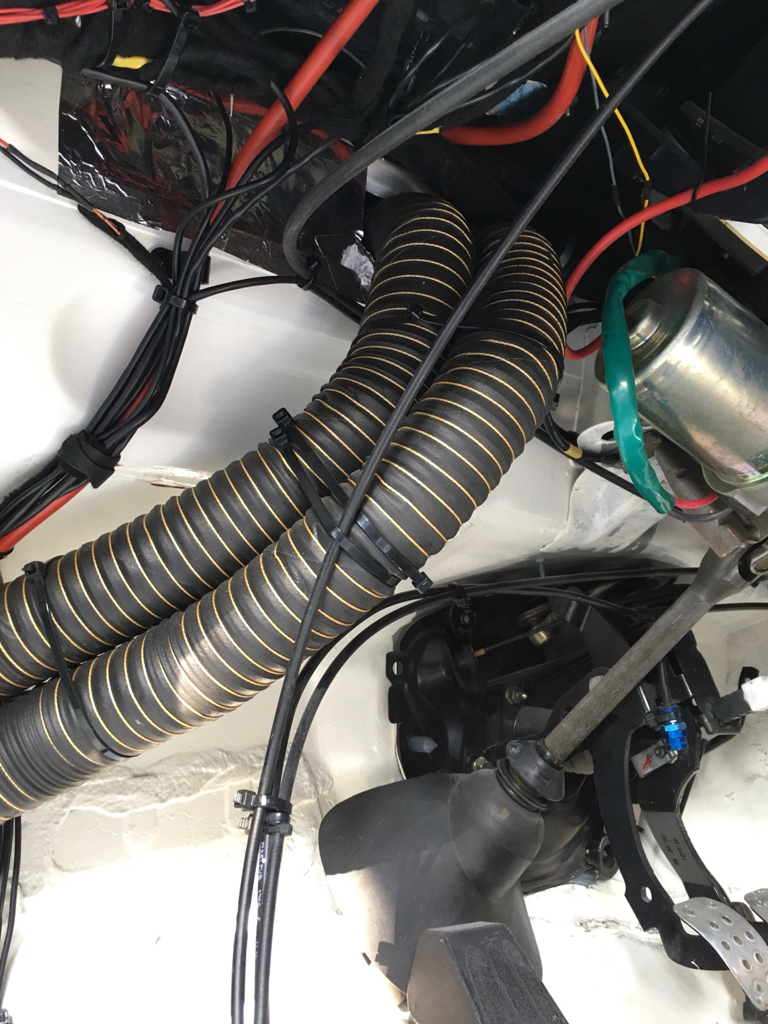

Yes ive got it going through a seald hole in the standard vent hole, to go through to top standard screen vents, and blocked off all other openings, i keep it running on stage if its wet or 1st thing on a cold morning and keeps clear, but if it gets missed up mid stage does take a bit of time to clear
I did look there my problem was I have Forge coolant hoses and the pipes from the thermostat open out to 25mm so I needed to reduce it down to 13mm for the heater. I could of used a series of reducers etc but wanted to keep the amount of joins to a minimum. I knocked up some 25mm>13mm reducers out of some aluminium at work which have done the job.
And how is this then controlled? Or does original dash still go on? Interested in seeing some T7 set ups
would also like to know how this is controlled. perfect for my future plans

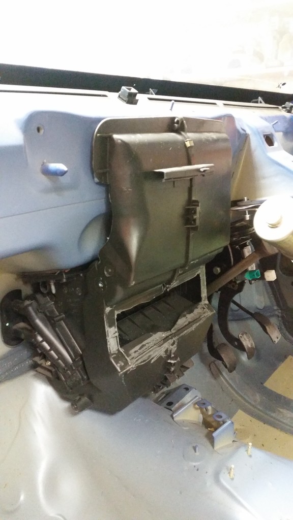

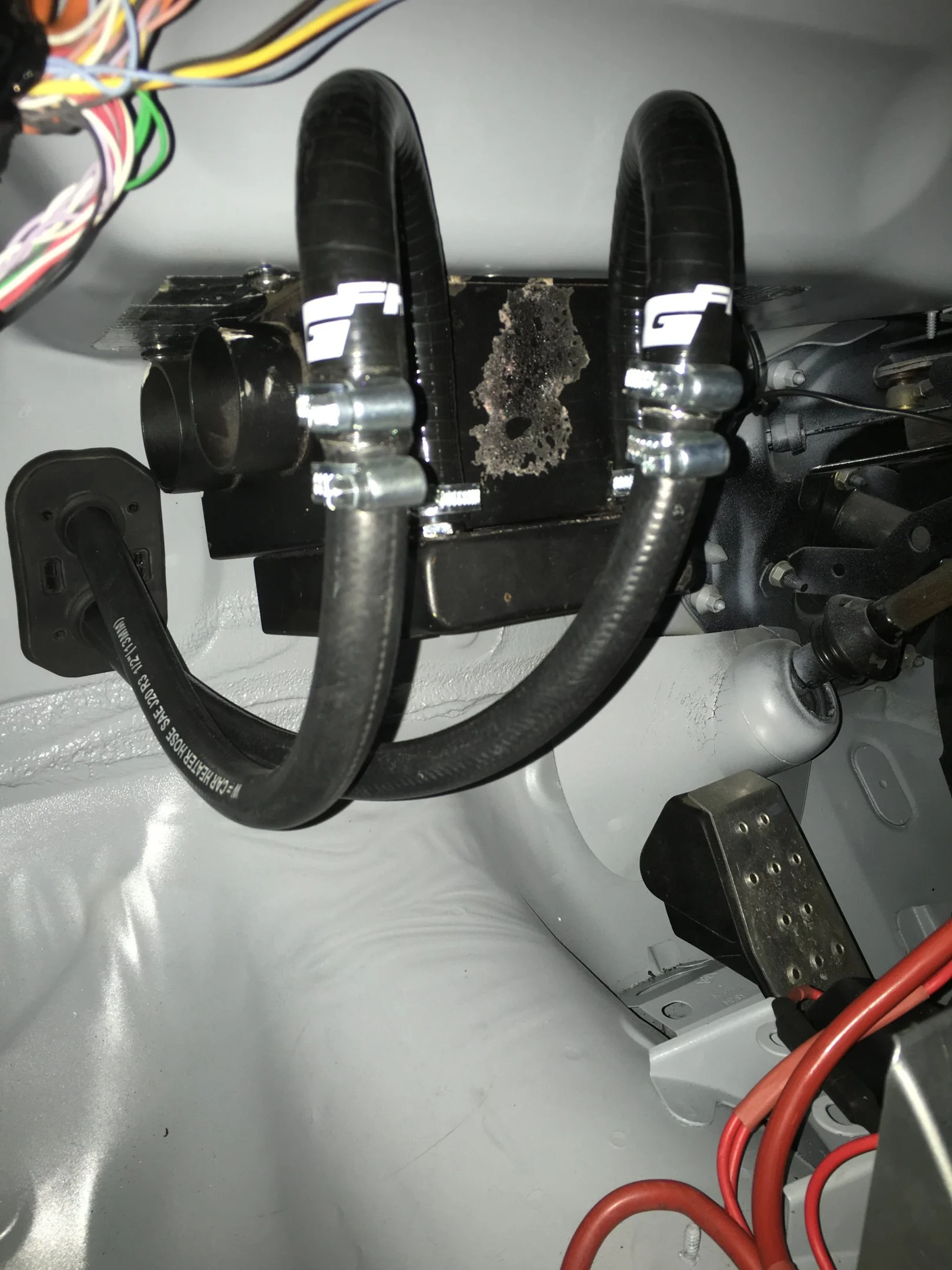

That's my setup. I've actually been working on it lately. So i've switched out the AC blower for a standard blower which will be a simple ON/OFF control. I've blocked up the cut of part of the airbox and I've used the motors on the right side to lock the flap inside to so that it'll only ever blow air onto the screen. Oh and it'll only blow hot air, there's no temp control.

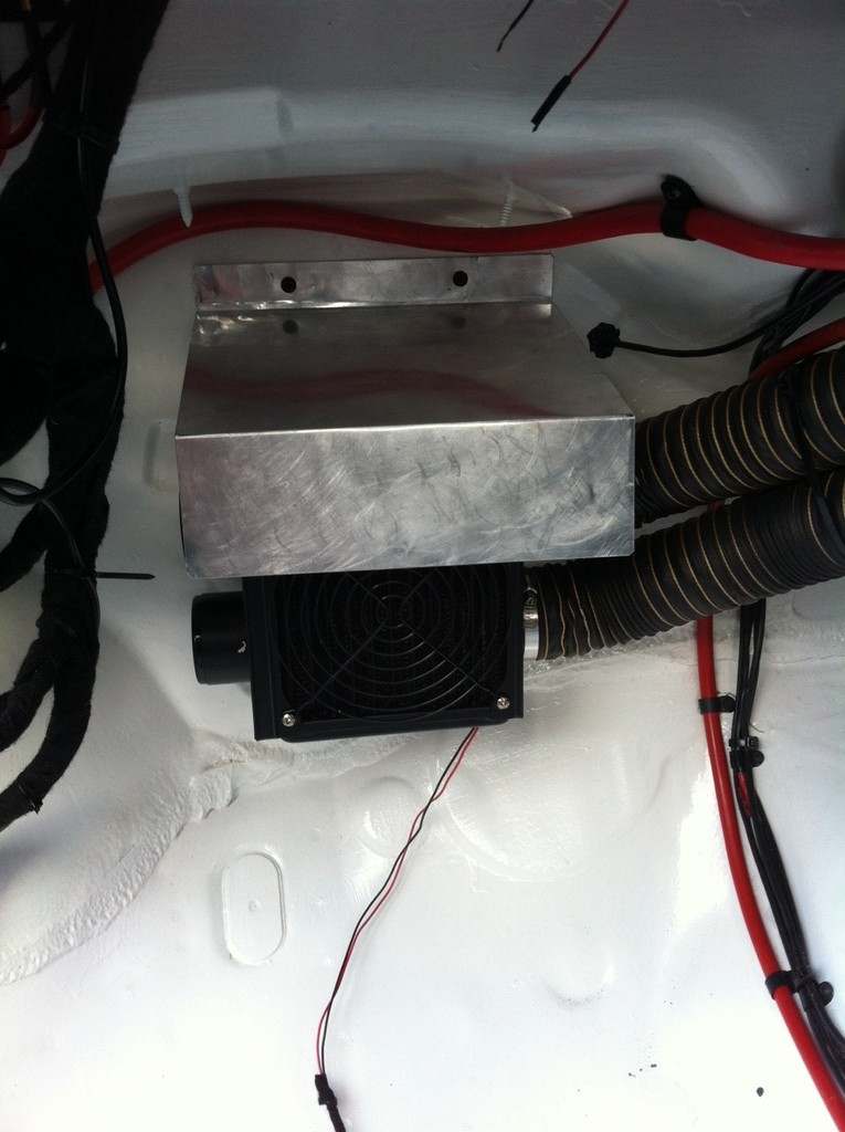

Iv had my T7 hater now for 3 race seasons, 2 of the outlets are plugged and the other two have ducts going into the original windscreen vents sealed.
When running it builds up enough heat to demist the window and on race without problems.

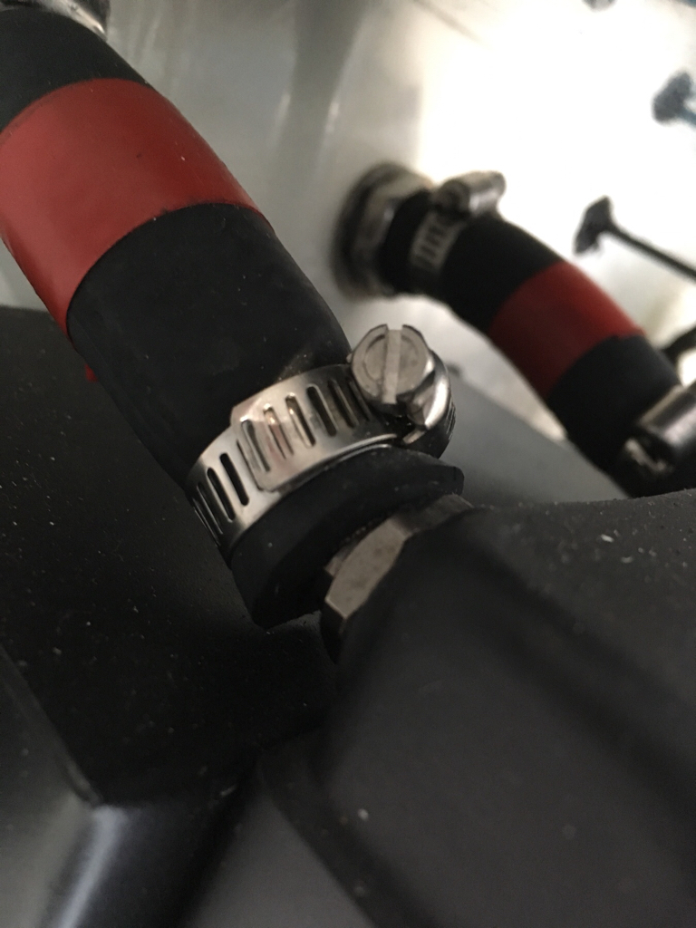

Only problem I had was when one of the heater face/fin split mid race at Castle combe and coolant sprayed everywhere and a lot of steam, I had to retire mid race (I wasn’t happy) T7 sent out a new heater free of charge so thats was good.
For those competing you will have to build a splash protector over the coolant joints of pipework and heater, and mark with red tape.

Did you use bulkhead adapters for that? Or was the size of piping the same? Want to order one but not sure what size fitting I need for the pipes.
