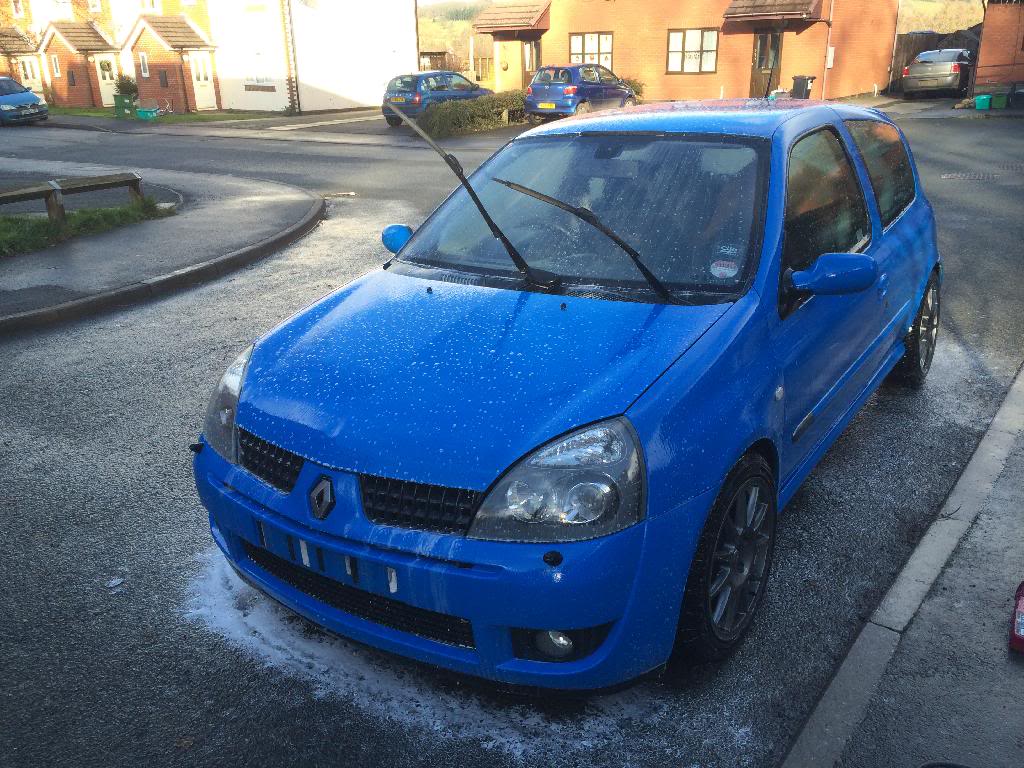

Snowfoam...What am I doing wrong?
I'm using AF Avalanche and filling the lance with about an inch of mixture and topping up with warm water. The setting is turned to minus and screwed hand tight but this is the thickest I can get it:
It comes out of the lance a pure white but then as soon as it hits the car it just drips straight off :dapprove:
Any help is appreciated.

Ah right, so it's just a case of putting in more mixture? That's a bit of a relief, I didn't know what was going on.
The bottle says to put 1-2 inches in, is avalanche quite a weak snow foam or have they just underestimated how much is needed?!

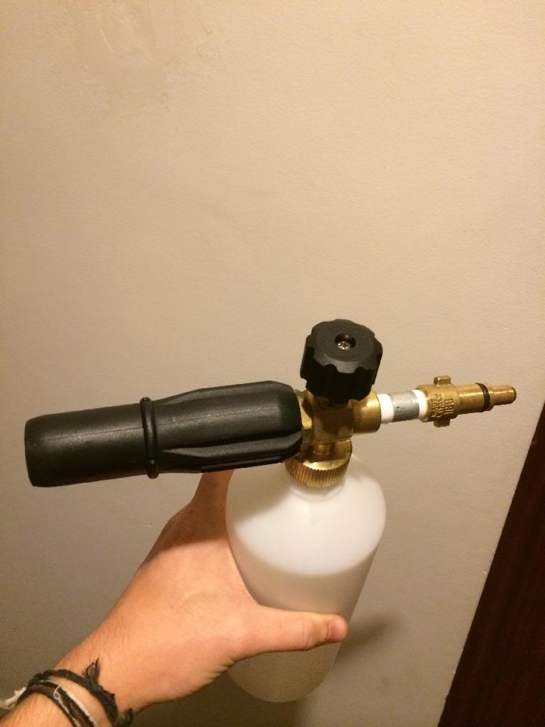

My foam comes out like that. This is my lance:
No idea why. I have tried all dilution ratios imaginable :( Shouldnt need cleaning etc, used maybe 10 times and did this from new.

Avalanche is not the thickest of foams, it won't sit on the car like others but still cleans as well. I like avalanche and even with a poor pressure washer I get thicker than that.
Looking at what's on the floor it looks very watery. Have you experimented with the dilution knob on the top. Yu say you had it set all the way to -, have you tried all the way to + or in the middle?
Mine is brand new too, it is a bit weird. I hope I'm not missing something totally blatant but I don't think (I hope) I'm not.
Yeah I had fiddle with it today and turning it to + makes it very weak, basically water and when in the middle is isn't as thick as when it's turned all the way to -, but still thicker than +.
This will sound odd, but when you next use it, turn the lance on its side. I find I get thicker foam when its on its side than when its verticle
Haha, it doesn't sound odd at all as I was doing this myself today. I was doing all sorts of weird things to try and get it to foam.
Still, I'd like to find out what the problem as I don't want to be a wasted present. Especially due to how excited I was when I received it.
  Golf GT & A4 Avant
If turning the lance on its side affects the mix and gives you a thicker foam then there is an issue with your lance, almost like you're not getting the draw of foam up the feeder tube into the mixer
