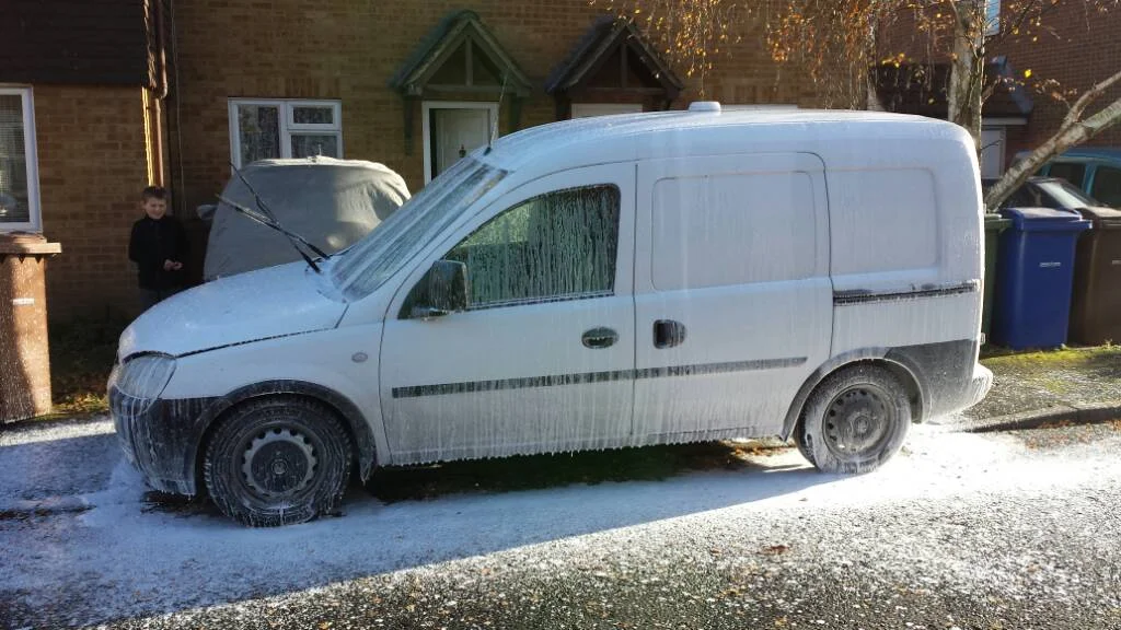

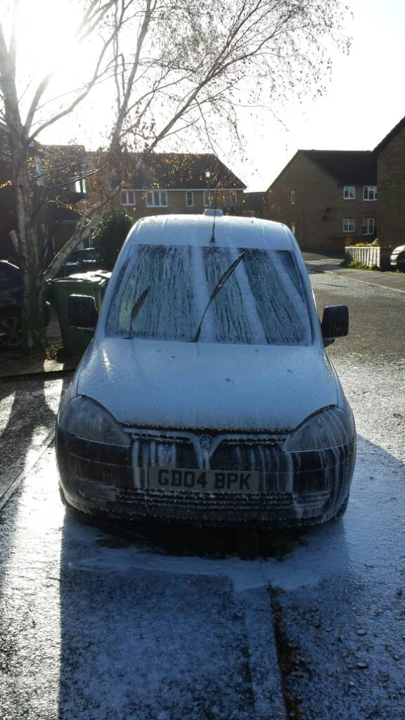

If turning the lance on its side affects the mix and gives you a thicker foam then there is an issue with your lance, almost like you're not getting the draw of foam up the feeder tube into the mixer
I have had mine a little while now. Too long to mention it to CYC, think O may attempt to take it apart and see what's going on then, worse comes to worse I'll have to buy another.
Will be washing the 200 in a bit anyway, will picture my lance and foam, may even film. See what your thoughts are then

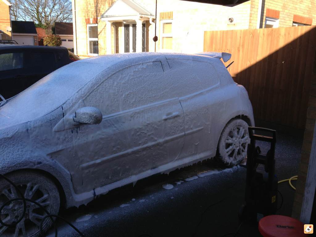

So. I feel a tit. Played with the settings on it and have it a squirt with clean warm water only, then this:
Happy days!
Lovely bit of foam.... I don't need one but I really want to get a snow foam lance just for the fun.
Just a valve sticking maybe or different setting on the mixture screw?
Looks a pretty thick foam, what pressure washer / rating is it?
Its on the 'thickest' foam settin there, next time I'll do it a bit thinner I think. It's an 1800 Nilfisk pressure washer, can't remember which model though. The mixture screw on the top was smack in the middle before, but I had tried it at both ends too. I think the flush out with warm/hot water may have removed a bit of gunk or something.
Im chuffed :)

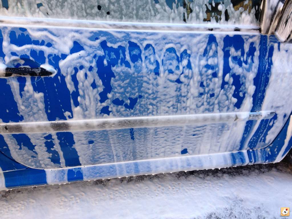

Also, re-dwell times. I used up the last of the Avalanche I already had in a foam lance bottle thing, after around 5 minutes or so:

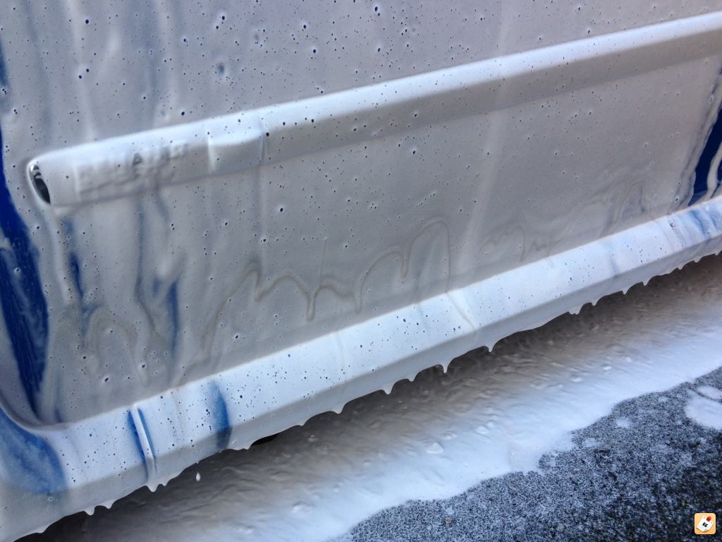

Magifoam after 5 minutes or so:
Magifoam wins for me. You can actually see a line or grime and dirt coming off.

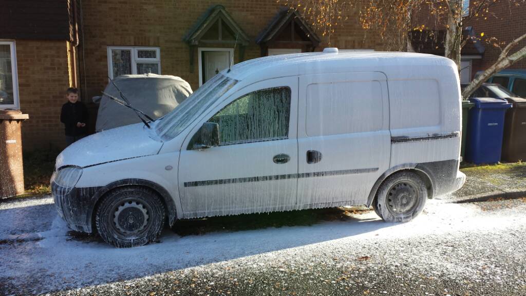

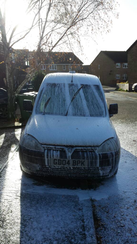

Mine wasn't that great 1st time around but im yet to try it again.
I put about 2" of sf then topped up with warm water.
This is mine 1st time I used it.

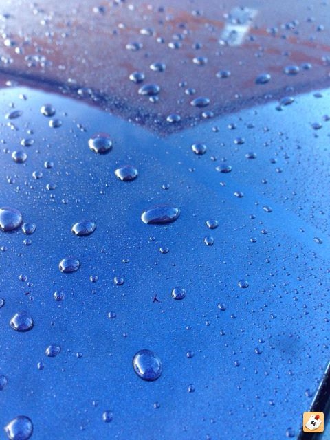

Hydro2. I wouldn't have believed it was this good without seeing it. Above is one application in an otherwise unprotected car!
What did you do differently mate, just fiddle with the knob on top?
How much avalanche did you use?
I filled the bottle with warm water (almost hot!) and squirted it continuously fiddling with the knob on the top. Once I had done that, I turned it to full strength and it worked a treat. Tis still on the road now! Wonder if it'll freeze?
Hydr02 is absolutely fantastic. I did my Dads car around 7 weeks ago, just 1 application, and its still protected now.
