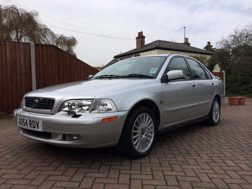

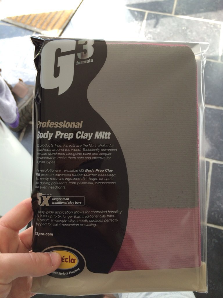

Just been using one of these on the old mans car -
Car is a 54 plate which has never been Decontaminated in its life until today.
Wash
Tardis
Iron-X
Wash
Clay Mitt :)

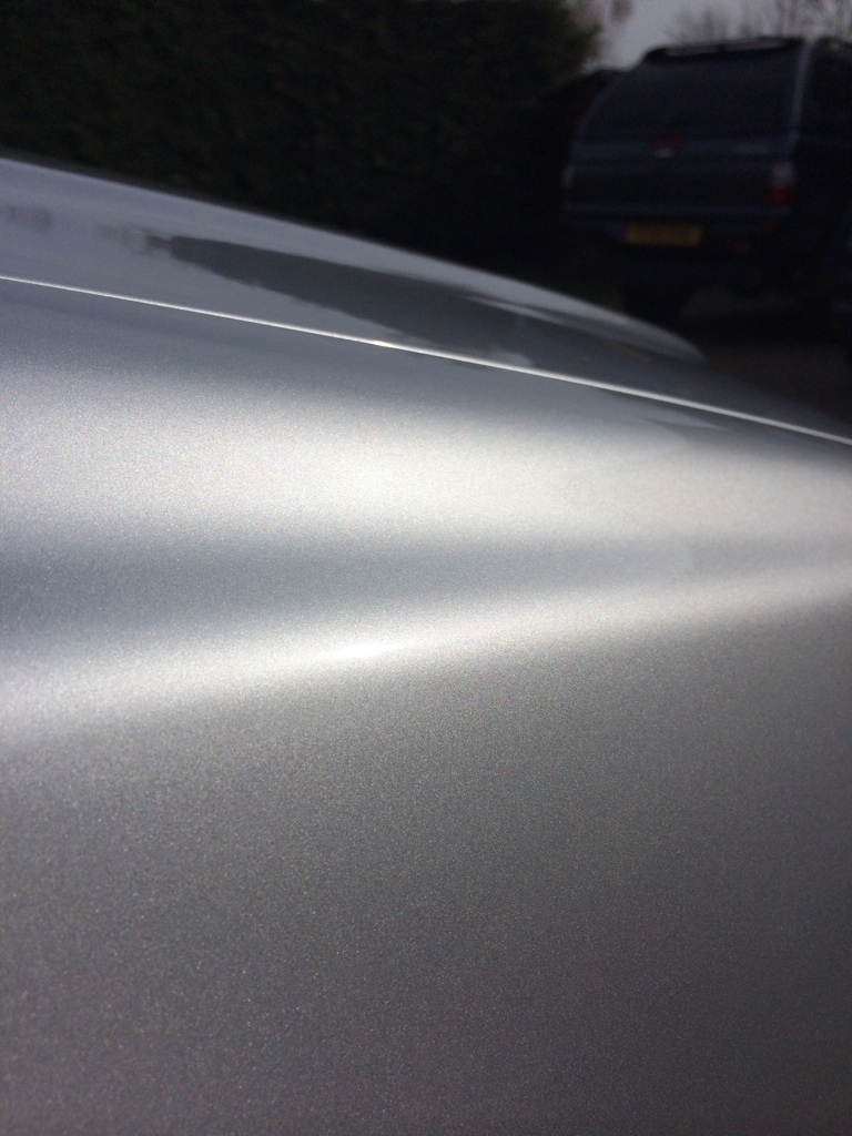

This Mitt is so easy to use, You can easily feel when the panel is free of any contaminants, Dip in bucket of shampoo'd water, Wipe with MF side first then flip over and clay, Had the whole car done in under 30 mins.
It's hard to tell if there has been any marring left being a silver car and it is far from immaculate anyway but I was very impressed and it felt quite kind on the paint using it.

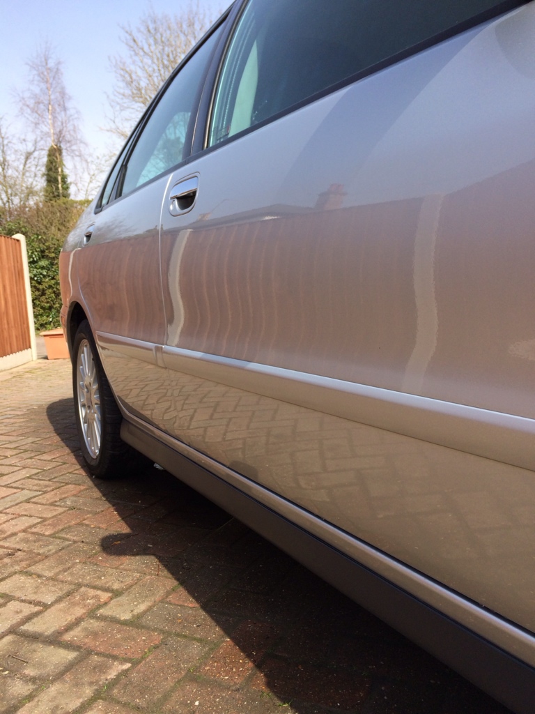

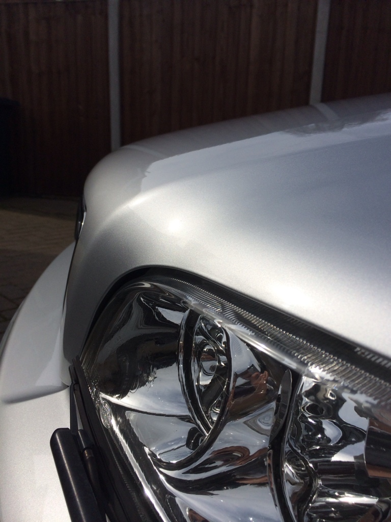

Nearly 10 year old paint fresh after Claying and drying -

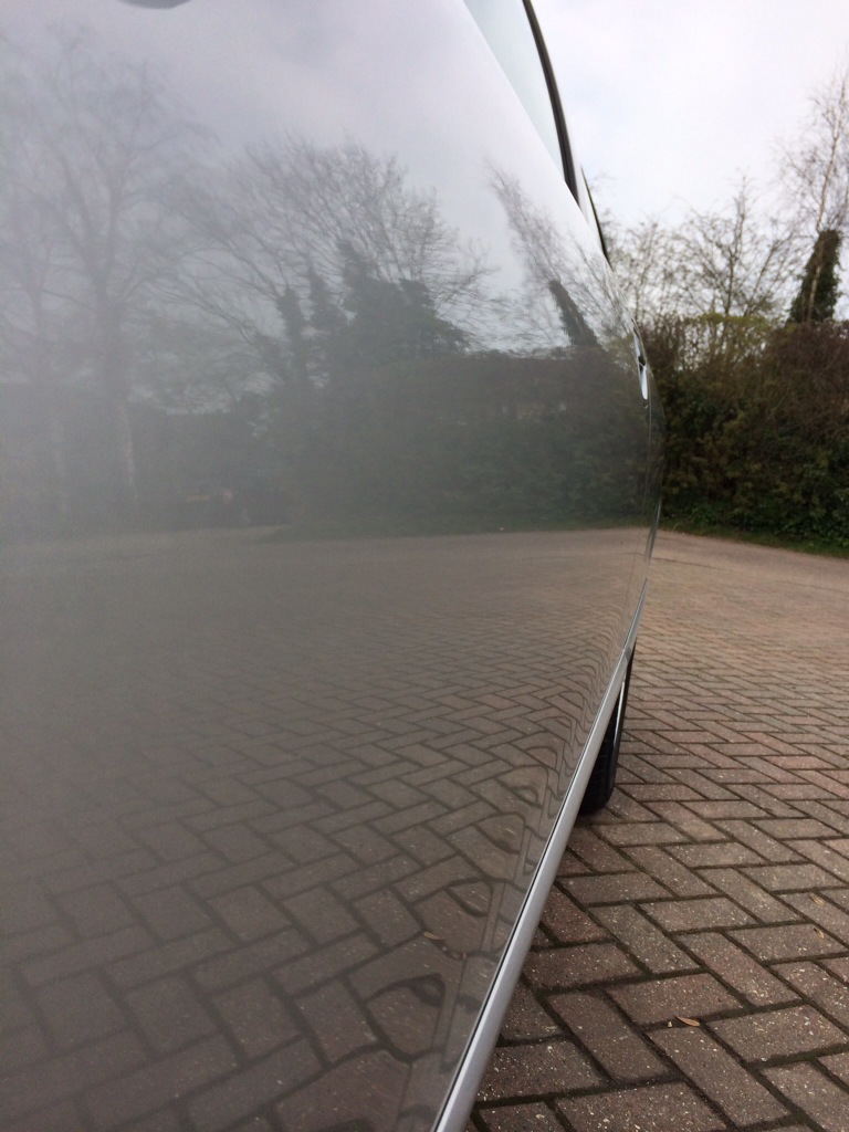

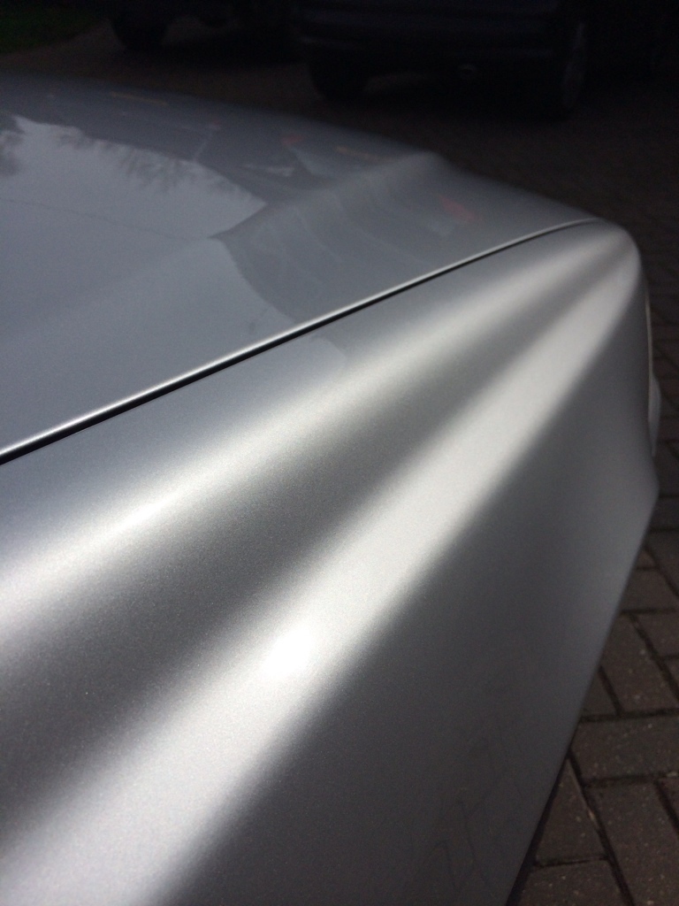

AF Rejuvenate working its magic
It's Amazing how much dirt it pulls from the paint even after a thorough decon.
Prep'd and ready for wax :)

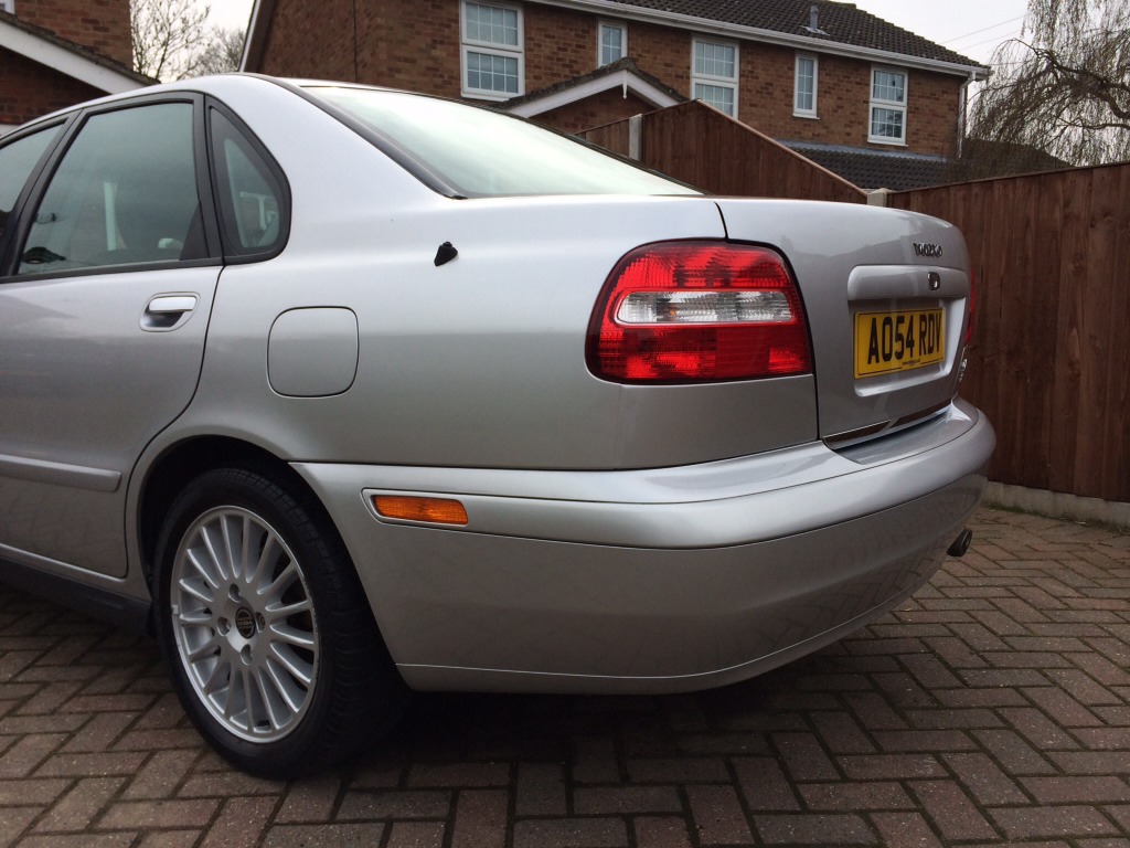

Sun has buggered off as always but topped Rejuv with Capture the Rapture, Had a sample a while and have never used it, Smells lovely!!!
Glass cleaned with AF Crystal, Plastics given a quick once over with Revive, Tyres dressed with Megs Endurance.
Nothing special but the old man was happy when he came home.

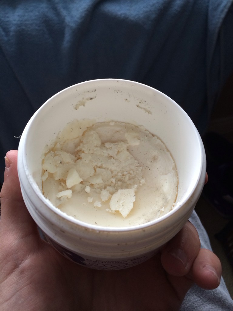

Is this salvageable??
R222... Bought years ago and at some point it seems to have dried out and crumbled a bit.
Do I just sit the pot in hot water and see how it goes?
aucky
Worth a try!
I'm really looking forward to getting Rejuvinate now. I barely used a wax last summer, and I have 15 of the damn things now (some are sample size) so I need to get cracking with them!

Will give it a go tomorrow.... Rejuvenate just pulls so much crap on from the paint, I should have taken a pic of my applicator afterwards.

Coby, get a small tea spoon and squash, mash the wax back together as it warms up it'll soften and become workable again. Had ag HD wax do something similar
Ok cool, Will sort it out at some point, Is it actually any good? Bought it years and years ago before I was into detailing.
Coby. Do this, but pop it in the fridge after, otherwise it stays mushy!
Cheers for that, Will have to explain that to the parents when I come to refrigerate my car wax.
