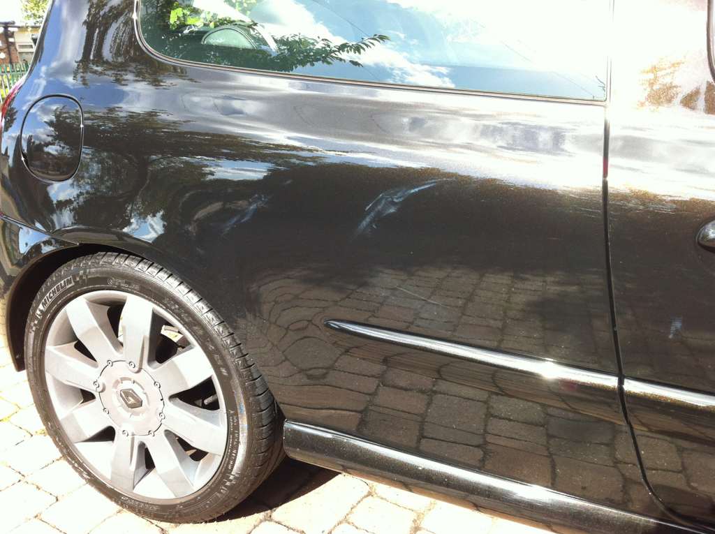

Need a bit of help with regards to the finish on my cars paint at the moment, I spent a good 6 hours the other day cleaning and rotary polishing the car the other day.
White hex logic pad and a low cut mazerna polish just to get the light swirls out, end result was good I worked the polish right down hopefully, under a light the results where pretty good for a light polish, ipa'd after then waxed with 476 but as usual a day or two later and the direct suns on it and I get hologram type on the paint, it's not actually in the clear coat it's wipes away with a finger.
So I think I could do with a new very soft MF? Mine are a bit old tbh, any good drying aids I could get? Or what else am I doing wrong? I think it's just the towels
Car is quite dirty now but here's a pic
Daniel
  Whichever has fuel
If the smears come off with your fingers, then you need new cloths. When mine get old they are terrible.
Gally
Short piles cloths ( like swissvax micro etc) are good for wax removal. Fluffy mf's are more for QD's I find.
It could be gassing from the wax, 476 is very solvent heavy and can leave marks on the paint as it starts gassing, especially with temperature change. Chilled water can help with gassing.
Either that or it's holograms from poor polishing. Even wiping the finger will just move the unbroken polish around. :)
Cheers everyone, I'll try a soft cloth later I've got one new one somewhere, I think it's my cloths they're old and never that great from new.
The polish was a light cut and I made sure I broke it down so hopefully a good clean will remove it.
