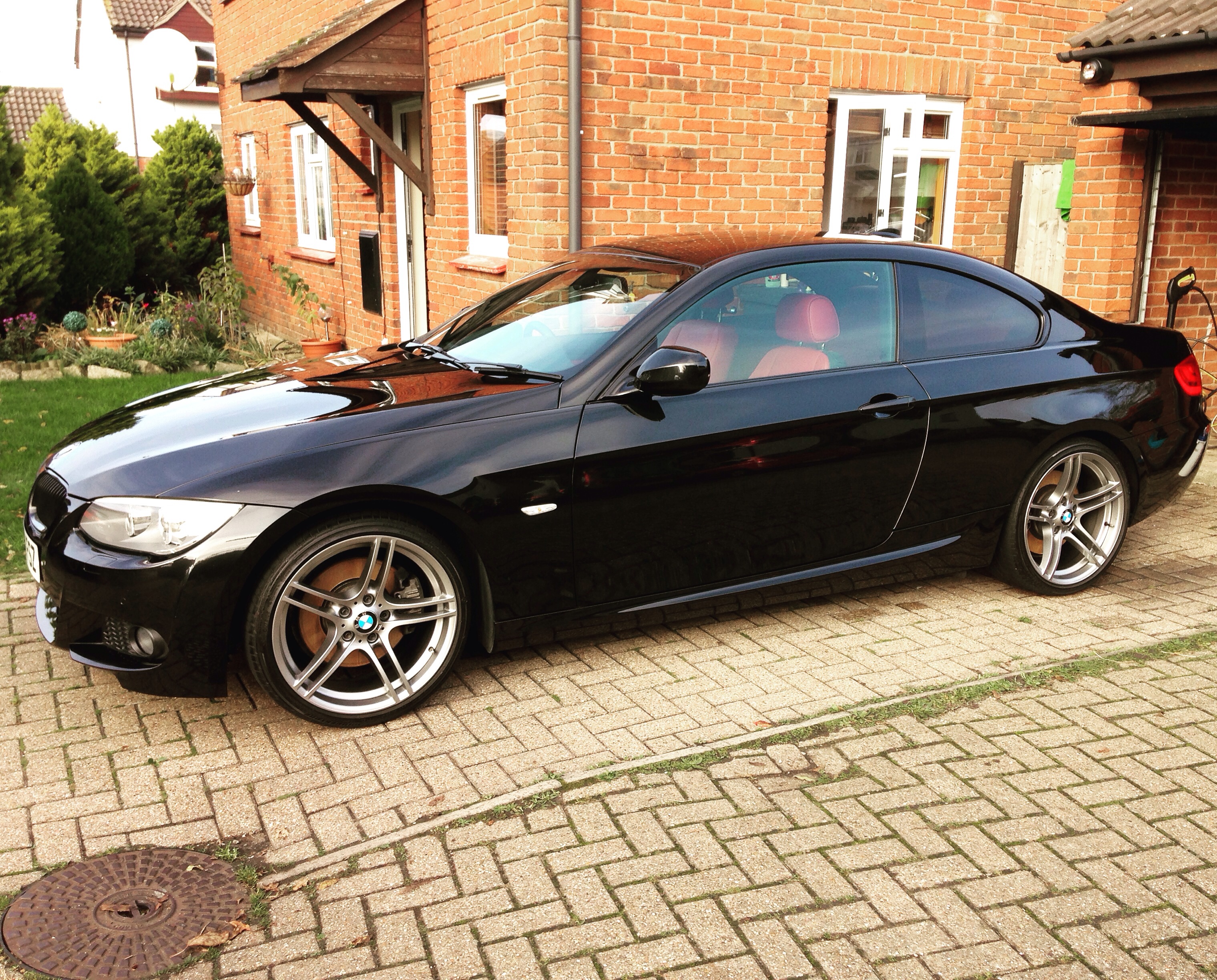

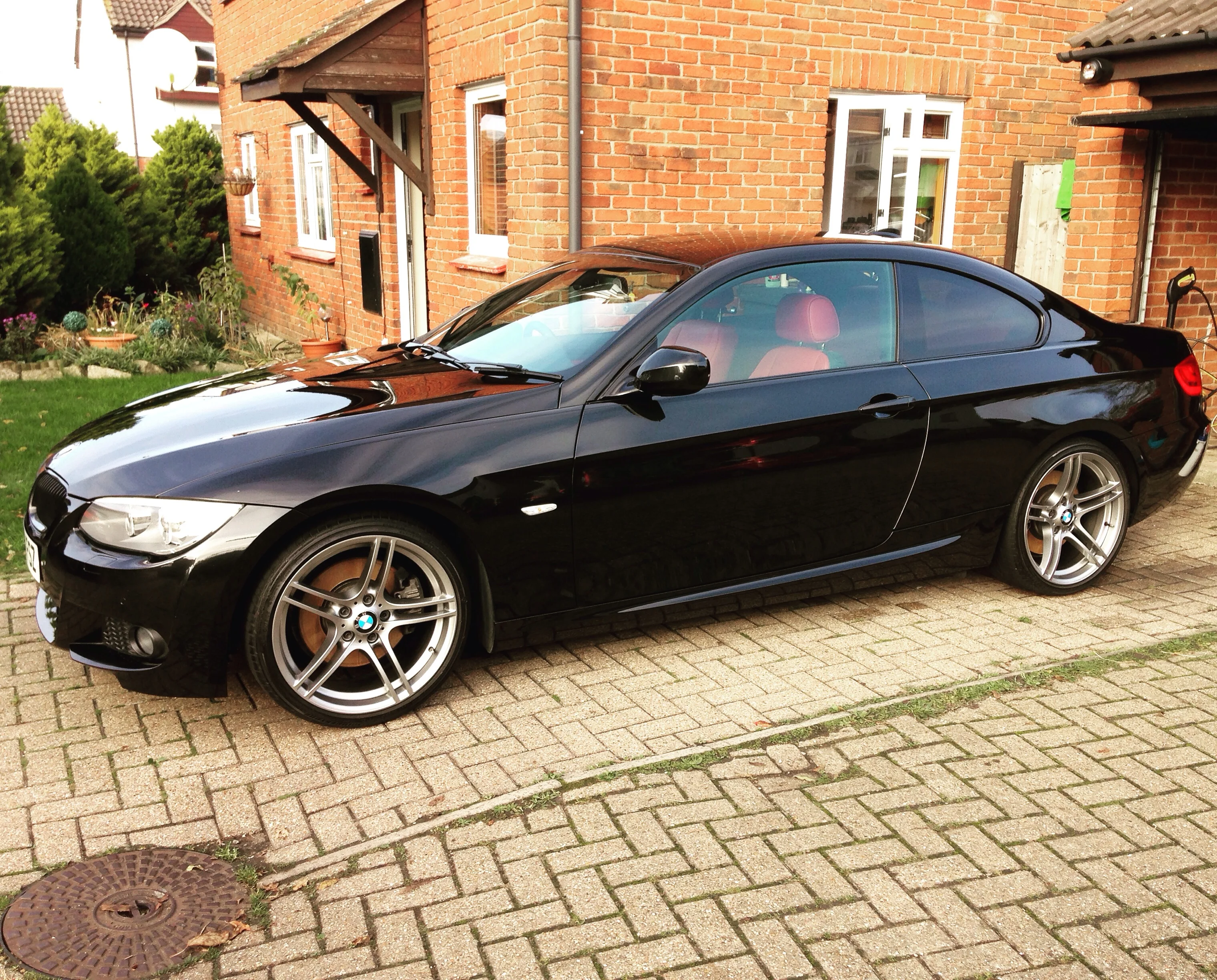

For those that work on cars not their own, do you ever not want to correct or try and talk the owners out of it?
I'm a firm believer in get it corrected once and maintain it carefully. A friend with a 330d coupe had his car professionally detailed at the start of the year and I've been trying my best to teach him to maintain it to the point his maintenance wash takes far far too long, but in this time it has picked up some minor swirls and marring. But nothing serious. He was gutted to see swirls after all the decon and wanted it fully corrected again. He plans to keep the car long term but took a lot of convincing not to correct it yet. In the end britemax blackmax on a Scholl concepts black waffle finishing pad was enough to remove some and hide the worse. Topped with britemax vantage it filled even better, looking fully corrected up close in the sunlight.

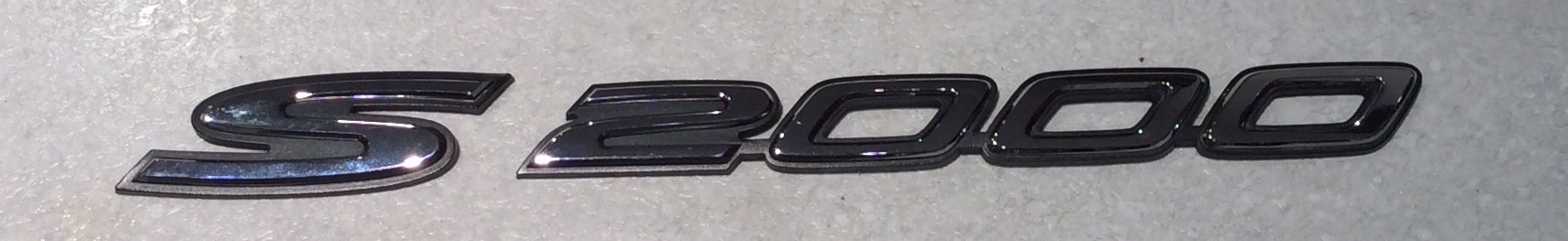

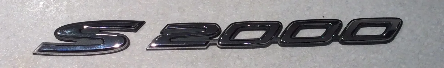

Depends what it is. Mostly badges with that stuff. Trim... really depends as the tape isn't great.
Basically it's the attached badges. They have always been loose on the drivers side (after a pervious respray) so pretty much fell off during a tardis session.
Iirc they're £60+ from Honda.
I was thinking there might be cheaper ways off restocking them without damaging the paint?
