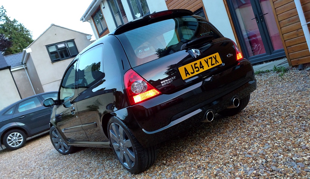

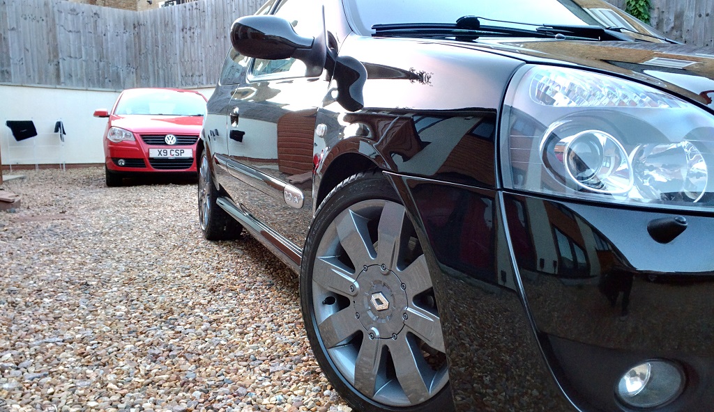

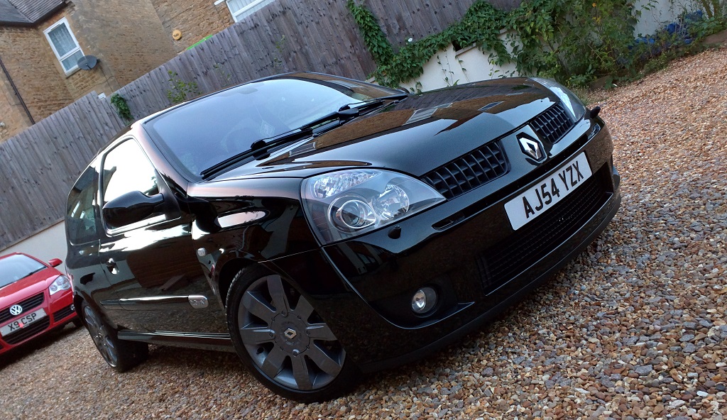

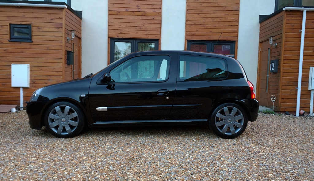

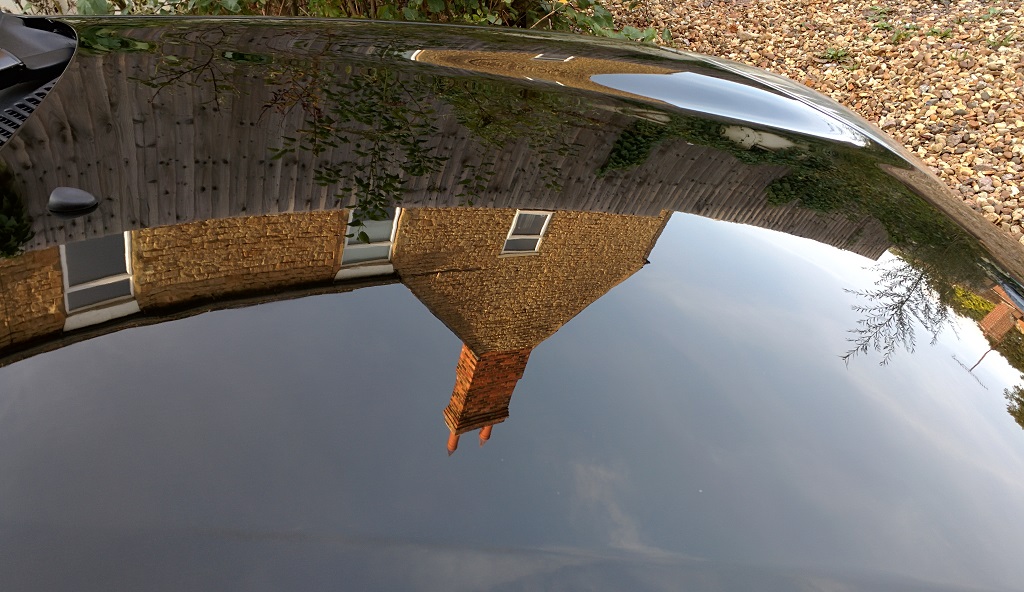

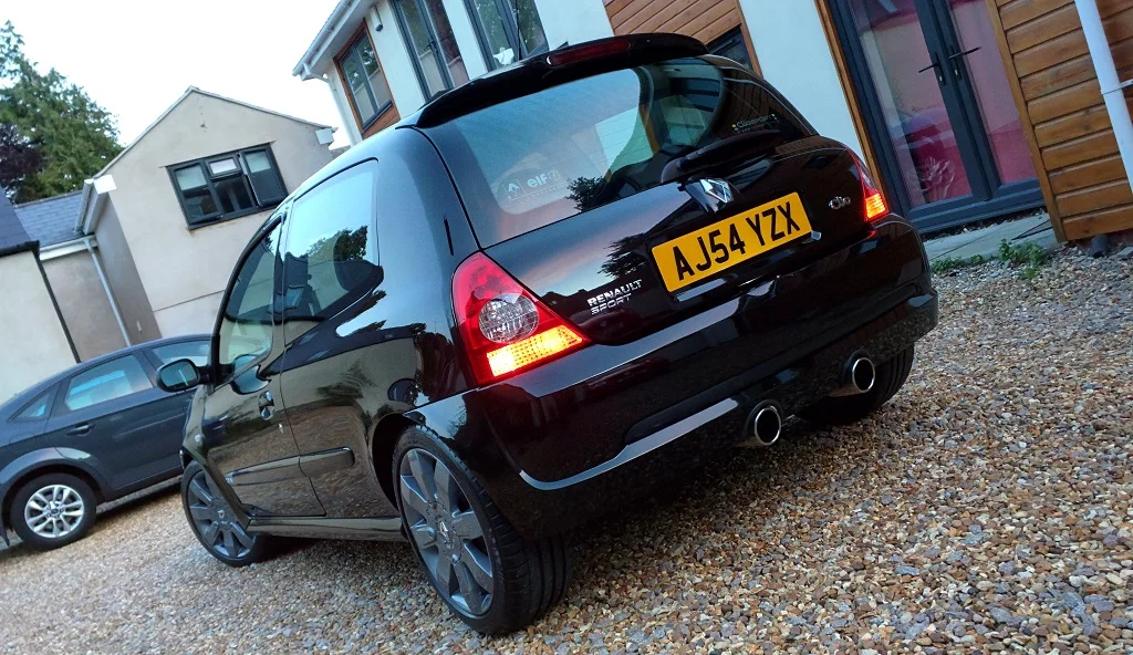

Very 2011 but tried Prima Amigo for the first time today.
I normally use tripple with a black hex pad however Amigo applied really nicely, stays very wet on the pad so easy to work in, very minimal dusting too.
Obligatory potato pics -
Gally
Looks superb. I still live Amigo I just got to the stage where it was only worth using on decent paintwork, it won't do much on tired paint imo.

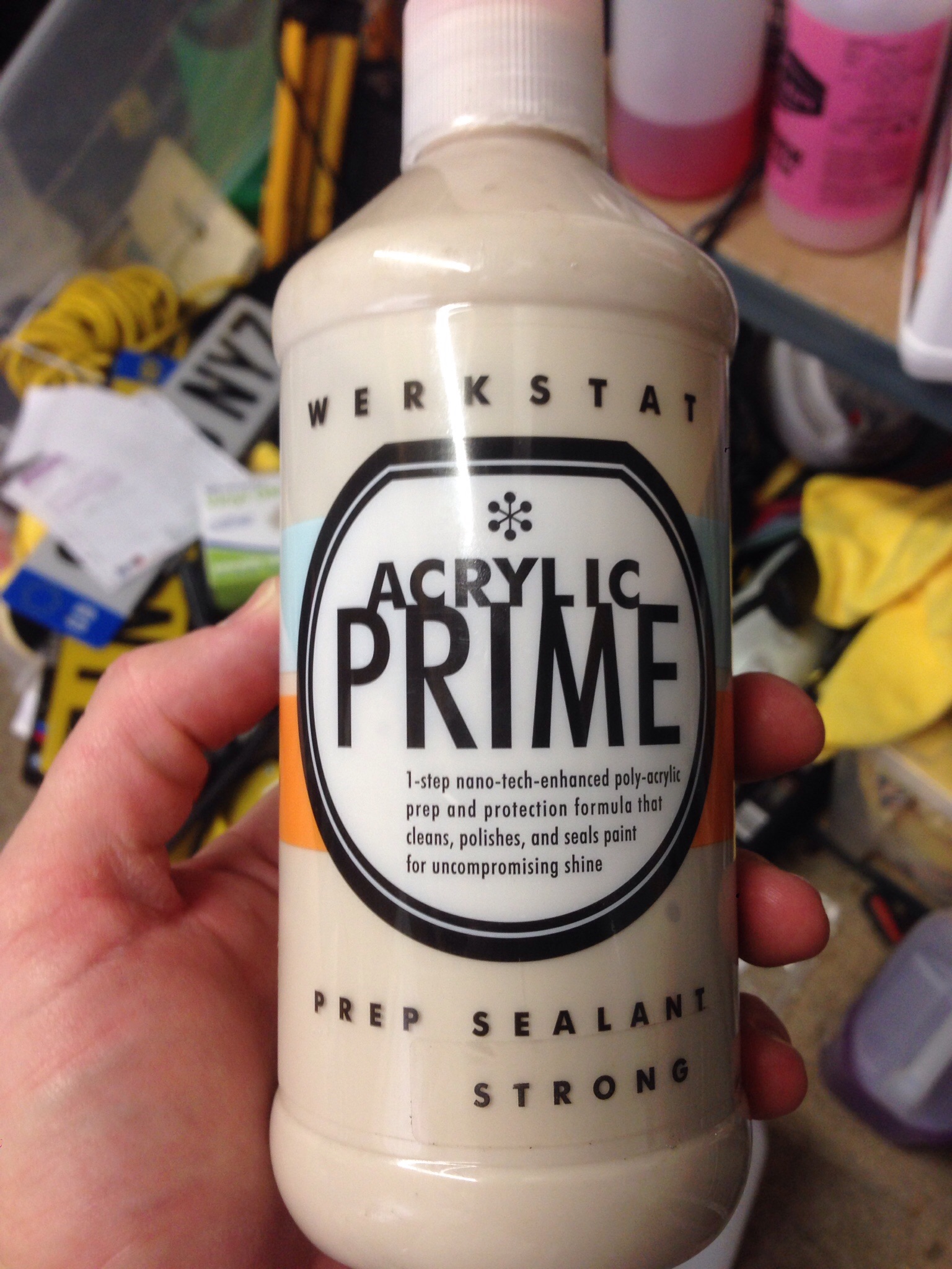

Have you ever read my threads Dave! @Sunglasses_Ron ??? I use Prime on nearly ever job I do.
Prime strong is the best cleanser you'll ever buy. They also don't make it anymore so you're holding some rare s**t! It has zero filler or abrasives. Also cleans amazing. Use it on glass it's great and leaves sealant behind.
If you had 100% corrected paint and wanted to use an expensive wax, Prime/prime strong is what I would use underneath, offers such a strong clean base. Polished Bliss used to use it in every detail almost.

Have you tried any of the Carlack stuff that Polished Bliss has replaced the Werkstat stuff with? I've still got some of the Werkstat Acrylic kit in the garage but wondered how the Carlack stuff measures up.
Gally
Years ago yes but not recently and only because I have Werkstat Prime, I also dislike the carlack branding and bottle compared with Werkstat, fickle? Yes, I will compare them soon.

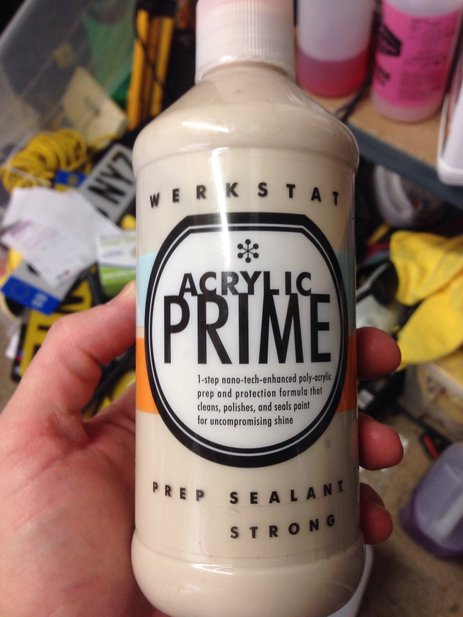

lol you've made me feel proper guilty now 😂
I've read loads of your projects but I guess I never put two and two together lol
ok so that's good to know.
I'm collecting some Swissvax wax from @RyG on Saturday so I guess I'll be using this prime and then applying some Swissvax on top.
Cheers G :up:

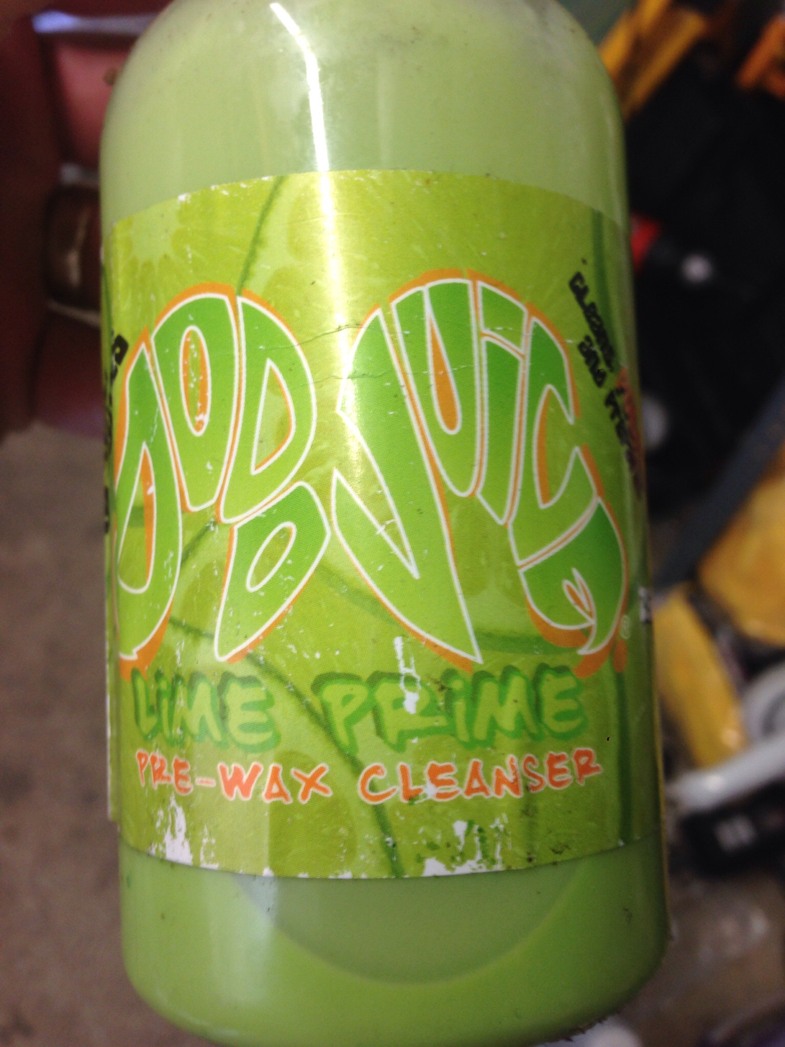

On those details where you use tripple by DA, try using lime prime. It's quite oily so found it fill ok still, but due to the abrasive in it pad dependant it can cut well also. RussZS aka midlandscarcare and Gally used to use it a long time ago for enhancement details. By hand I still prefer AF rejuvenate or tripple.
Prime is a strange one. Can really pull the dirt out and leaves a great base for general sealants. But I prefer waxing so didn't use it all that much
