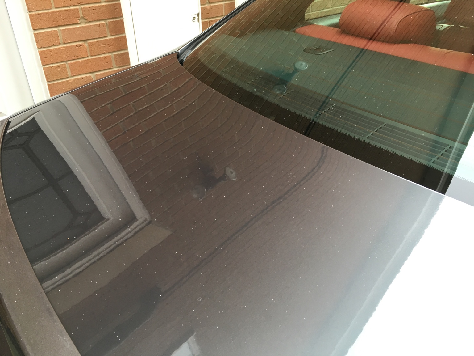

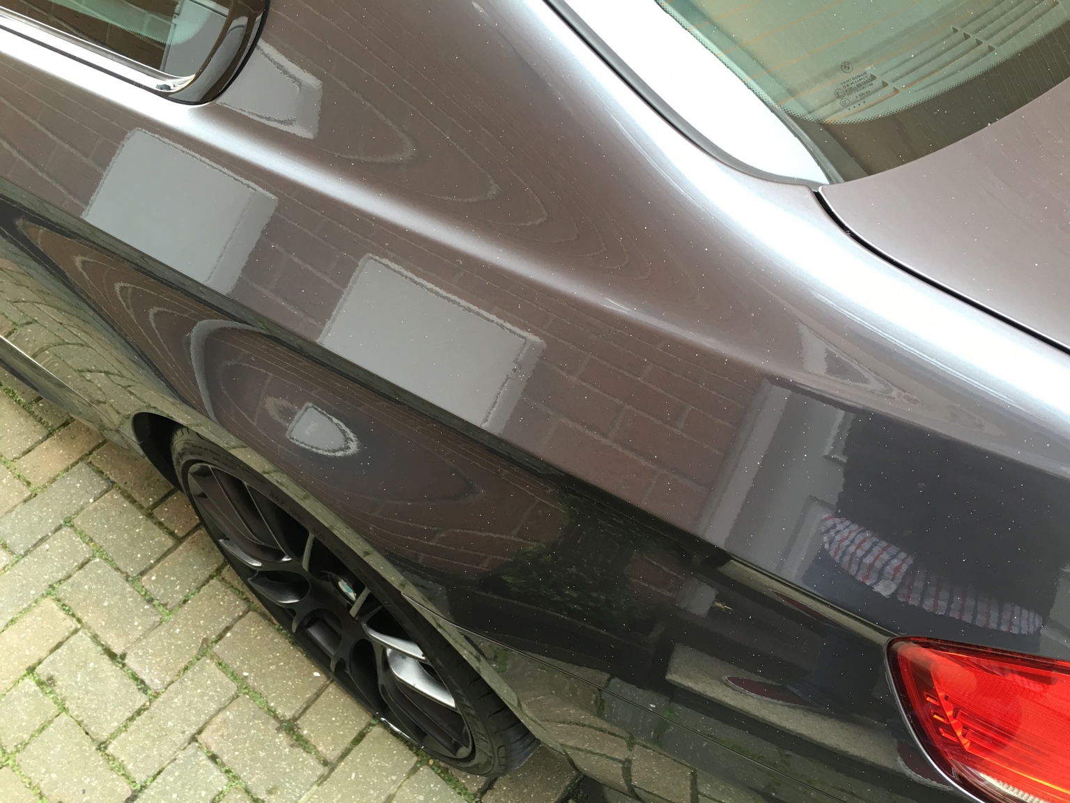

Thanks for the replies regarding the paint.
Had a word with the building owner, he'll cover any costs incurred to sort it. He then recommended a 'detailer' that turns out to be the local £5 hand wash. I'll give that a miss.
Anyway, took a patch on the boot tonight: cleaned then clayed it. It left 'marring', so then used Megs compound and finally Zaino to polish/seal.
Looks great. It's going to take me ages though, will probably do a panel a week (I don't have the time). Also, every single panel, window and alloy has it on 😧
Any other advice on the above?
(These are before I attempted any removal):
It'll be a water based paint, So autosmart tardis will shift it, Spray on panel, Wipe with microfibre and RINSE WELL. It will obvioulsy need to be polished and sealed afterwards. Ive done a few for clients who have been reimbursed by the builders/decorators and its the quickest way to remove it.

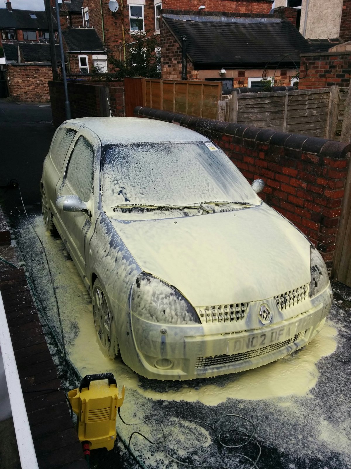

Hello experts, full on annoying amateur here.
At the weekend I decided to use, for the first time, my Autobrite SnowFoam Lance (thanks @The Russian. ) with the Autobrite Cherry stuff. Followed instructions - 1.5/2 inches plus warm water. Came to spray it and the consistency wasnt right at all. Even on the Most '+' setting the foam was still quite runny and basically ended up on the floor rather than holding on the car.
I played around with the nozzles and it didnt make any, positive, difference only making it more watery.
What am I doing wrong? Is it the product that's naff? Recommendations? Any help massively appreciated.
The product is pretty naff tbf but only because it's autoshite
Oh and you need to turn the dial the other way ;)

Well other than slating my choice - do you have a recommendation of product in that case?
The knob must be on the wrong way round then as turning towards '-' definitely makes the mixture more liquid.
Riz on my R53 I used Autofinesse Revive - an expert will probably come with a better suggestion.
I doubt it's the product, I've used autobrite snowfoam and had no problems
Can't offer any other assistance though :(
