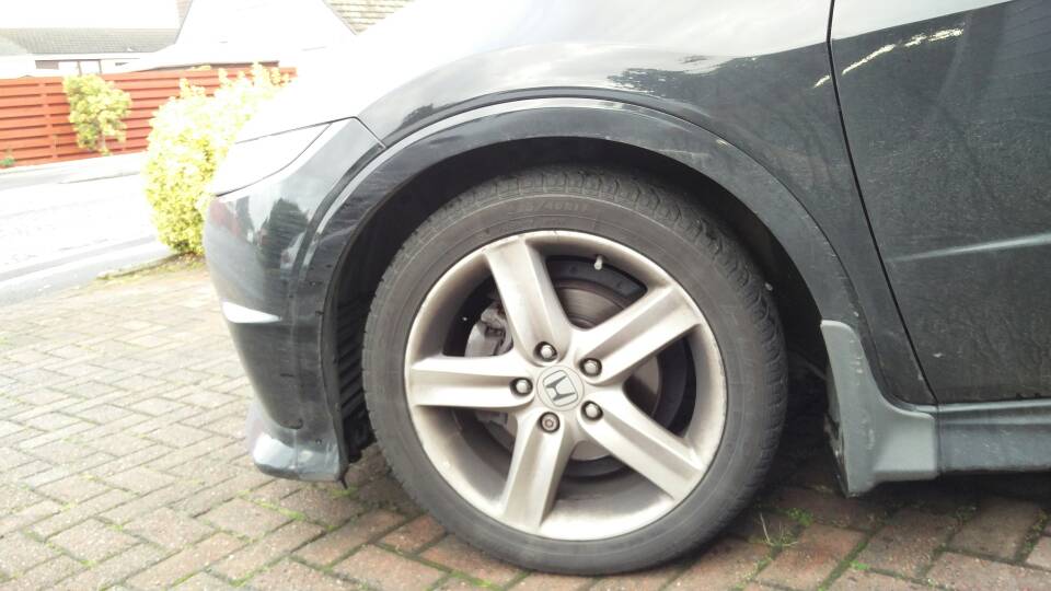

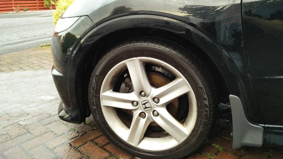

I just tried it out there anyway, diluted about 200-300ml into a 1 litre bottle (probably a bit strong but I have no LSP just now anyway so just wanted to test cleaning power).
The car hasn't been washed in about 2 months and its left it very clean looking for just a quick going over!
I'll get a few photos once it's dried a bit since it always looks cleaner while wet.
OK ignore that idea. It's too dark now lol!
So this was before. It almost wasn't black anymore...
And then after using autofoam at the dilution I mentioned:
Photos from a distance don't really show much hence why I've not got any of the full car, however, I'm very impressed by it!
Use 8:1 in a decent pump sprayer also for epic cleaning ability!

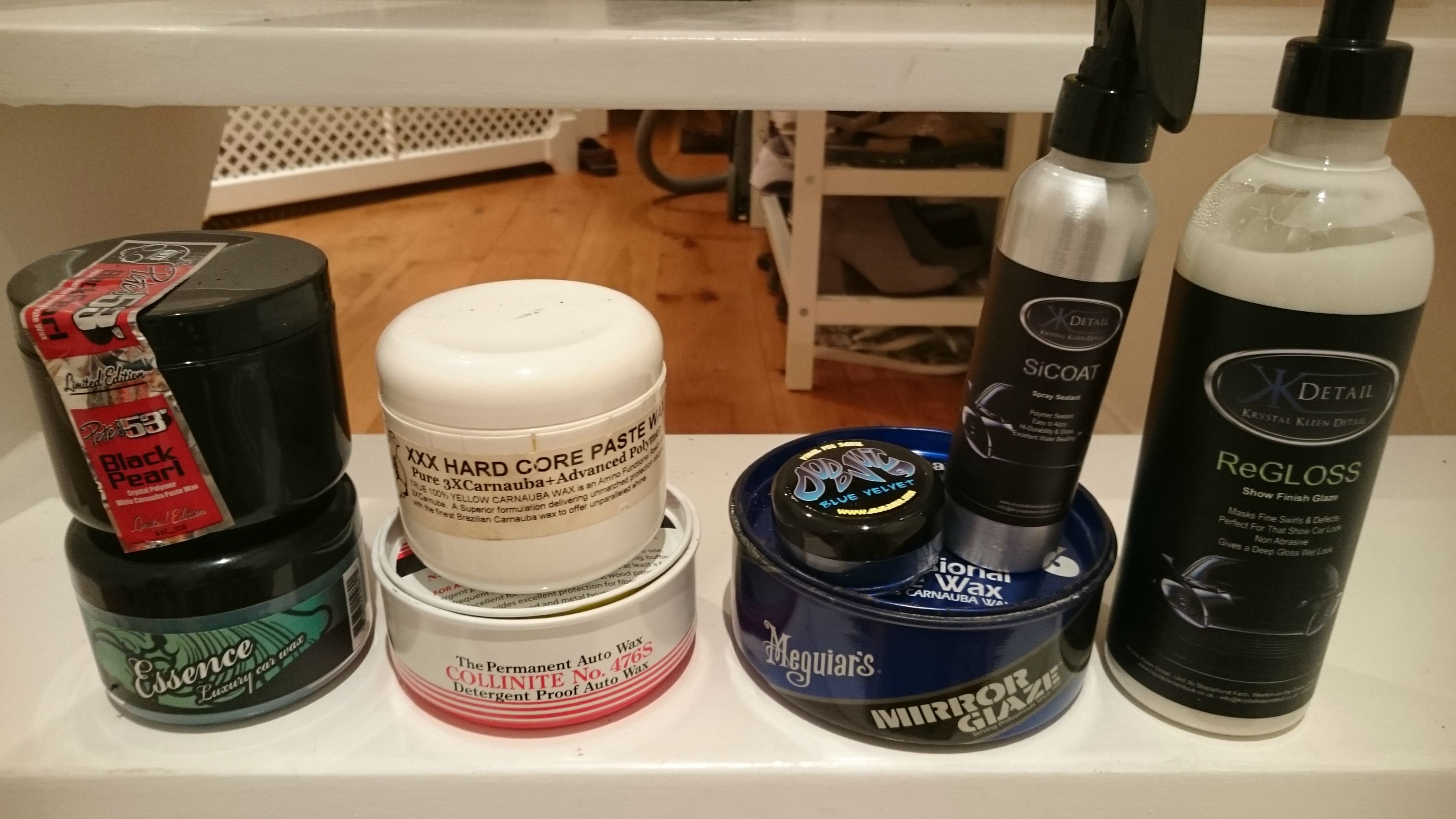

So I have spent way too many hours machine polishing a petrol blue 182. I have gone through wet sanding any deeper scratches, meguiars ultimate cutting compound and then 4 different Menzerna polishes and a range of hex logic pads until the paint had a complete mirror finish. Ive never spent this long on a car but now that I have a nice garage it has been quite enjoyable to spend a few hours a day on it without rain or weather screwing things up.
Im now at the stage where tomorrow I plan on using bilthamber cleanser just to get rid if any oils from the polish and also any glue from when I remove the masking tape. I now need to wax the car and that is where I am a bit stuck. Usually on my black 182 its an easy choice - black hole followed by collinite if its winter or chemicals guys XXX wax if its summer.
I have these waxes at the moment and they are all pretty low budget choices. As I have spent so long on the polish and prep I want to try some decent wax.
Ive never opened the Essence wax and wondered how good this is?
Any help appreciated.
Do you drive the car in winter?
Either way, I think you need a strong base, followed with a nice wax.
Something semi-permanent, CQUK etc..

It's a bit of a shame you have to use one of those on what sounds like a flawless finish.
Megs #16 2 layers for me. Esscence or 53 might look the best but won't last at this time of year.
New age sealants are king now due to their ability to keep cars cleaner for longer and keep the fresh look there.

That #16 must be 10 years old. Used to quite like it lol.
Really could do with a point in the right direction. Im up for buying what it takes and was hoping you could tell me what to buy. I dont mind if it doesnt last ages and am looking for a beautiful finish more than anything. What would you suggest. Dont want to spend more than 200.
And after the hours you've put it, you may as well put something hard on top. Then follow it with something nice for devilment / looks.
I like layers.

Has JD still got his small pot of BOS for sale?
That would be ideal over some CQUK/STRATA/Whatever
What does CQUK and BOS stand for ? will go and have a look at what you have suggested, much appreciated!
Sorry dude,
CQUK = CQuartz UK, a semi permanent sealant. Just an example, there are plenty available. It reall would be a shame not to protect your hard work with something durable.
STRATA is the Migliore equivalent, there are several on the market, I haven't stayed up to date in the last year though..
BOS= Swissvax Best Of Show. In terms of show waxes, there's few I'd choose over it.
Like it said, you've put in the graft, so the final 5% will pay dividend more than most dividends.

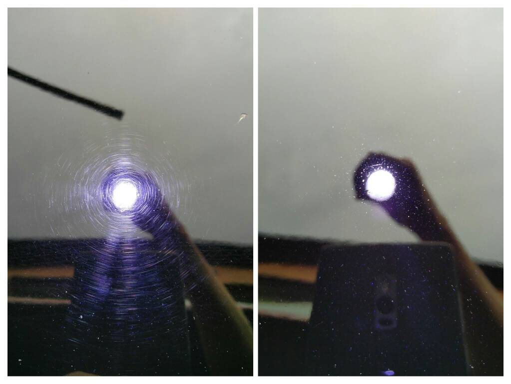

Bit of recent polishing done on the daily. White hex pad and Menz SF4000 (106FA on the old school naming I think). Was amazed at how much correction there was from a combo with such a low level of cut.
There's a few deeper marks left, anyone any ideas as to what combo I'd be best moving to? Harder pad or higher cut polish? Or just another pass with the same pad/polish? It's clearly very soft paint and I don't want to go through it!
Nice correction there!
How many passes did it take to achieve that? Have you measured the paint to see how many microns those passes have taken away? Also is that second picture cleansed to reveal the actual correction?
If that was only a few passes and actually corrected that well i'd probably stick with that combo as the paint is clearly very soft.

That was about 3 passes I think. Spread the polish about then went over it twice by which point the polish residue was pretty much disappearing before doing a final light pass. That second picture wasn't cleansed though, forgot about that! Don't have access to anything to measure paint depth either. Never been an issue in the past but might need to try and find one for this since its so swirled.
It's a Honda civic. Paint is in shocking condition just now lol.
Yeah you can't go heavier stu as it will inflict it's own marring, i'm surprised the white hex hasn't left marring actually.
