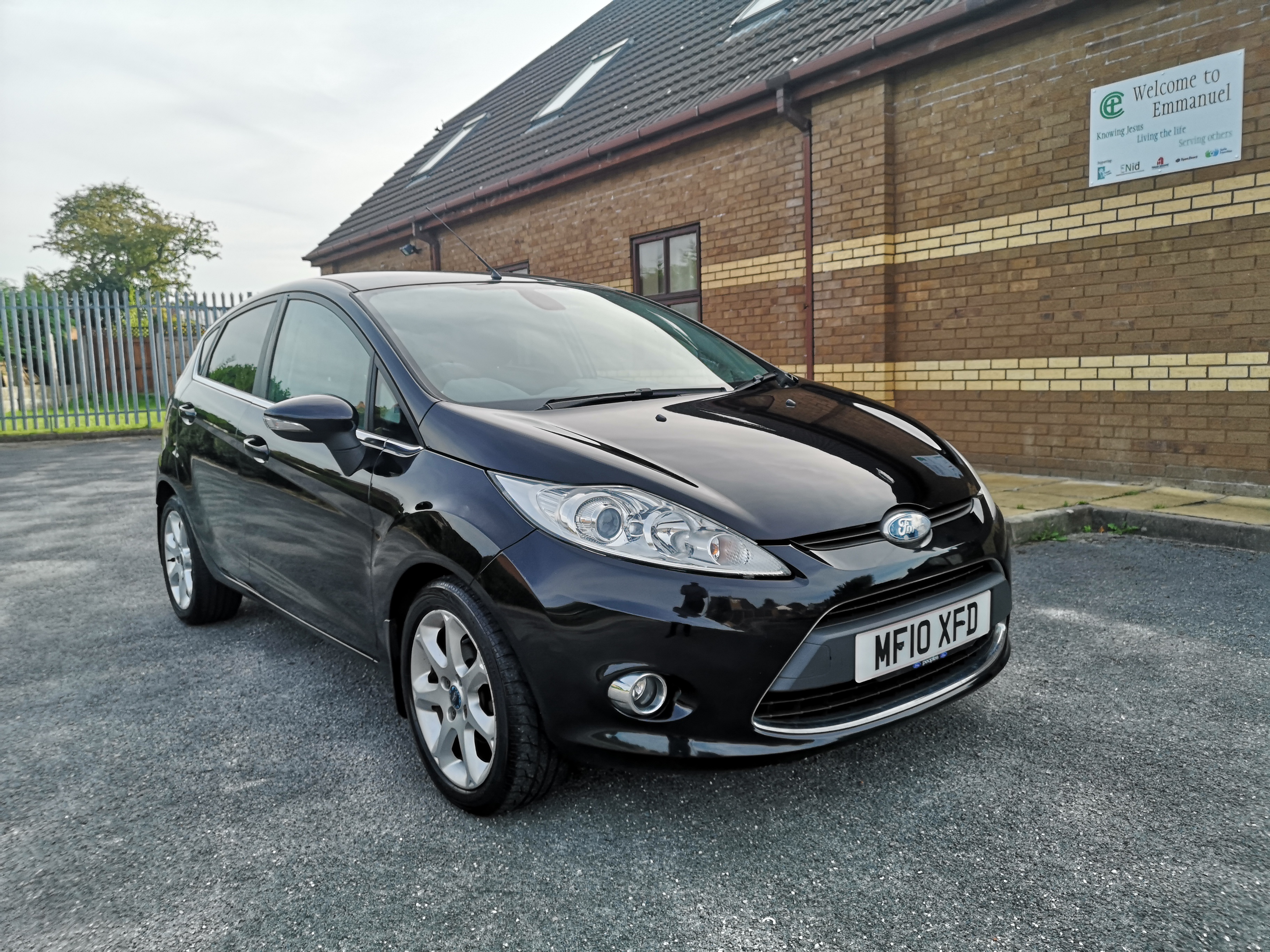

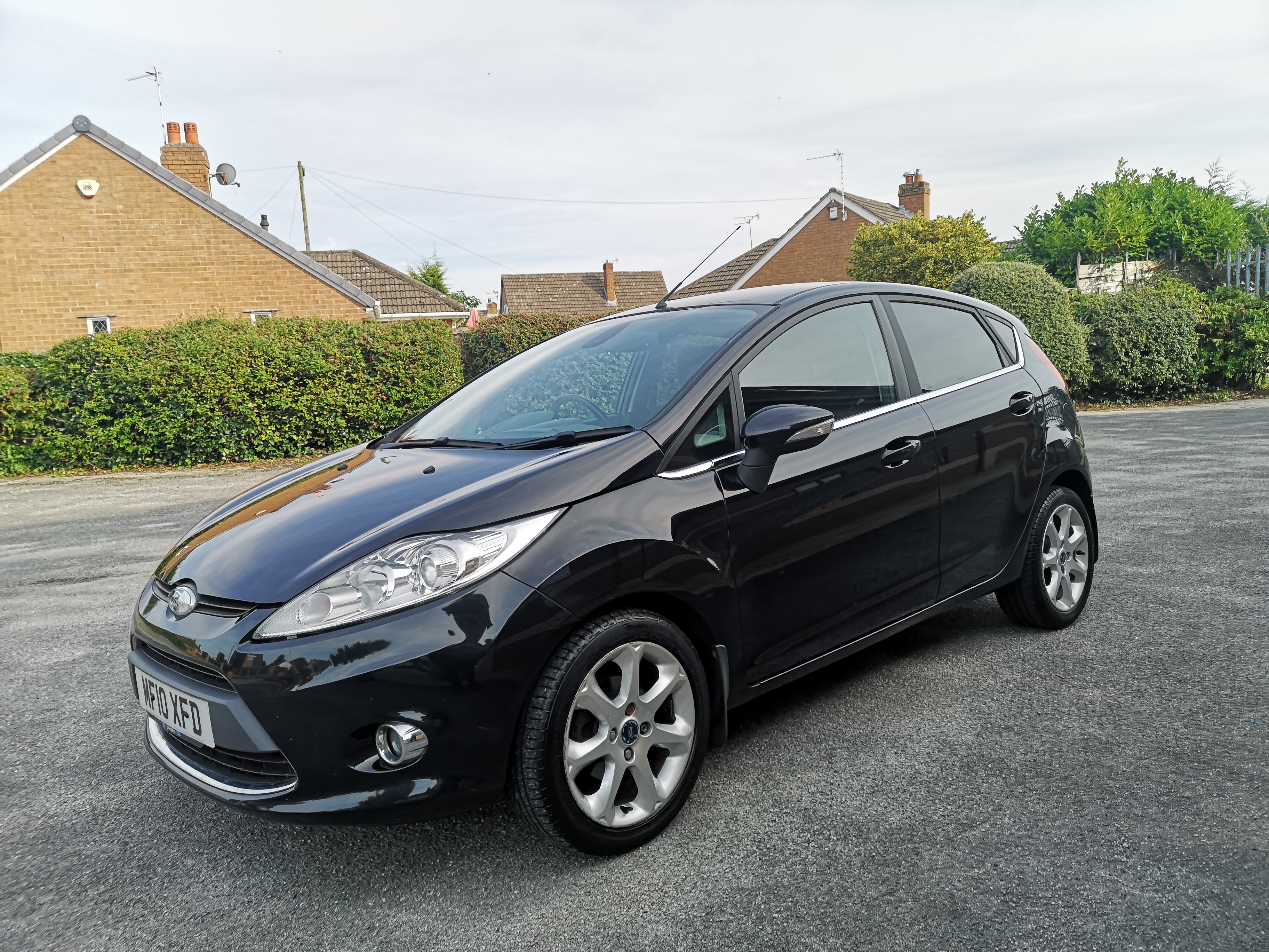

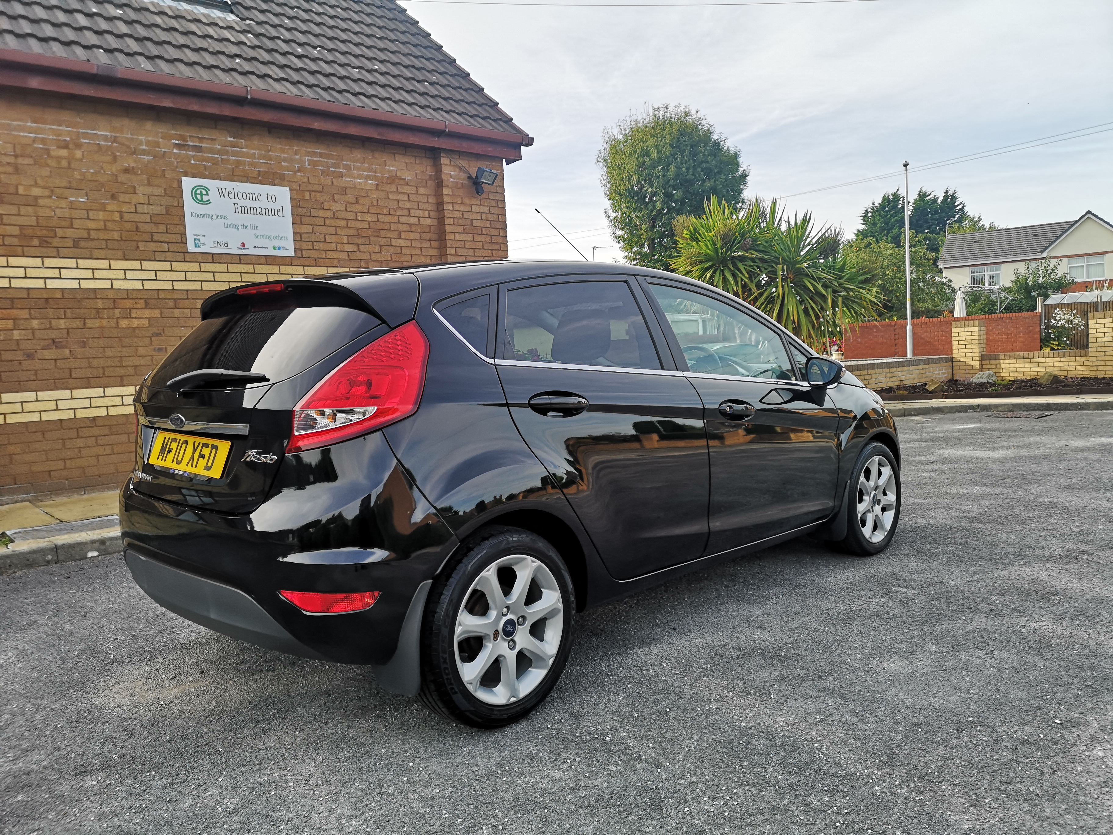

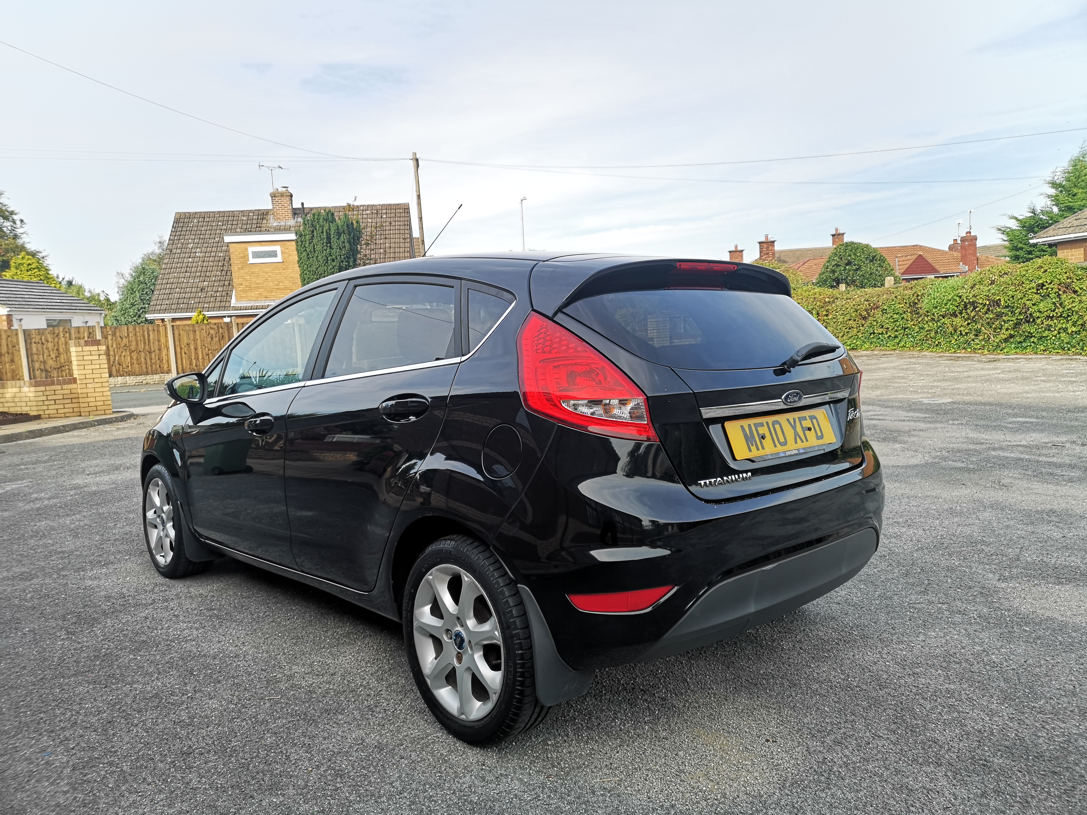

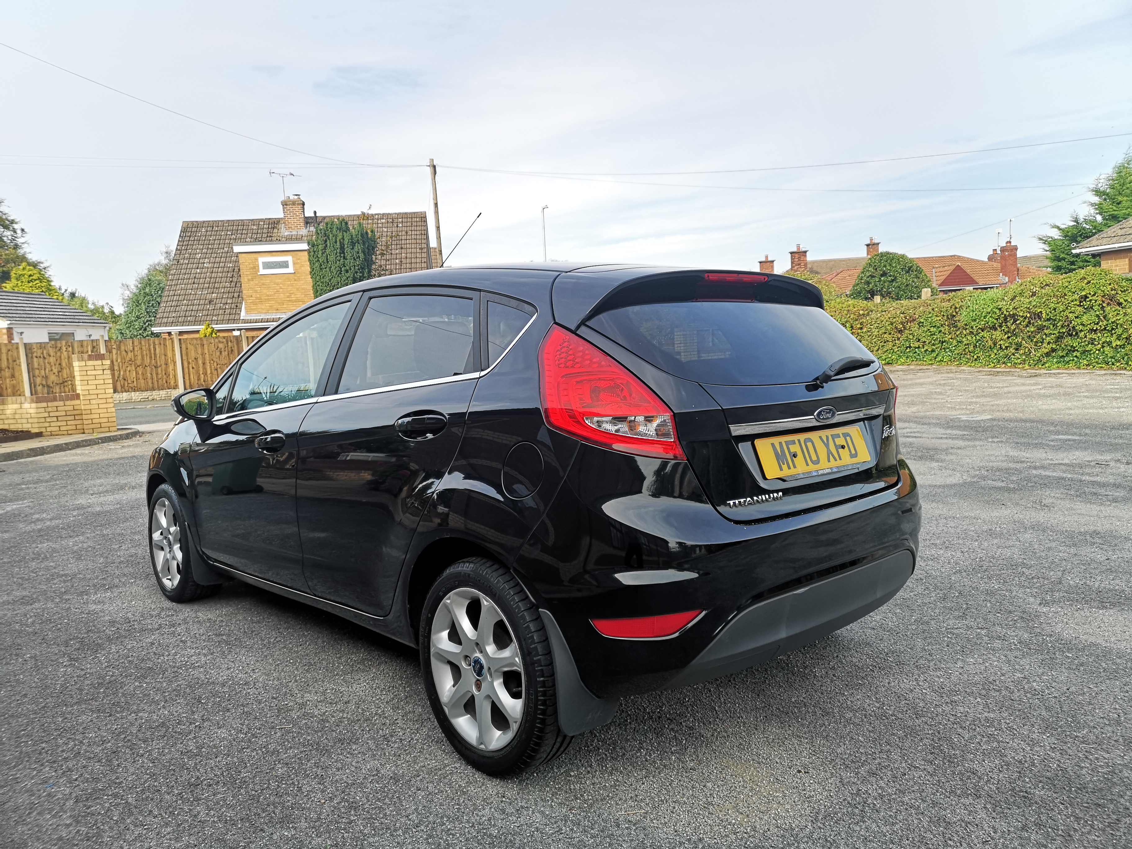

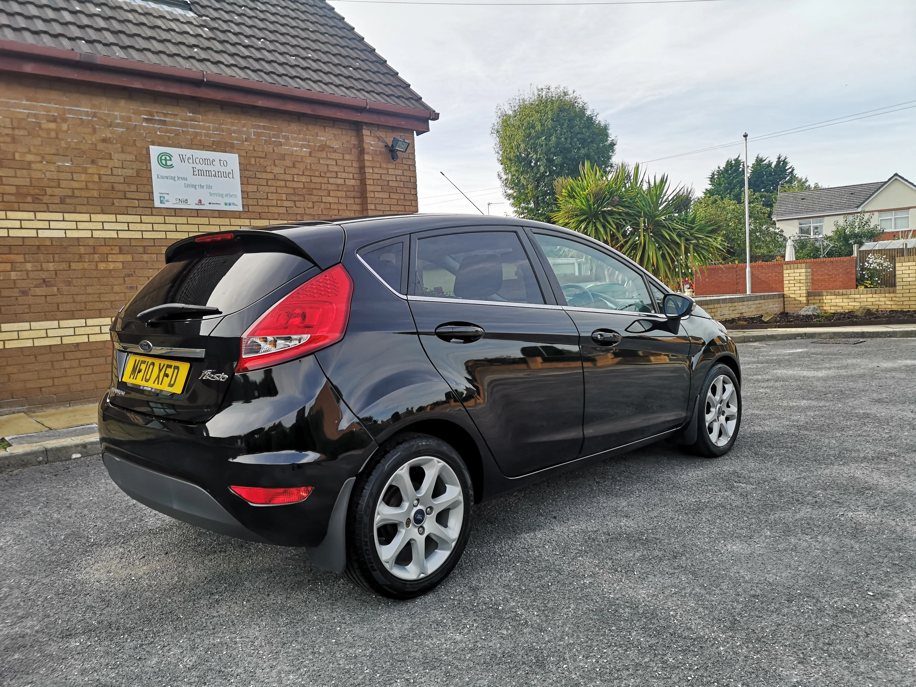

Really should have taken a before. This came in part ex and was faded badly. Srp was hard work so whacked out the flex, green quantum pad and detailed kingdom final polish. And two layers of @Hxrry detail spray, tis very good. 👍👍

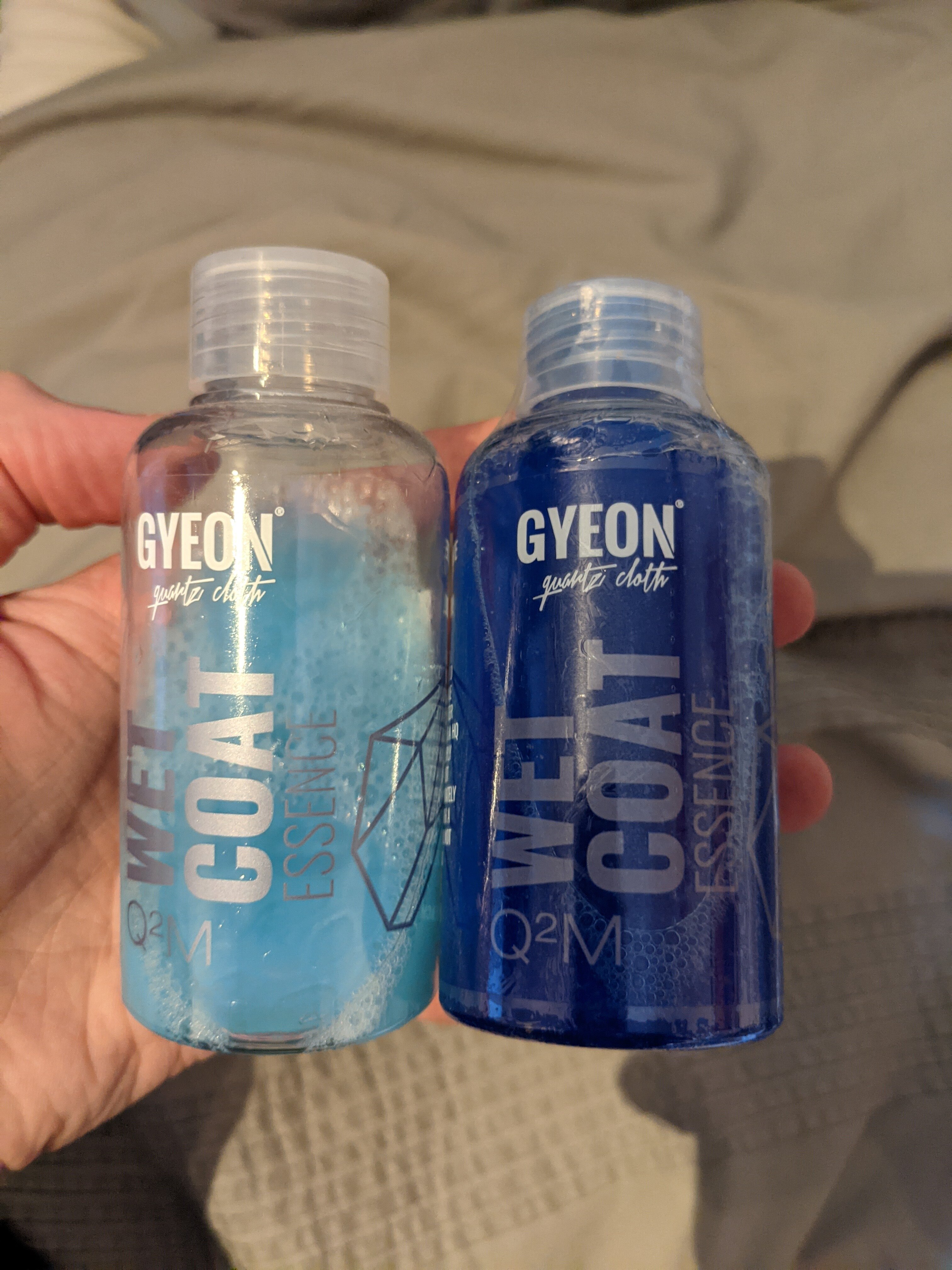

Already used a 500ml mix of the light blue/older one. Mixed at 1:9 with di-ionised water and it's been fine.
The ready mixed Wet Coat is close to 1:8 apparently and i have had one occasion of that spotting but i put that down to me, it was slightly warm and i sprayed the whole car before rinsing off. I now do sections at a time.
Keep giving it a shake too, to keep it mixed.

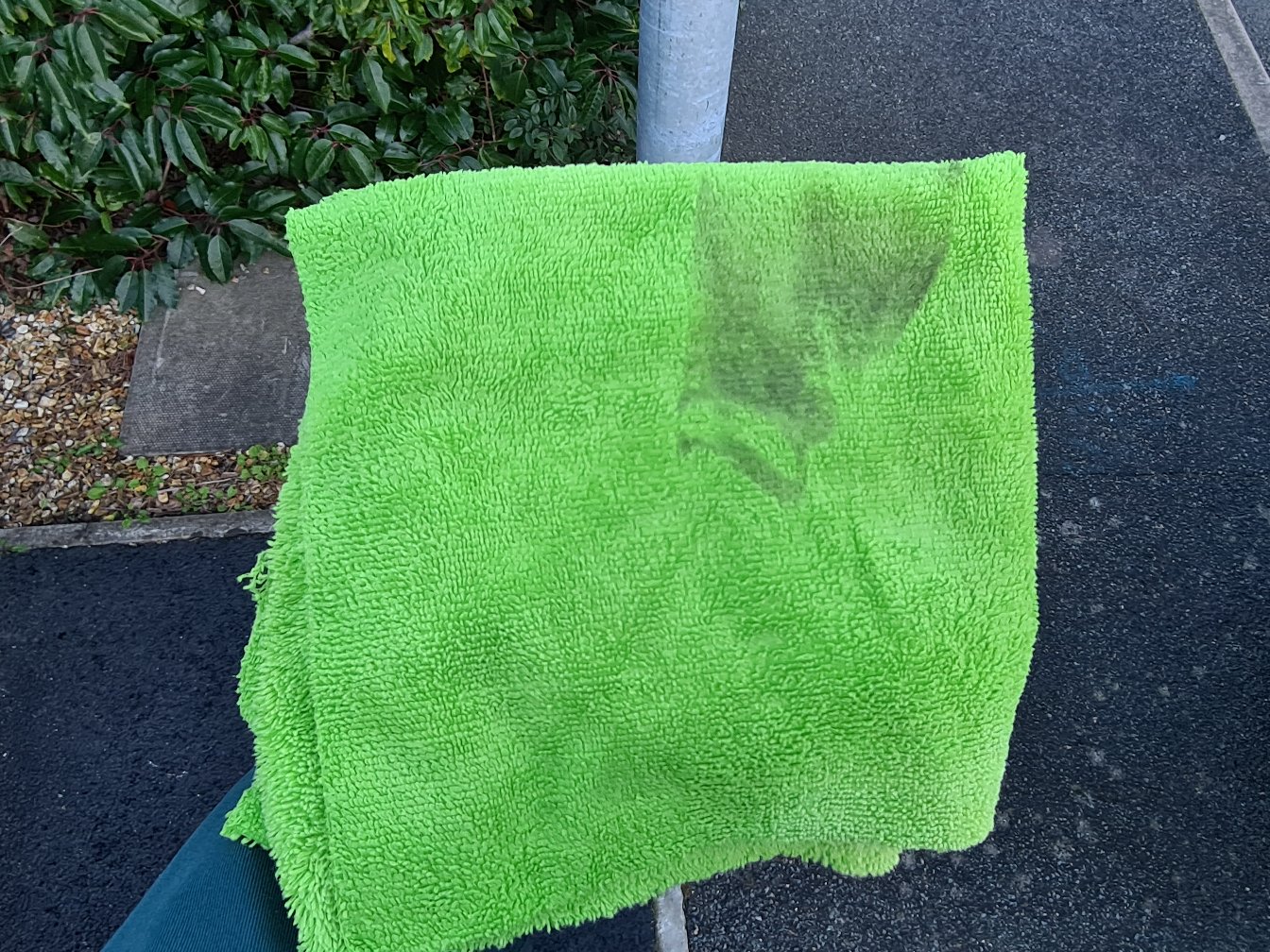

Like that, 4% PIR, best foam I've tried so far.
I can foam a car 2 or 3 times from a full foam bottle so get 20 washes out of a 5 liter container. Only use it in winter so not too bad really.
Not sure if it says in the container but it doesn't need to be soaking wet. Using it in a pump sprayer greatly reduces product use.

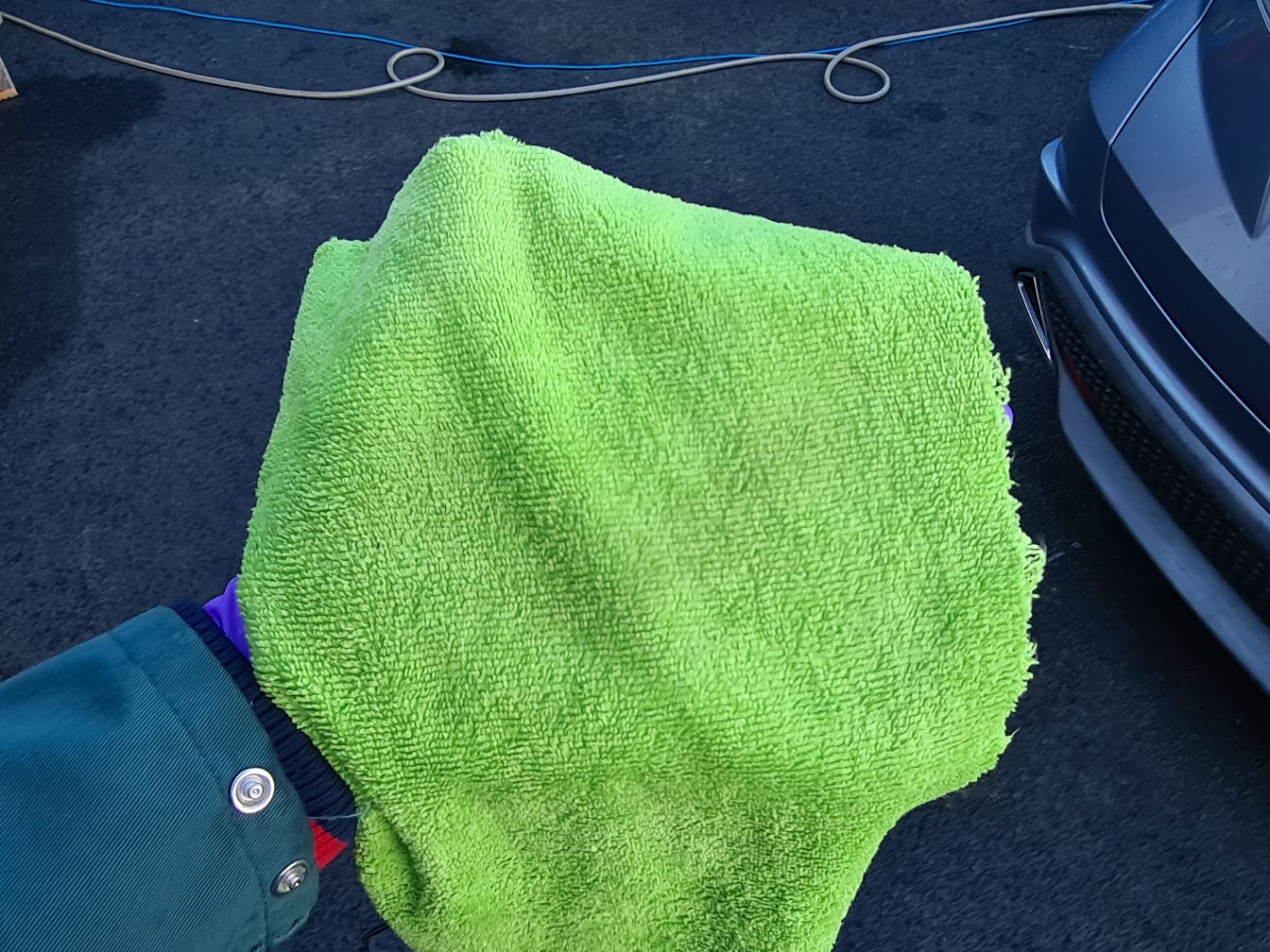

Wipe after soak and rinse of half a bumper sprayed with auto foam
Wipe of the rest of the bumper that was just pressure washed off.
