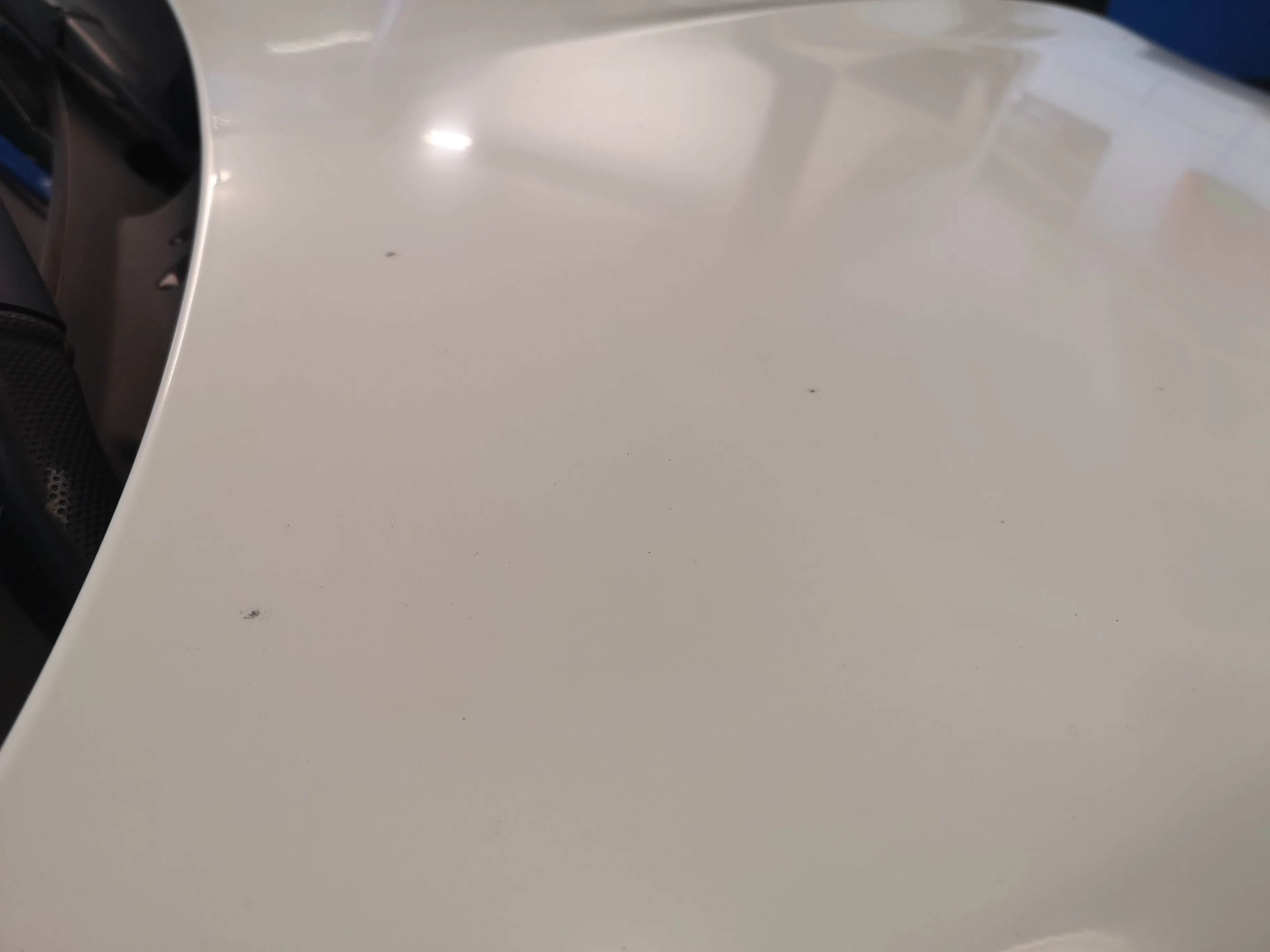

Noob here looking for a product to remove oxidation from white (single stage ?) paint.
I went over a panel with super resin polish and it has improved it slightly, however now rather than a chalky flat roof I have a mix of shine, oxidation and a finish that looks like polish that has dried, although that’s not the case I removed it immediately.
Wish I’d not bothered 😂
I’d like to sort it this week, so wanting something I can get from Halfords or Amazon.
Contenders are:
G3 Pro Colour Restorer
G3 Advanced Liquid Com
Maguires Ultimate Compound
I have a cheapy machine polisher that I’ve never used which I can have a stab at. Alternatively not afraid of hand polishing.

Out of that selection id go with the Megs stuff purely because ive seen it work pretty well. The one thing you wanna watch for is residue control. If its single stage paint that heavily oxidised your pads will clog pretty fast. Either blow them out or use a pad brush after each set. Id recommend watching some of Ammo NYCs videos, he's done a few about clearing up single stage paint that are actually decent. Things like doing a 'mow down' pass to remove the bulk of the oxidation to avoid clogging pads up.

Give it a blast. That one seems popular albeit with a smaller backing plate and pad.
The one that came with it is bloody huge, so I did buy a smaller one and backing plate. Not got a lot to lose, I’ll give it a tickle and see what happens.

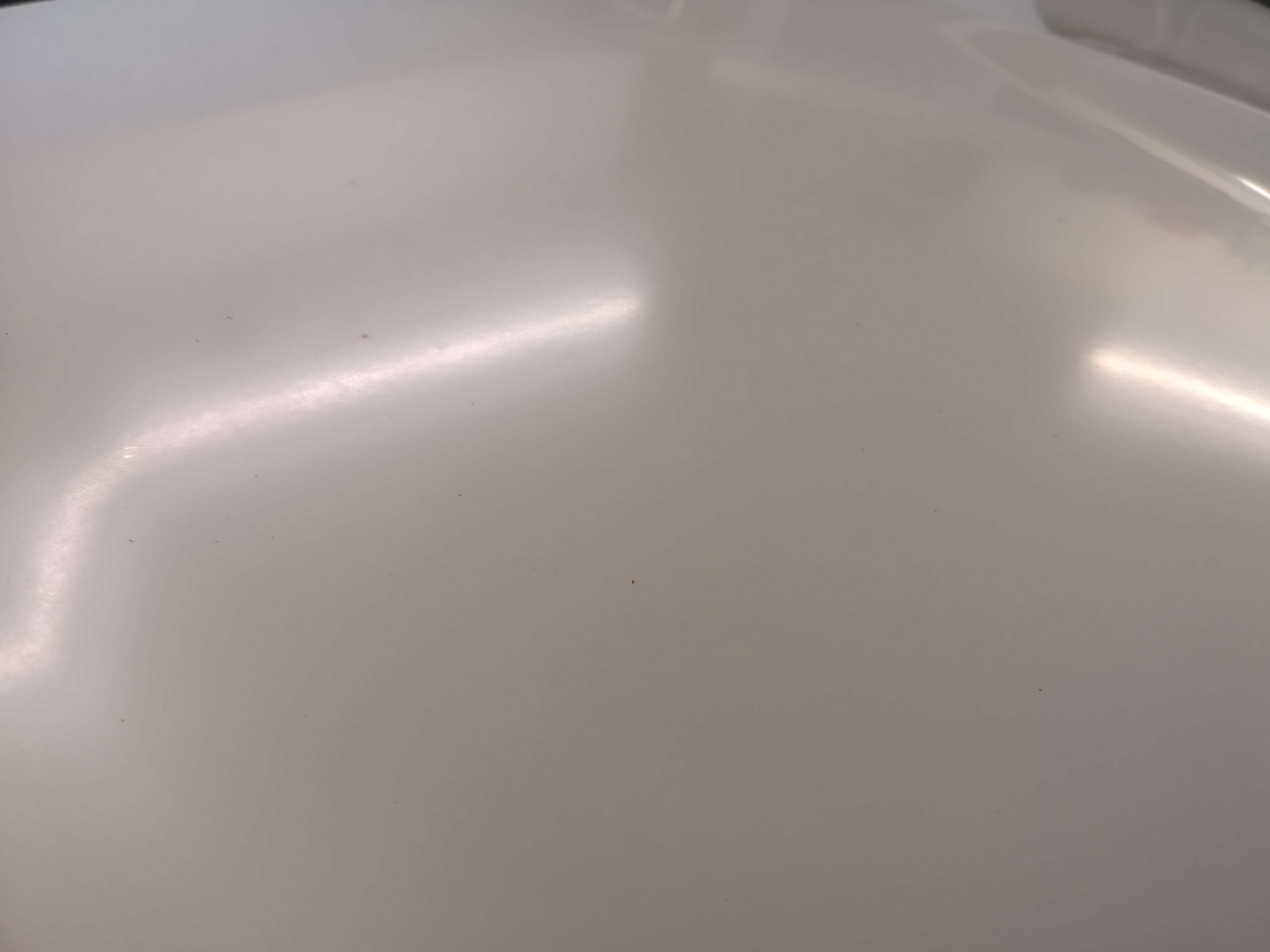

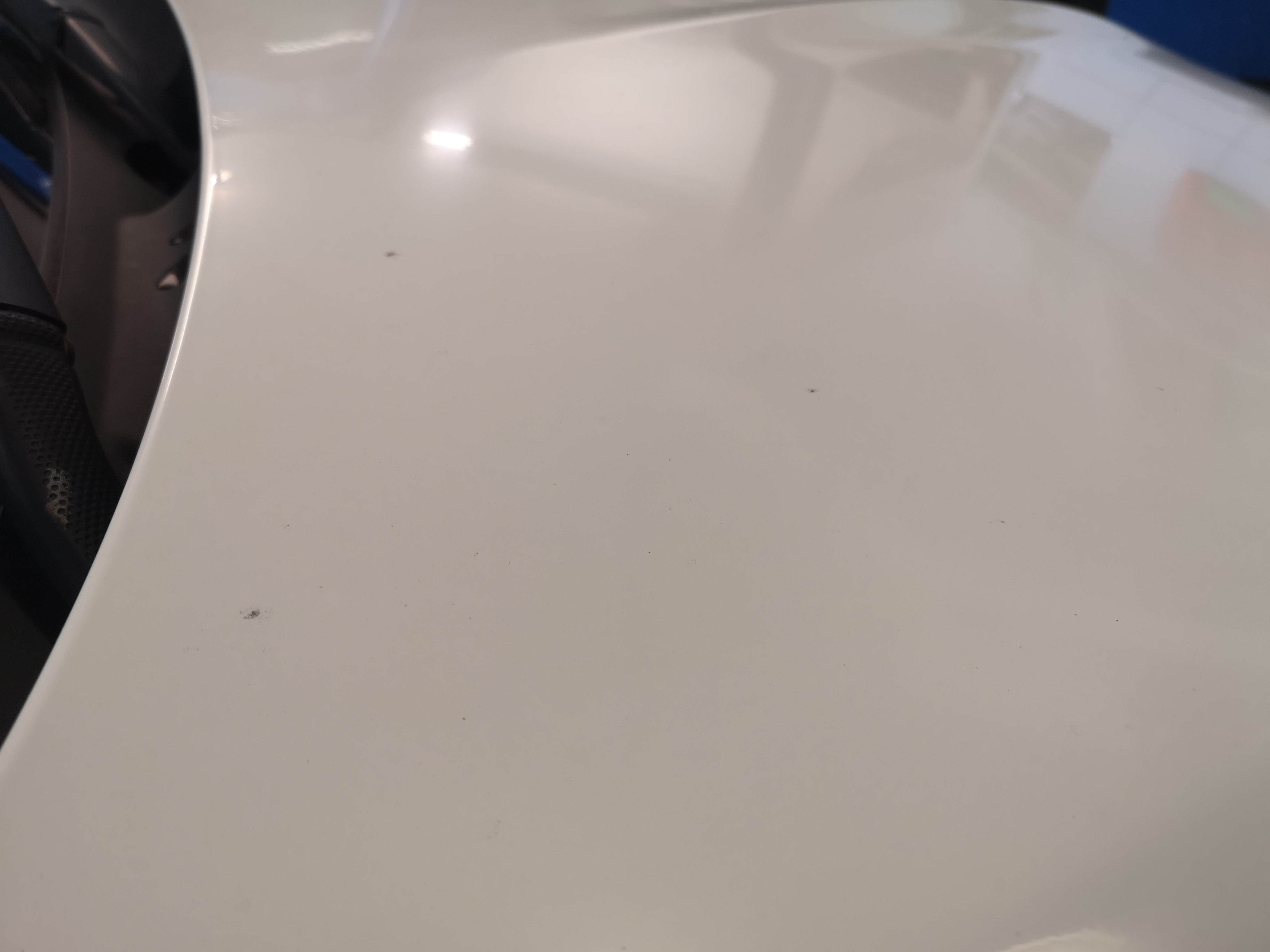

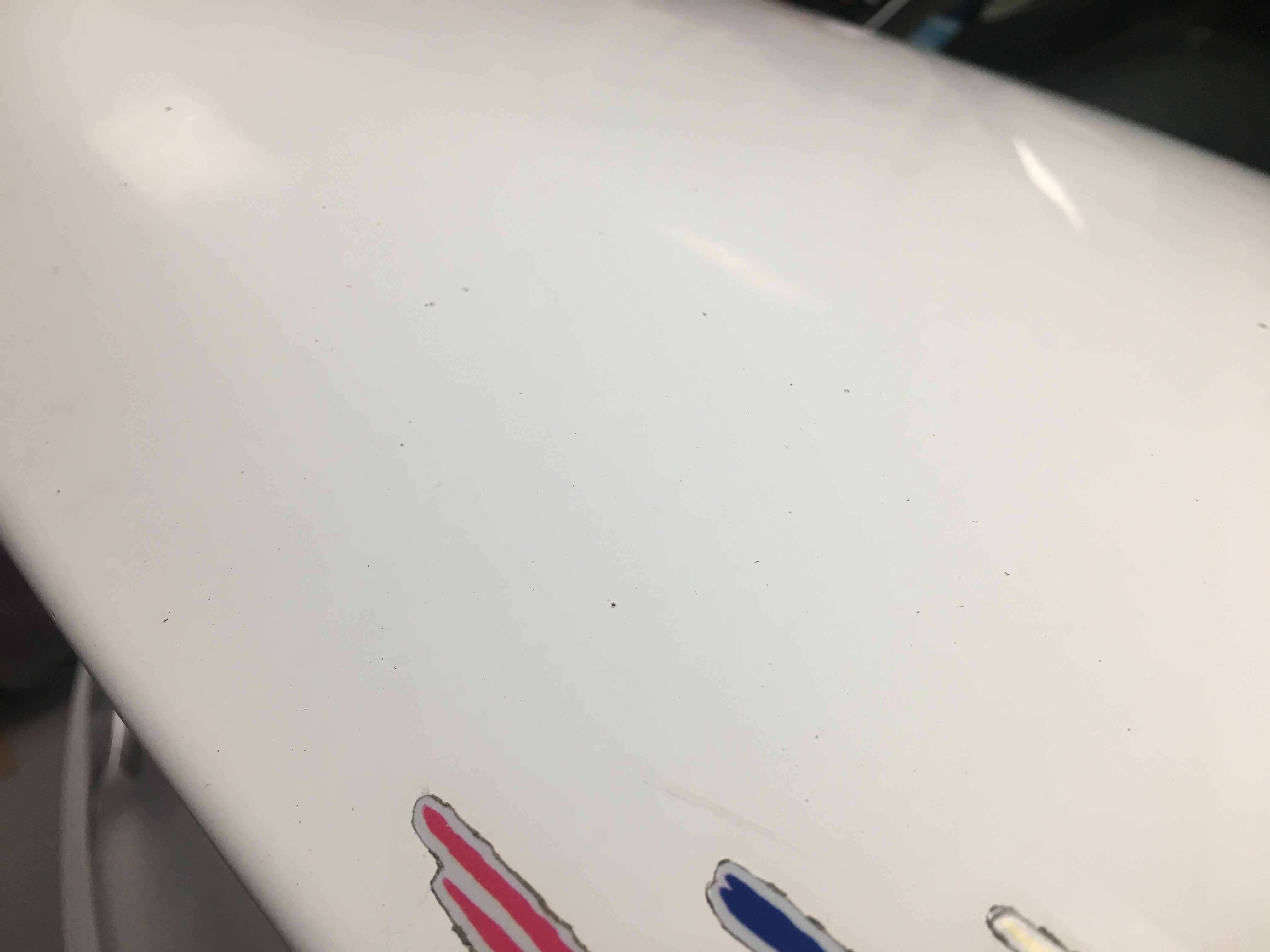

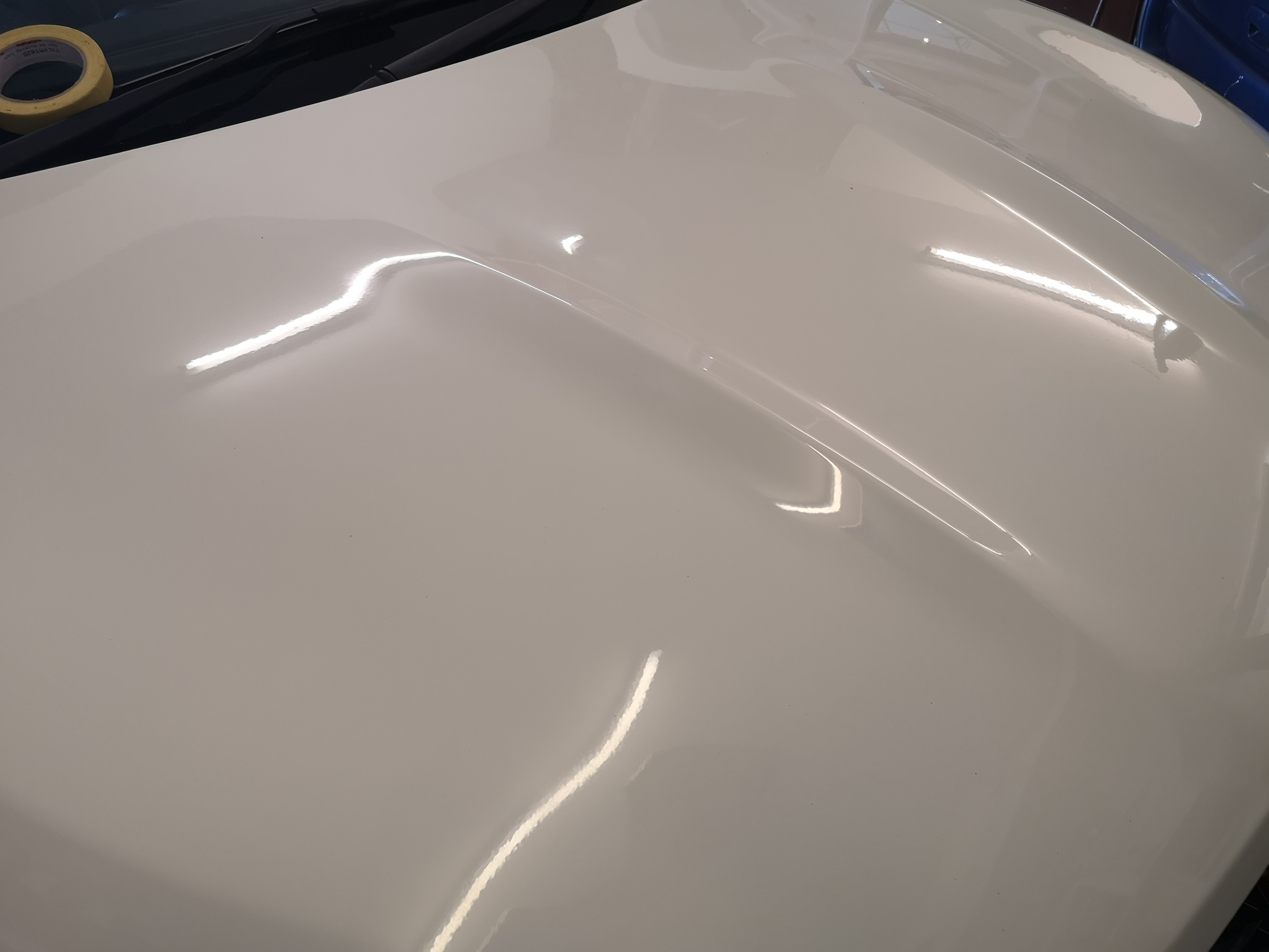

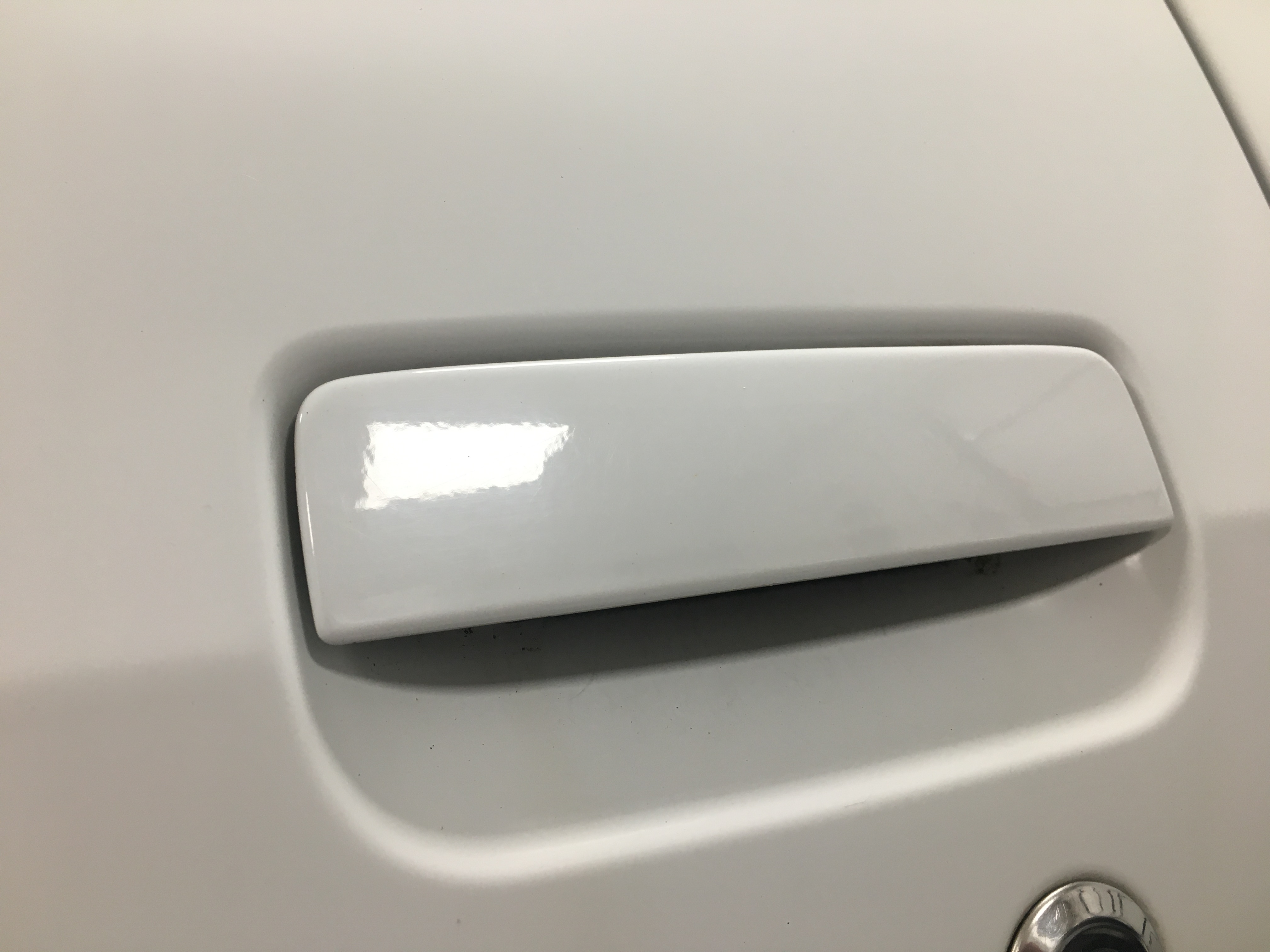

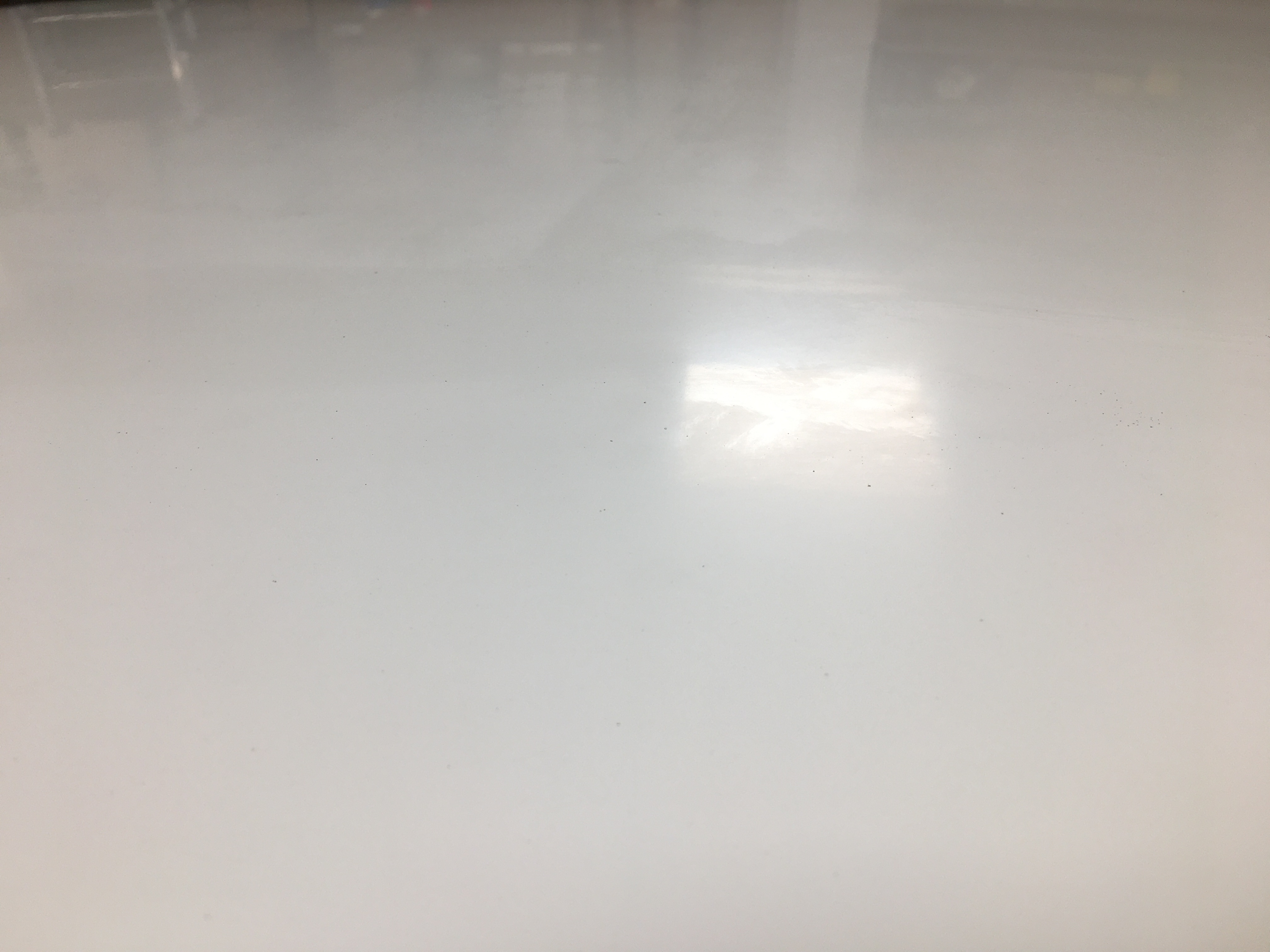

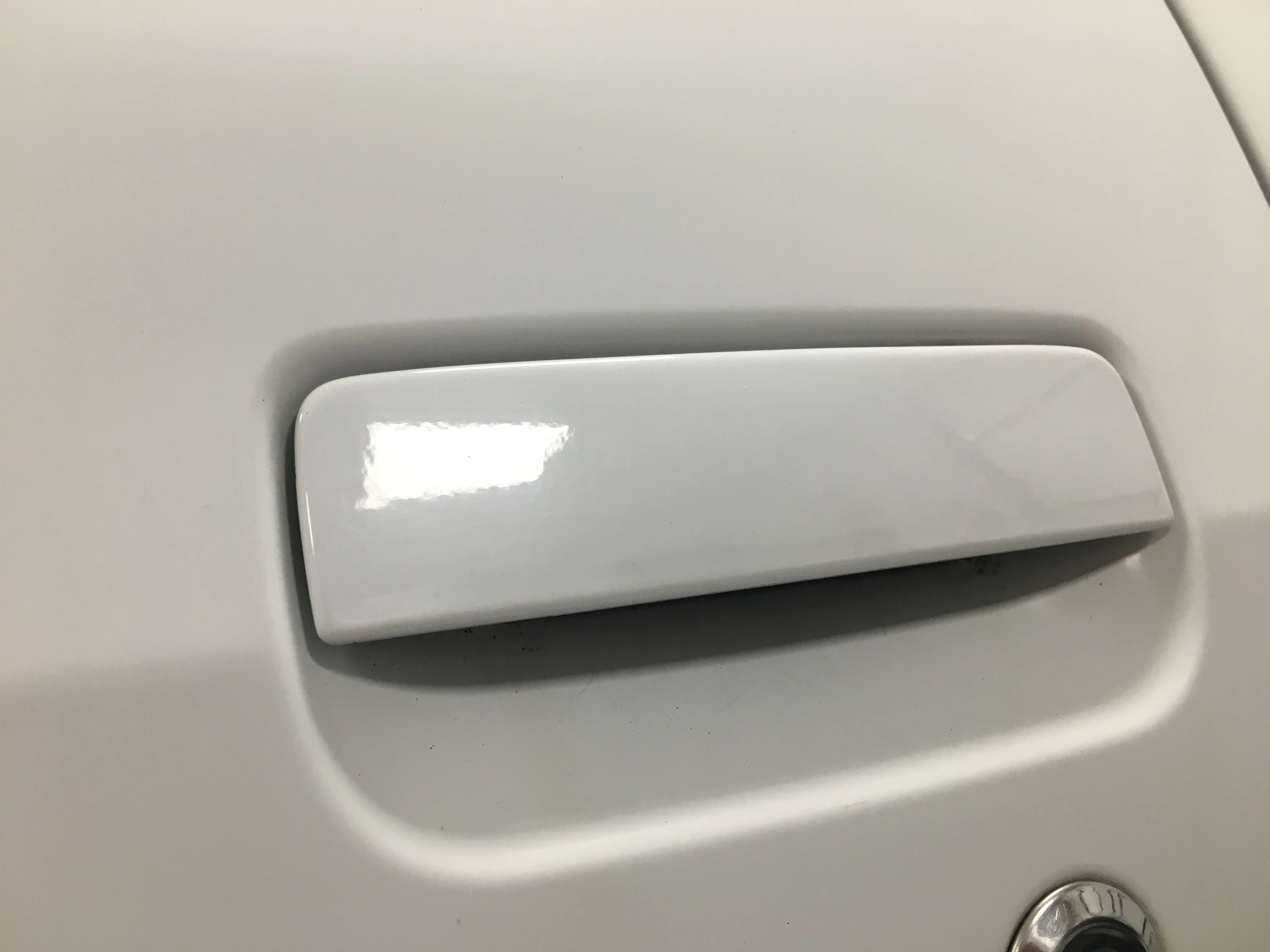

Very difficult to photograph flat white paint, especially under artificial light. It’s 23 year old Peugeot white.
This is the roof after going over it a couple of times. Was totally Matt before.
Contrast showing where the handle hasn’t faded, nor has most of the lower side. It’s the roof bonnet and typical horizontal surfaces that have suffered over the years.

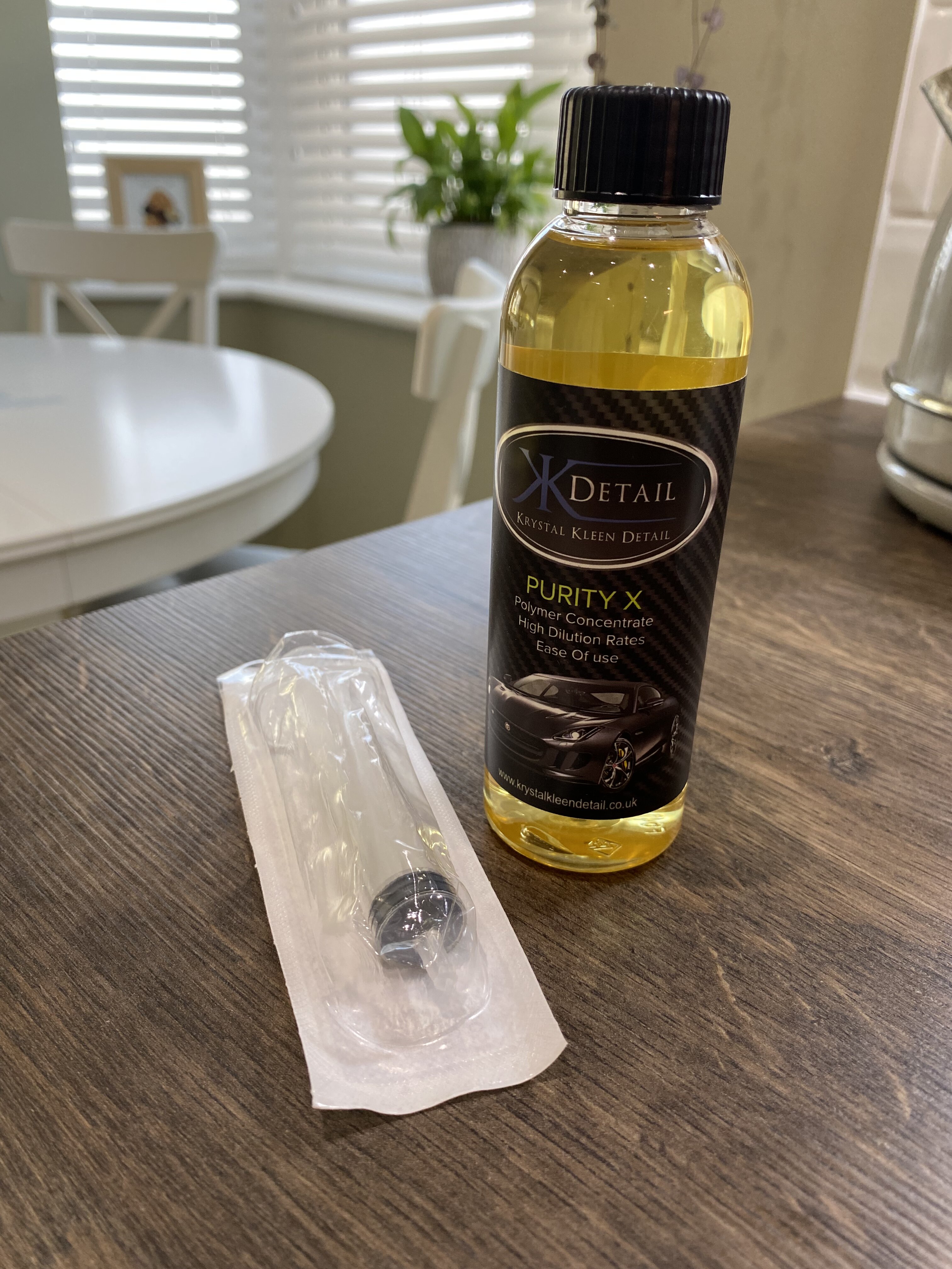

You know the ratios are ridiculous when a product turns up with a syringe to measure it out 😂

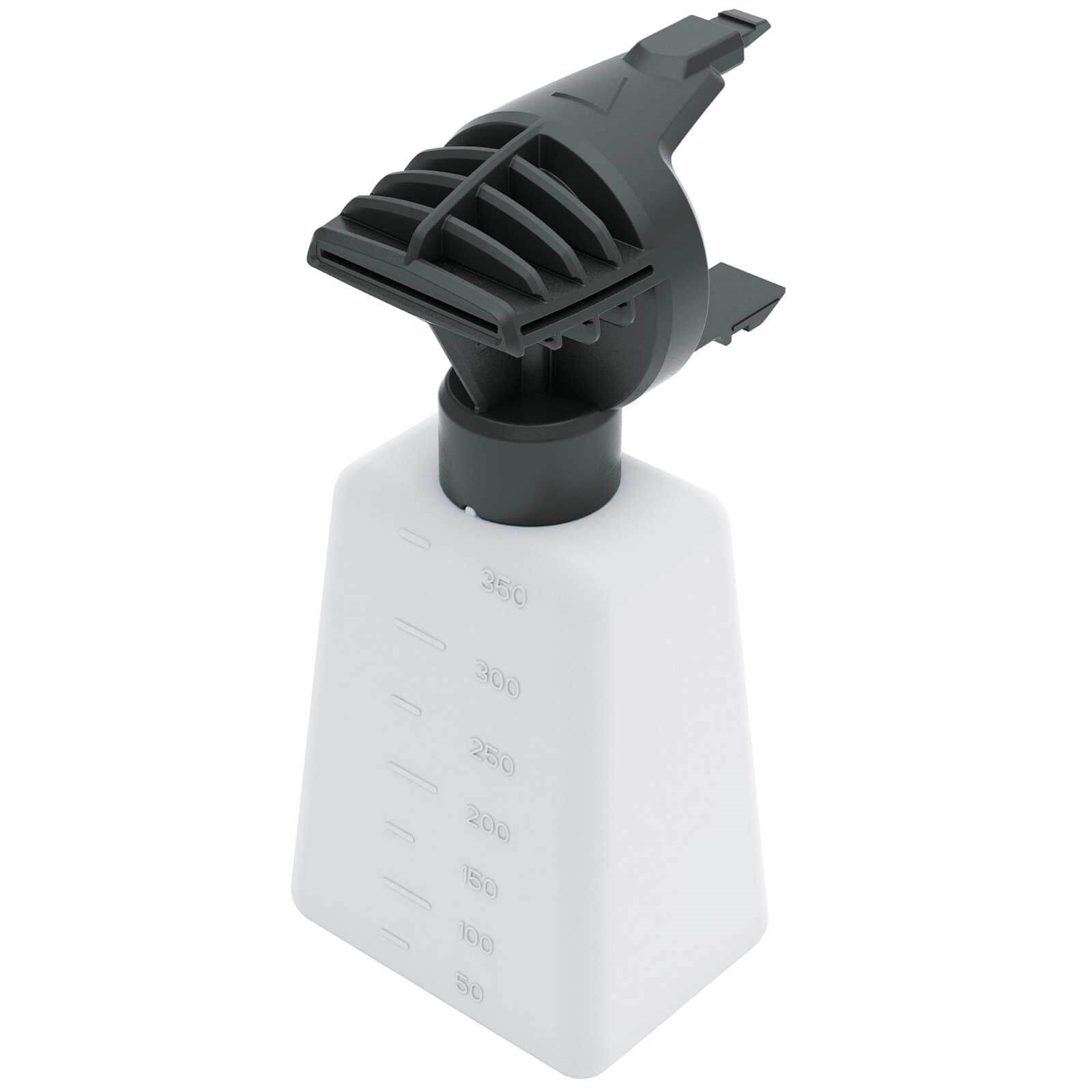

This is the bottle lol
It just sucks up a bit with a venturi feed hence the 3:1 on the machine. I have seen videos of it making decent foam but I just want to get it right. Guess I’ll have to test though

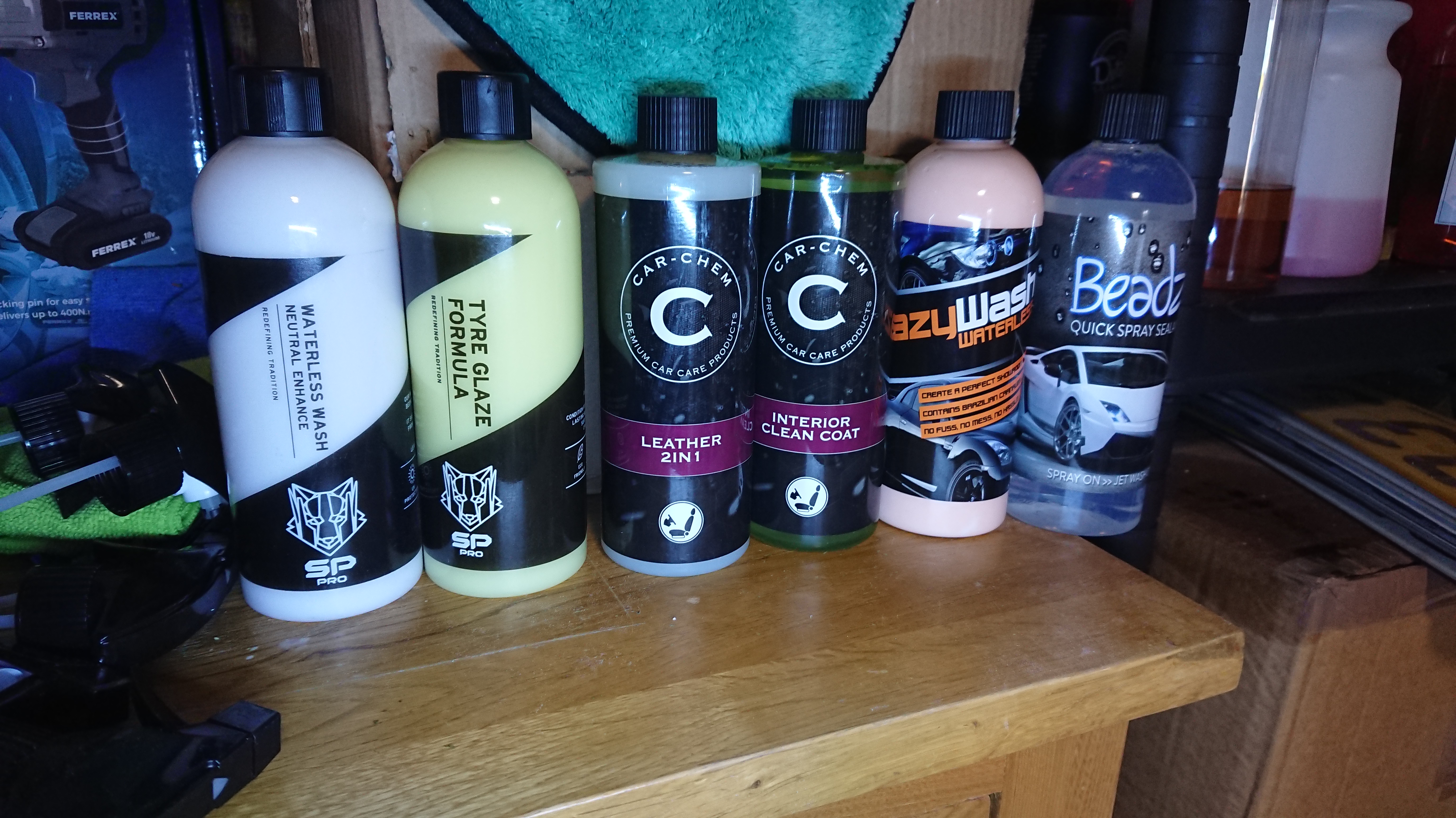

Nice. Even turned up with 6 triggers too for the bottles. Not sure how much of any of these I will use, but for £16 it was worth a punt.

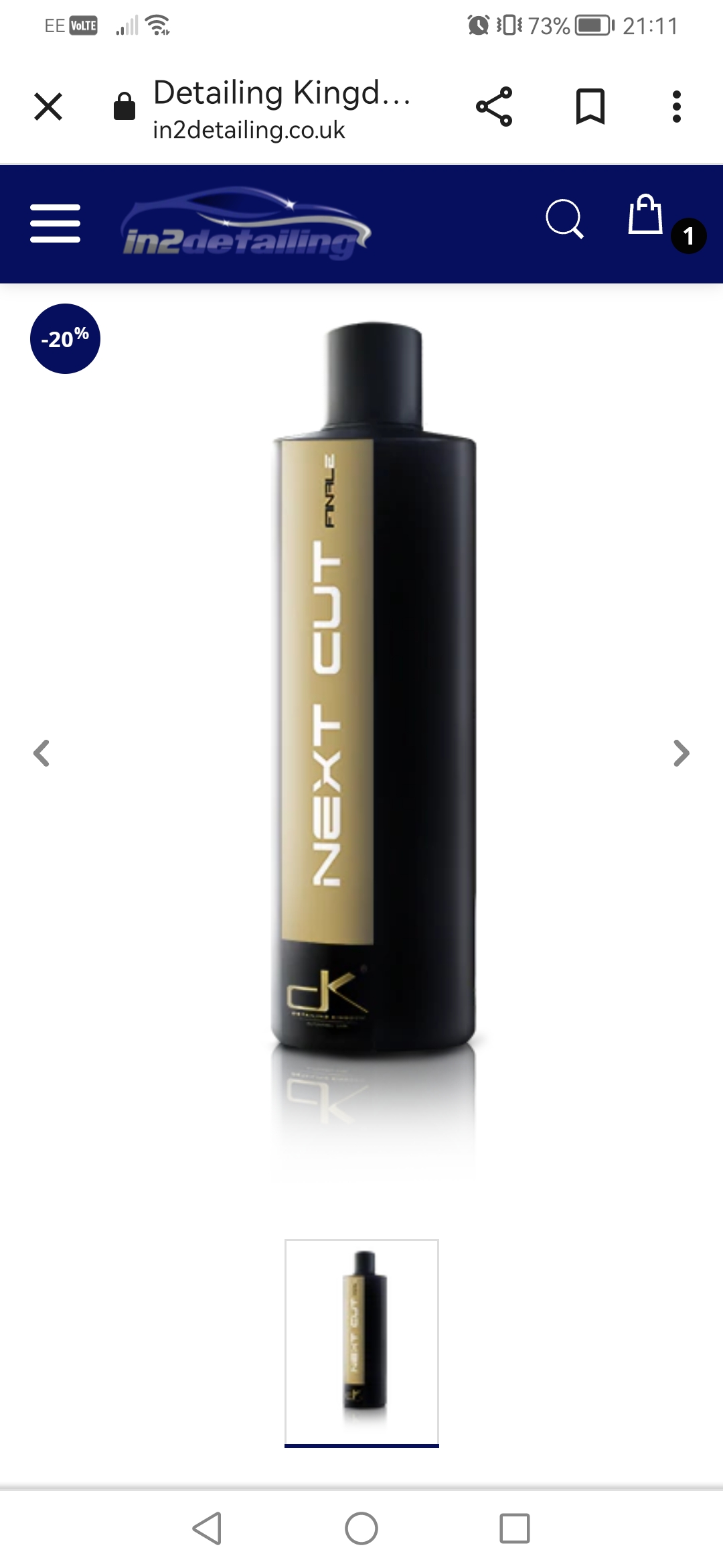

Try country detailing and in2detailing. Both have promo codes iirc, usually 10%
This is great to use as a finishing polish. The compound is decent but would pick h9 by koch.

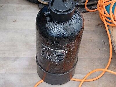

I've just had my house windows cleaned by a professional cleaner who used a vessel.
Now I'm tempted for my car.
Found this local and cheap.
Can I keep it outside?
Sidnancy
  Cumpact
My vessell is one of the best things ive bought detailing wise (when it works!)
I had problems with my little 5L one which I then gave to @TheEvilGiraffe and I think he managed to fix it.
I have almost exactly the same as the one you linked and its been flawless but I did buy it brand new filled already. After you've bought the resin, it wont be far off the price I paid for a new filled one (circa £90) and you know its just going to work.
Either way, go for it. Its a brilliant bit of kit.
In regards to keeping it outside - possibly. They shouldnt really get too hot as it can degrade the resin more quickly. On the other end of things, if it gets too cold it can split the plastic vessell if the water inside freezes and expands. I keep mine in the garage in a nice set up, wall mounted with my wall mounted PW. Works brilliantly.
