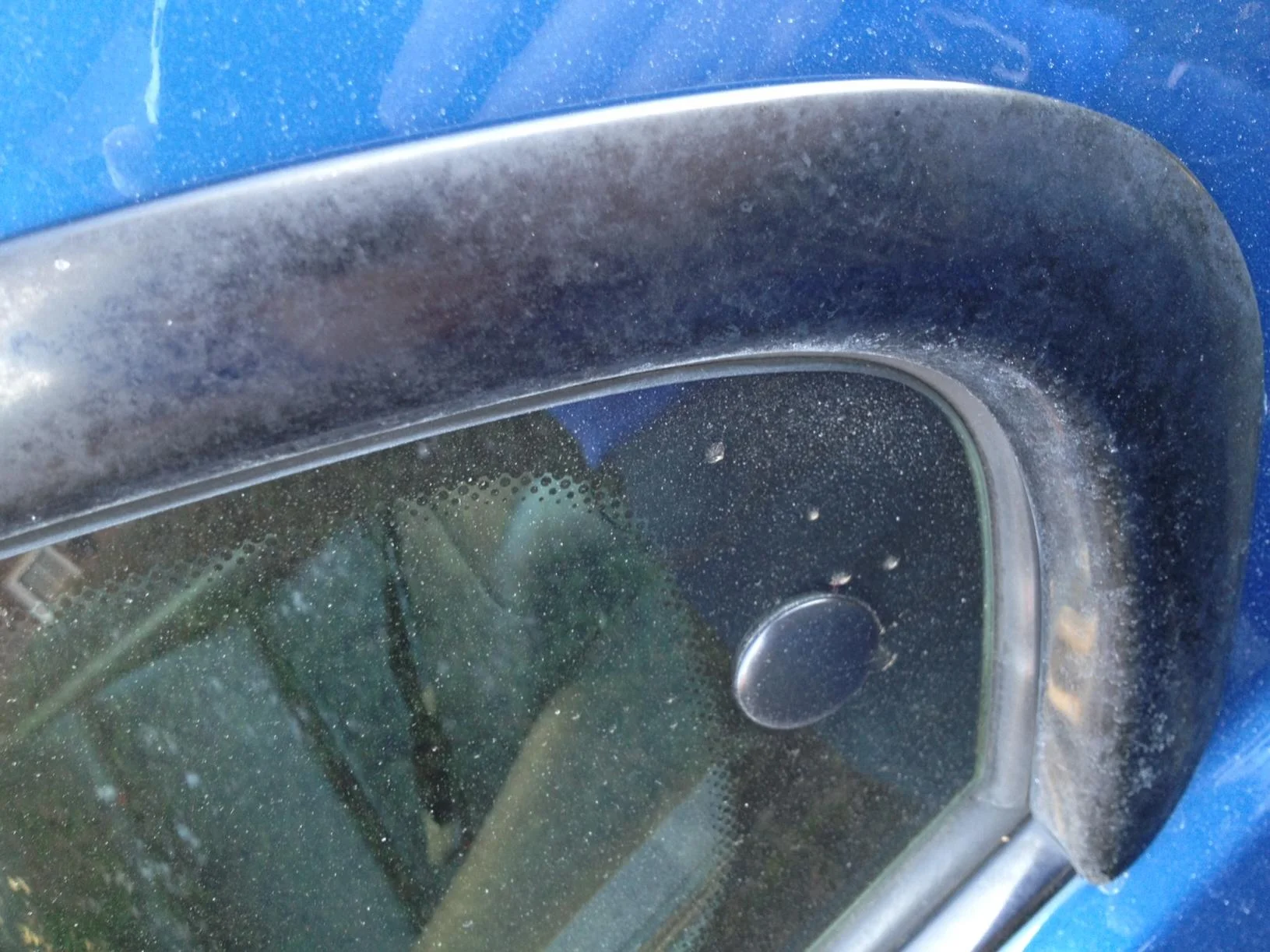

Detailing Q: The blackline trim on my 330Ci isn't as glossy as it could be. It looks saturated, what, if anything could I use to bring it back?
Quick photo of said trim, note some of that is dirt/salt.

If I'm not mistaken, the trim isn't rubber but painted plastic. Try giving it a good clean with an APC and then a bit of light polish. I found GTechniq P1 worked well on mine.
Yeah, Chapppers, its not rubber. Its painted plastic as Ads said.
I'll see if a hand polish does the trick. Wasn't sure if it would be gone forever.

It shouldn't be, they have a habit of going 'off' quite easily - normally they take on an almost greasy appearance.
Mind need respraying as I masked them up last time I polished the car and the tape pulled some of the black paint off. :(

Ah my mistake, was wondering but thought it looked like the rubber below the windows!
I would go with P1 on something like that.
