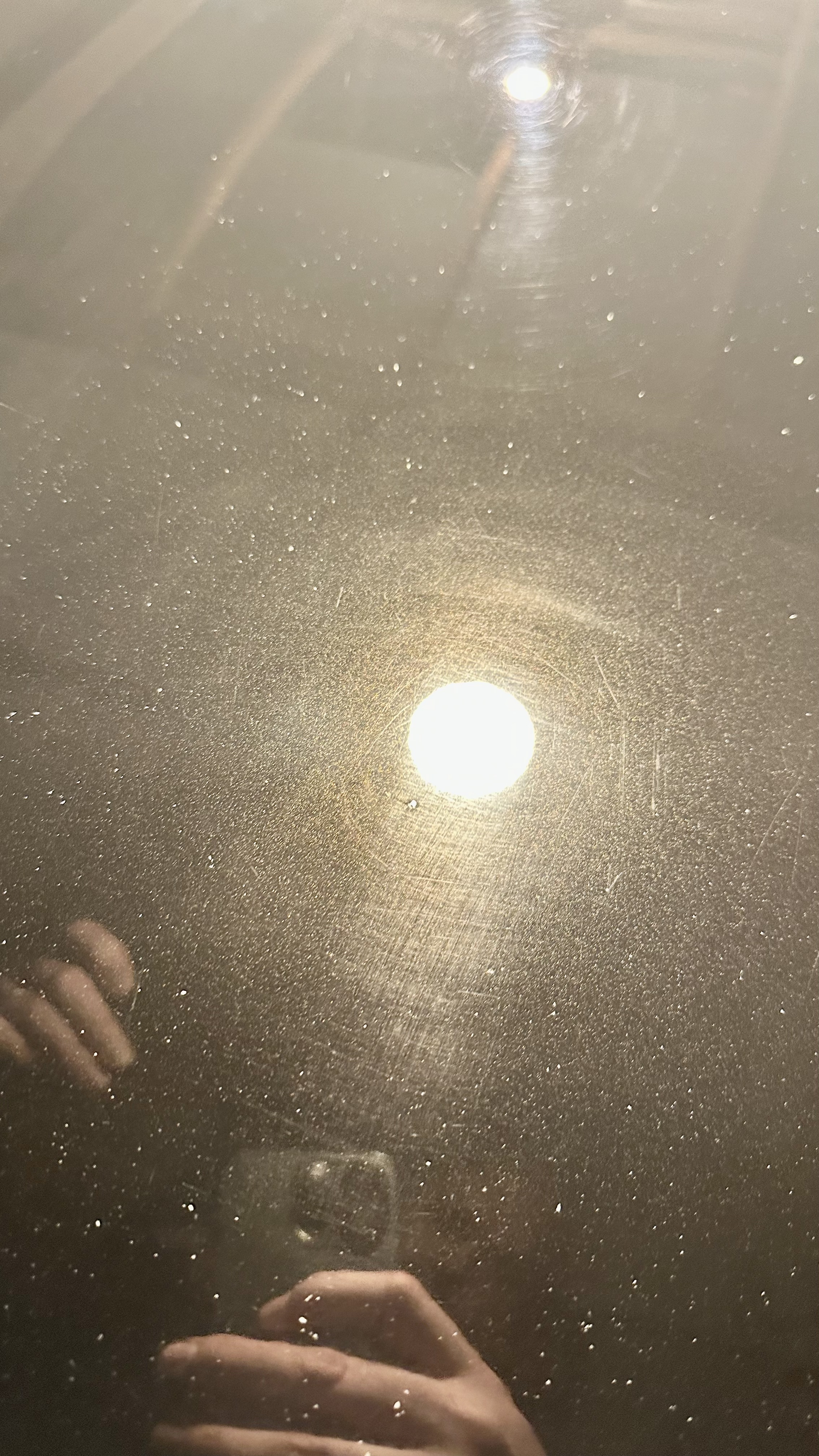

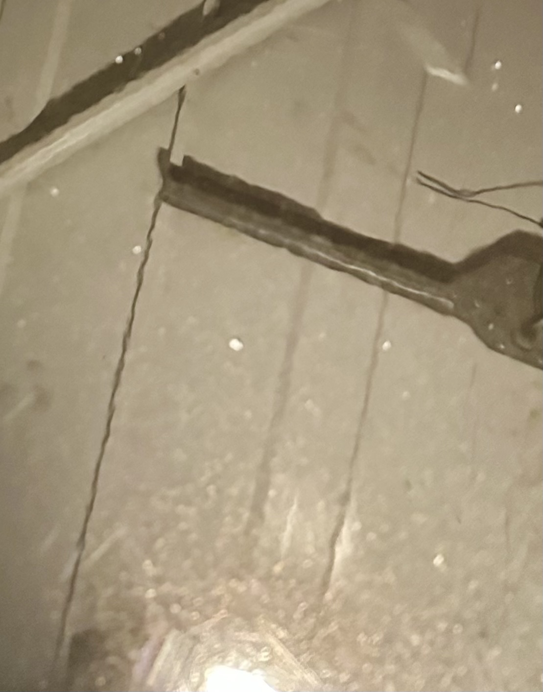

This might be a random question but how long do you spend machine polishing? If you’ve got a shitty panel, how many passes/applications or whatever you want to call it would you do.
This was the Clio bonnet
A bit of work I got this half and half but it still needs more. How much can I realistically do?
As in how long spending machine polishing the car or how long till you burn the paint.
If the later then maybe get your self paint depth gauge and that way you can work out how much there is to play with
Probably a bit of both. I’ve spent maybe 5 mins with the first compound the the same with the 2nd on that half. It’s never had paint and never been machined before so I’d guess I have plenty to play with.
Im using meguiars foam pads so f**k knows basically 🤷‍♂️. I think I’ll just go until it goes mint or bad. As long as it’s not the rear quarters I can but new panels 😂

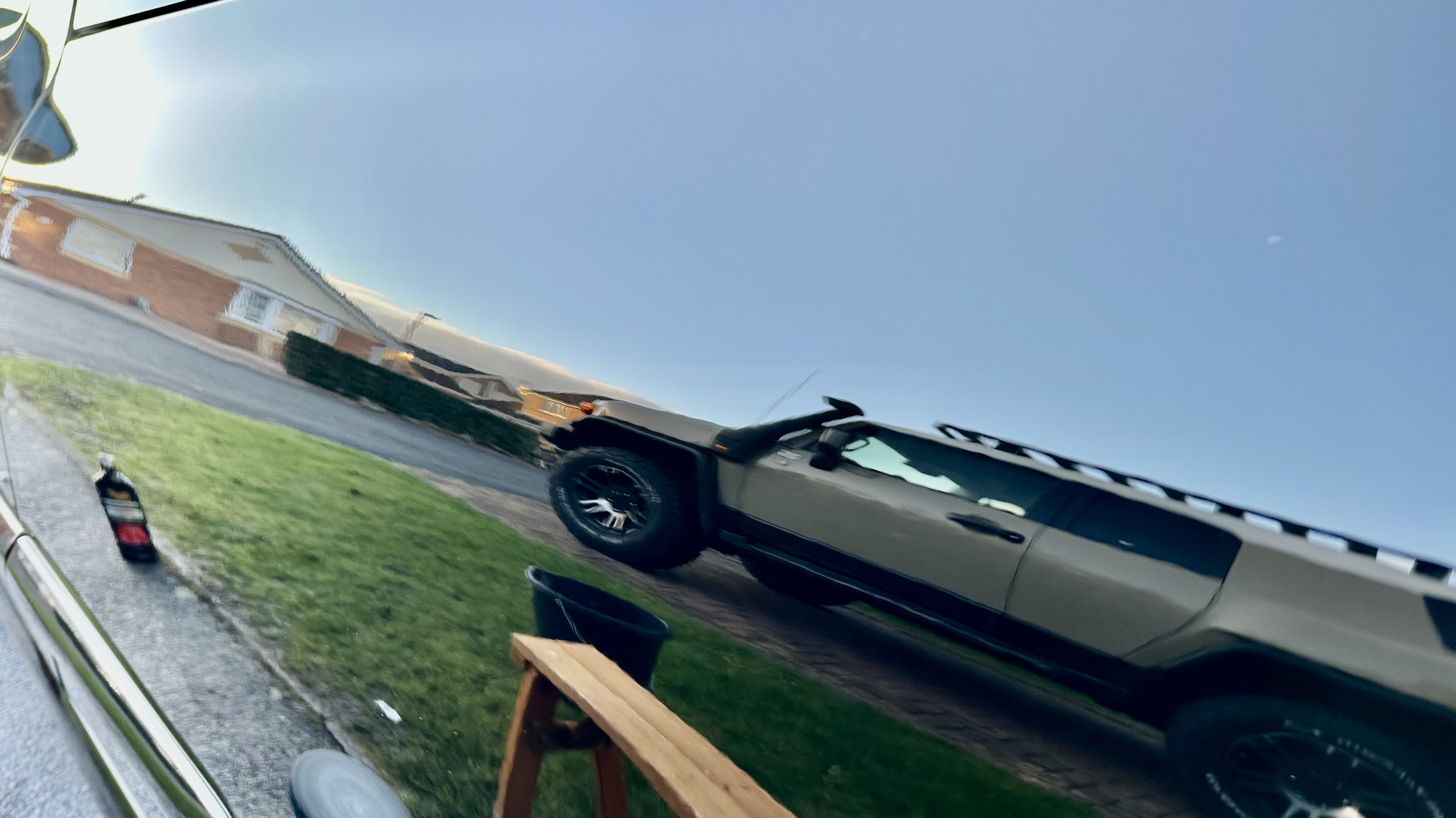

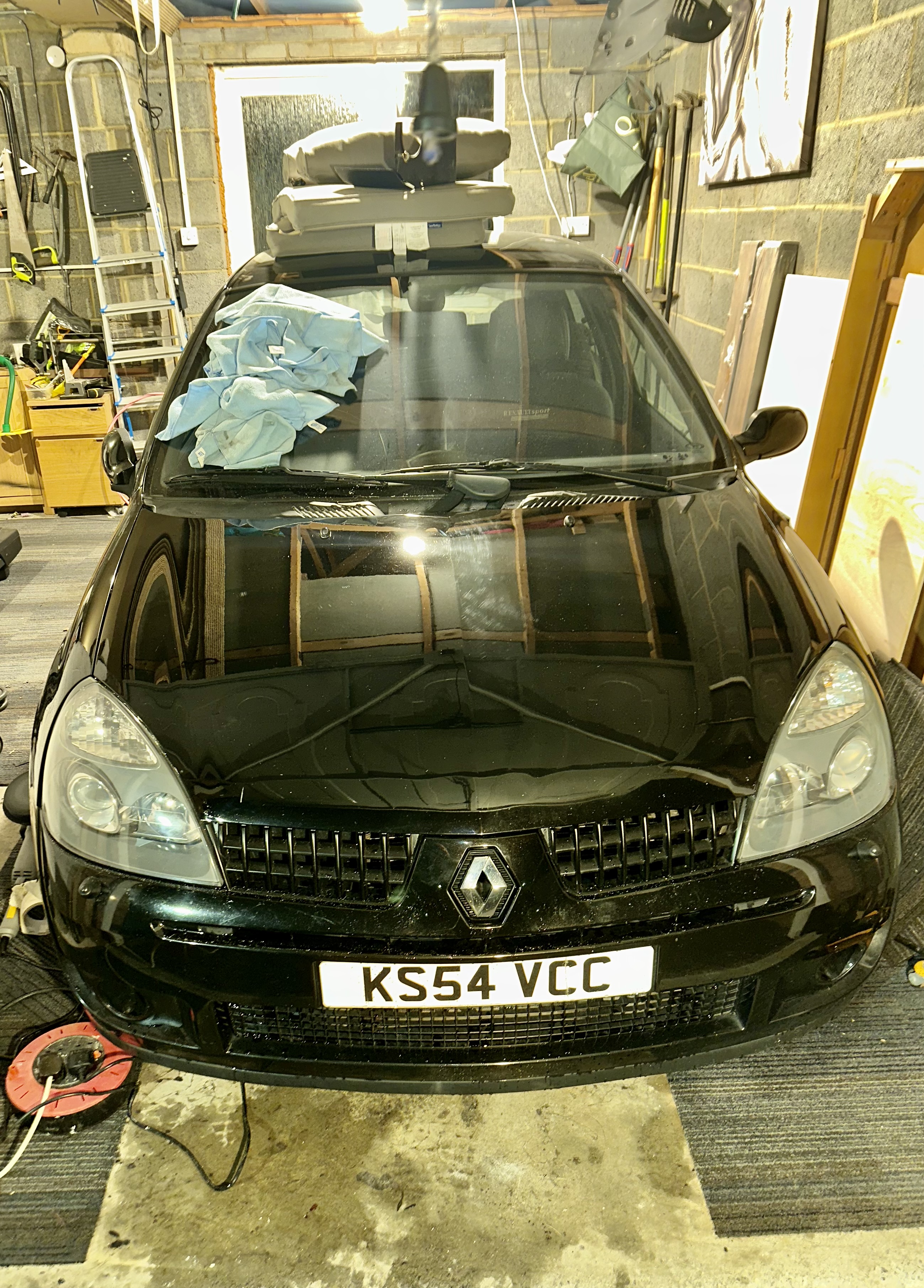

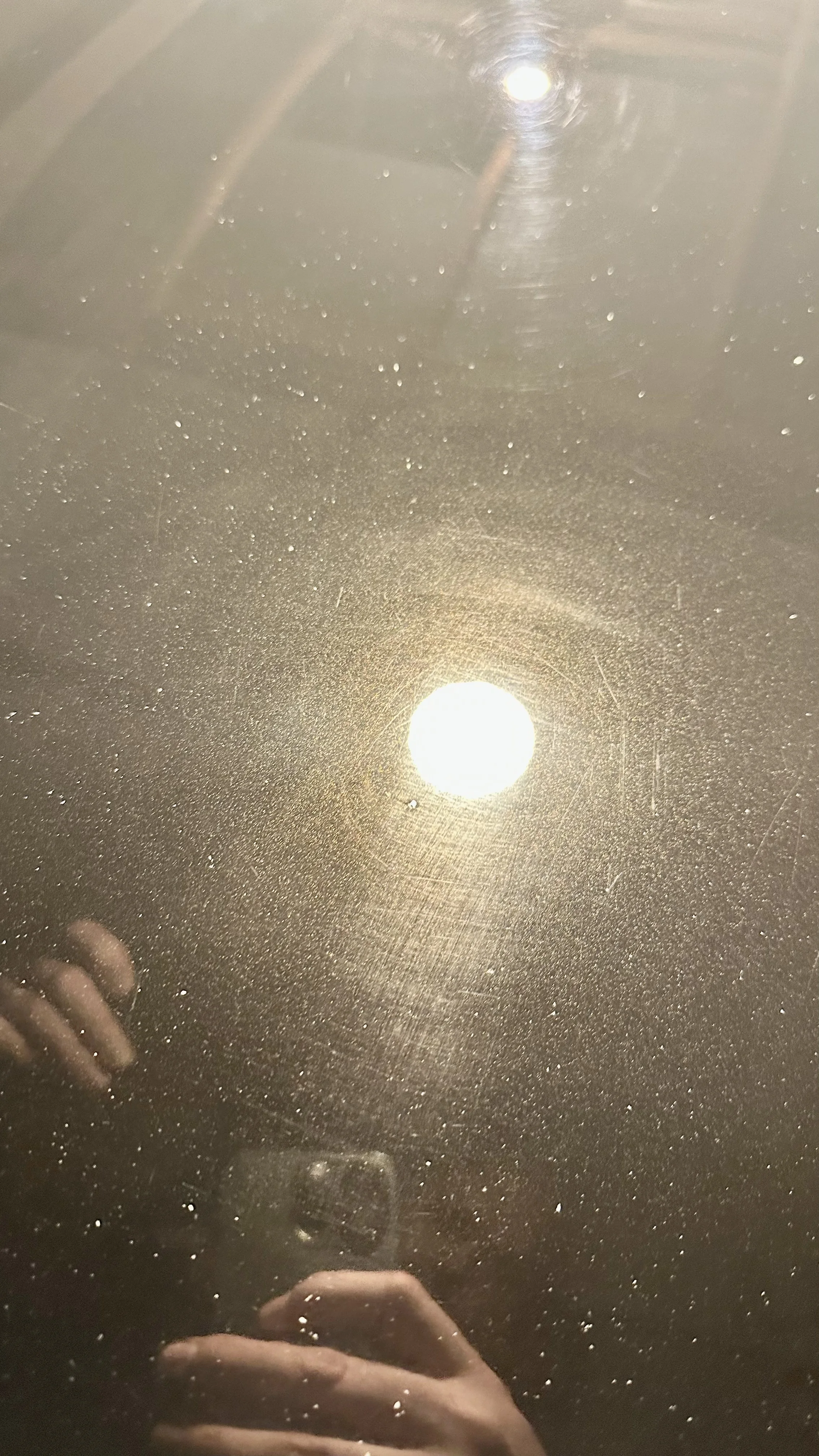

I’ve been machining the Clio and the sides have come up great. However, I’m struggling to take some of the deeper swirls out of the roof and bonnet. I’m using maguiars compound which obviously isn’t the harshest so was looking for recommendations.
I’ve used poor boys ssr1 2.5 before, is that acceptable or is there better in the same price band I can use?
Awesome side
Less awesome roof
I found meguires average at best. Grab a bottle of Koch h9 and a decent pad, maybe a ccs yellow.
Be warned though the yellow pad can burn paint. Renault and honda paint are not it's friend lol
That might not be the best option for me 😂. It’s not horrendous and passes the 10ft test comfortably; it’s only really in direct bright light they show.
Given I’m very much an amateur in this, is there something a bit less nuclear you?
Do the pads make much difference? I’m using ones from Halfords at the min, no idea what spec they are, just 3 different colour foam pads in a pack
I would say yes and more so for durability.
If you wanted something less hi primer try the green hex from chemical guys with a decent compound.
I haven't polished for a few years now (there may be some now wonder products on the market) but I always preferred to use pads as the variable. CG Hexlogic and 3M being my favourites.
