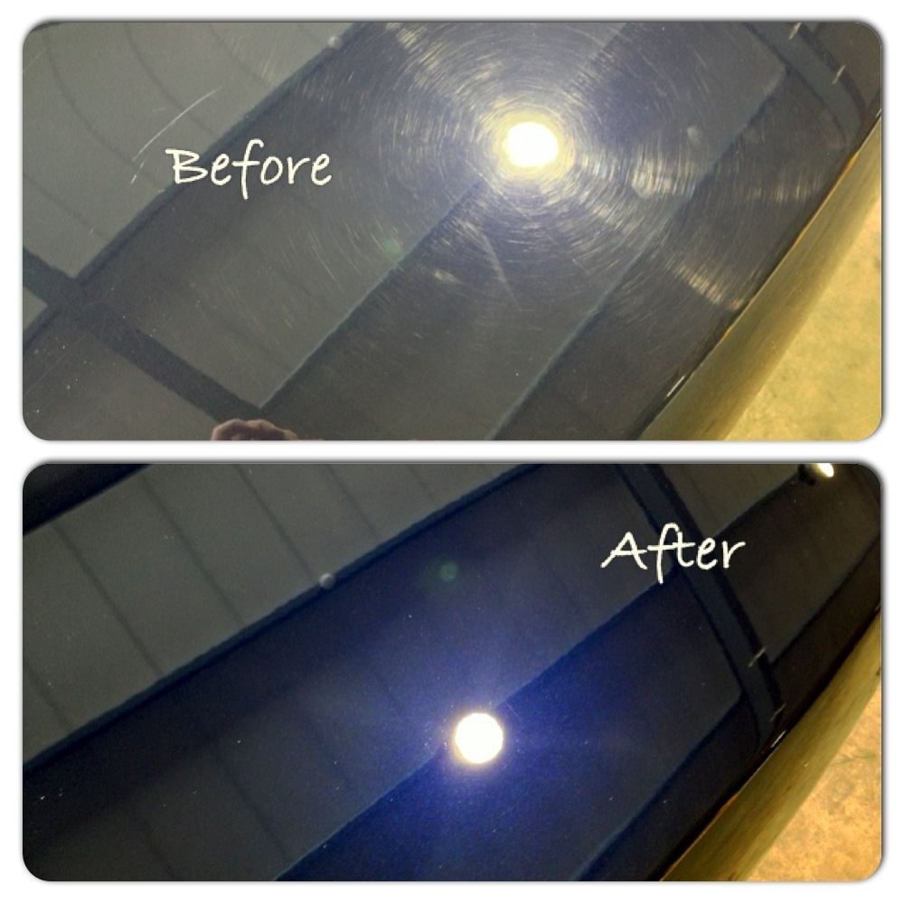

Impressed myself today
Swirly old audi a4 I had a play with
FC+ on 3m wool, removed 95% of the defects, then finished down with ultrafina on a blue 3m pad. 1 set each
I don't think I will ever ignore the 3m range, fool proof
Gally
Drop anything in with the FC mate. Way too dusty for me although very good. I prefer Menz sometimes. Or i'll drop some ultrafina in the FC.

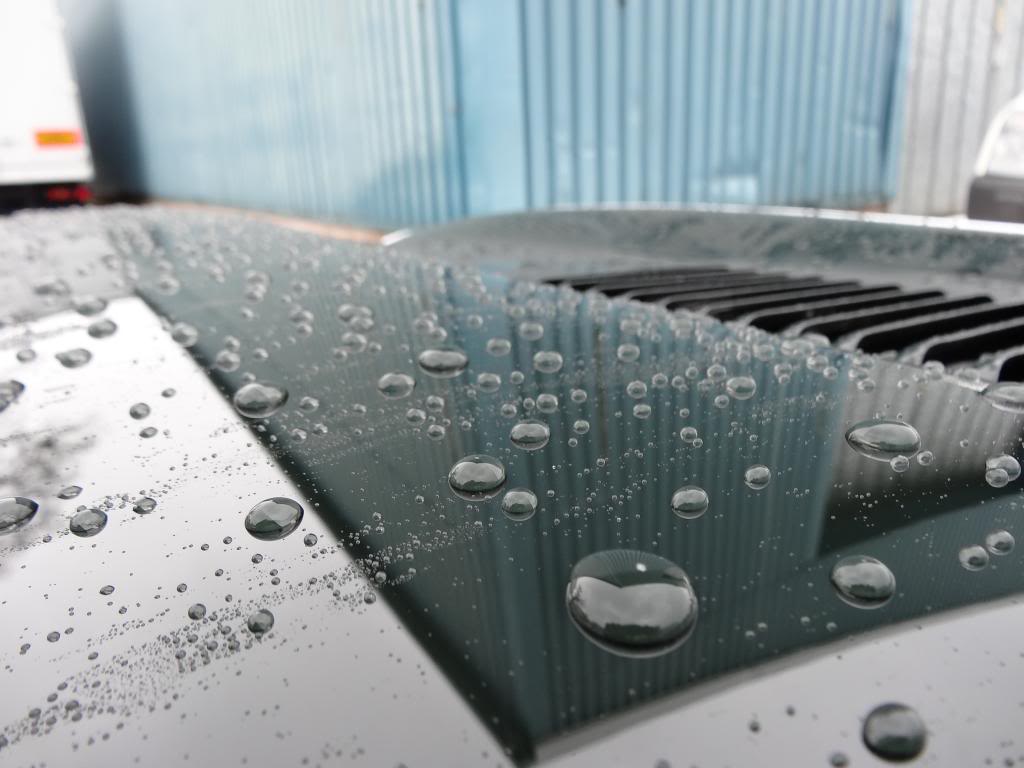

had to accompany the e-type i detailed earlier in the week today, just for some last minute prep for the show.
concours gives amazing beads of water!
