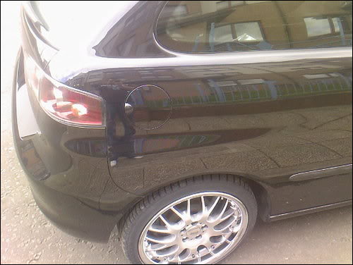

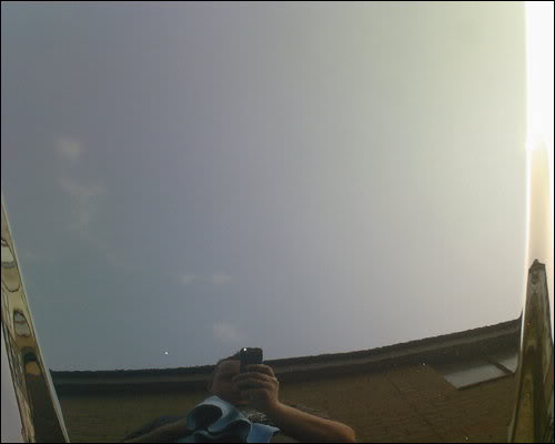

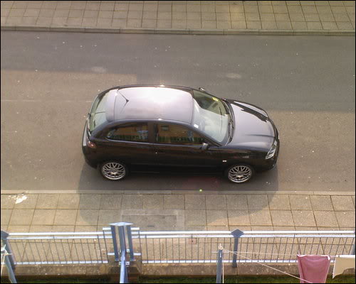

i agree with you JD that it is more affective by machine polishing, however i did achieve a good level of correction by hand:
bonnet:
wing:
roof:
Could do with some 50:50, before and after and some shots with a light source in there to actually show the correction, but all in all looks good lad.
