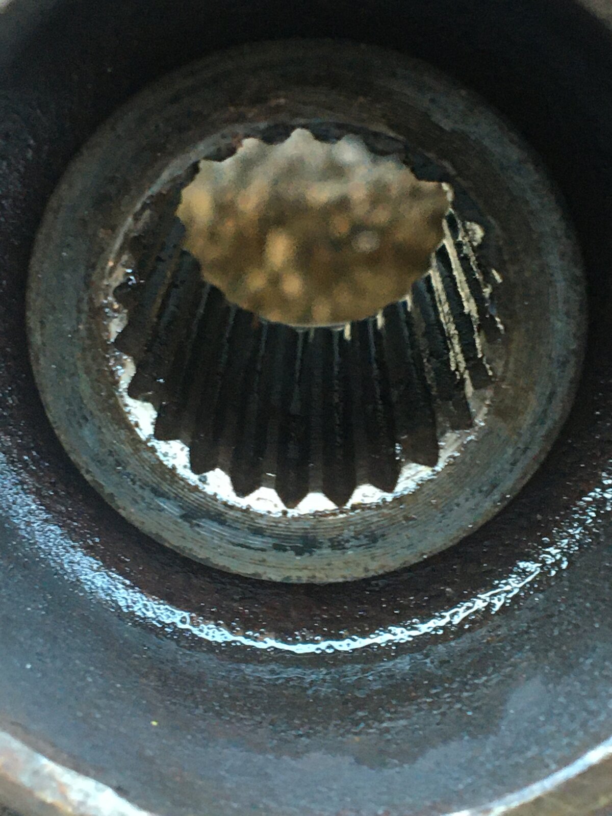

So the first track day went almost without a hitch..... (found a split driveshaft boot near the end of the day)
so got the car back home and first job was to look for the next potential track day 😂

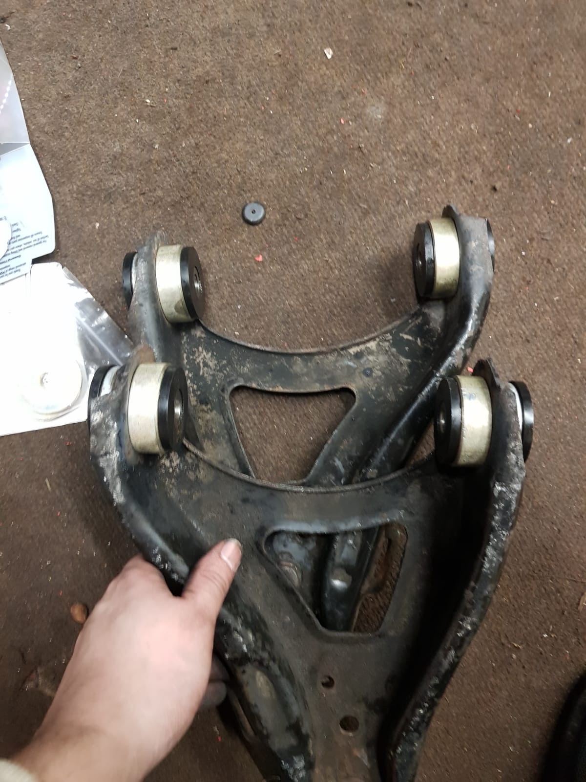

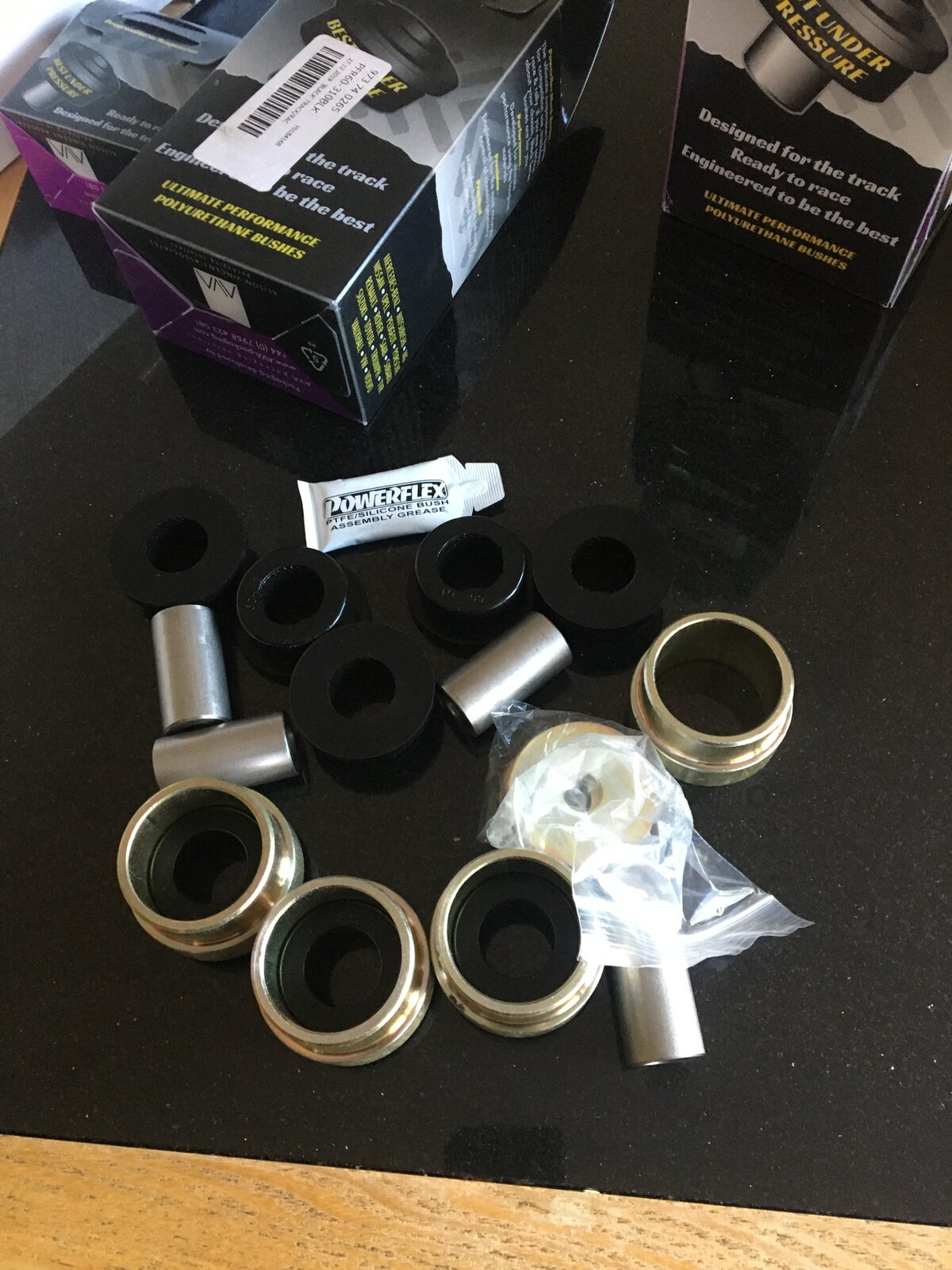

after a bit of a debate we decided to go with a new driveshaft rather than a boot, ordered a engine service kit and some goodies in the way of poweflex black series wishbone bushes, inner arb bushes (outter wasn’t in stock) and rear beam bushes.

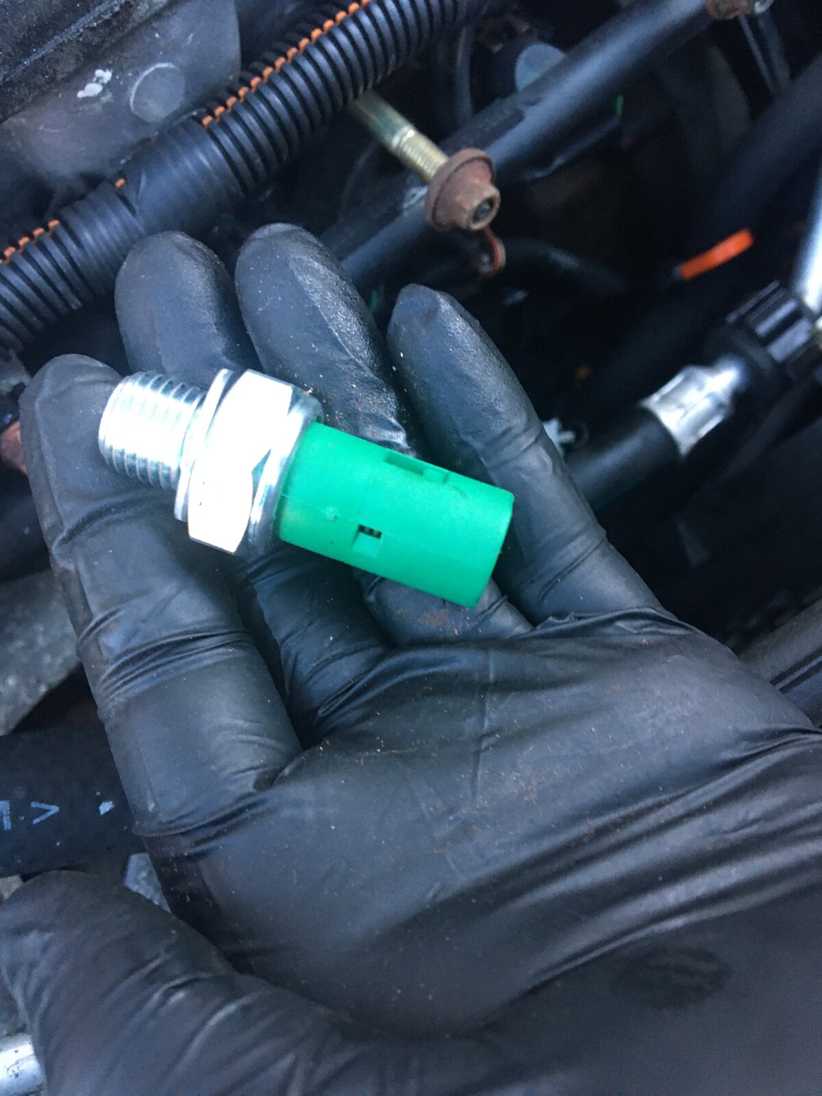

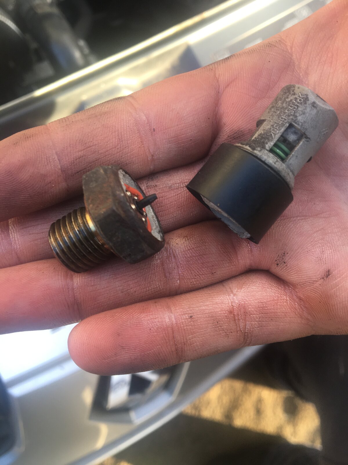

Oh and we needed a oil pressure sensor after some Rodney slipped undoing the oil filter and broke the old one!!!

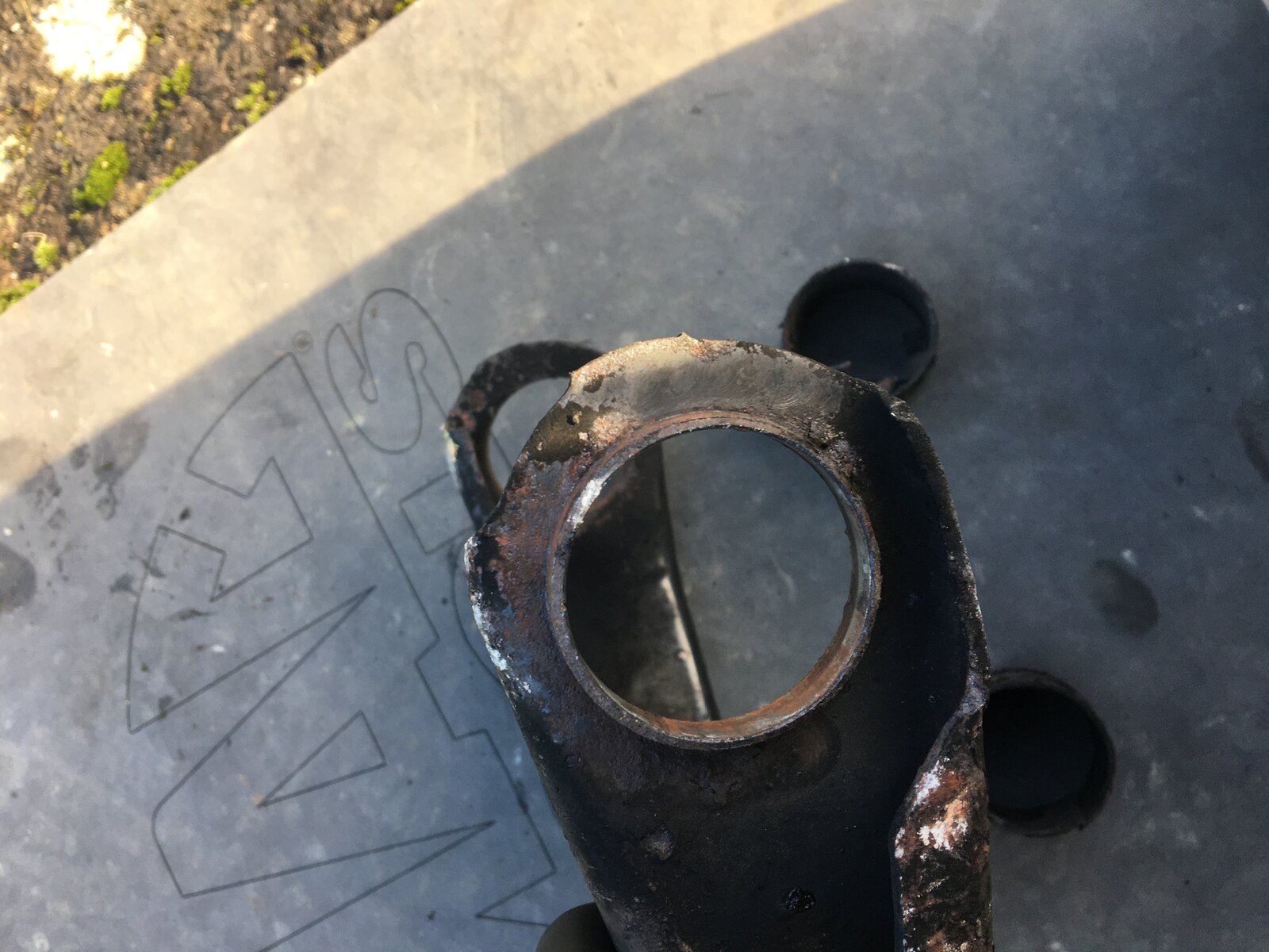

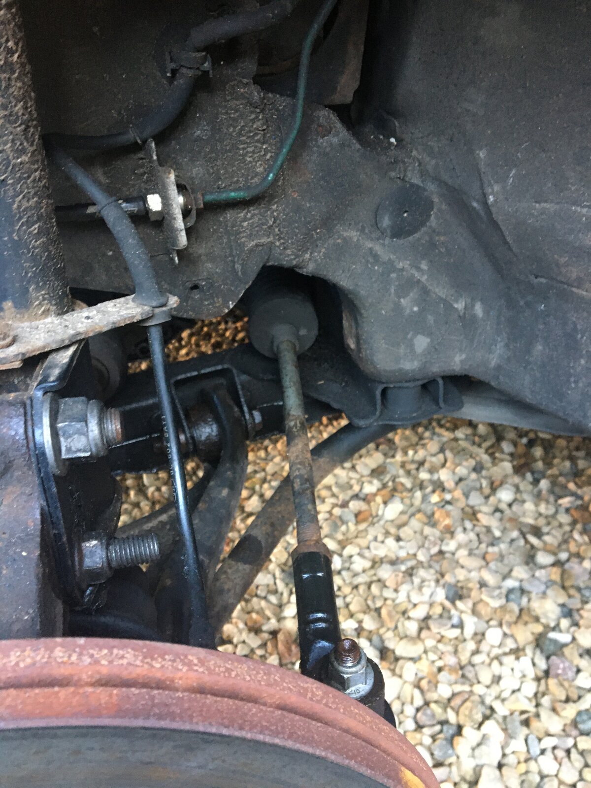

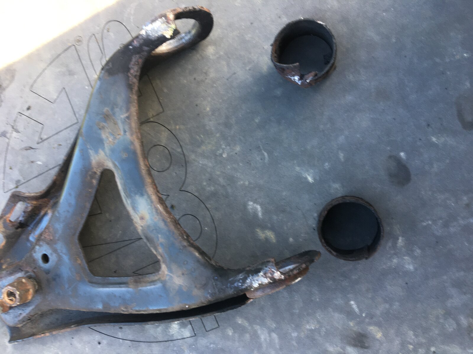

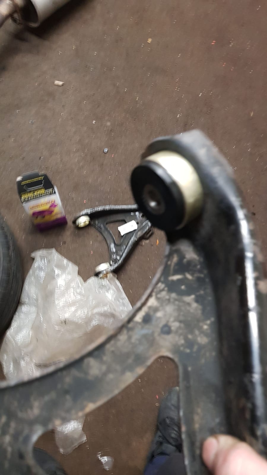

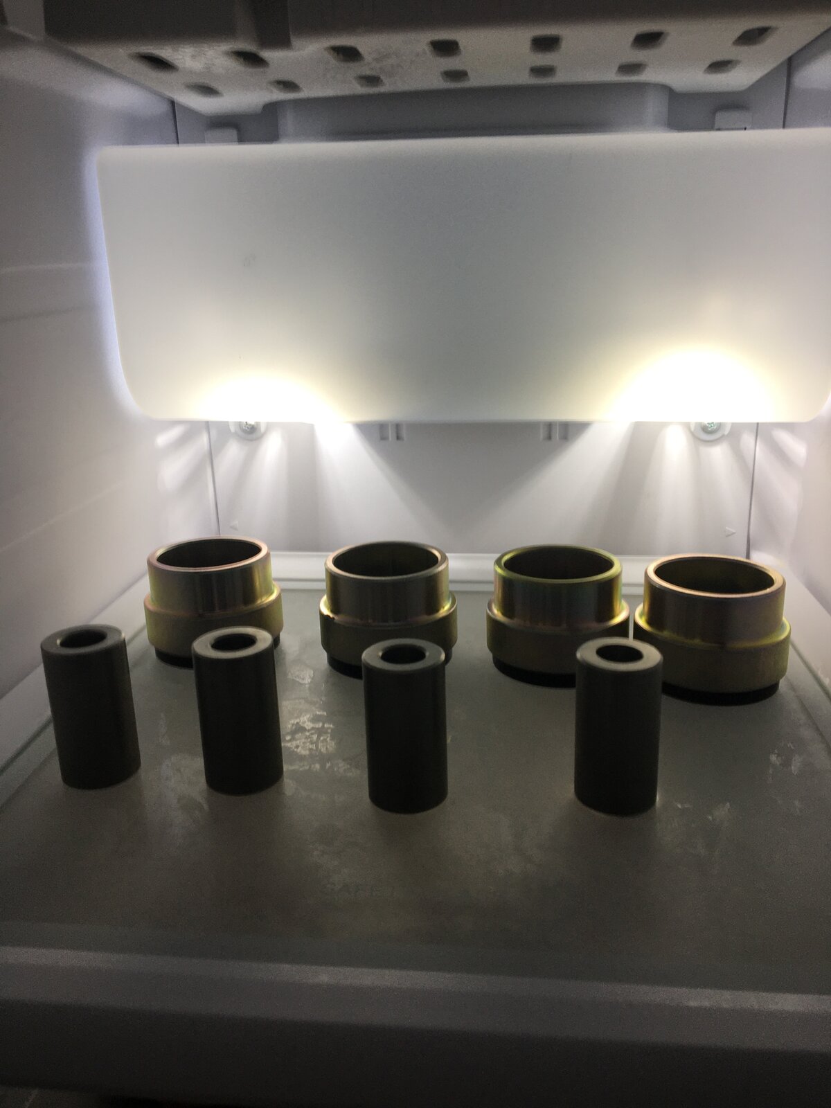

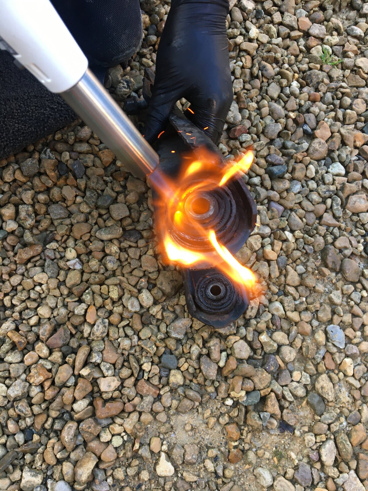

Some pictures posted twice sorry, so the bottom arms was a rite pig to be honest. Everything was seized and we resorted to fire for getting the old bushes out.... new ones went in nice though with the vice and had them chilling in the freezer just incase 😂
Didn’t get to tackle any of the others as I assumed I was going to be in for more of the same rusted seized nuts an bolts...
sorry about the lack of pictures of things going back together but we had a bit of a rush on tonight after work and managed to take the car a little run an booked Donington for the 25th if anyone else is there?

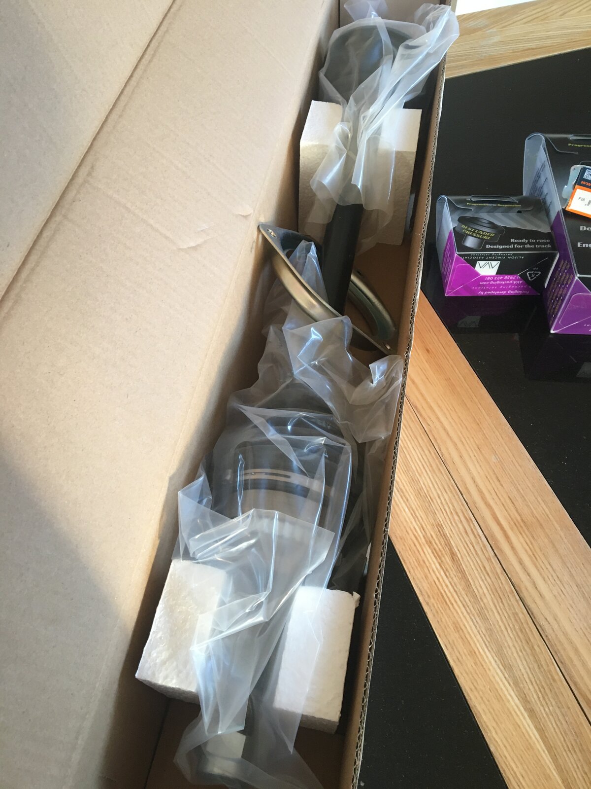

also placed an order for something quite nice 😉 will put pics up when It gets here an hopefully some pics of it going on the car...

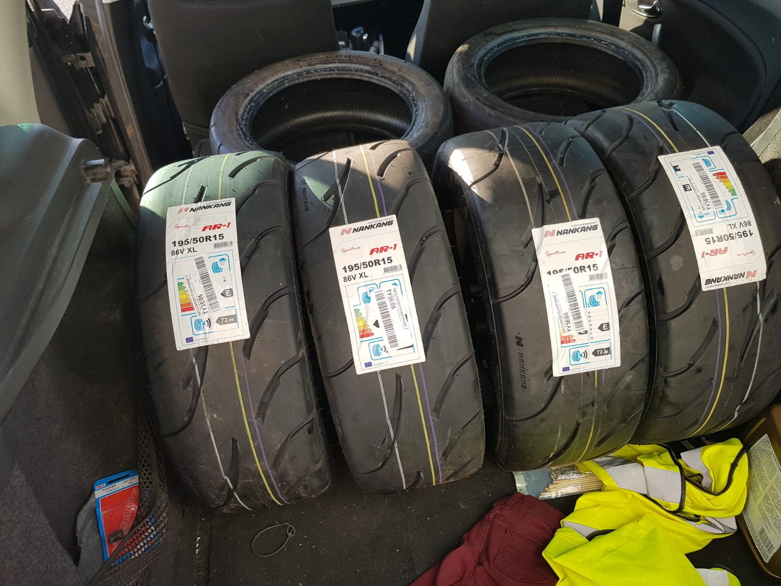

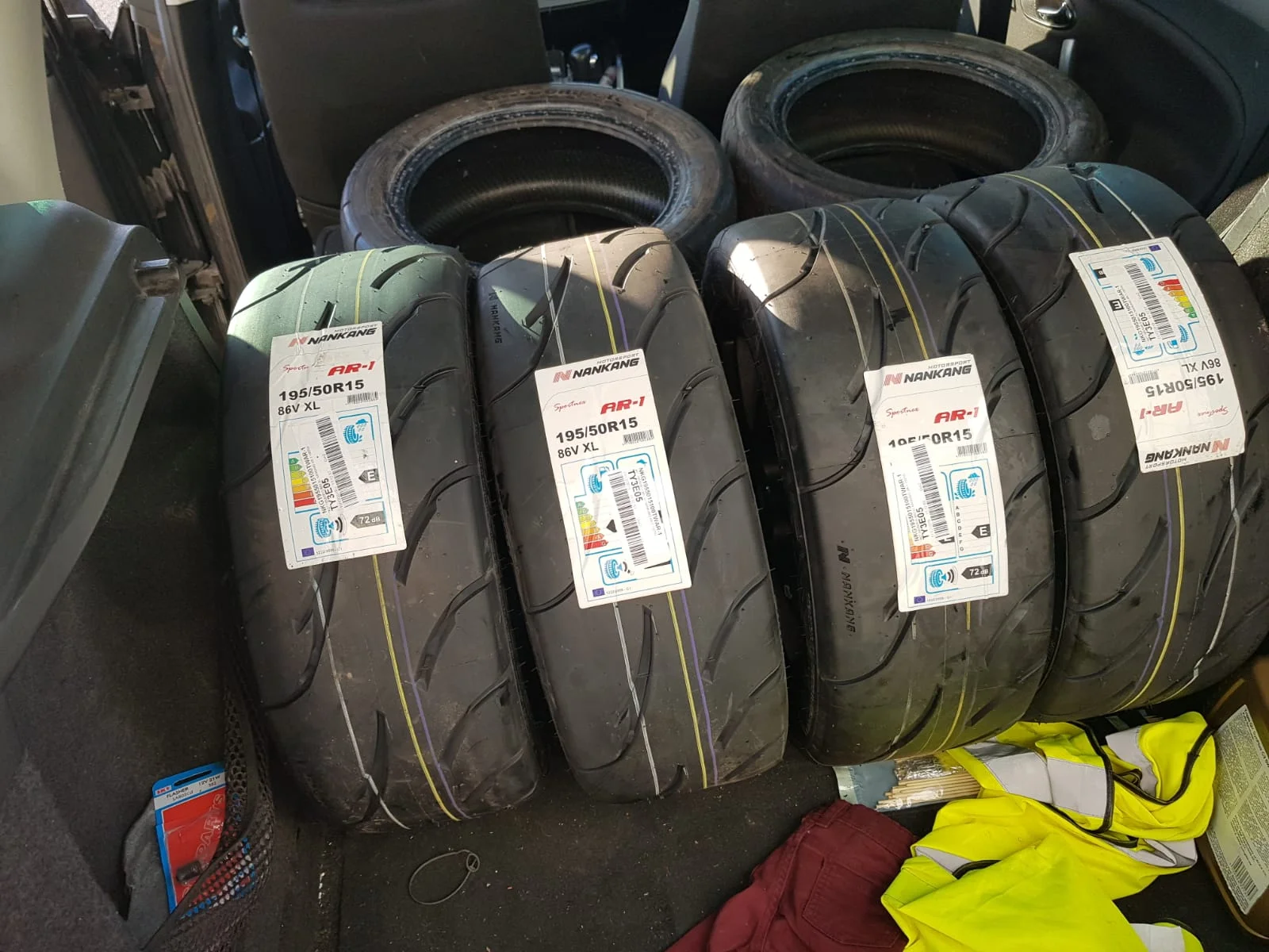

pic of the AR1s just before our first track day, think we needed all the help we could get lol so decided on decent tyres.
