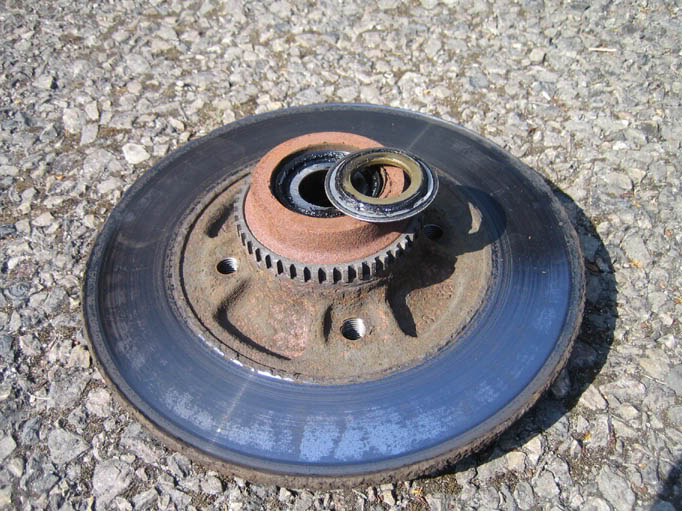

Heres a pic of the rear disc with the abs ring , the ring in the middle with teeth , the front discs don't have an abs ring fitted .Get your self a haynes manual , both front and rear disc / pad changing is easy .Plus get yourself a brake bleeding kit and some new dot 4 brake fluid .Castrol Respone Dot 4 from Halfrauds is pretty good stuff , doesn't cost much more than Halfrauds own .

Make sure you don't lose or put that bearing seal/spacer on the wrong way round. They're hard to get hold of and don't come with the bearing kits or discs!!
Apart form that rears are easy to do, you'll need a 30mm iirc socket to get the centre nut off.
