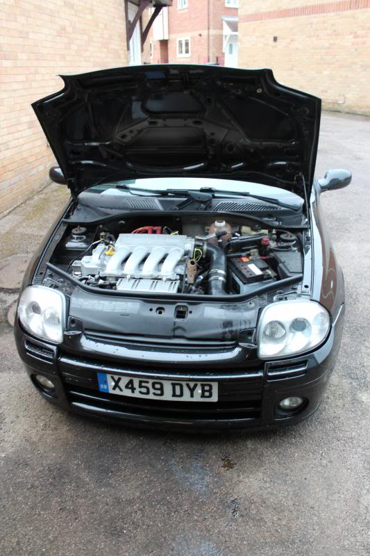

To bring this upto date & I know it might seem like a lot of pictures but I tried to take more pictures whilst doing stuff :eek:

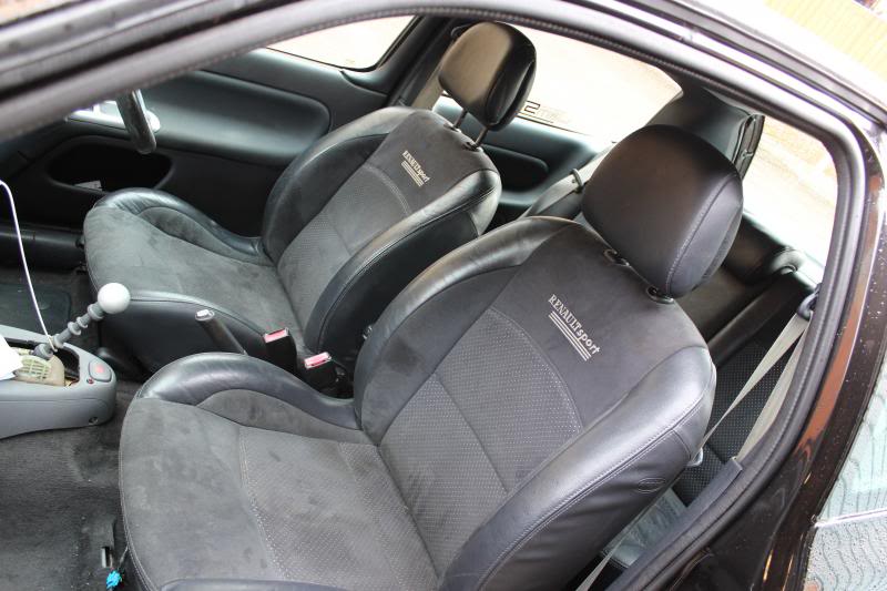

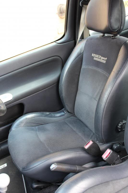

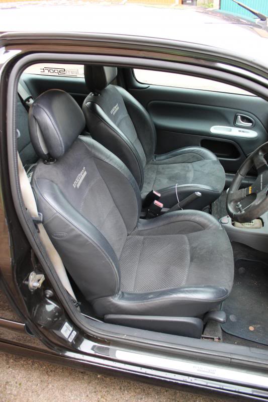

First up got another set of front seats off meekings14 as they were in better condition than mine.
the pictures make no sense really as it rained but here goes,
Then I found this and covered the seats in it.

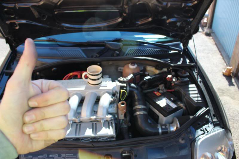

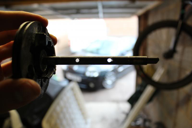

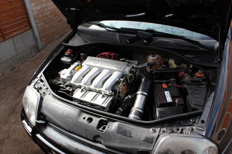

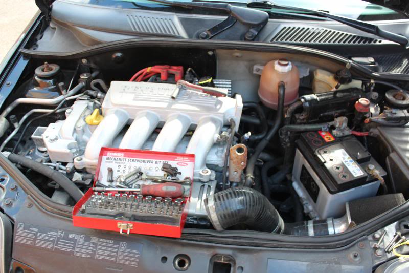

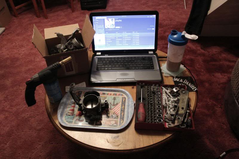

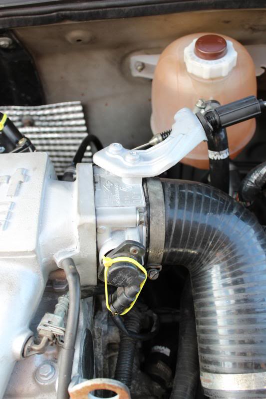

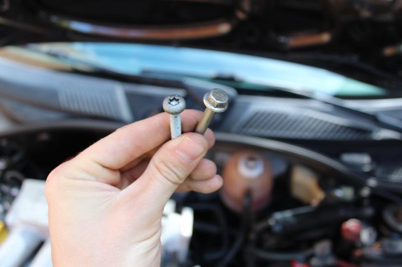

Moving on from the seats I then changed the throttle body due to it sticking, tricky decision choosing one.
I then pulled it apart,
Swapped the torx bolts out for a normal headed bolt,
Back together and working,
I then sprayed more of this on the seats,

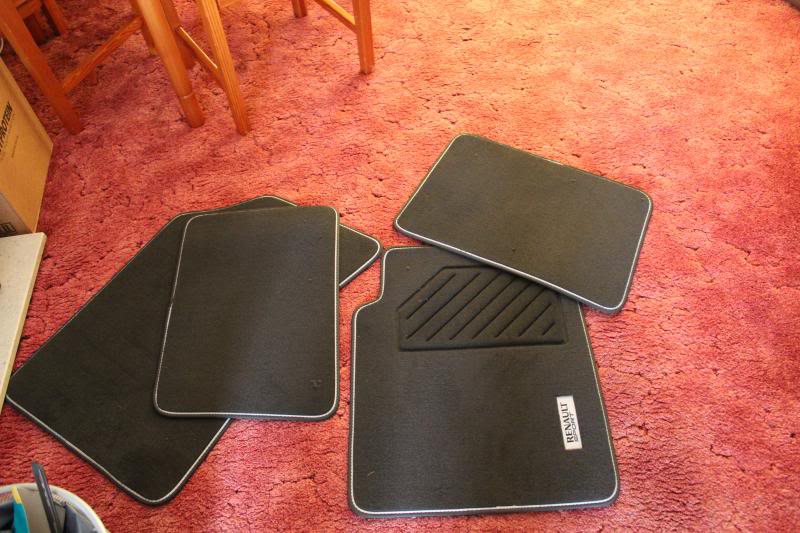

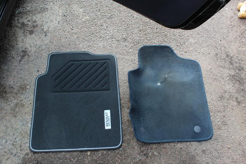

They ended up like this, still need to order new mats!

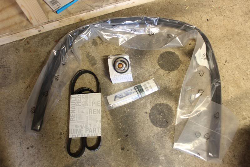

I then recieved a little delivery from Renault Wolverhampton, cracking service as always!

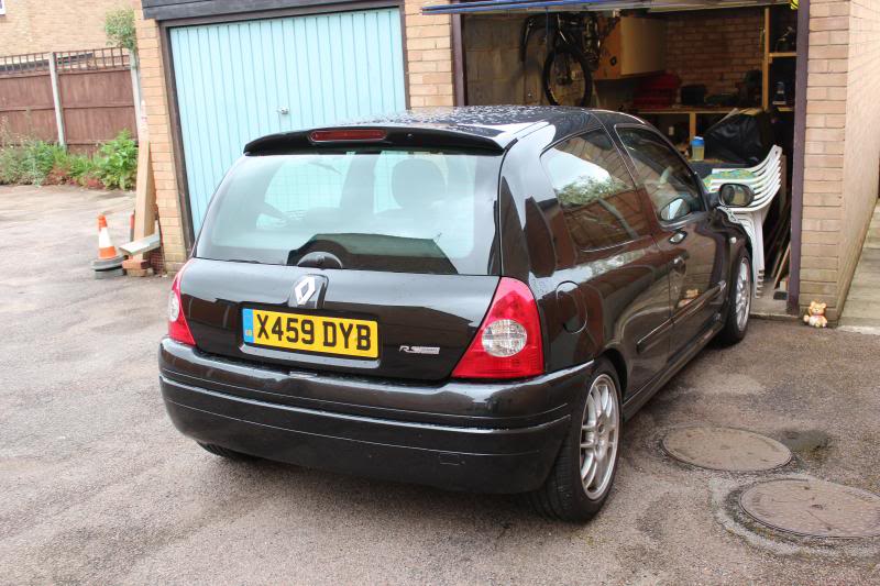

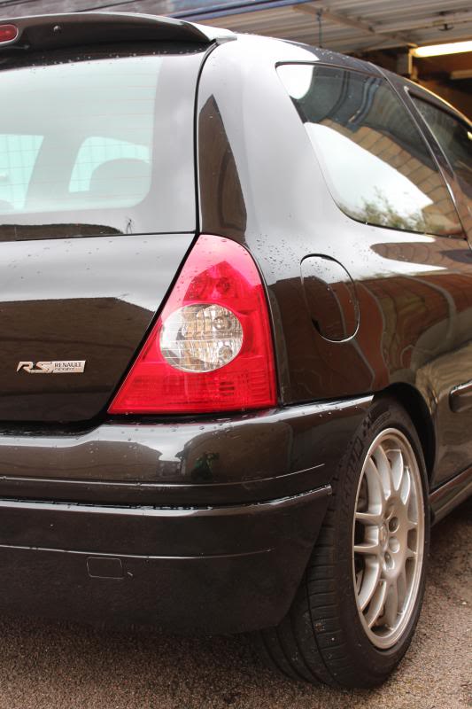

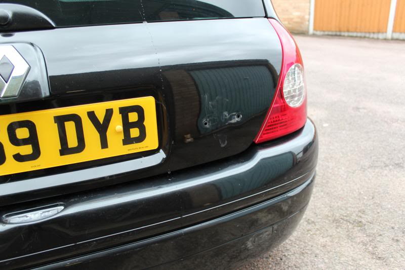

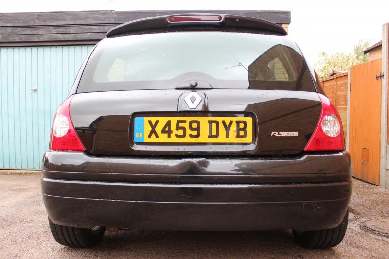

I then debagded the rear,
Abit of spit later and it look like this,

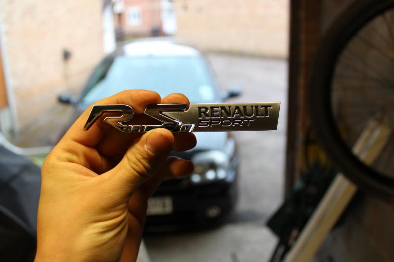

This was in my delivery,

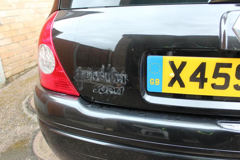

I then stuck it over the holes from the clio badge, again getting over excited with the pictures.

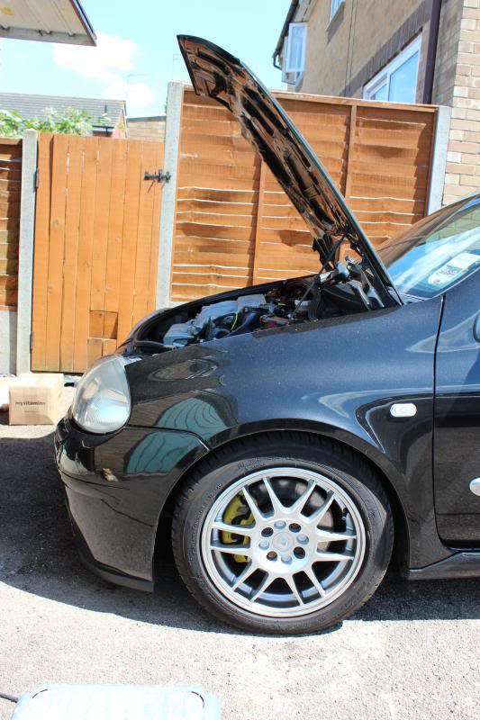

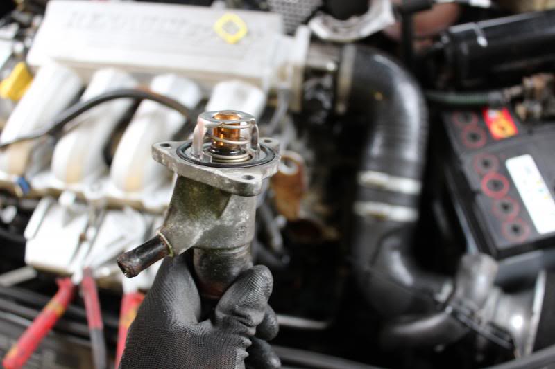

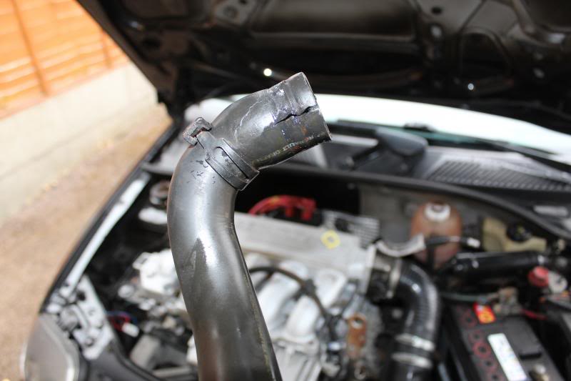

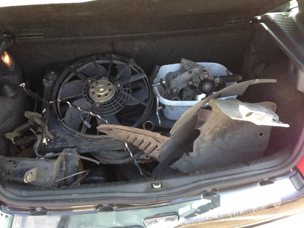

Then I changed the thermostat. First off I would like to mention that it was filled with the most disgusting, sludgy, pissy smelling coolant ever. I flushed it through quickly and the smell was awful.
Bit close to the garage floor,

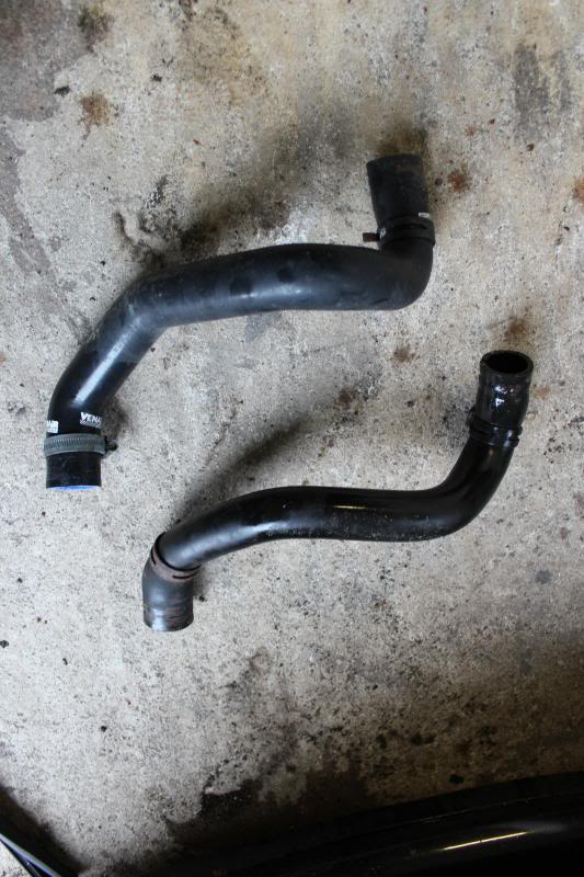

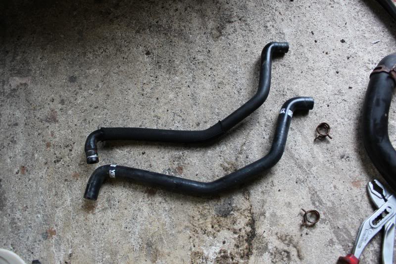

Found a split radiator hose,
Luckily I have a silicone set,
I also changed the hose from the top of the thermostat to the expansion bottle whilst I was there,

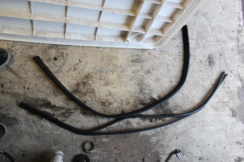

My delivery also included a new seal to go along the grill area, NEW V OLD
I then re-bled the coolant system using water. Purely because ive got to change the rest of the hoses and fit the polo rad at some point. Probably when I remove the air-con tbh. Anyways back together.

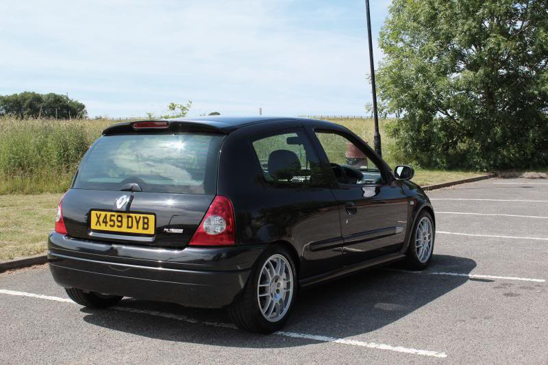

Looks lovely Dan, although I am a bigger fan of the 197 badge as opposed to the 200 one.
Either way, ph2 bootlid has cleaned it up no end :)
cheers :) it does look simpler with the ph2 boot, new plates will finish it off nicely now!

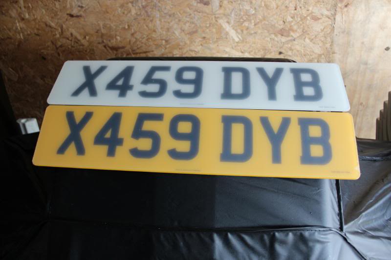

Fresh plates, Craig. happy now? ;)
& fitted. Looks better IMO.
Thats the outside done until/If I start getting stuff resprayed.

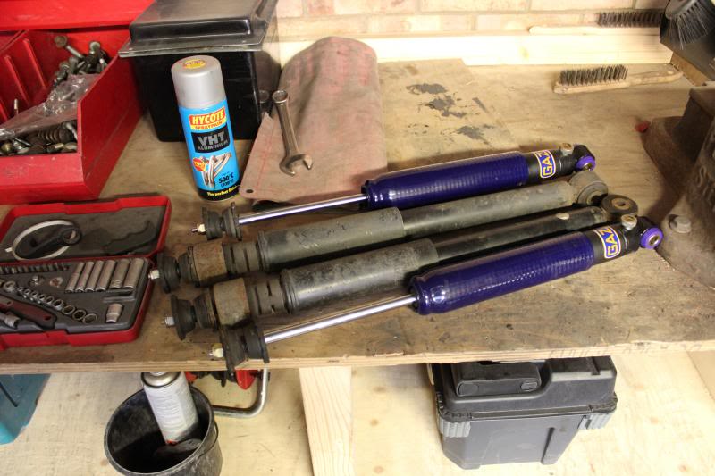

In other news my rear shocks have been serviced, just waiting on a call from gaz to pay for them & a new set of rear springs. Great service from them so far!!
Re: dmallett's indecisive clio thread! Monaco ph2 pg1+, Titanium ph1 pg31+, PB ph1 pg

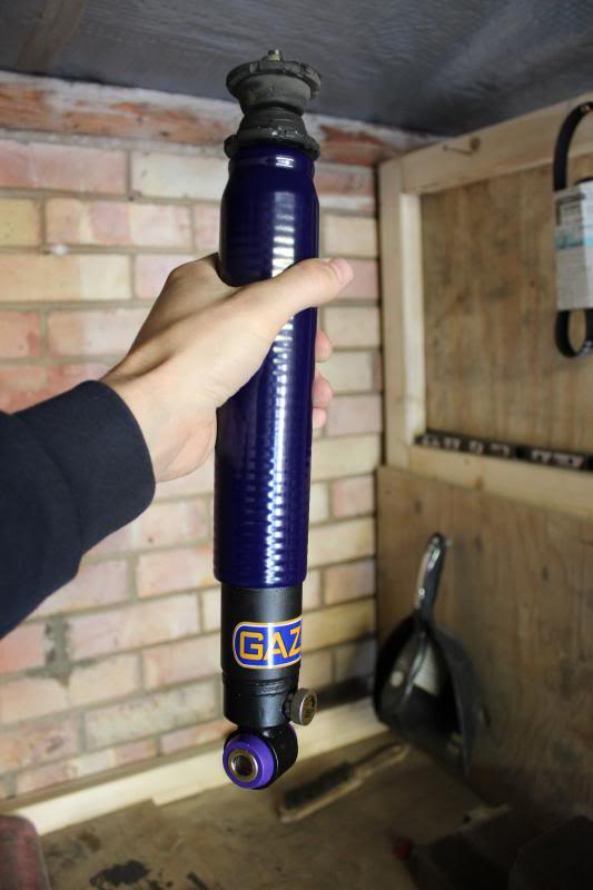

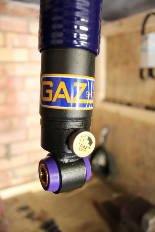

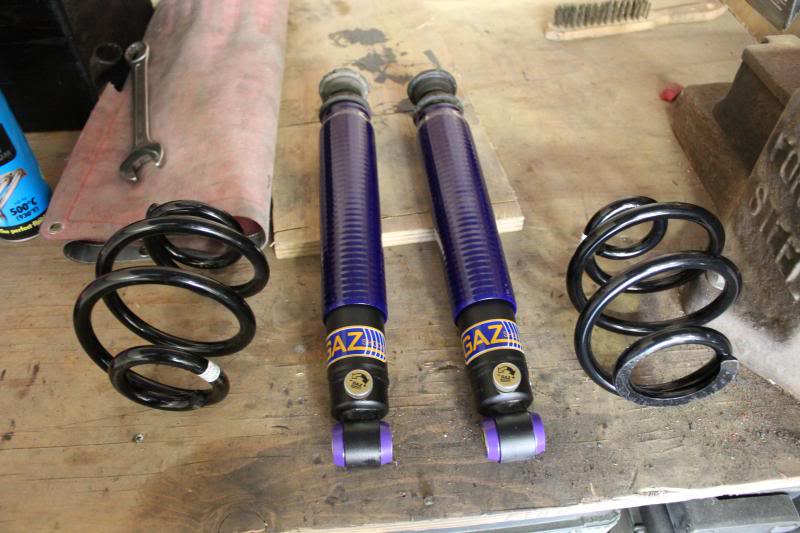

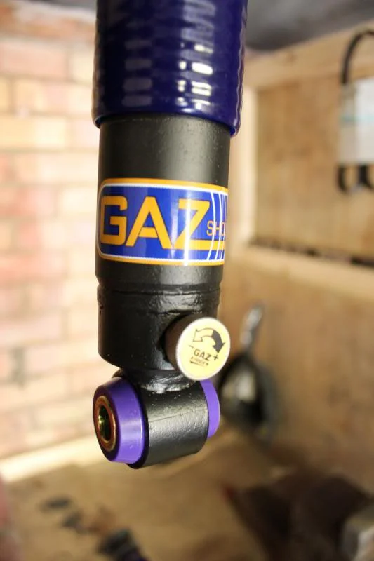

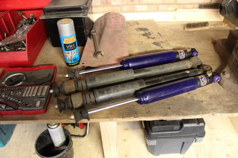

Received a rather anticipated box today from Gaz.
Which held to nicely refurbished rear shocks and two brand new springs.
Basically look brand new :eek:
And the best bit was the price.
Unfortunatly Im not going to get a chance to fit them for a while due to other commitments, though Im desperate to get them on as one of my standard rear shocks is oozing oil now too.
As for Dealing with Gaz;
the price of the servicing is ridiculously good
the service is spot on, really helpful and friendly
the turn around is super fast, I only posted them Last Wednesday via 48hour courier
they called to check if I wanted to change the spring rates and talked me through the difference it would make.
For once I can not grumble!

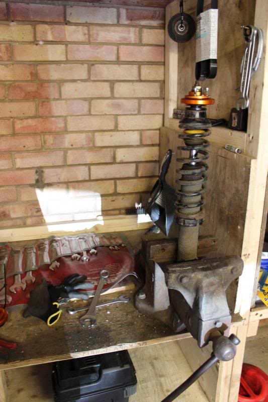

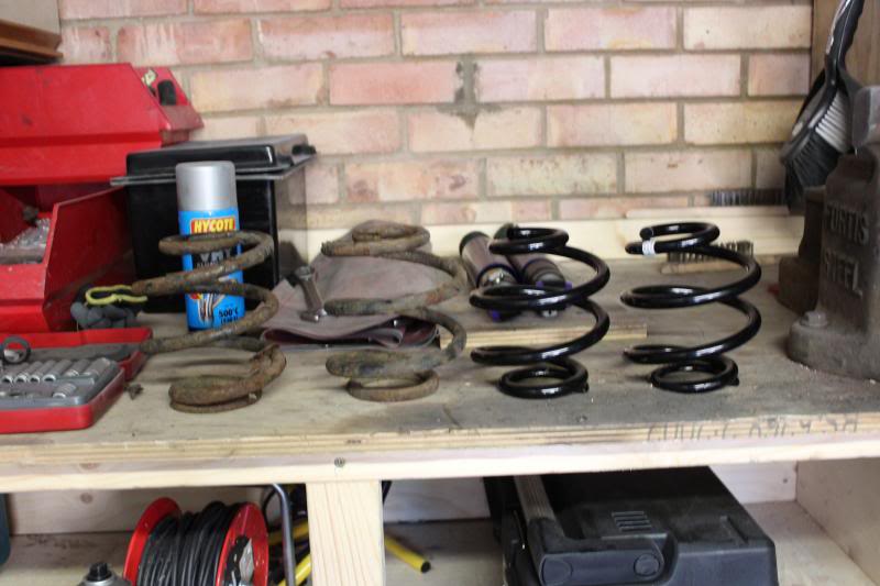

Got round to fitting my springs/shocks.
Old v New,
This was the height before,
This was after, looks no different to me! Though Ive wound the adjuster plates down to half way, will wait and see how it sits in a few days and adjust it accordingly from there. I imagine it will drop slightly as the sprins are new.

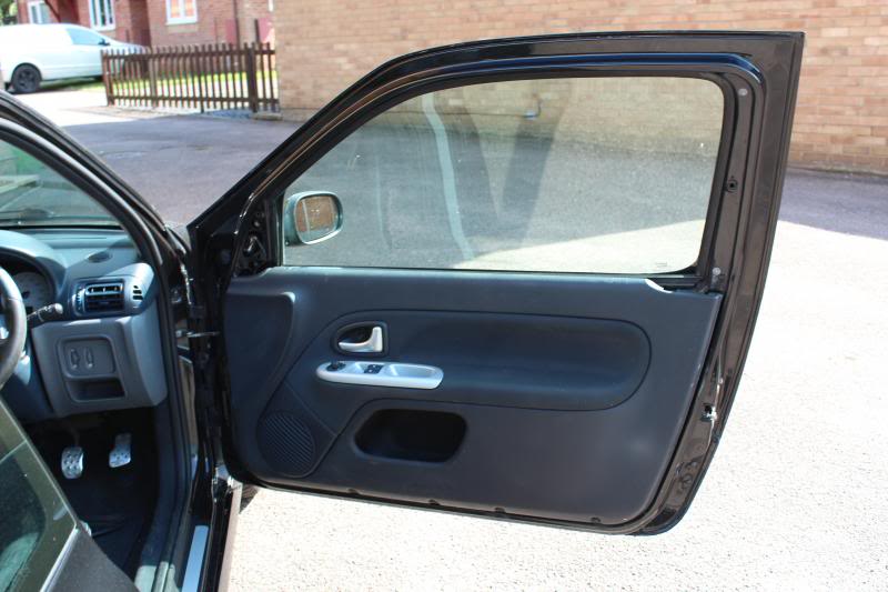

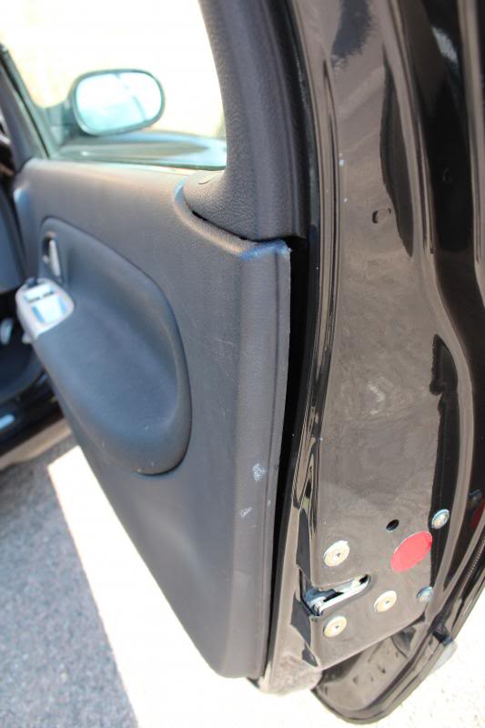

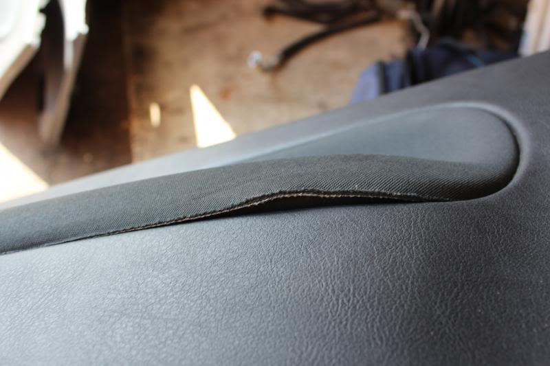

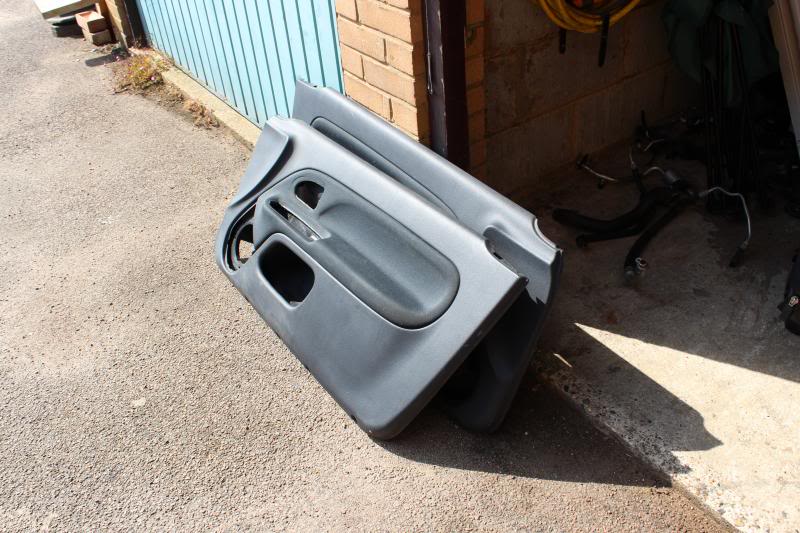

@AlexW kindly donated some door cards from a cup he once had, pauper spec light weight ;)
Reason why I swapped them, this had happened on both. Why glue it back down when you can just swap them?
Random door picture
Unfortunatly I lost one of the bits the door pops onto, anyone know where to order them from?

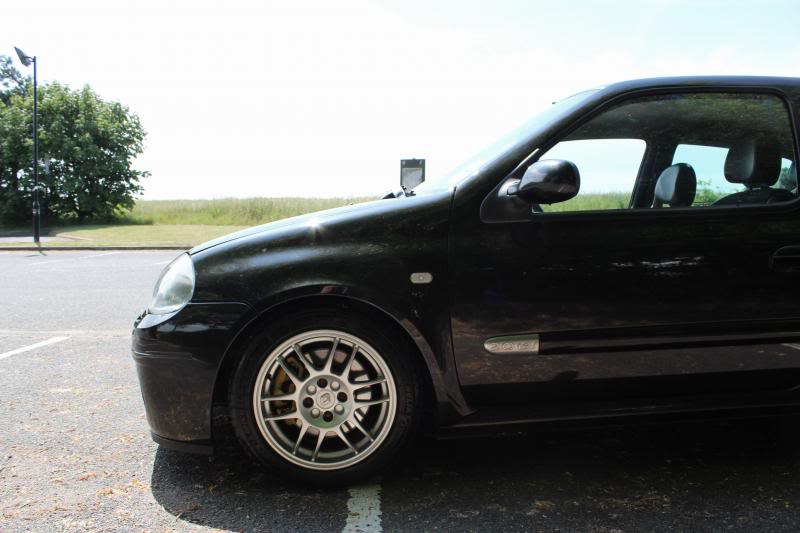

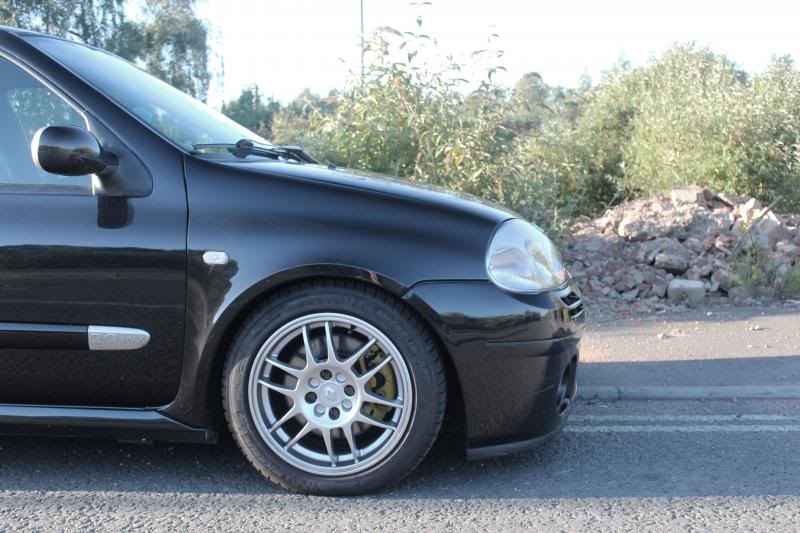

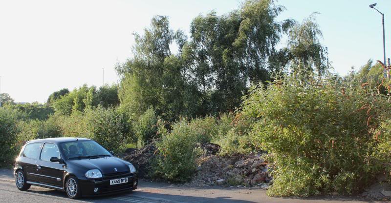

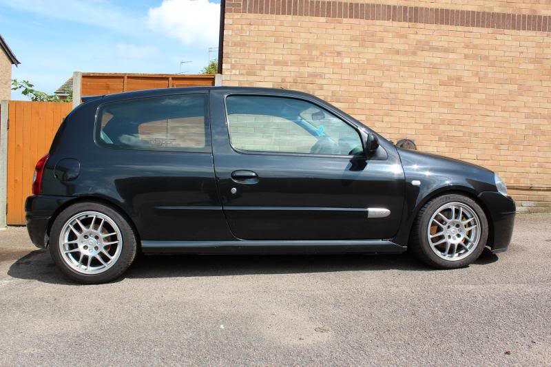

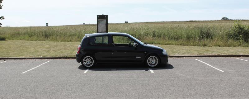

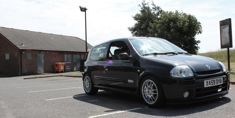

Took the car to be cleaned at a local car wash then for a drive around some of Suffolks back roads, pointless cleaning the car really as its dusty already.

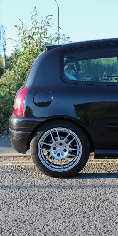

Seems to be handling much better now on the Gaz rear shocks, think Im going to spend abit of time/money dialing in the geometery as its working pretty well now but I know it can be better!
Thought Id stop and take a few pictures in a disused industrial park on the way back, forgot that I have the CPL filter on the camera so had to edit the pictures as they just looked weird.
Need to lower the front abit more IMO. (abit means a tiny weeny bit)
Hopefully the rears will drop slightly more in the coming week.
Certainly a nice car to look I think.

I wouldn't touch that front at all - that's spot on for me.

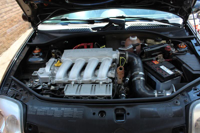

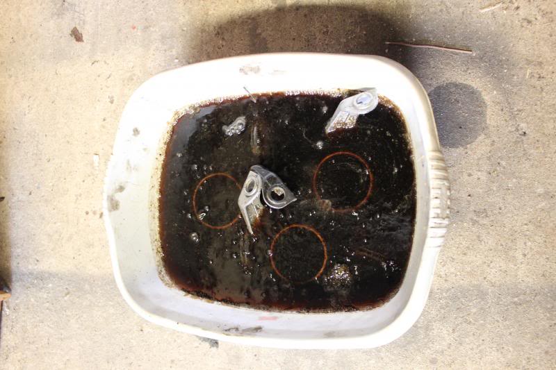

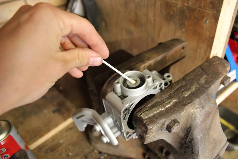

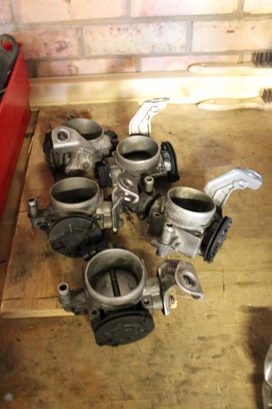

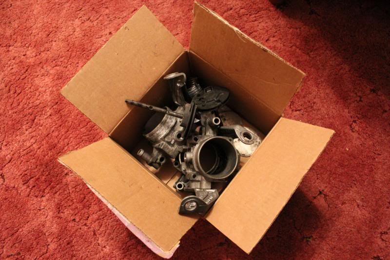

Some progress has been made.
First off I took 3 throttle bodies and dismantled them.
Leaving me with this,

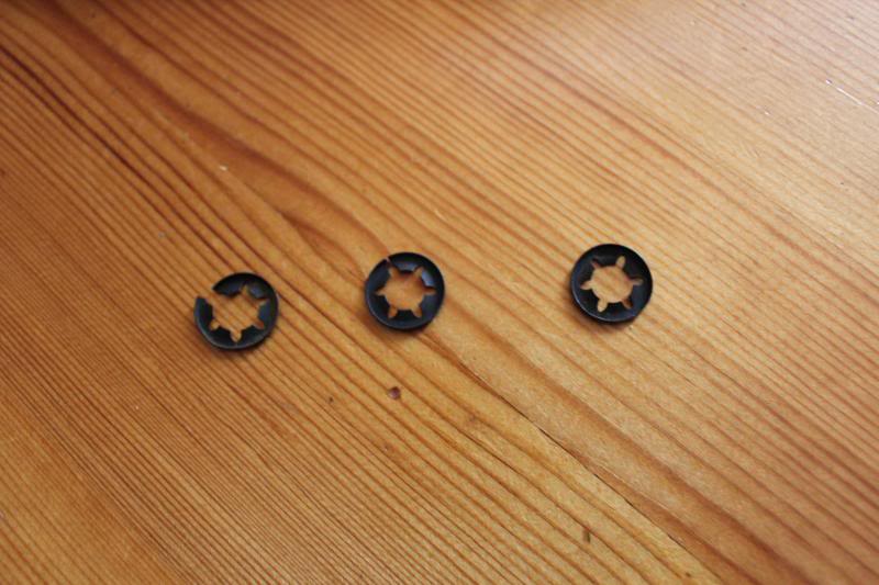

I noticed some weird things, such as egg shaped holes.
& broken circlips.
Set about cleaning them up, the sand blasting place beside my yard is shut due to annual leave. So I did the next best thing, used come coca cola.
I then de-greased them and they are pretty clean. I got some new circlips, some loctite and some grease. Look at that for precision lol
Oh and it got painted and fitted, works a treat! Only re-assembled one for the time being.

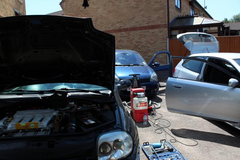

@hiben1 and @Ste101 came round and hired a rug doctor (steam cleaner) they kindly cleaned my interior for me, the passenger seat was disgusting. someone has s**t them selves on it previously we decided.
Look at that filth!
Much cleaner now!

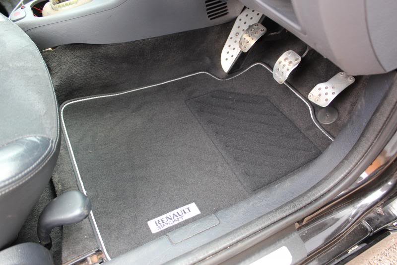

Got some new mats too, old v new.
They match my ph2 interior nicely!

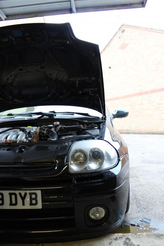

I removed the aircon, this is the least pictured part lol
To summaries,
Megane alternator set up fitted
Polo Rad fitted
Silicone hoses fitted
Pacet slimline rad fitted
Induction kit changed ( need to sort something better out)
Before
After
Removed parts, also got rid of the block of metal under the engine mount.

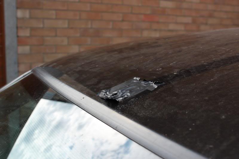

Lost my aerial too, temporary fix which I think has blown off already :eek:
And finally some whoring,
All in all good weekend, car now handles better and is lighter and easier to work on.

How comes you decided to remove the air con? To release a little more va va voom or to create a bit more space or both or more?
Why you thinking about bigger front spacers?
Also i think the front is fine, it doesn't need to go lower. IMO.

25mm front spacers? lol

Because I had the set up sitting in the garage, air con never worked anyway and im not used to having it. I also like the extra space it creates. Mainly I love simplicity, im still tempted to try it with out PAS :eek:
Its seized so it cant go lower, for now! As for spacers with the castor/camber the wheels are looking pretty hidden up front now so Im debating a change. I can try the 5mm rear spacers on the 20mm front and see how that looks before I commit!
Looking good dude.
Cheers! 25/30 need to do some testing. I think ill be changing to hub spacers on the rear too, shame they dont make .5' camber ones though!

Makes sense mate. When I set mine on max camber the 20mm look too small so I see where your coming from.

Looking good mate. How was the coke for stripping crap off? Work well?
It worked wonders! When I first tried to clean them I sprayed them with some brake cleaner, it hardly moved anything. But after soaking them in coke and respraying them with brake cleaner the s**t fell off! I was suprised how well it worked.
Under £1 too!
Im not even running max camber! But they are looking hidden, ill have a play about! I can build it up to 30mm to see what its like safely using my 5mm spacers! ( I wont drive it though, thats asking for trouble as there will be hardly any thread in)
What rear spacers have you got on yours mark?

I got 10mm rear hub spacers with no camber.
Ive actually stopped drinking it except if I go out for a meal, its my treat these days! lol
nice, I dont know wether to 10 or 15 then add .5' camber. If I go 10 and its not enough I can use my 5mm spacers I guess. Oh decisions.
