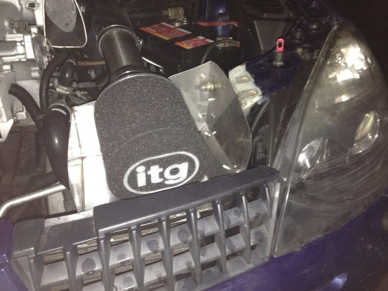

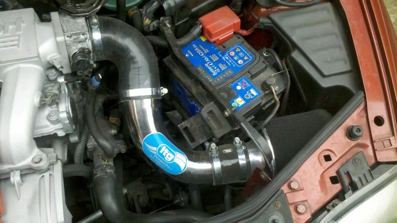

I love your heat soaking device ;)
Will fold some stainless 1mm sheet into a heat shield for it tomorrow as its sitting above the rad.
;) problem solved, got some nimbus heat shield in the garage also that can be fixed to the stainless if it does still get warm.

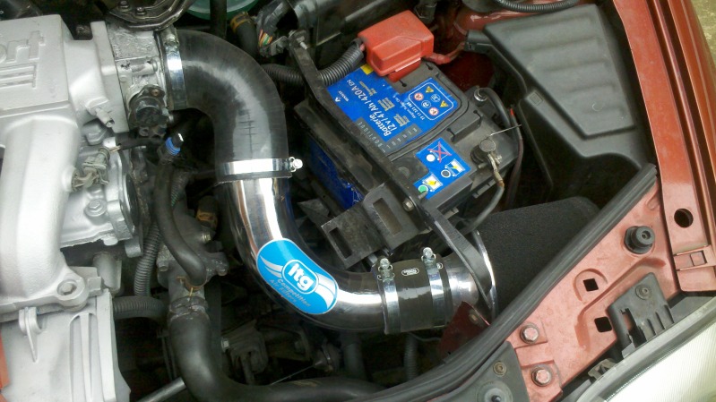

Disrespecting my filter? These filters have seen better gains than the ktec ones ill have you know! This way its much more open to cold air, compared to my old set up on the ph1. Note the filter ;)

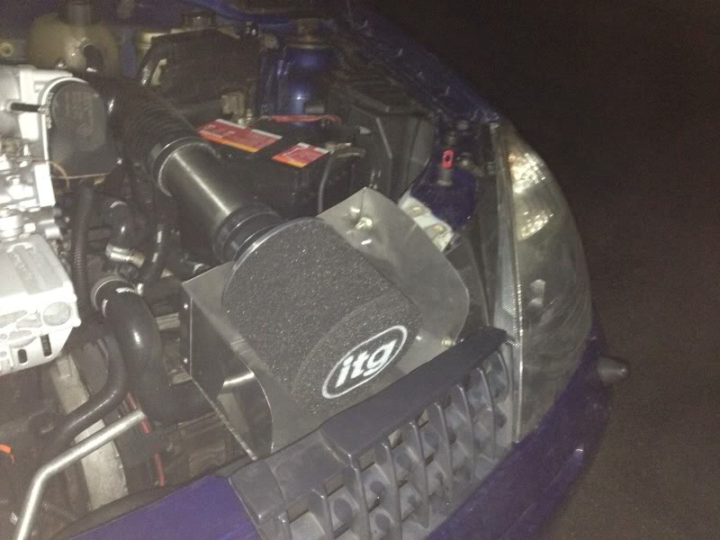

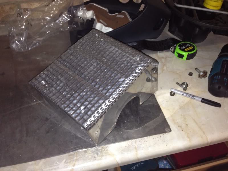

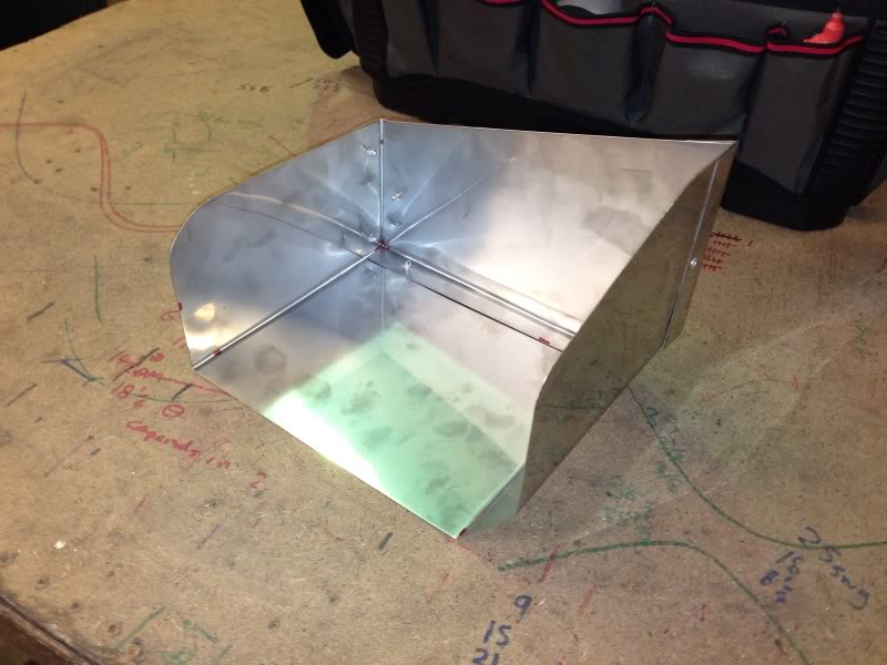

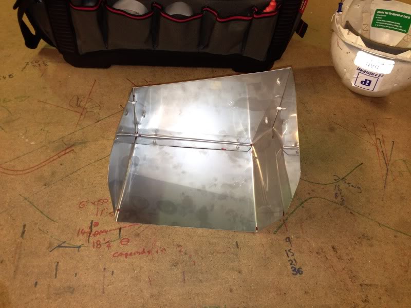

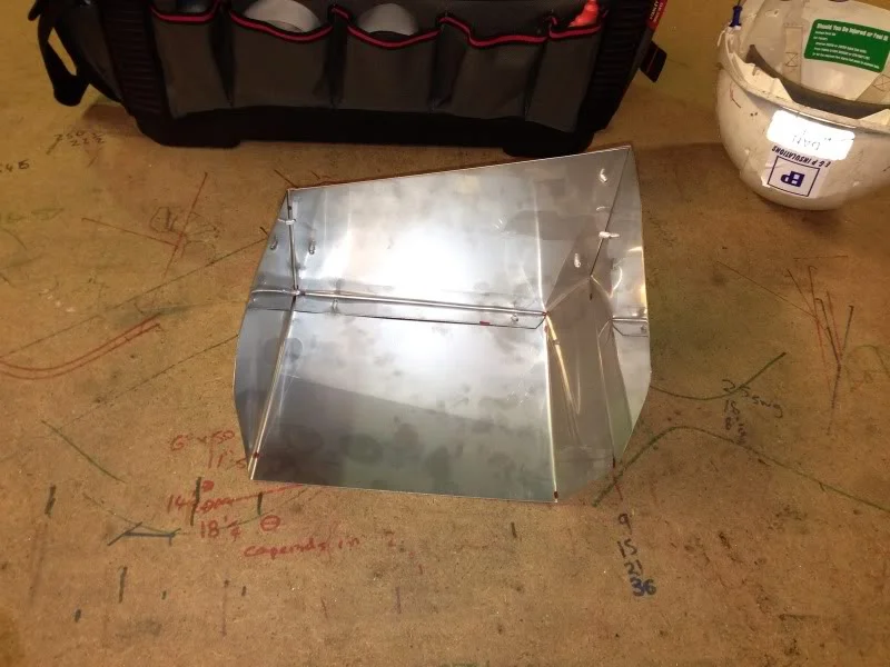

Pikey heat shield time!
As i broke the lock former at work folding stainless and riveting it together had to suffice. Ended with this in about 5minutes,
Added some nimbus heat shield to the under side for that extra bit of cover,
Then fitted it so it cleared the rad pipes so it wont damage anything, few bolts holding it, unsure how long it will last but its not like it was hassle to fit or if its actually making any difference as the cars still missing two wheels!

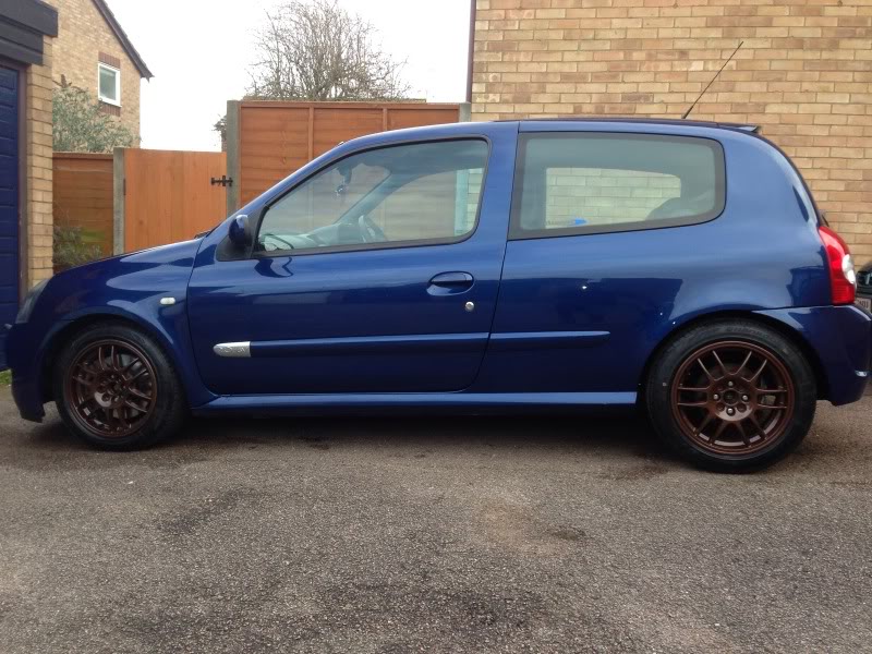

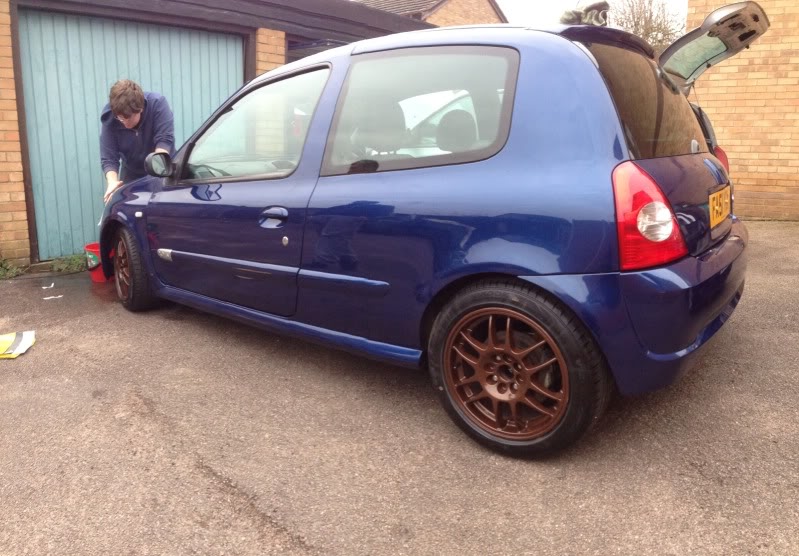

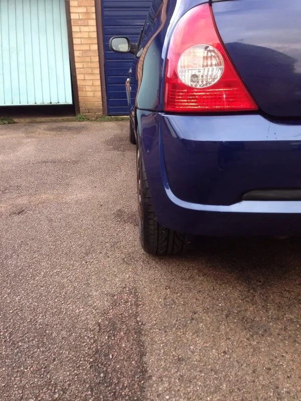

Back on all four wheels now, it even got a clean amazing what £6 gets you!
Show the rear width with the 10mm spacers,
Just waiting on the 25mm spacers for the front, then its MOT time followed by a service.
Hopefully most agree with me on the colour and think its passable, not quite what i was hoping for but for the small amount of money and time it will do!

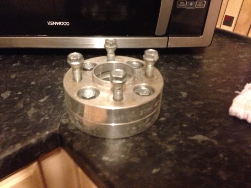

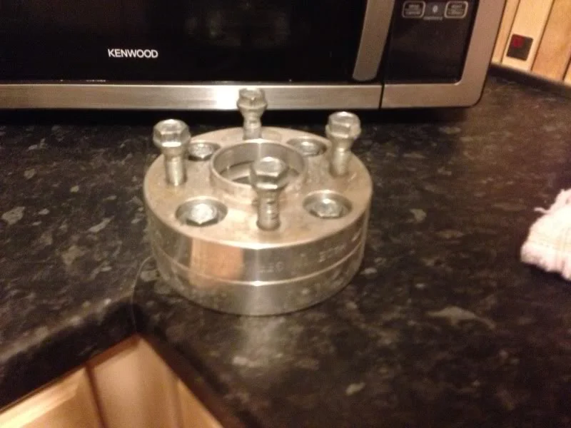

Spacers turned up, will be getting these fitted at the weekend, 25mm for eitheer side.

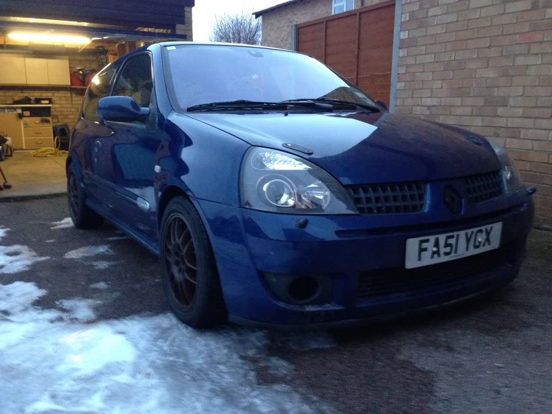

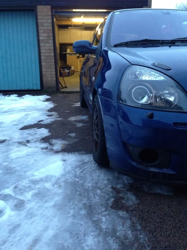

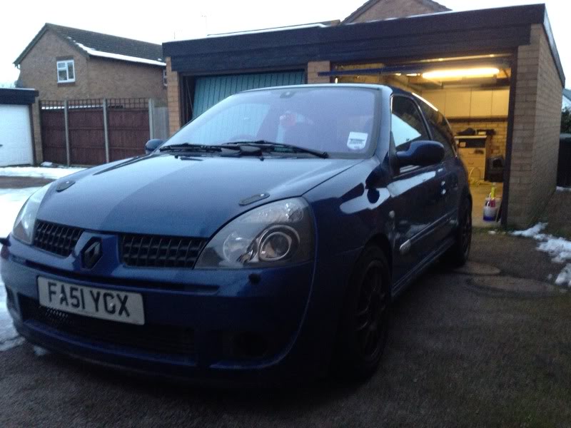

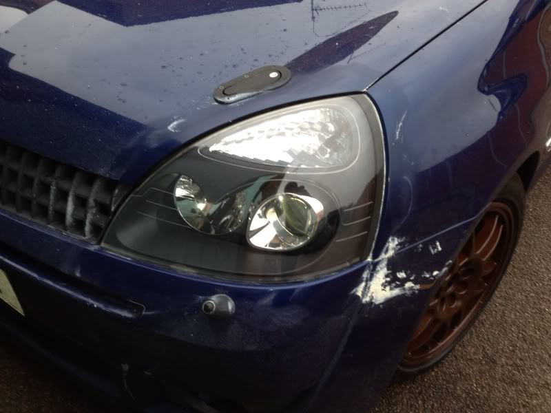

Last weekend my friend and fellow clio sport member hiben1 restored my head lights, here he is in action lol
Needless to say they are now mint, excuse the white polish s**t everywhere.
Heres few pics,
And it yesterday in a spot of snow,
Need to sort an MOT out as ive been lazy :eek:

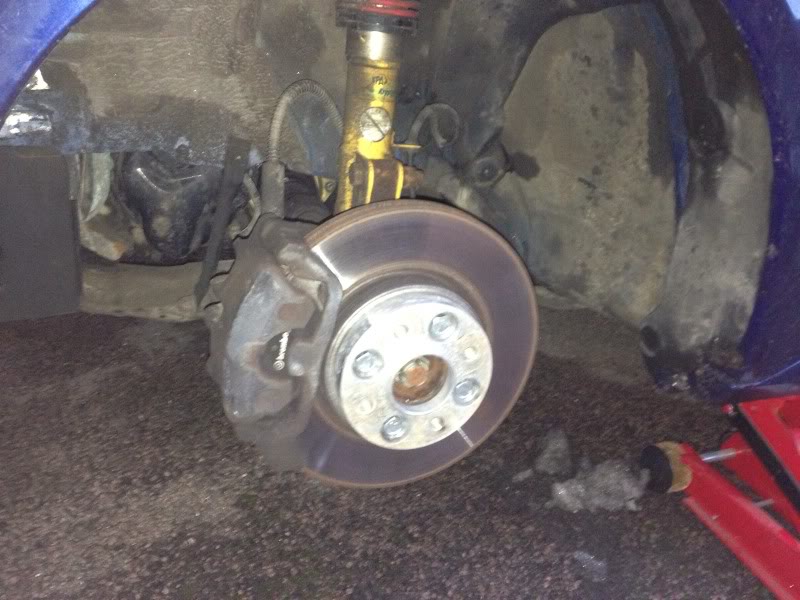

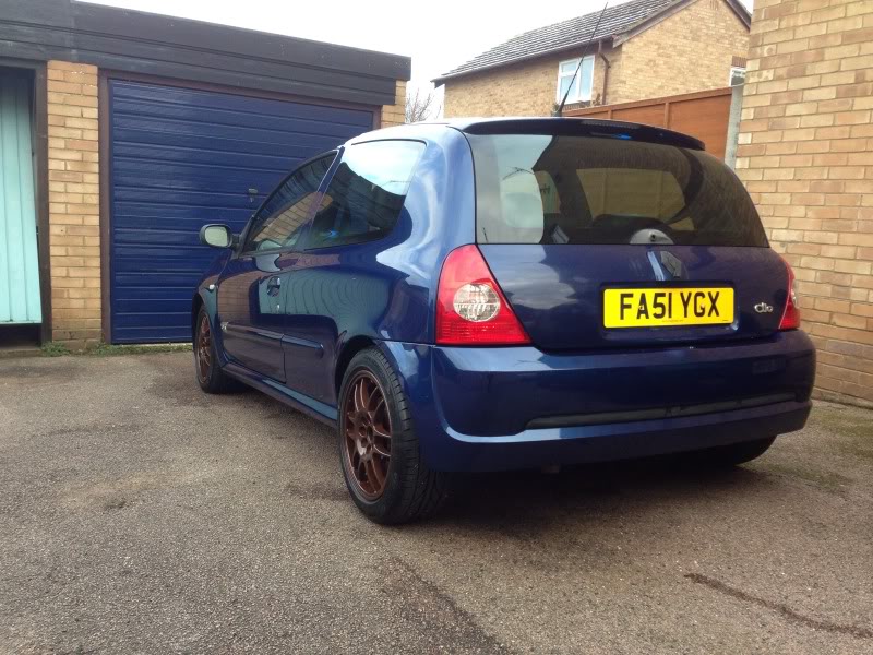

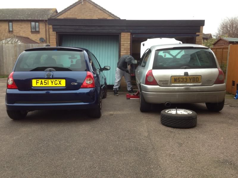

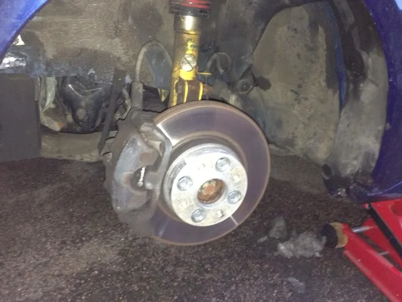

FK 25mm spacers added to the front,
Nice and grubby in there
Think it will be staying at the height it is for now as it doesnt seem to rub anywhere on all 4 corners which is nice!
The car feels nice on the road and pretty planted so im happy with it. Compared to the ph1 its only missing the Whiteline RARB and solid topmounts, then its pretty much setup identically!

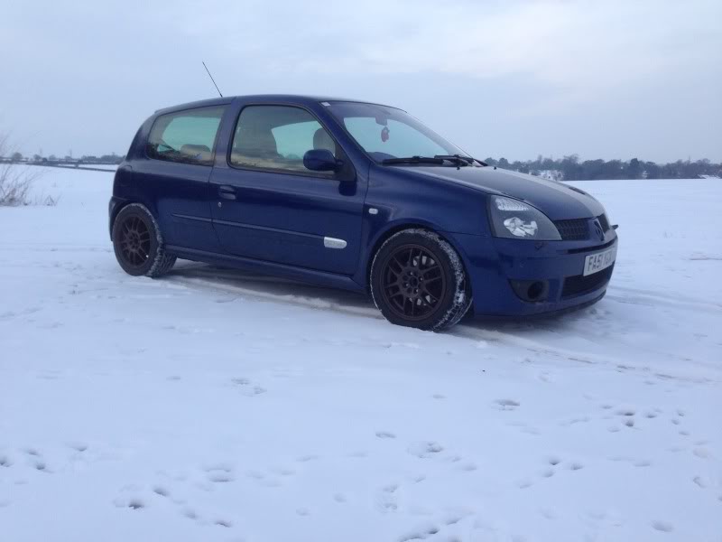

Couldnt resist a snow shot :eek: ive also got a slow puncture in my front wheel
