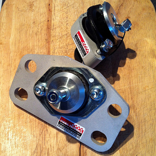

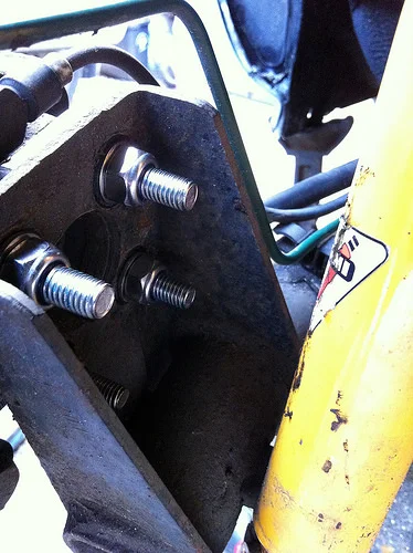

Got a few more bits done on the clio today:

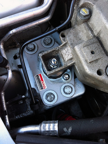

Vibra-technics solid engine and gearbox mounts by Dr-Jekyll, on Flickr
Fitted

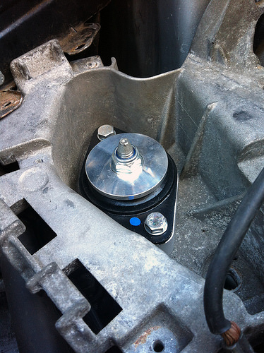

Vibra-Technics solid gearbox mount by Dr-Jekyll, on Flickr
Vibra-Technics solid engine mount by Dr-Jekyll, on Flickr

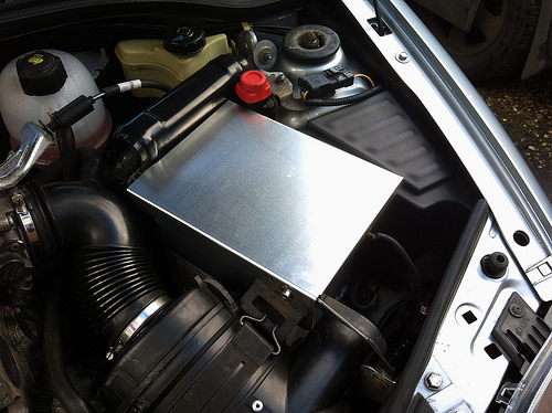

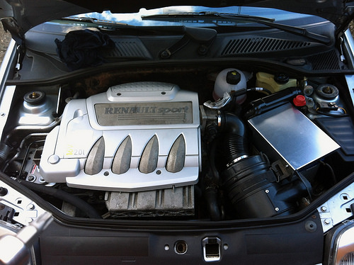

Managed to straighten out the battery cover. The kink is still there but is mostly hidden by the induction bend.
Myldan battery cover fitted by Dr-Jekyll, on Flickr
Engine bay (19.10.14) by Dr-Jekyll, on Flickr

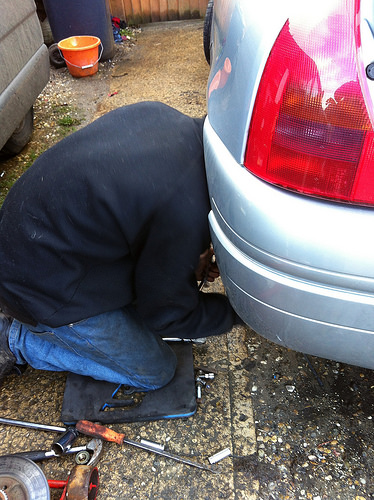

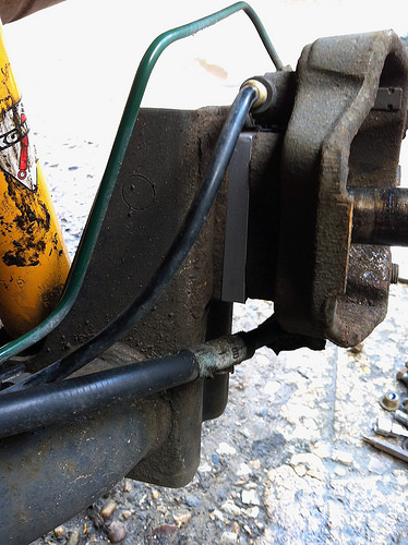

Then Alex set to work at fitting my rear spacers
Alex at work by Dr-Jekyll, on Flickr

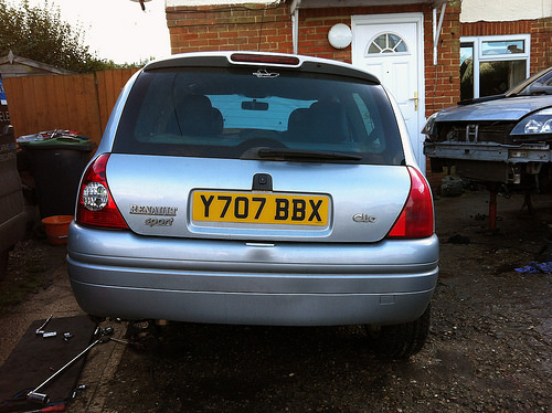

Rear hub spacers fitted by Dr-Jekyll, on Flickr

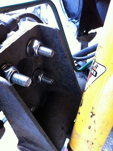

Rear hub bolts by Dr-Jekyll, on Flickr

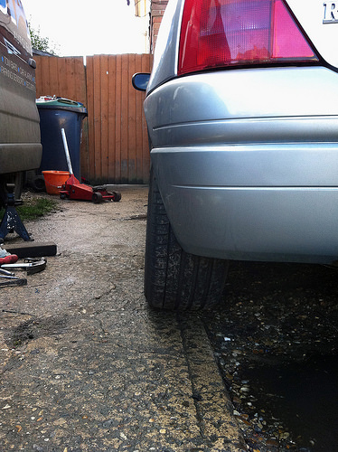

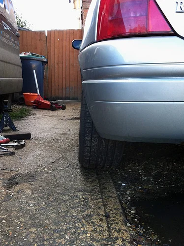

Got camber y0! by Dr-Jekyll, on Flickr
I took many looks at it at many angles and i dont like the camber. Its too much for my liking. This leaves me needing to order new hub spacers which after last orders is not going to happen, find a 2nd hand set or get camber shims and reverse the camber. I had a look on Ktec's website and they are £15 for the pair:

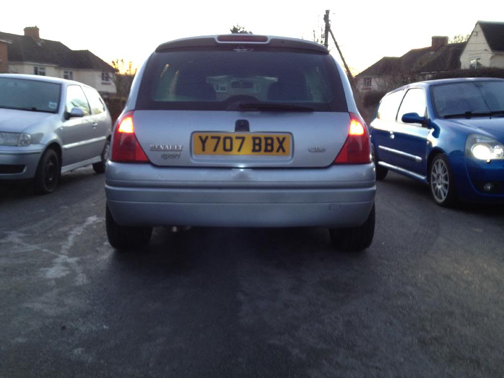

Also quickly fitted Alex's rear lights off he's Ph2 after seeing a load of silver Ph1's with them fitted.
Ph2 rear lights Vs Ph1 rear lights by Dr-Jekyll, on Flickr
Actually think it suits really well after seeing them in the flesh, hmmm.

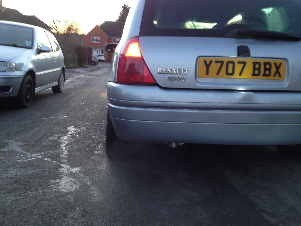

Couple of more pics of the Camber yo!
Personally, I don't mind it so much, I followed it up the road and it don't look as bad as I thought it would.
But Mark is picky, and I knew straight away that I was going to end up changing it again in the future!

Looking good mate, im unsure on my rear camber too, i think i prefer it with just the fronts done so ill probably take them off soon.
It doesnt suit the clio on the rears imo, the fronts look good tho.
welshname
Looking great and I agree in the rear camber. Looks far too try hard for an OEM+ car.

Good mod the solid mounts I loved them when I 1st fitted them on mine.
The ones from ktec are powder coated in black.
DT ones will just be bare alloy which will go dole in time as there is no protection.
I had mine powder coated so this wouldn't happen couldn't be having scabby looking mounts in the engine bay lol.

For looks tbh mate. The Ph1's really need it up front as the wheels look tosunk into the arches, more than the Ph2's.
Nowt wrong with a bit of camber, gives it a bit more of a purposeful stance imo.
I agree with Rhys and Tom, bobby. Its too much IMO and its not really for me on my car.
Agreed on the side strips Craig, although they do look great on Harphams!
I like the mounts so far mate. As said there is more vibration than standard but not enough to bother me. It feels better when giving it some too :race:

I have also ordered some new wheel bolts. 8x M12 x 1.5 x 22mm with a 60degree taper for the fronts spacers as i know you need to shorten them and mine are manky and 8x M12 x 1.5 x the standard 26mm 60degree taper for the rears.
And i Have bought off Ph1 Tom some 1 degree camber shims to reverse the current rear camber
http://www.cliosport.net/forum/showthread.php?728043-Brand-new-camber-shims
Ordered some 20mm spacers today. Decided with hubcentric H&R's.
Yeah I noticed the vibration at first but it doesn't take long for it to just feel normal.
Good choice on the 20mm spacers mate, 25 is just abit too much imo.
Mark wont be wanting to try my ph2 side strips then!
I agree with your above comments on the mounts, never been in a car with them and standard interior though. In mine the vibrations are pretty noticeable.
