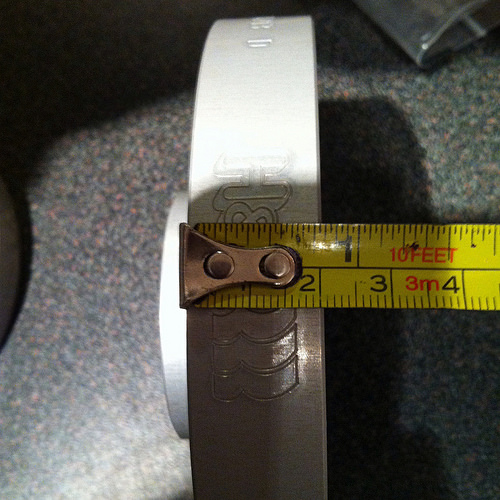

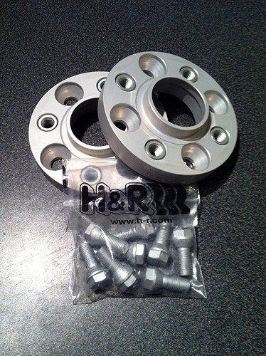

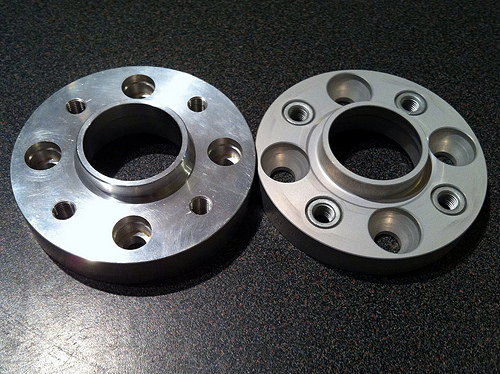

Had these turn up this week.
H&R 20mm spacers by Dr-Jekyll, on Flickr
H&R 20mm hubcentric spacer by Dr-Jekyll, on Flickr
Fantastic service from Larkspeed :) Only ordered them monday lunchtime and they was here Tuesday when i came home from work. They had to be ordered in too!
Comparison between Dan@MAD and H&R's
Myldan spacers Vs H&R spacers by Dr-Jekyll, on Flickr

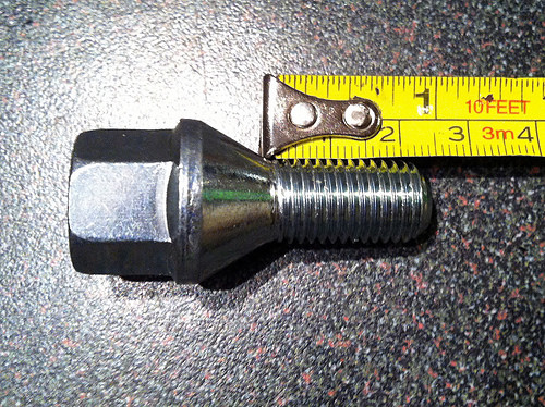

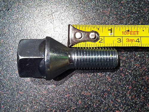

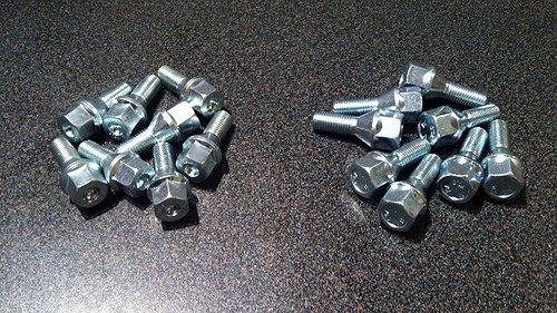

New wheel bolts to compensate as my old ones are a tad manky and i needed to shorten the fronts to fit the 20mm spacers so made sense to get some shiny ones
New wheel bolts by Dr-Jekyll, on Flickr
New shorter wheel bolts for the fronts
New from wheel bolt length by Dr-Jekyll, on Flickr
And standard sized rears
New rear wheel bolt length by Dr-Jekyll, on Flickr

They look well made Scott. I don't know why I was wanting H&R's over FK's but I went with what my head said.

The H&R's have got proper steel threadded inserts for the wheel bolts, hmmmm very nice. :approve:
  Many.
Seeing those, Even I prefer the H&R's, However, as I said to you, have no problem with my FK's through loads of abuse and a trackday.
Got you thinking now ;) They do look better quality than the Myldan ones tbh.

So you do you need longer bolts for the 20mm ones Mark? I'm going to be getting them soon and reverting back to bolts instead of studs.
The name change confused me for a mo. If your thinking of 20mm spacers then you will need shorter bolts than standard. I read on here that few people on here have shaved the ends down but I ordered shorter new ones. Standard thread length is 26mm and I didn't think people would remove anymore than 4mm of thread which was the next size down so I ordered 22mm threads for the 20mm spacers.
@Phase1sr Could you measure your front bolt thread length sometime to clarify please?
  Many.
If you fit the front spacers round mine, I'll check the bolt lengh before fitting anyway, and if I think its better to fit the longer bolts and trim them down a little, I will.
It depends how far the bolts stick through the wheels.
  A special one.
Mine are 24mm mate, as i said they only needed a couple of mm to clear.
So yours at 22mm will be fine. :)
Ahh right, I was thinking the wheel bolts just went through the spacer and into the hub as normal. I'll get these ordered I think !

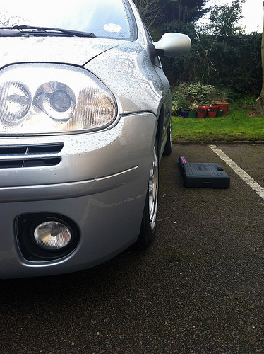

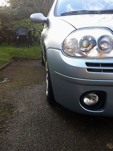

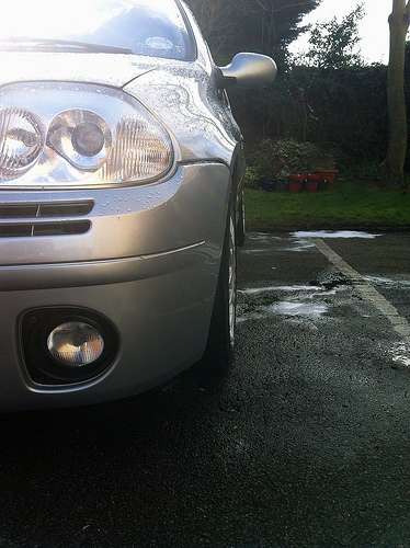

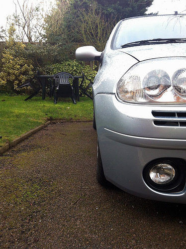

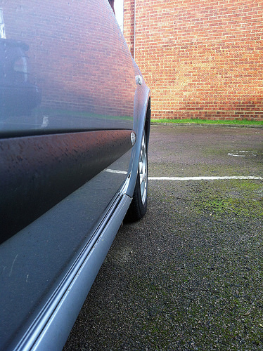

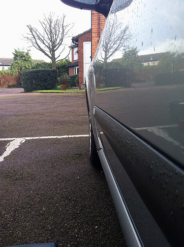

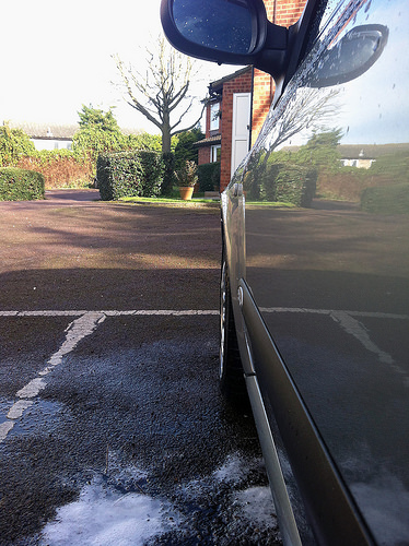

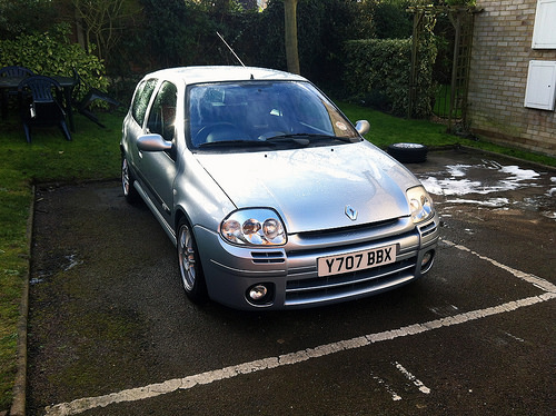

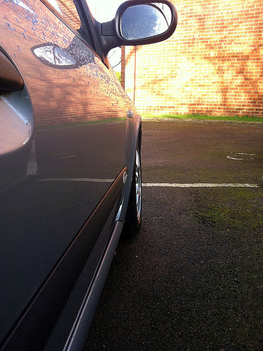

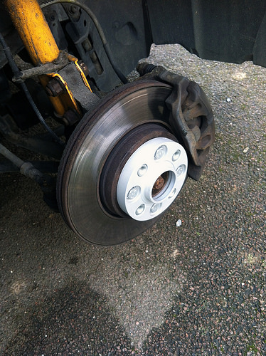

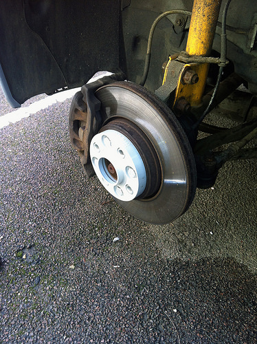

Thanks for the feedback guys. Managed to get a few more bits done today. Fitted the front spacers and new center exhaust mount. I got to admit, i think it looks perfect up the front! I'm glad i went against the grain and got 20mm's.
Before:
Drivers side without spacers by Dr-Jekyll, on Flickr
Drivers side without spacers. by Dr-Jekyll, on Flickr
Passenger side without spacers by Dr-Jekyll, on Flickr
Passenger side without spacers. by Dr-Jekyll, on Flickr
During:
Without spacers by Dr-Jekyll, on Flickr
Driver's side spacer fitted by Dr-Jekyll, on Flickr
Passenger side with spacers fitted by Dr-Jekyll, on Flickr
After:
Driver's side with spacer fitted by Dr-Jekyll, on Flickr
Drivers's side with spacer fitted. by Dr-Jekyll, on Flickr
Passenger's side with spacer fitted by Dr-Jekyll, on Flickr
Passengers's side with spacer fitted. by Dr-Jekyll, on Flickr

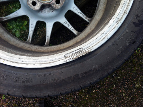

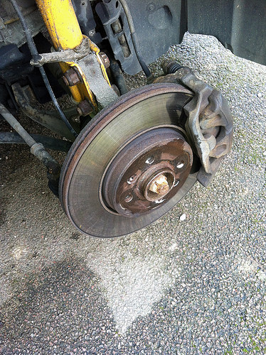

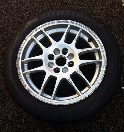

While the drivers side wheel was off i had a look at the back to see if it was buckled after hitting the pothole....
Buckled wheel by Dr-Jekyll, on Flickr
I've never had a buckled wheel on any of my cars :( Can getting wheel weights fitted ease the vibration in the steering wheel?
Also found a nail in the passenger rear tyre so i've removed the wheel so it can be repaired tomorrow. Took my spare wheel out and put that on for the time being, but it has seen better days!!
Spare wheel by Dr-Jekyll, on Flickr

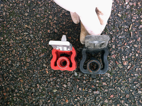

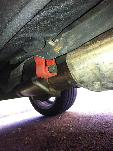

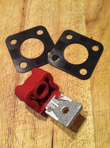

Fitted new center exhaust mount while it was up in the air
Center exhaust mount - New Vs Old by Dr-Jekyll, on Flickr
Center exhaust mount fitted by Dr-Jekyll, on Flickr

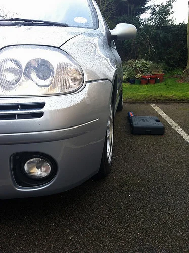

Then gave it a quick clean. Will get some better pics at the weekend. Getting the camber shims fitted on sat so hopefully they will reverse the -1 degree camber and then i will have 10mm rear spacers with no camber. If it doesn't work or i'm not happy then i will remove them all and get a 5mm rear wheel spacer either side.
Cleaned by Dr-Jekyll, on Flickr

I'd try bashing that front wheel straighter, then balanced. Or get the spare refurbed and chuck that on there.

20mm is bang on, i know its only 5mm but 25mm seems to be to much.
Totally agree mate. Even when i tried on Alex's 25mm i thought it was borderline but i knew in my head that i wouldn't be happy with them. I like a little tuck and this looks like it came out the factory like it, width wise.
Still on sportlines aye? Happy with width and height compromise?
Yep, still on the sportlines and Konis's. I adjusted them to the softest setting this morning too. Really happy with the width but it's not low enough for my liking. Im not a stance king but i do like the arch to be closed a tad more tbh.
Djw John
Scotland - South
I wouldn't be changing the height on mine, considering spacers now though. The 25 look daft on sportlines IMO. This has really got me thinking
