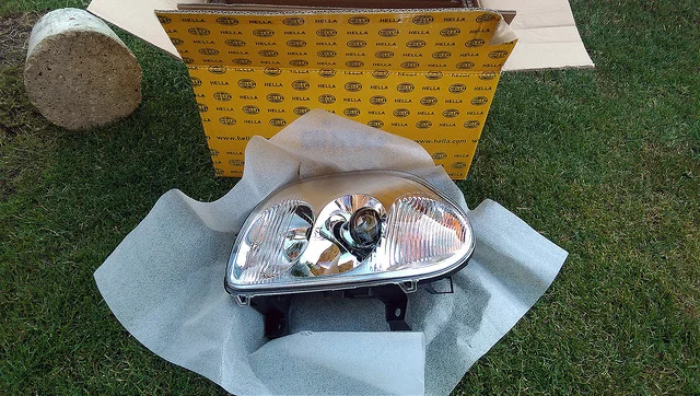

Next thing is to get the car sprayed. Going to wait until the cheque comes through and clears. Gives me a few more weeks to save a bit more. In the mean time I will buy a new headlight. It's a risk buying 2nd hand ones and the majority have knackered lenses. Spoke to Renault and they recommended me to go to Euro Car Parts as they are exactly the same, due to OE spec and noticeable cheaper!

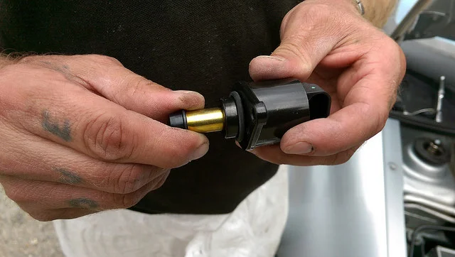

So following on from my revving issue on the link i posted, i believe the fault was due to the idle control valve. Throttle bodies and throttle position sensors were swapped, breather filter had a ally joiner fitted as it was a rubber end going into the breather pipe so lots of flex, removed the vacuum pipe off the inlet and refitted it and general cleaner of all parts and plugs.

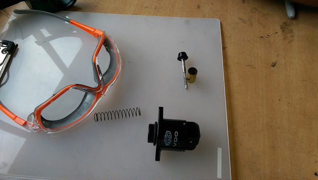

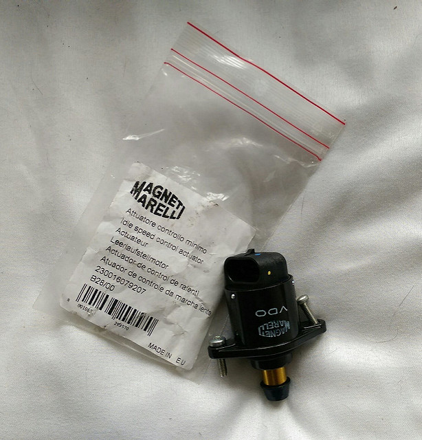

When i removed my ICV to clean up i noticed that it was pushed in. Upon inspection I noticed that it doesn't spring back smooth. (the shaft compresses when the throttle is pressed and releases when the throttle is released.)
Also turned out the the threaded part of the bolt was slightly bent. So I straightened it up slightly, being careful as it doesn't seem that strong, and re-greased it all up and put it back together. It was still not perfect (which I think was due the sliding side of things) but it was much better. Next day i ordered a new one from Renparts with next day delivery. It turned up on friday so friday evening i got it fitted.

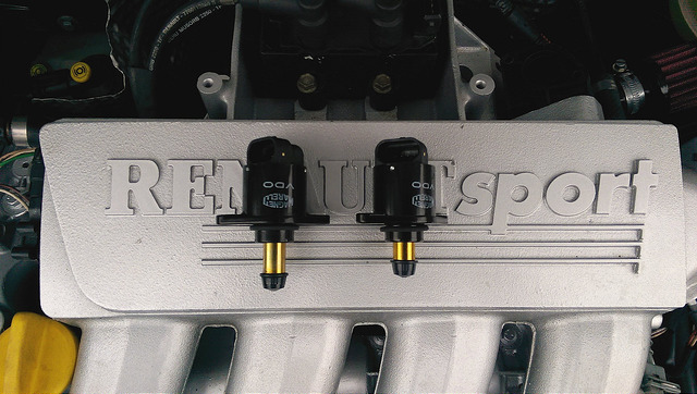

Old Vs New
Idles as it should, drives as it should apart from one time that I put it in neutral when coasting and the revs fluctuated a bit. Maybe the car needs to adjust itself? No horrible 2k revs when stopped though. I drive 15 miles to work so i'll see on the journey if its all sweet. Fingers crossed. Could be placebo but it seems more responsive on the throttle too.

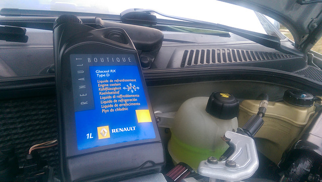

Coolant had dropped so i gave it a top up

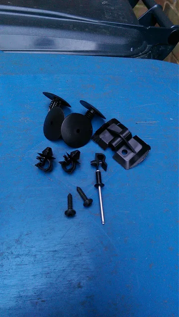

I've also started to collect some parts all ready for when the car gets painted. Having the ally bonnet fitted i knew that the clips would all need to be removed so i got new ones from Renault. I managed salvage my excellent condition stay from my old bonnet too.

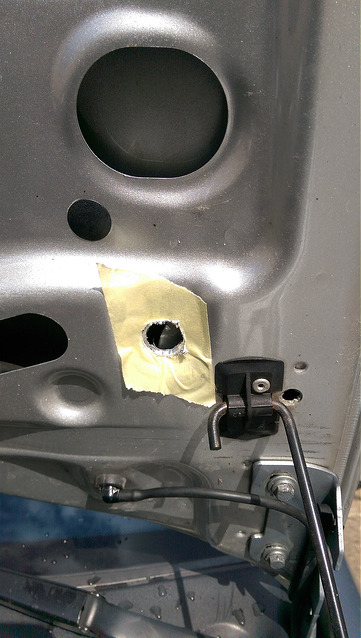

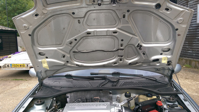

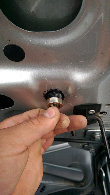

The BC coilovers that i run come with damping adjusters on the top of the struts. I like to keep these on as its easy to adjust to different setting if i fancy it soft for a nice drive or harder for a more fun drive. These are removable but knowing my luck i'd either lose them or have them in the glove box/ash tray and break the stems so i keep them fitted. The downfall is that they rub slightly on the underside of the bonnet. I did not want this on my newly painted ally bonnet so i decided to cut a hole where the adjusters rub.

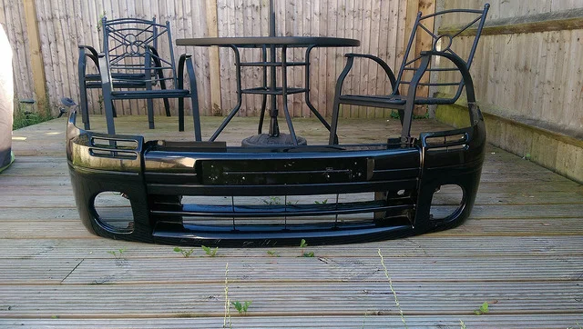

Both holes will be finalised and neatened just before paint. Next thing to get will probably be a new headlight. I'm getting a front bumper off @Daniel at CSS and @Sunglasses_Ron is taking back to Essex for me so once i pick that up i'll get that fitted and then wait for paint :)

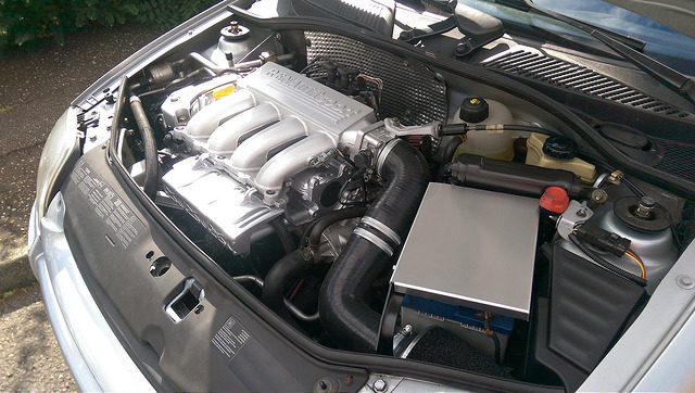

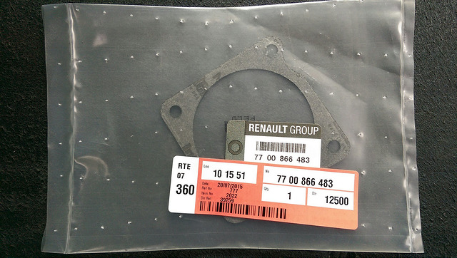

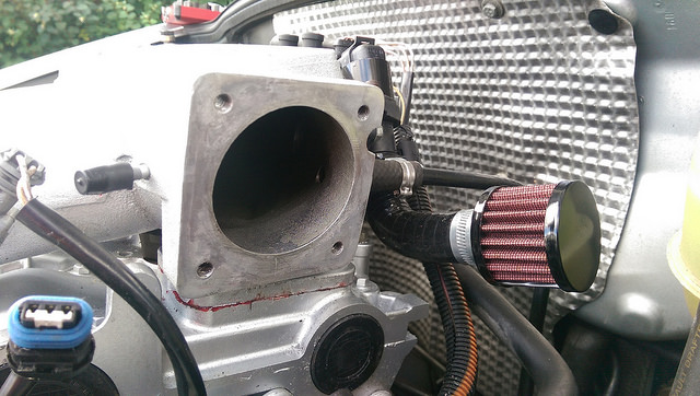

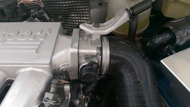

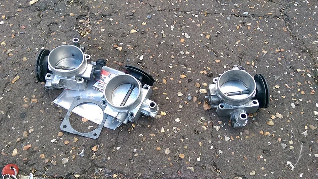

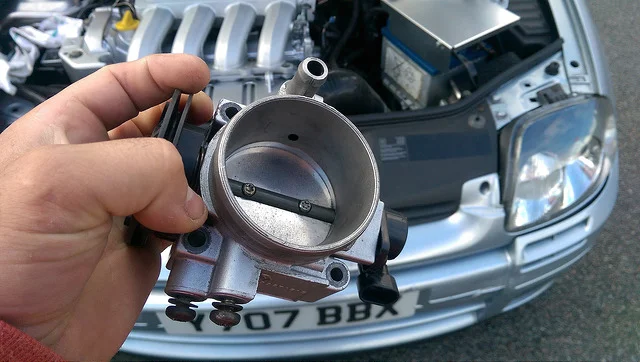

I sorted out the idle/rev issue. Turned out be be a slight leak around the throttle body. Took the body off and it turned out the gasket had broken. The next day i ordered a ph1 throttle body gasket from Renault for next day delivery.

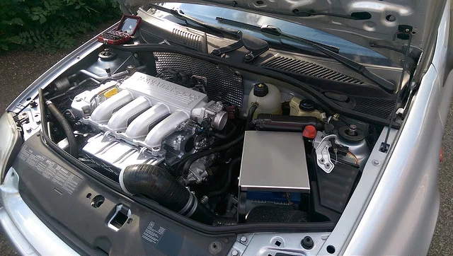

So the next day i set to get it fitted - Having the induction kit not only releases the inner chav, but also makes the engine bay so much easier to get to things over the standard airbox and bend. Throttle cable and bend off:
Removed the old gasket and gave the throttle body a clean:

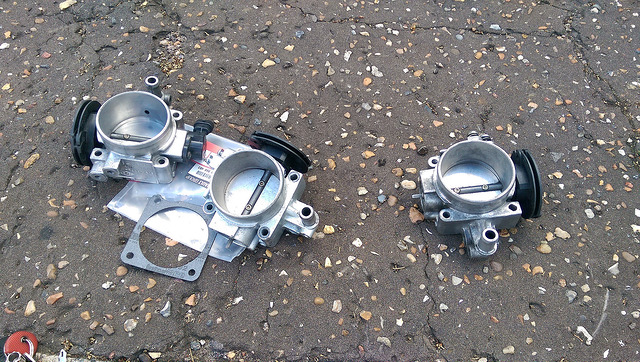

A few spare throttle bodies that ive collected!
All fitted and back together:

Had an awesome time and it was great to catch up with some old faces and meet new guys. Was great to finally meet @DieselDavis @dann2707 @Don @james24785 amongst many others. Was a total crack and i look forward to next years! While i was up the @Daniel bought up a ph1 bumper that i had bought off him and @Brian bought it back to practically my front door. Top chaps :smile:
Once the bumper was back home i removed the splitter as mine is in better condition and gave it a clean.

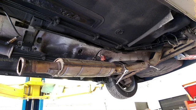

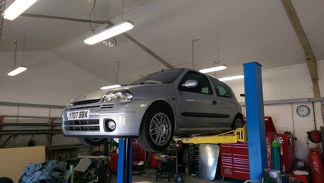

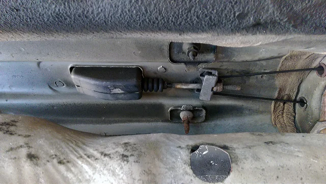

I'll keep it here until the clio goes into the body shop. Today i took the car to work as i wanted to tackle a few jobs, plus i went in to fit some brakes on a Jaguar for a friend. Once the brakes were done i moved my car up on the ramps. My jobs i wanted to do was adjust the handbrake as it was a little slack and pulled up too high, Re-align my exhaust and fit my other sprayed gear knob that i've had a while.

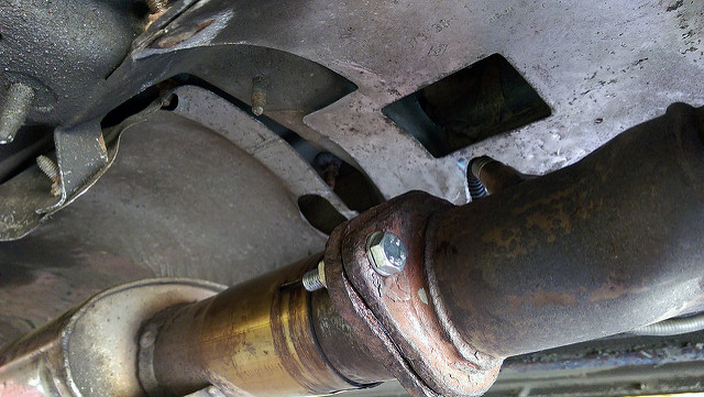

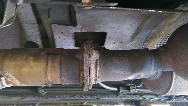

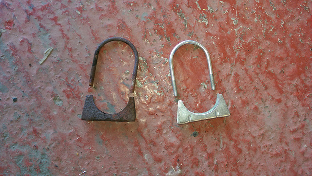

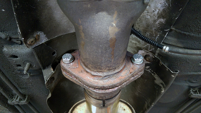

First job was to cut off the old rusty bolts and clamps and replace with new ones:

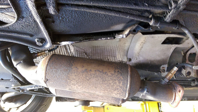

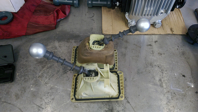

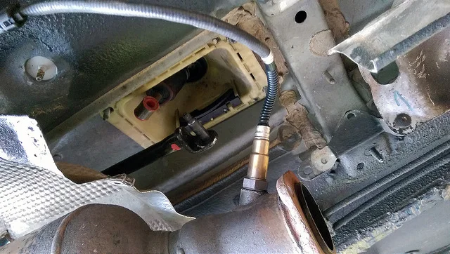

I then dropped the exhaust and cat, and the removed the heatshields to get access to the handbrake adjuster and gearknob:

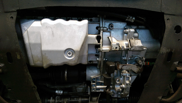

Took a quick pic of the sump and gearbox underside too and then adjusted the handbrake:
After that I fitted my painted gearknob:
After that i started to put it all back together, realigning my exhaust as i did so and giving parts a wire brush clean and then gave everything thats bolted or clamped some copper seal grease.
I also got @Kyle 86 to order me a new headlight which arrived quickly so today i picked it up from hes house. Was good to catch up and see he's clean cup :cool:

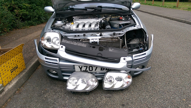

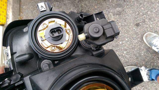

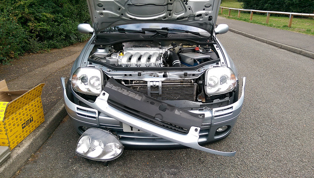

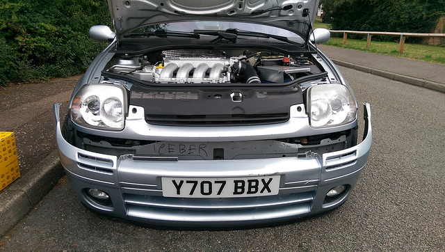

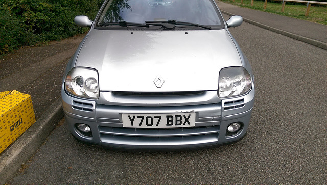

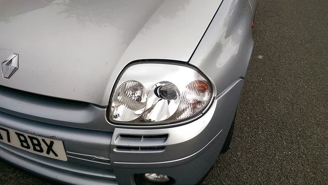

Changed the headlight tonight:
All plugged in and adjusted. Need to get some new bulbs next as I broke one of my Cree sidelights. It's still works but the end is loose so I will order some nice led ones.
I'll order some new headlight bulbs too as well. I currently have some mtec super white ones which are nice and bright and give good length but they still seem yellow like my old nightbreakers. I might try a blue bulb instead of a white bulb. I'm hoping that that will give off a white-ish look and not yellow. @McGherkin Views on this? Would it work?

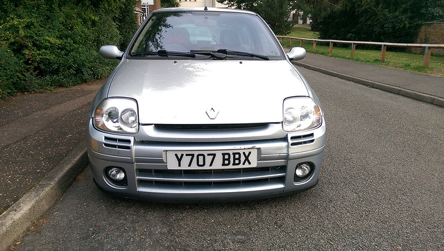

Looking great and shiny headlight looks nice
