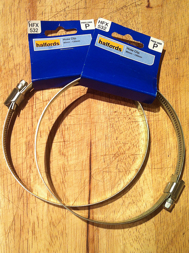

No buddy. I'm round AlexW's with a friend with a cup to get a few bits done. Plans for mine are to re-tap my exhaust mount and use a exhaust mount bolt I've got spare, fit polybush dogbone mount and use a jubilee clip for either side CV gaitor. I got these ones:
Jubilee clips for CV gaitor (90mm-120mm) by Dr-Jekyll, on Flickr
Also I've finally found that annoying rattle in the rear! It turned out to be the headrest stems rattling. When there extended they don't do it but once they are at the lowest setting they do. Me being me, I don't like the look of them unless they sit all the way down :o so I masking taped up the stems a tad and bingo, no more rattling!
I think I might buy a small lot of underlay now to fit behind the door panels to help with the vibration. Worth a shot.
Mark Re CV boot clips, they will be to long once done up.
I just trimmed mind down with a fine hacksaw blade, neater job. :)

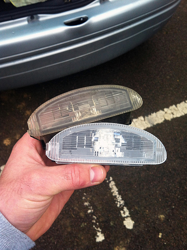

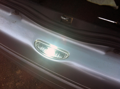

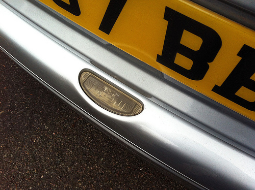

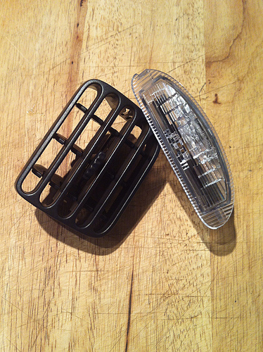

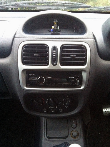

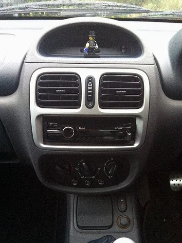

Got a few more things done this weekend. New air vent and number plate bulb holder arrived saturday so i got them fitted with the new LED too:
New air vent and rear number plate bulb holder by Dr-Jekyll, on Flickr
Ph1 rear number plate light cover by Dr-Jekyll, on Flickr
Rear number plate bulb holder - Old Vs New by Dr-Jekyll, on Flickr
Rear number plate bulb holder with LED fitted by Dr-Jekyll, on Flickr

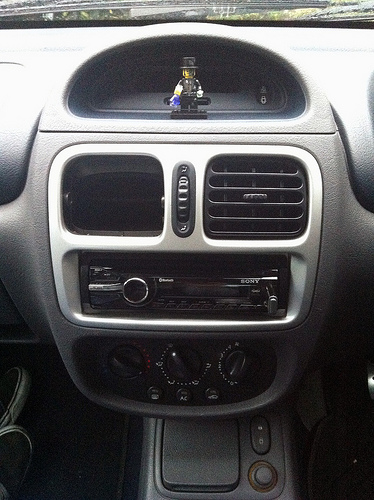

Center console without air vent by Dr-Jekyll, on Flickr
Center console with air vent by Dr-Jekyll, on Flickr

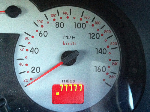

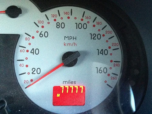

Also hit all the 7's:
All the 7's by Dr-Jekyll, on Flickr

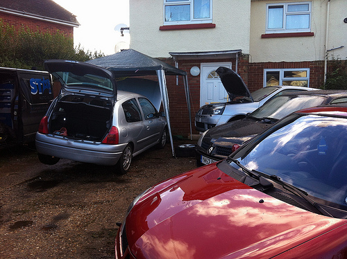

Today i shot down to @AlexW to get a couple of bits done:
AlexW's Auto's! by Dr-Jekyll, on Flickr

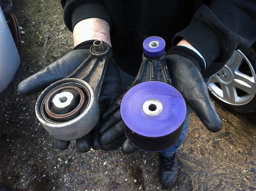

First job was to change the standard dogbone mount with my polybushed one.
Dogbone mount - Standard Vs Polybush by Dr-Jekyll, on Flickr

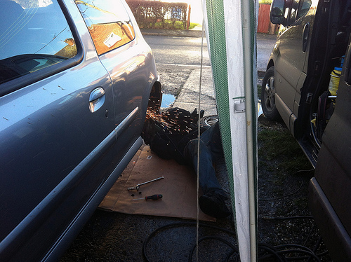

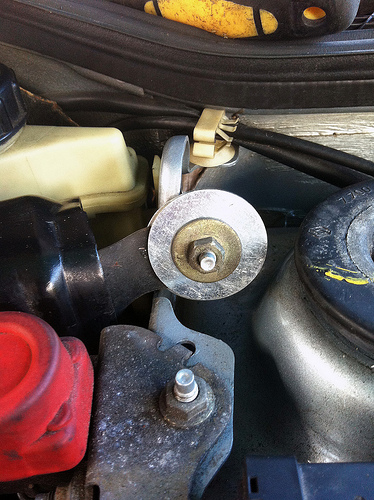

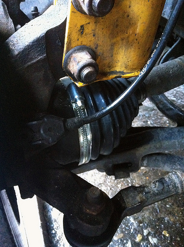

While Alex was busy fitting the polybush dogbone mount i used some gaffer tape to tape up the Ktec induction kit as we noticed that where it wasnt fitted properly it had been rubbing on the battery brace bar and had made a little incision. Once both those jobs were done Alex the moved to the rear of the car to remove the middle exhaust mount bolt as it wouldnt tighten up or loosen off and i took my old cable tie off my CV gaitor and fitted the jubilee clip. Alex also re-tapped the 3rd hole as i went in pissed before. All sorted now, thanks @Phase1sr for the tap :)
Grinding off rear exmount mount bolt by Dr-Jekyll, on Flickr
Re-tapping exhaust mount by Dr-Jekyll, on Flickr
CV gaitor jubilee clipped by Dr-Jekyll, on Flickr

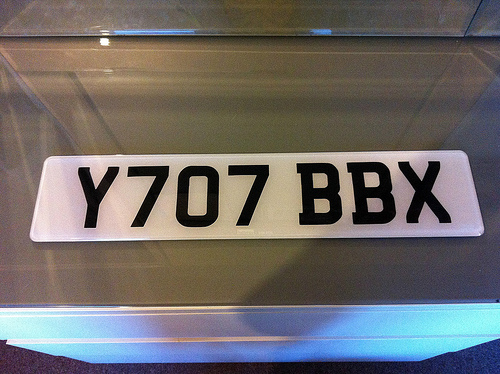

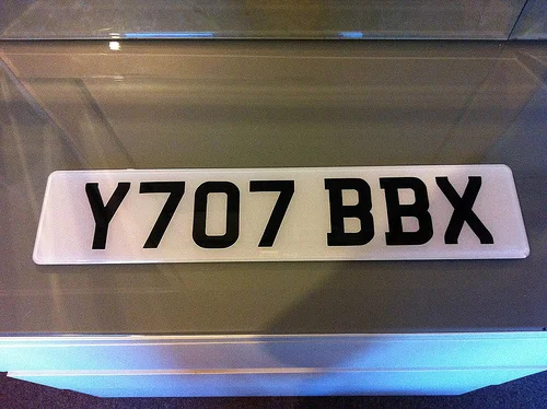

Also shot down to Halfords today to get a clean standard plate made.
Clean standard plate by Dr-Jekyll, on Flickr
I will fit this tomorrow and then I'm legally clean ;)

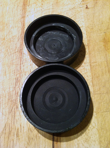

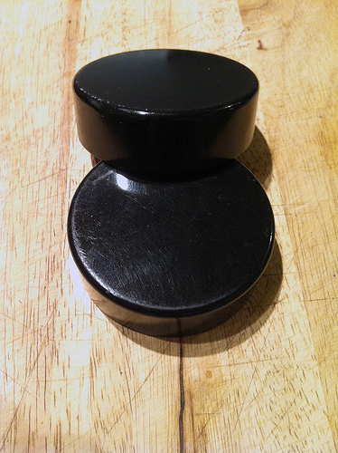

My girlfriend also bought me a new toolbox out of the blue because she's awesome and mine was knackered! So while i was removing all my tools from my old box to the new one i found these in there:
Top mount covers. by Dr-Jekyll, on Flickr
Top mount covers by Dr-Jekyll, on Flickr
Dan@MAD top mount covers! Well thats them off the wish list now! lol I'm going to get a can of Iceberg made up and colour code them :cool:
Wow cracking work mate, glad the exhaust mount is sorted. :)
Thanks Buddy. No more loose or wonky bolts now!
Less freaky pics of me this week! :D
I did have one of you tapping the mount but i had to crop it anyway loosing part of your gorgeousness!

Also im glad the poly dogbone mount has been fitted! Sooo much better than before. Virtually no movement on the gearbox on and off the throttle and no noticeable vibrations either. Definitely a mod that is recommended and im glad i listened to you lot!
Nice work mate, how did that vent go in?? Easy?
It just pops in Rob. I broke it getting it out so i was concerned about putting it in as i didnt want to snap anything as there £24 and i waited a month for it! I did post up a thread but got impatient and had a go and it was so easy i shouldnt of needed the thread (Hence why i removed it :o)
