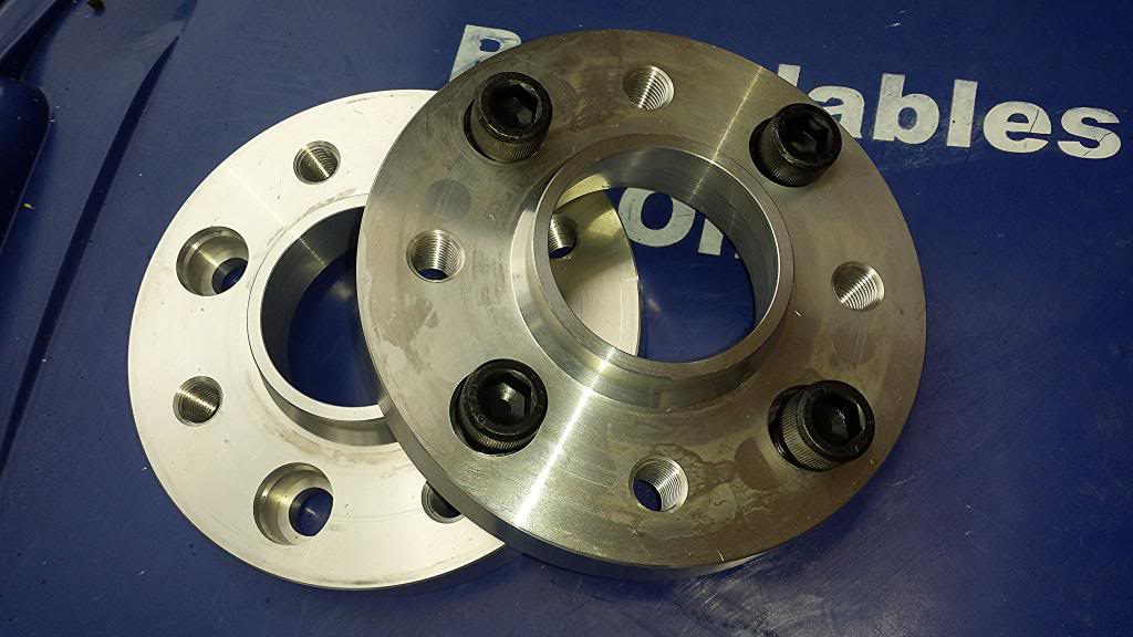

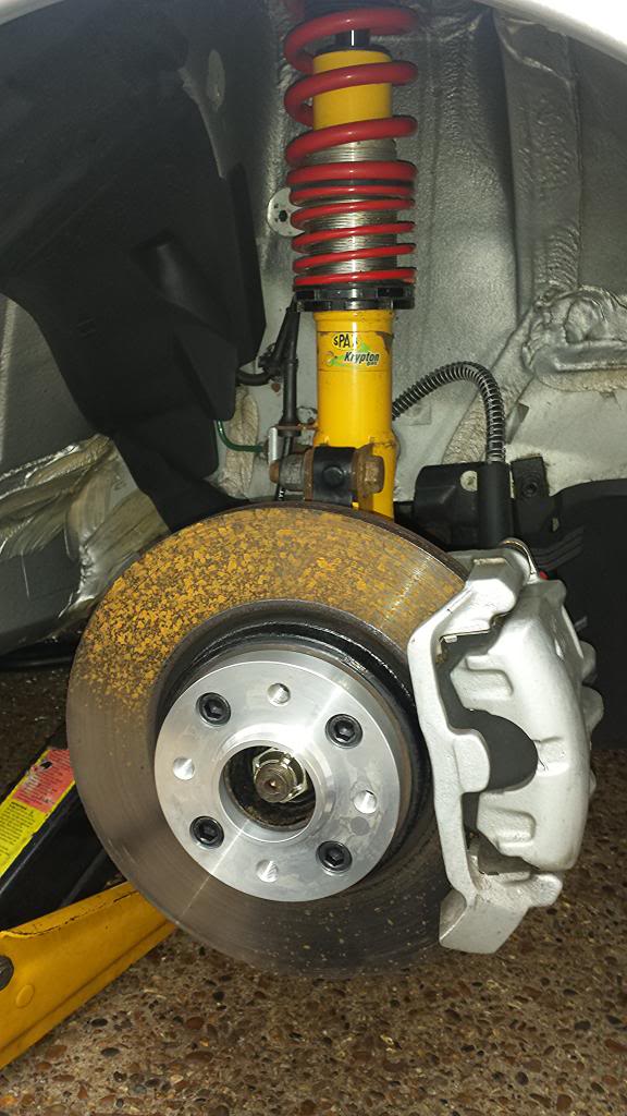

Front 20mm spacers from M.A.D

Oh i just remembered mark, i had to take about 2mm off of the end of my wheel bolts.
I did this at work on the lathe, but a file should do the trick

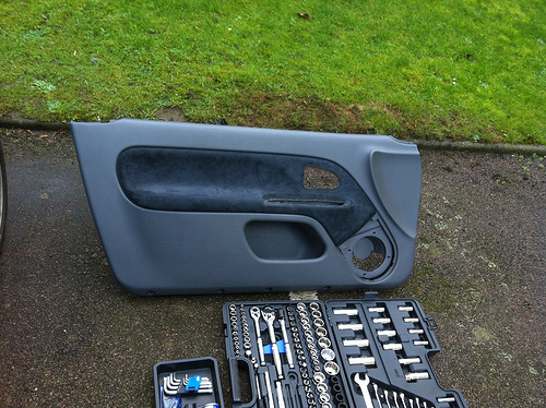

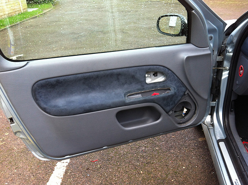

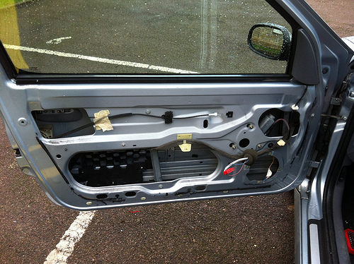

Did another couple of litte jobs today once the whether brightened up. Decided to remove the door cards and fit my standard ph1 door handles and remove the colour coded ph2 ones.
Handles and speaker removed by Dr-Jekyll, on Flickr
Door panel off by Dr-Jekyll, on Flickr
Bare door by Dr-Jekyll, on Flickr

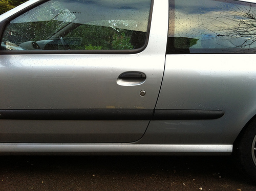

Ph1 door handles fitted by Dr-Jekyll, on Flickr
The car is filthy and you can see the door dent next to the handle. It also has some paint imperfection so it'll be eventually sprayed but not yet so I may get my dent guy round.

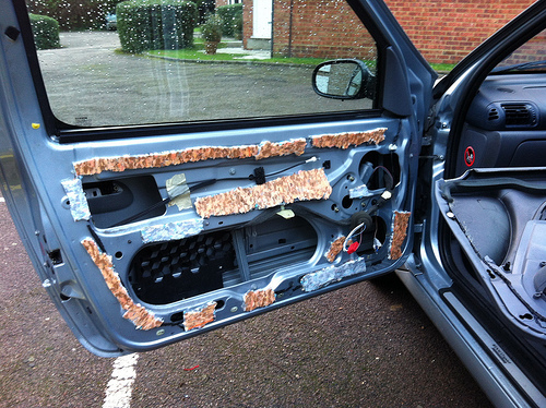

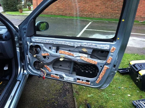

Then while the panels were off I decided to underlay my door panels to help the vibration. I had some strong doulble side sticky tape but due to losing the light and it being cold I only quickly did it as you can see :eek: Tbh I'm not sure it'll do anything but it was worth a shot for £8.
Underlayed drivers door by Dr-Jekyll, on Flickr
Underlayed passenger door by Dr-Jekyll, on Flickr

Yes mate some of the bolts felt a bit funny when doing them up.
I took them out to find that some had hit the end of the bolt so was not doing up 100% tight.
All sorted now though.

The FK spacers I got from dmallett have taken an amazing amount of abuse on my car, never even had to re-torque, although I have the wheels off so often I wouldn't notice. When we borrowed one of the spacers for Marks was the first time I've removed one of them since fitting lol.
Have you driven it since fitting the underlay? Notice any differance? Or doors had a better feel/noise when shutting?

I only did the underlay this afternoon mate so I can't comment yet, but I have sh*t loads left!

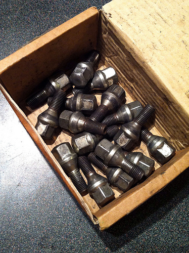

Went up into the loft and managed to find a spare set of bolts. I will grind the tips off these for the spacers.
Spare wheel bolts by Dr-Jekyll, on Flickr

Mark, when you fit the rear spacers if you are going to use the stainless bolts and nuts provided then make sure that you put copper slip grease on the threads.
Stainless steel on stainless steel tends to bind up so it will feel as if the bolts are tight but it won't be 100%.
Also hold the bolt still and do the nuts up. :)
