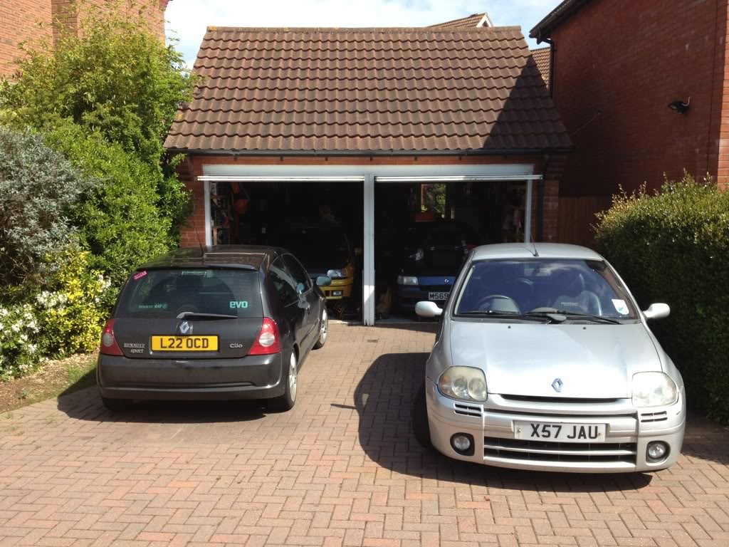

Do you mean the phase 2 I had at llandow and took you out in, or do you mean my silver phase 1 which Im guessing you dont mean as you probably dont even know I own one, lol, or do you mean one of my mk1s?
So basically, which do you mean in this picture, black, blue, yellow, silver:
  182/RS2/ Turbo/Mk1
now thats a garage I would like to own!
Me too, but sadly thats actaully my parents place, the house I own myself only has a single garage :( I store the mk1s at my parents though and as they were away on holiday we got the mk2s on the drive as well as me and the mrs had the week off to do a load of work on all of them so it made sense just having them all in one place.
