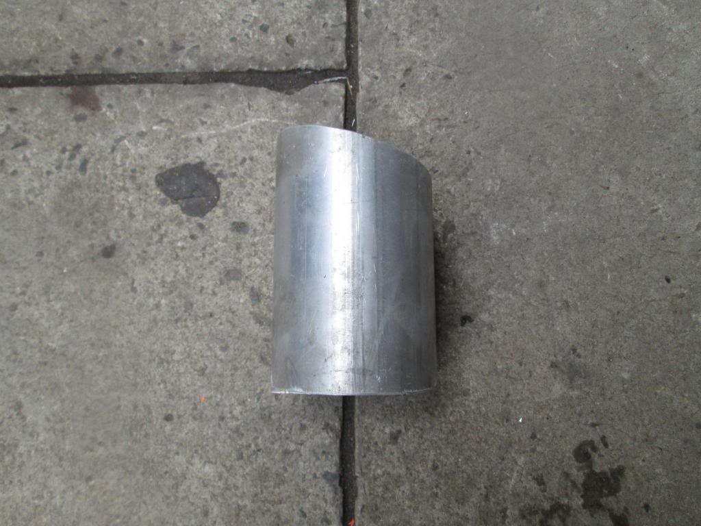

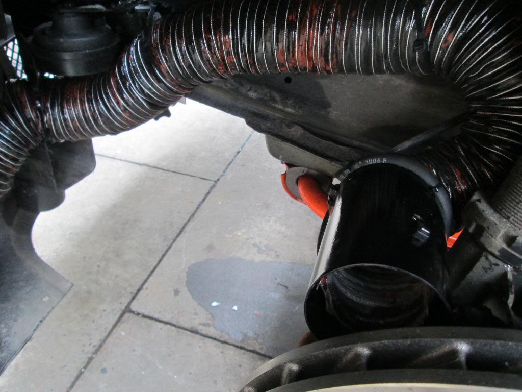

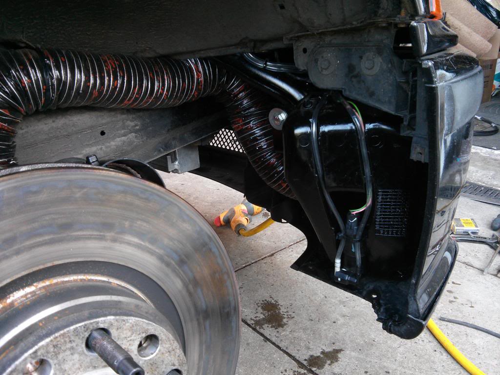

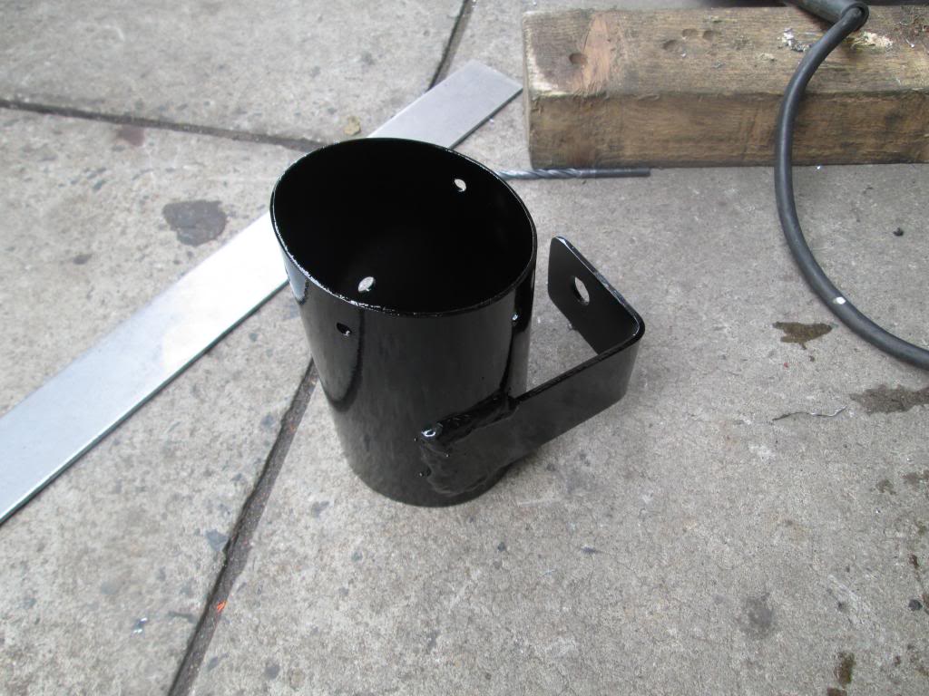

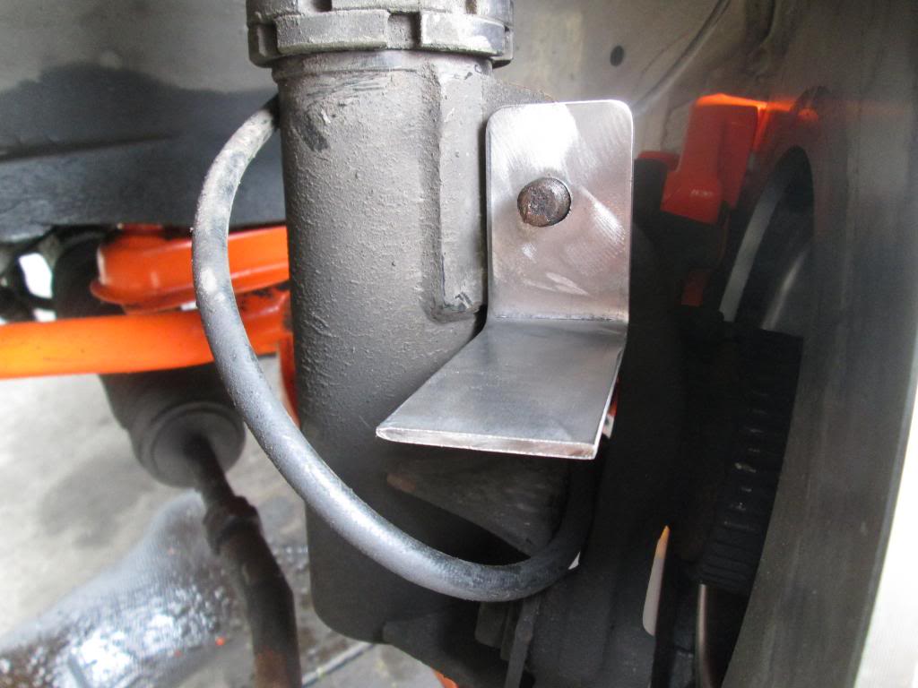

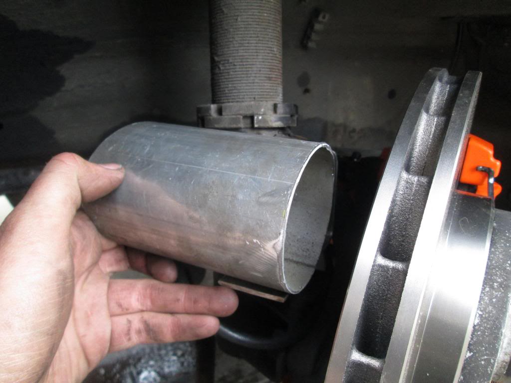

So going back to the reason for the ducts in the fog lights - I wanted to run some ducting to the brakes. I managed to get hold of some proper 2 ply silicone ducting at £4/m as its been splashed with red paint, much better than the usual £10+/m they charge for it!
To properly direct the airflow at the disc, rather than just having the pipe hanging about, I set about making a pair of brackets from others I had seen on the internet. The ducting is 65mm, as are the outlets on the fog light inserts. Started with some 3" exhaust pipe I had lying about..

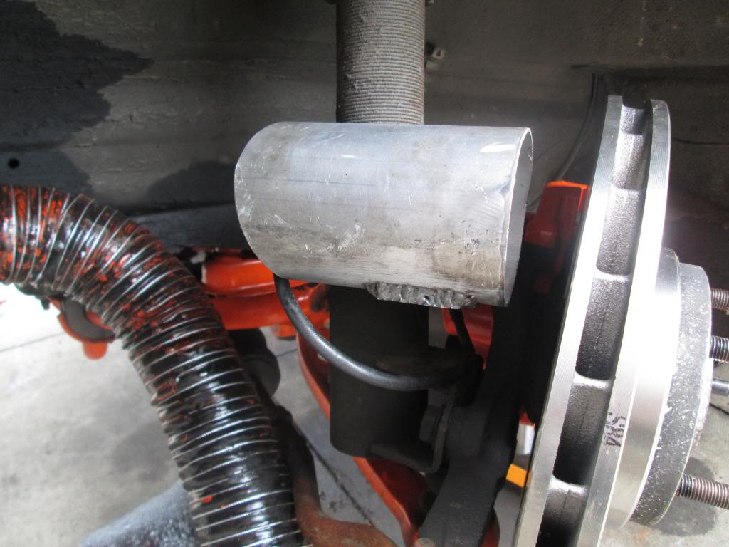

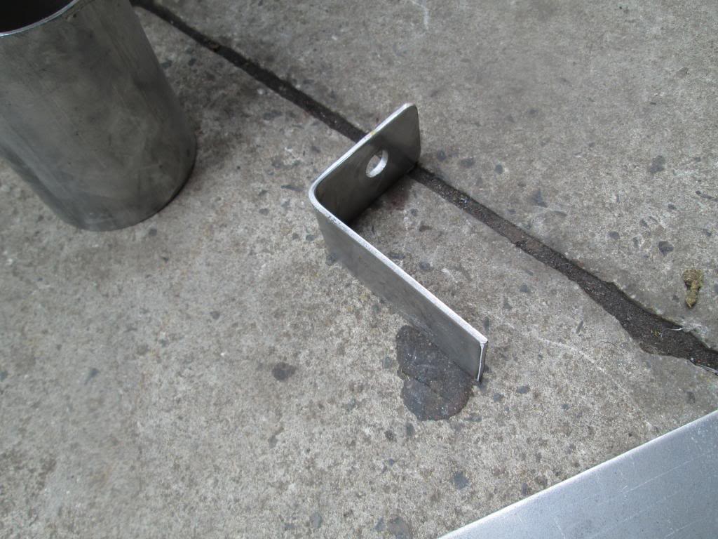

Then a bit of 3mm flat bar, which was bent to 90 degrees and drilled..

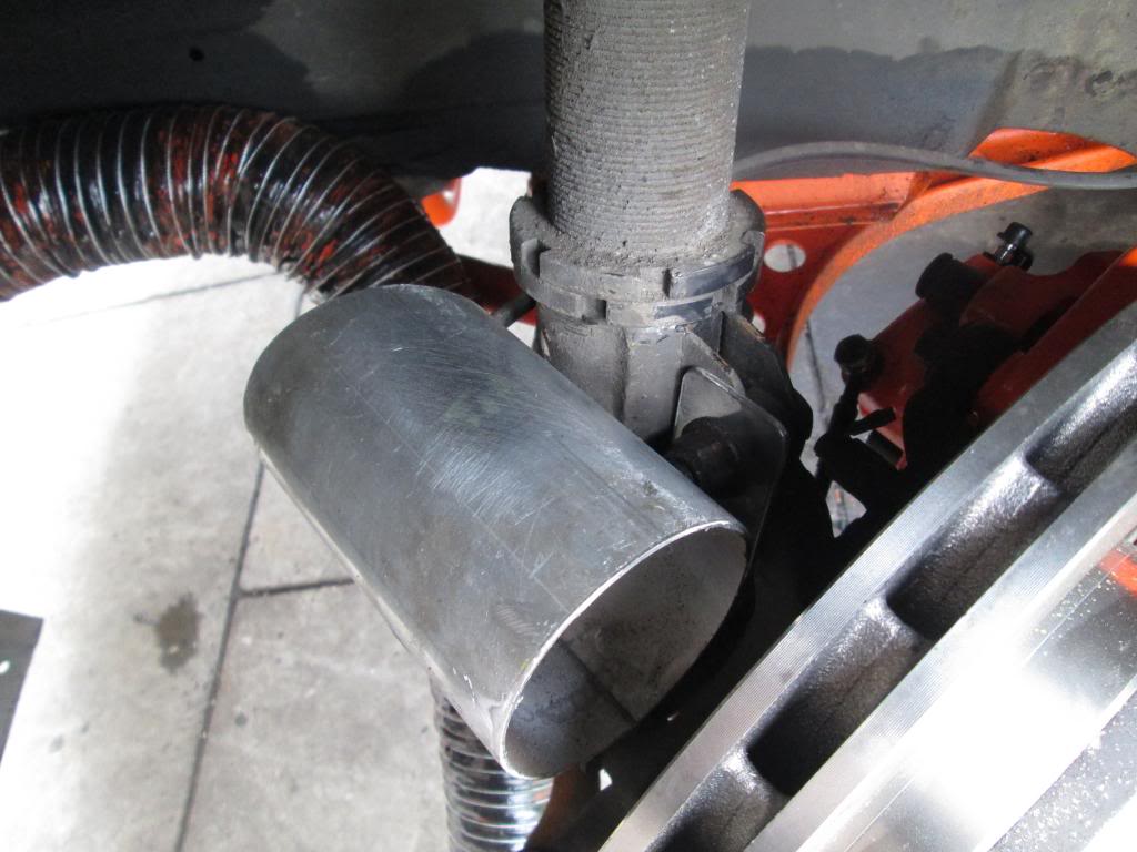

This fits well over the upper shock bolt thread like so..

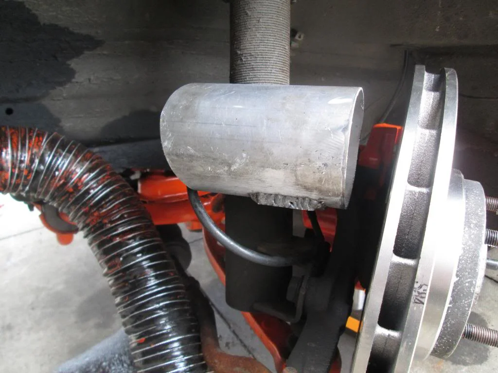

This allows the pipe to point directly at the disc..
These were then welded together and the fit was tested..

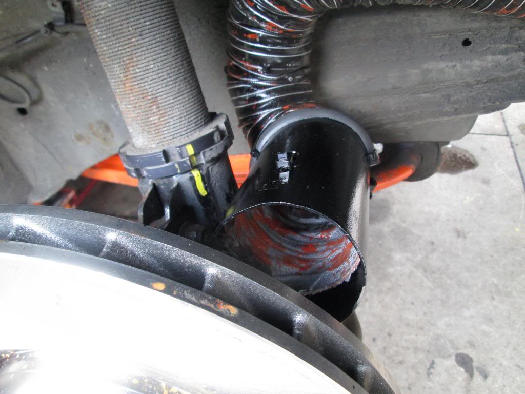

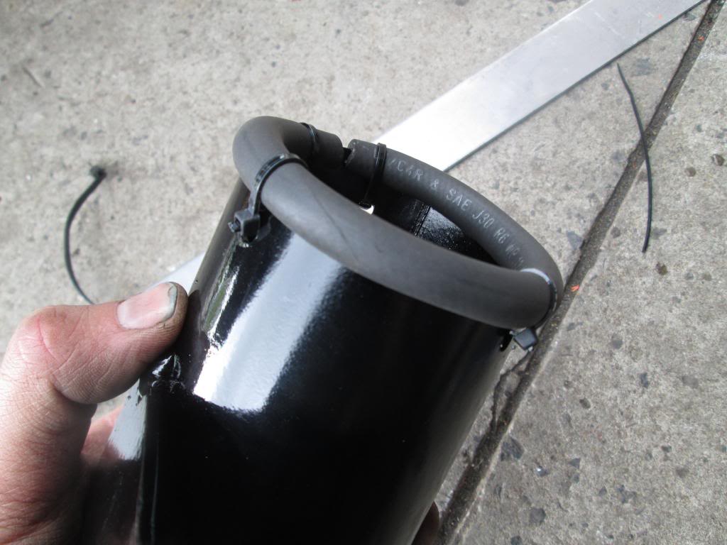

The reason for the angle on the 3" pipe at the end is to aid in the direction of the ducting. Once I had done both, they were cleaned up and painted..
I split some small fuel hose down the middle and attached it round the end where the ducting will enter, so the edges of the pipe do not cut into the ducting over time..

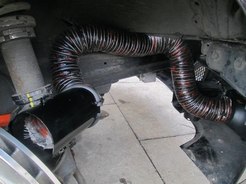

Bolted up the ducting enters, and is attached through some holes I drilled on the pipe so it cant slide any further in towards the disc..

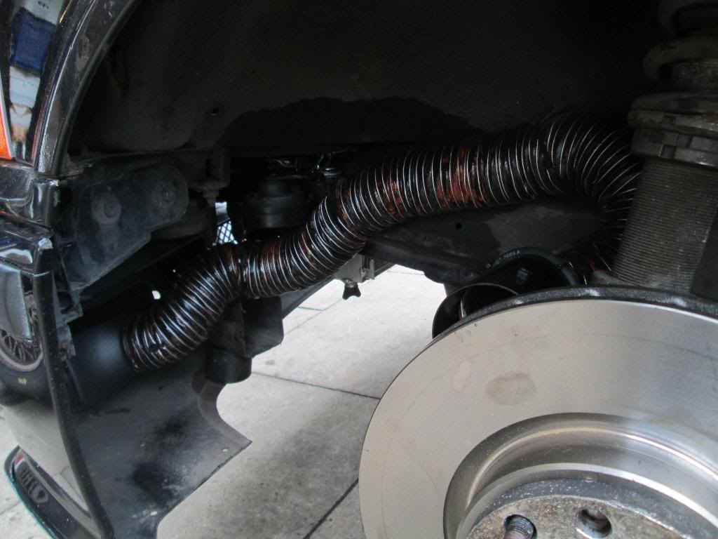

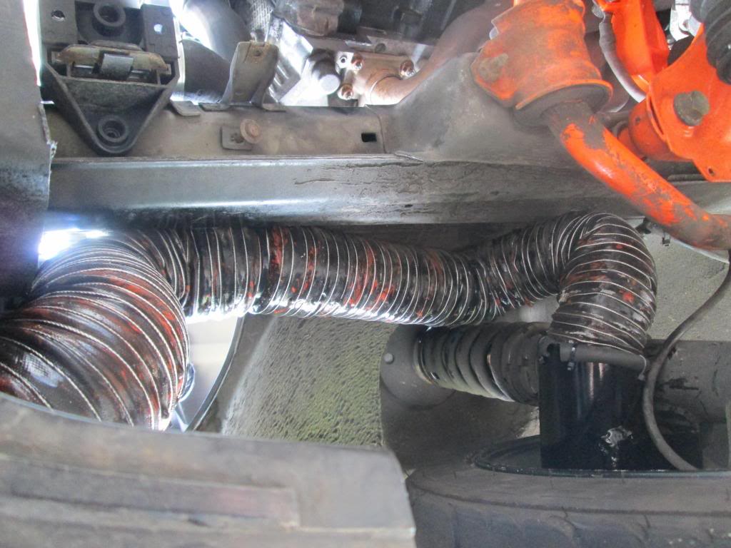

Routing of the pipe with plenty excess bunched up to allow for movement... took advantage of the now unused brake like bracket in the arch for this..

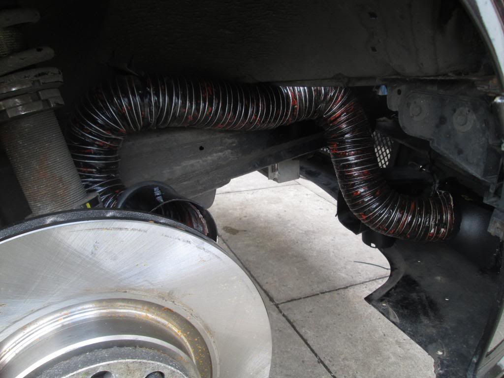

Full lock, and a view from underneath..
Passenger side done also, ducting routes slightly differently due to the horn but still fits well..
Obviously I checked there was enough clearance when on full lock between the wheel and ducting, quite a lot of space there with these low offset wheels/15mm spacers. Worked out well for a cheap mod using bits I already had lying round and will be more functional than some old foglights!

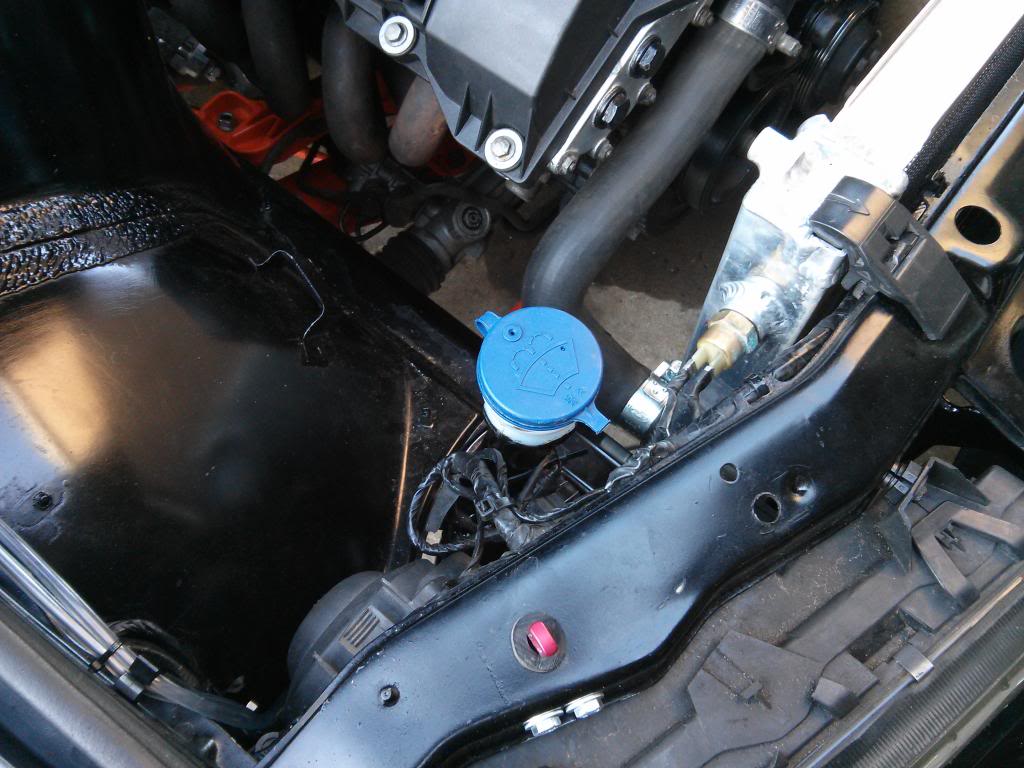

Much prefer making things than buying off the shelf parts where possible. Just a bit sh*t doing it on the driveway, but make the best of what you've got I guess.
After removing the scabby/old washer bottle from the engine bay when swapping the engine, I wanted a smaller alternative that was out of the way. After a wander round the scrapyard I found one from a Citroen C2 that looked about the right size.
I didn't get any pictures of the brackets I made but it mounts from the front bumper support, and sits in the front arch. They have a really long neck on them on the C2, which I cut a section out of and stuck it back together in the right position. Painted it black to stop the white tank sticking out like a sore thumb. Wired up the C2 pump to the BMW wiring and replaced the hose to the jets. Much tidier.

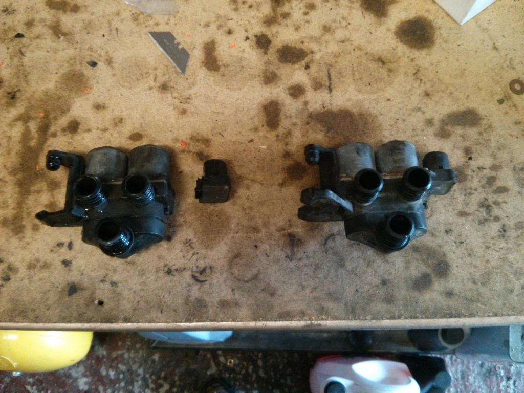

When swapping the engine, I knocked the heater control valve on the bulkhead and it's electrical connector snapped off. Managed to get a replacement from a breaker and swapped that over. Drained the water out that was in from running the engine in, and filled with proper coolant/bled through. All good.
Just and oil/filter change to do now, then its good to go.

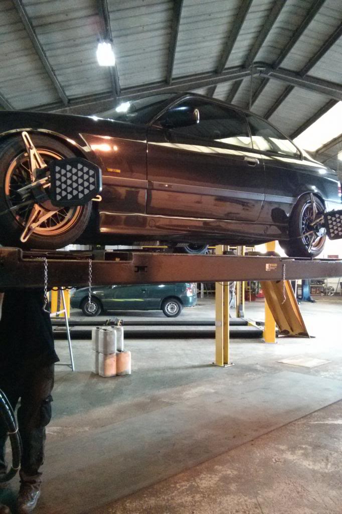

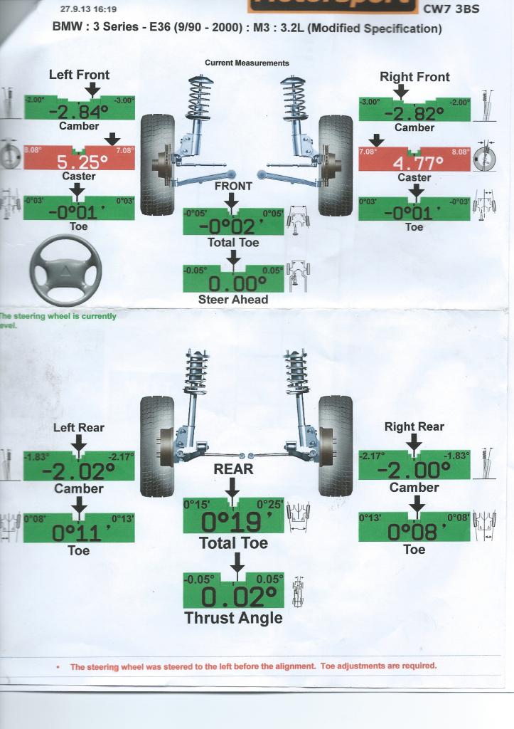

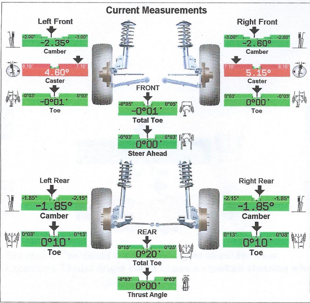

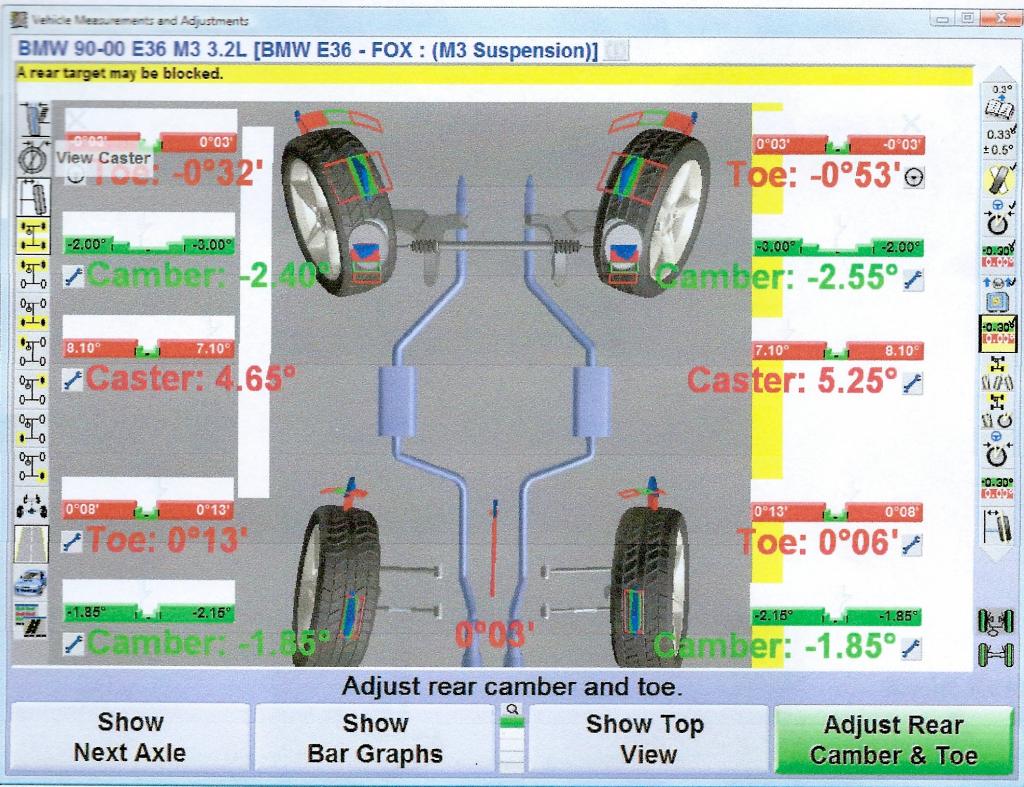

With a few trips coming up, including a day at Oulton, I wanted to get the alignment checked again, especially to check the front as the wishbones/balljoints have been changed since then. It was previously done at Blink Motorsport, who were recommended at the time. I tried to get another appointment but had no joy over the space of a month, no answer on the phones and no replies to e-mails, where previously I got very quick responses. Anyway, I decided to go elsewhere - a place in Liverpool with a Hunter system who just specialise in alignment, nothing else.
To recap, when I previously went to Blink, the completed printout gave the following:
Front Toe: 0
Front Camber L + R: -3.0deg
Rear Toe: 20min Total Toe In
Rear Camber L + R: -2.0deg
Which were the settings I provided and wanted at the time. This was September 2013. Drove straight as far as I could tell..
Now I knew the front toe would be out, as the whole front subframe, wishbones and balljoints have been swapped. The rear end has not been touched with a spanner since then, every thing is 'as it was', and at the time everything was brand new. Needless to say when we got the initial readout today I was quite disappointed..
Front camber is different L/R, and the wrong value. Top mounts have never been touched since it was originally set up. Rear camber is the wrong value on the rear also, but equal. Apparently a common mistake if the Hunter kit isn't calibrated properly... Front toe is out as mentioned above, but rear toe is p*ssed across the axle, even though its total is near enough correct (20min total). Caster can be ignored as its not adjustable.
Anyway, for now I just wanted the toe correct, so its not chewing through tyres. Did not want to go messing about with the camber (as its not a simple job on the fronts, takes time with fiddling). We got there in the end (Front camber is actually equal but we didn't do a final printout once the car had rolled off and back on)..
Eventually I will go back and add more camber, as now I know the true value its not really enough, probably 2.75F and 2.25R, but we'll see. It now drives how it should, much better than before (which I thought was OK anyway), and I'm questioning whether it was ever 'right' when I had it done at Blink. Looks like they got it 'near' then accepted that IMO.

Saw this on Facebook. The printout is all over the place. Luckily Drury Lane Garage is 6mins from here and does hunter alignment and they seem to get good reviews if I ever needed a decent setup doing.
At least it's sorted now anyway.
Front Toe: 0
I don't really understand how hard it can be to find somewhere that you can trust to get it perfect for the money these places charge, first time round? I've heard quite a few reports of various places in the NW doing poor jobs of late also!

Anyway, in respect to the alignment I would like to clarify a few points to help other people understand the Hunter machine and how we carry out an alignment.
Jordan states heasked us to put the following settings onto the car:
Front Toe: 0
and this is the printout from that alignment session:
The Hunter system that we have is the top of the range Hunter Elite imaging aligner - the settings can not be altered by the user in any way; what is shown on that printout is what was on the car when it left us. (Assuming the aligner is callibrated correctly).
How we carry out the alignment:
(1) EVERY car that we align we ask what the normal load will be during use - we ALWAYS add weight for the driver and have weightlifting weights for this but Jordan specifically stated he usually carries a passenger as well on his trackdays so this was also added. Weighting a car for use is critical for accurant alignment otherwise you will not get the correct settings on the vehicle - it would be like corner weighting without the driver. (Yes the wheels would definitely have been removed but a Known weight added)
(2) An initial check would have been carried out giving us all the angles currently on the vehicle and includes a run-out compensation for the wheels
(3) The angles are adjusted to spec.
To get an alignment as accurate as the printout we provided above takes some considerable time so it certainly wasn't a rushed job - anyone who has watched the alignment being carried out knows how sensitive the aligner is! (We allow all customers to watch the alignment so they can see the work involved and everything that is happening)
After 8 months of track use Jordan has complained that the settings moved to this:
I think we have now agreed that the front suspension is irrelevant since all the components (Subframe/wishbones/ball joints) have been swapped with different components.
Rear Axle:
(1) the rear toe has actually only changed by 2 minutes in the same direction. 2 Minutes is actually an incredibly small amount and would not be far off the width of a human hair! (anyone who has a vernier put it to 0.3mm and see how small an amount that is, and this is at a wheel rim) The fact that it has moved in the same direction would indicate something has slipped ever so slightly; we would expect this on a trackday car after eight months of use (In fact we are quite surprised it has only moved by such a small amount). The fact that all the components were as new and powder coated, usually means they may move considerably. (further to this there has been a wheel bearing change).
(2) Regarding the Rear camber, I know Jordan has said it is 0.25 degrees on a couple of occasions from what he asked from us but the reading shows only a difference 0f 0.15 degrees, which again is a small amount. We still are adamant that weight was added to the car and this is why there is this difference. Even a different level of fuel in the tank would get close to this difference.
We are truly sorry you feel the way you do Jordan - you have brought us a lot of business and we are very grateful for it - we certainly are not in the lucky position where we can turn work away and it is a great shame you feel the communications/service faultered on these occasions. We take great care in our alignments and try our very best to resolve issues as some members here have hopefully experienced. The Hunter machine is exceptionally good but we know it is not fallible. We have it calibrated twice as often as recommended so it is kept in as good a working condition as possible.
I hope this helps explains and we apologise if any of my posts offended anyone.
Front Toe: 0
Sorry but you added no weight whatsoever, as I mentioned in the past few posts. I was there stood next to the car for the whole process. I even helped with adjusting the front camber! I had not long removed my spare wheels from the car before the alignment as you were fitting tyres to them for me, and no weight of any kind was added. Please don't try and tell me there was, because it just never happened. You may do for other people, or since then, but you certainly didn't on mine.
Rear Axle:
