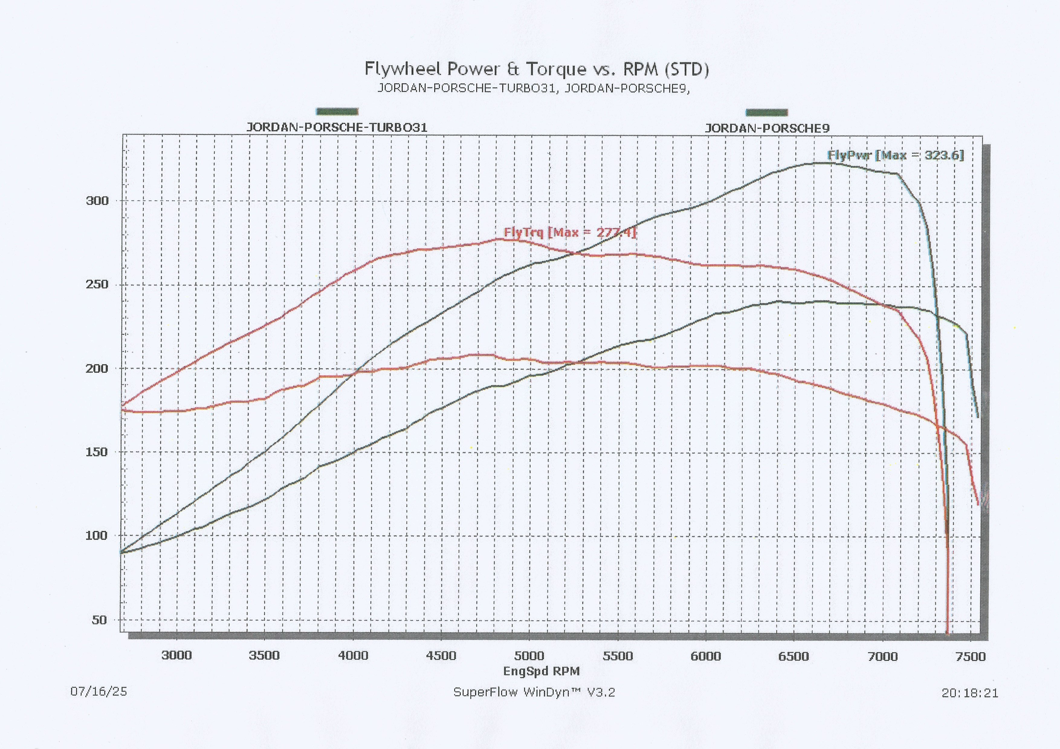

325bhp at 4psi and 385bhp at 7psi it made.
Stock it did 242hp, esentially the book figure for the engine.
Then as above, here is stock vs 4psi, albeit with 50C, intake air temperature.

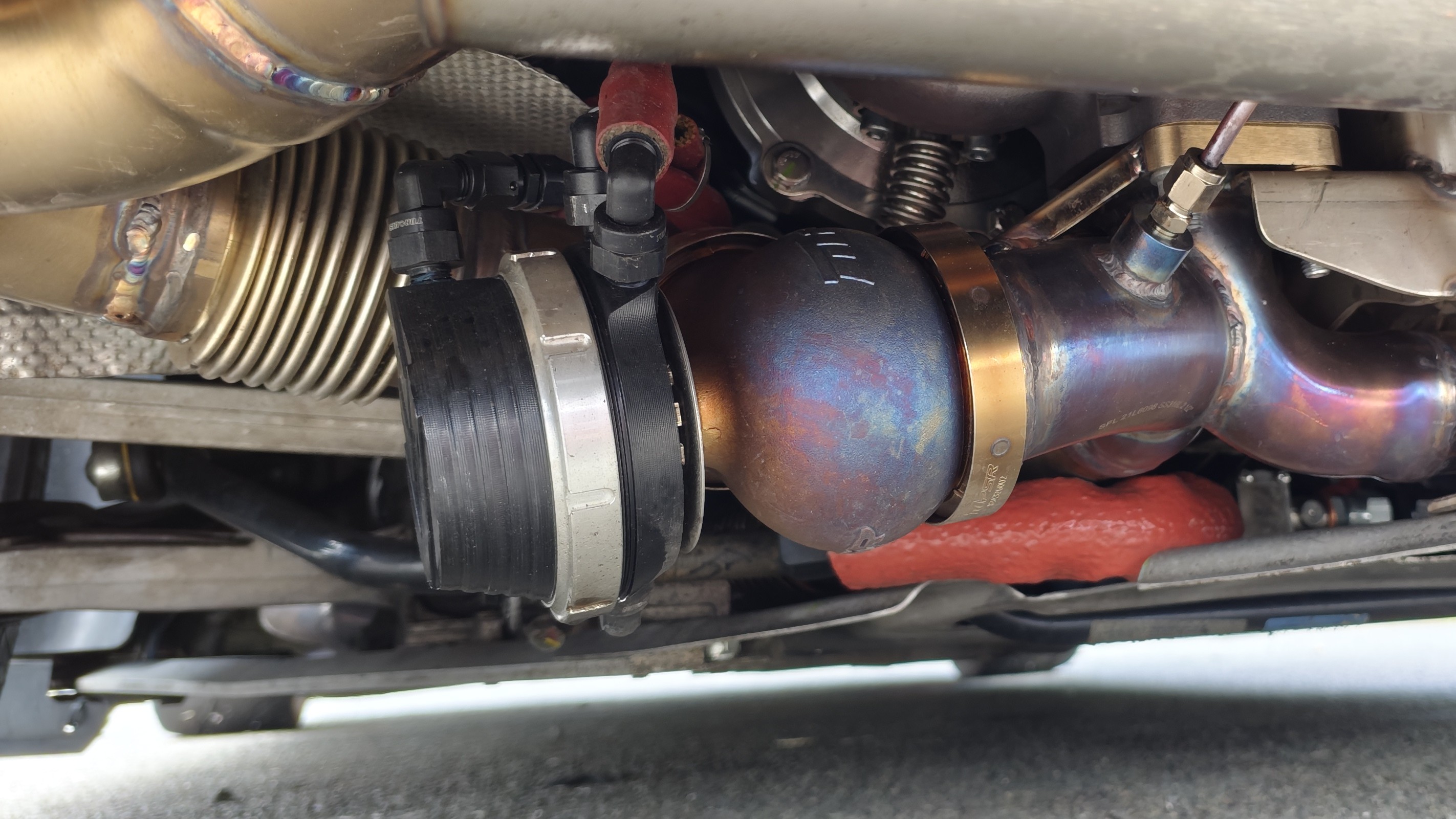

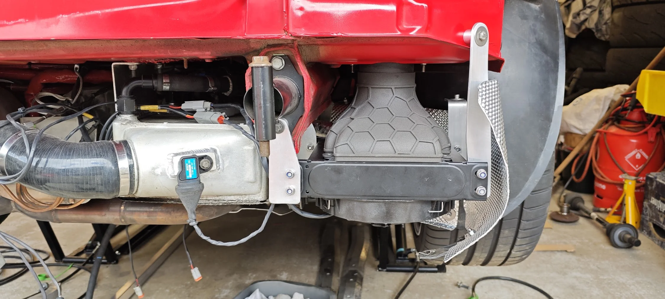

Since spent the past two weeks putting together a big cooling system for the charge cooler, with two more radiators up front, bigger water capacity, high flow pump to get some more realistic temperatures.

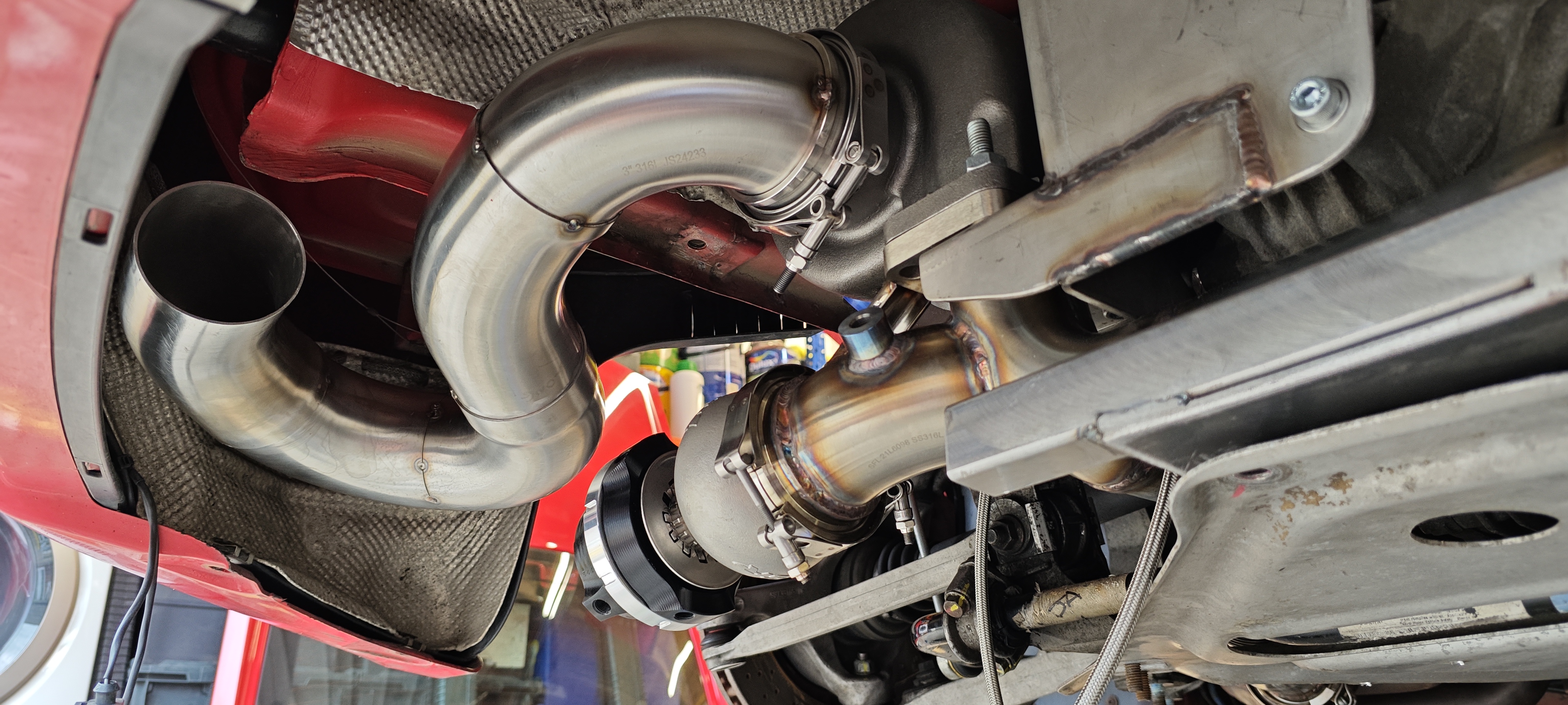

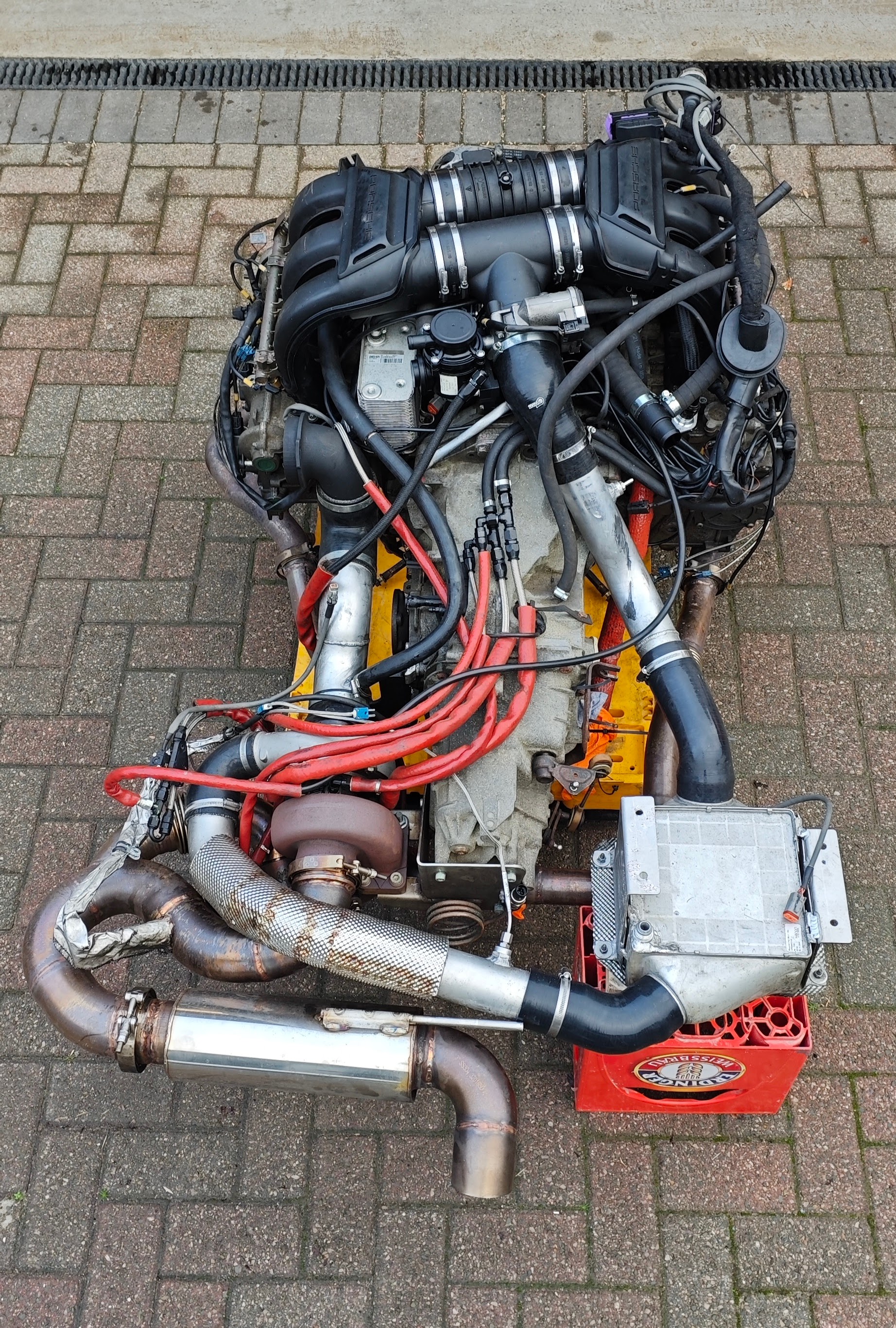

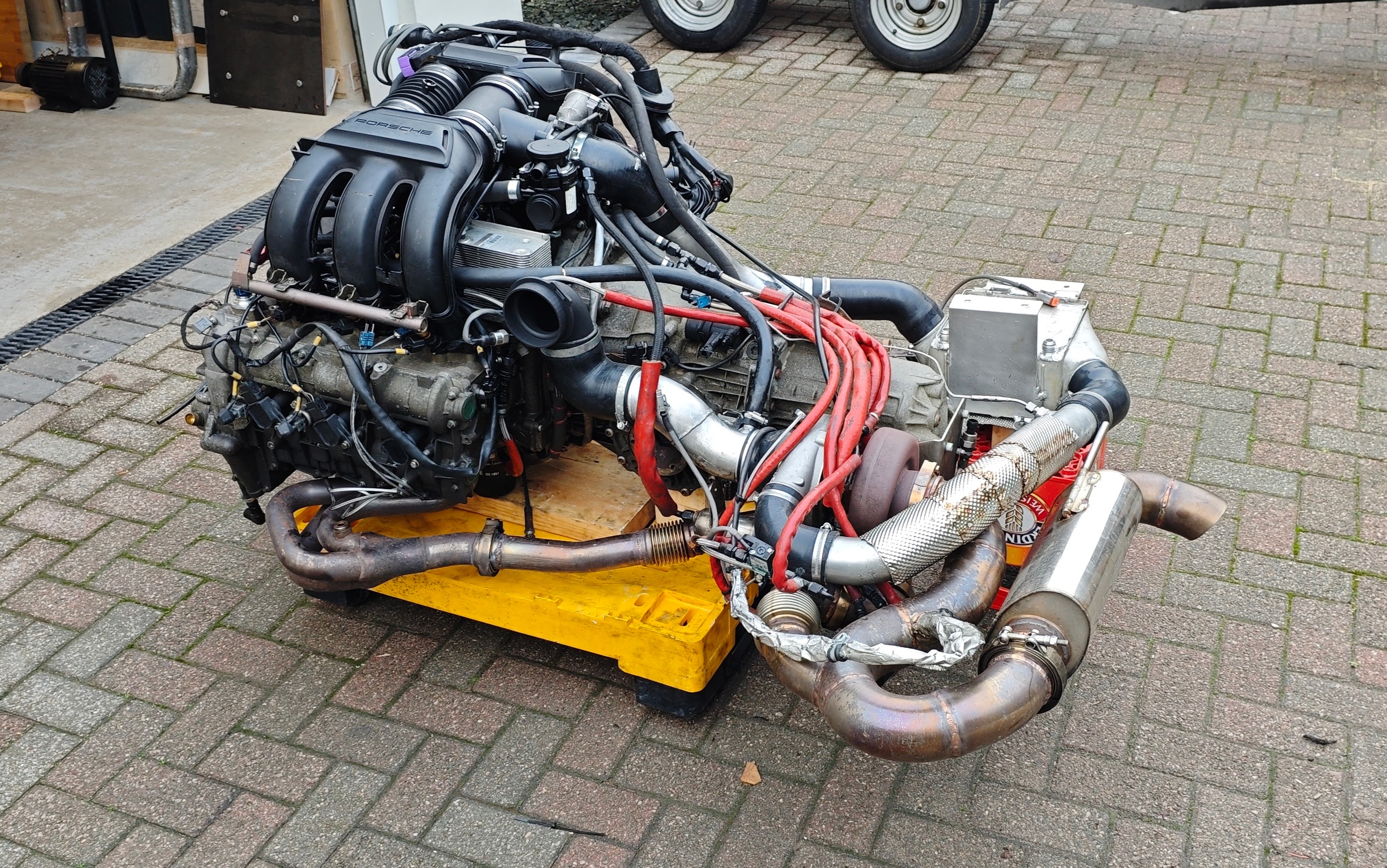

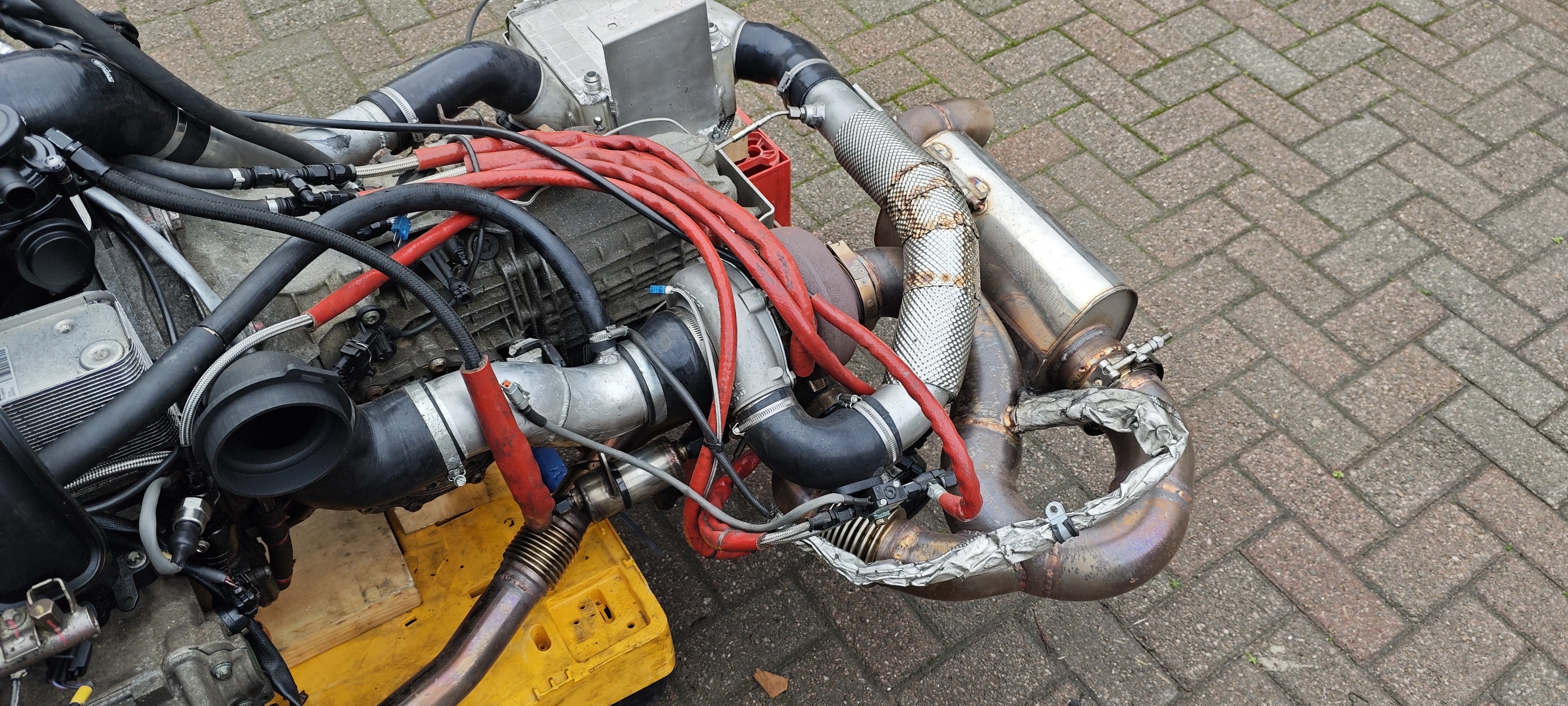

Handy it can all be dropped out as a complete setup, few niggles resolved and going back together for 2026 💨

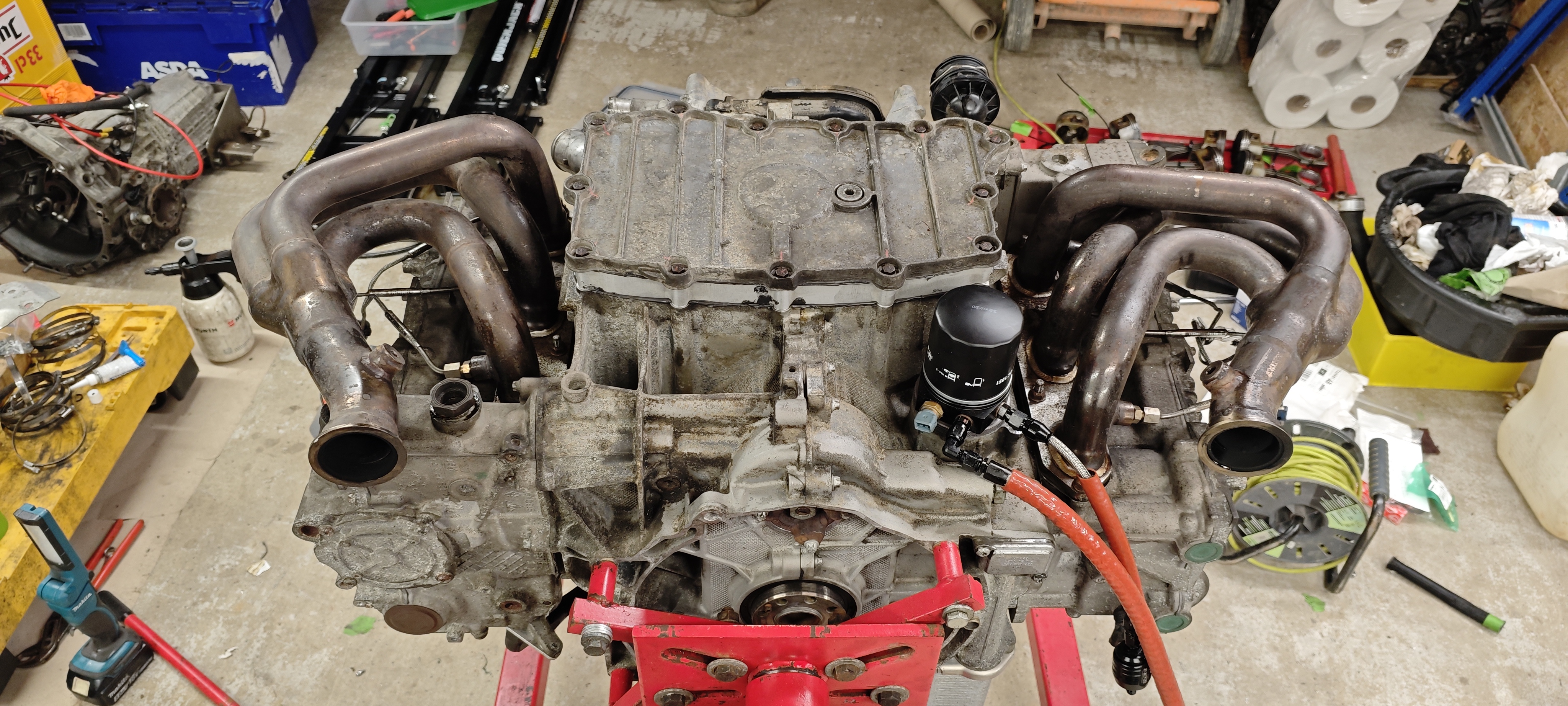

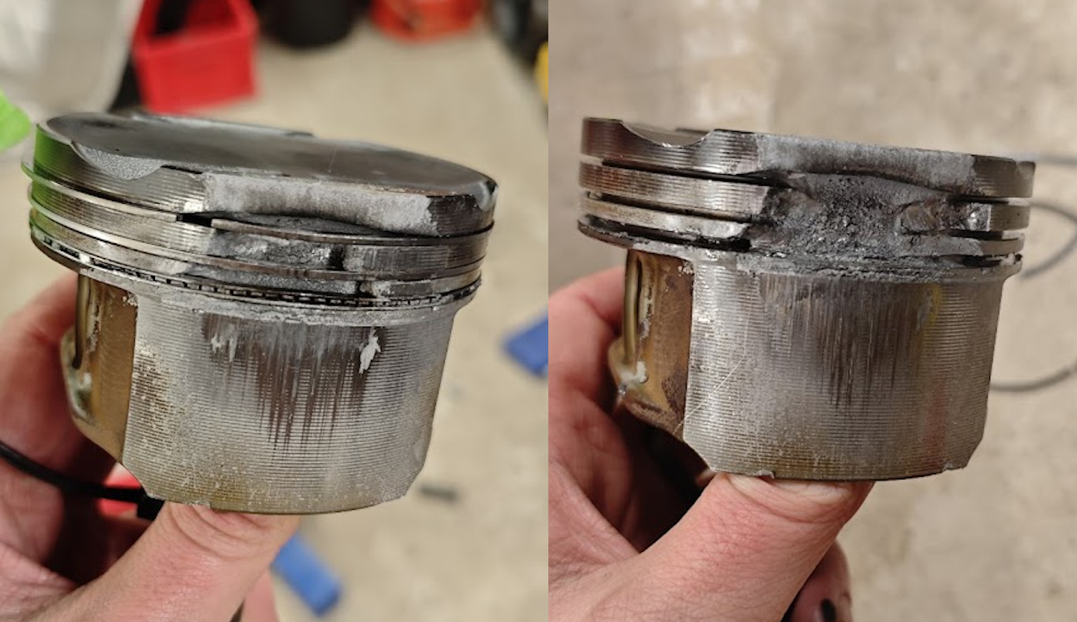

Ouch, worked out why yet?
Well DET killed it, due to oil ingestion, but also an issue with knock control (which would have prevented it). It's a long story and probably easier to explain at Cadwell in July if you're interested!

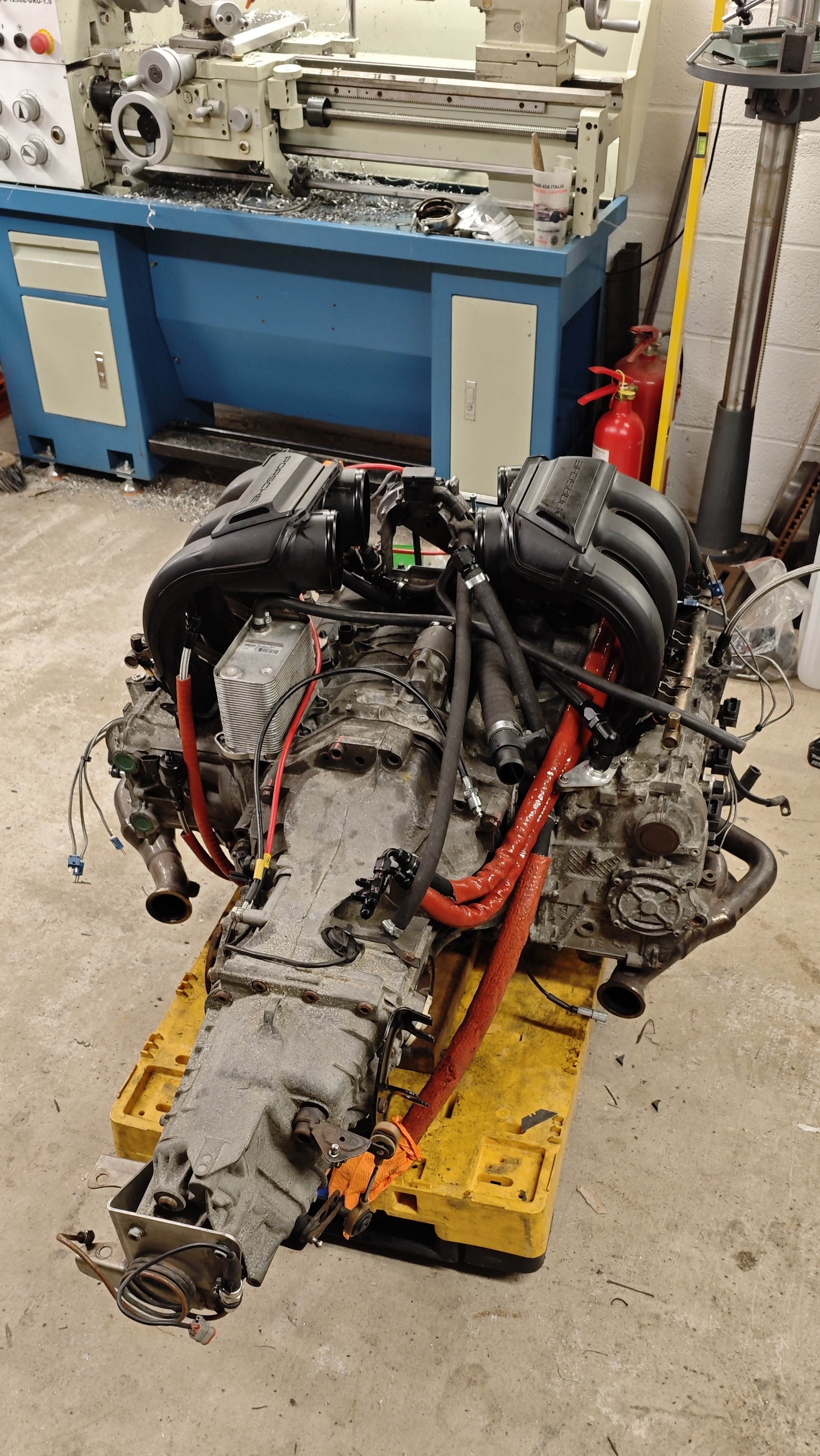

Spare engine is built up and ready to go in this weekend 👌

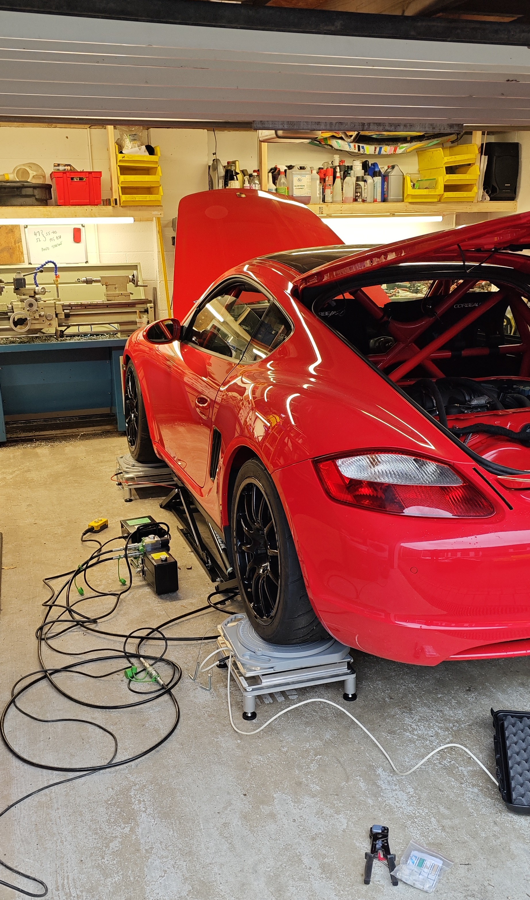

Before Oulton, I got it on the scales post-turbo to compare the weight to pre-turbo - only added circa 25kg overall.

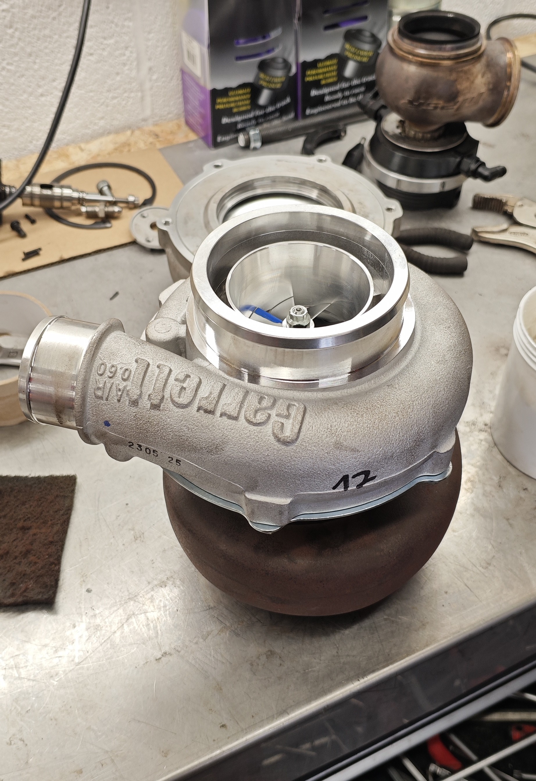

It's a good level on both base (wastegate) and 7-8psi, I've added flex fuel over winter so I can run a blended fuel, but ran out of time to get back to the dyno to tune that before the above. My plan this year was to concentrate on the set up more, as it had been good for 6 days in the back half of 2025 with the turbo.

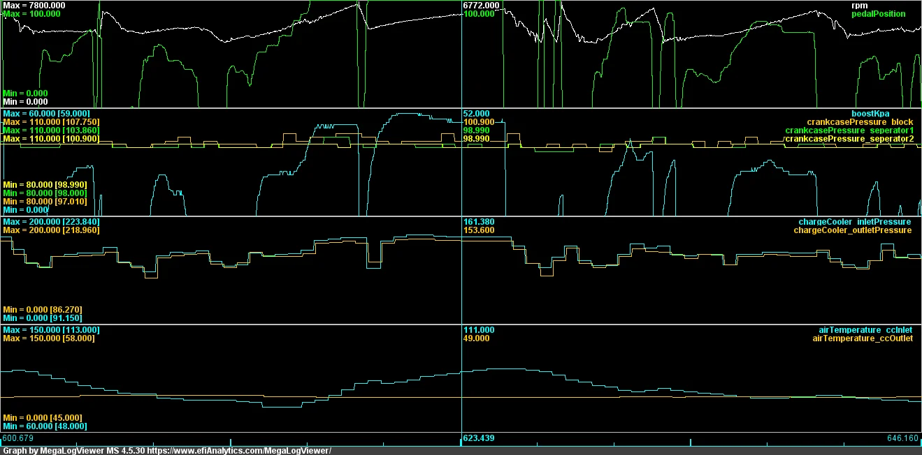

At Oulton it happend mid afternoon, now I know, the damage was done earlier in the day - I was already bleeding boost into the crankcase (via a cracked piston) on an out lap, this then rose rapidly and blew the cam seal out when the piston finally gave way on cylinder 6

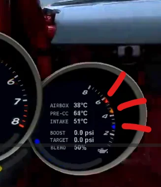

What are the red orange and blue markers showing re oil pressure?

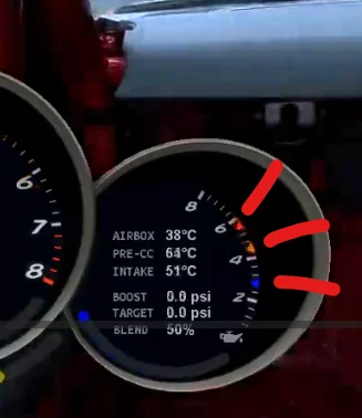

Hindsight I should have never used a 3 port solenoid, as on E50 I couldnt keep the gate shut on 100% duty cycle. Reason being I want to keep my lowest setting at ~3psi flat, which is the gate spring (300hp on 99RON, 330hp on E50) as its a good level for low. I've now swapped to a 4 port solenoid now and just going to have an hour next week to set up the duty cycle tables from scratch on petrol and max blend.
Red = Oil pump outlet
Orange = Cylinder head (furtherst point)
Blue = Turbo oil feed inlet (It's regulated at 2.7bar with a TurboSmart OPR)
