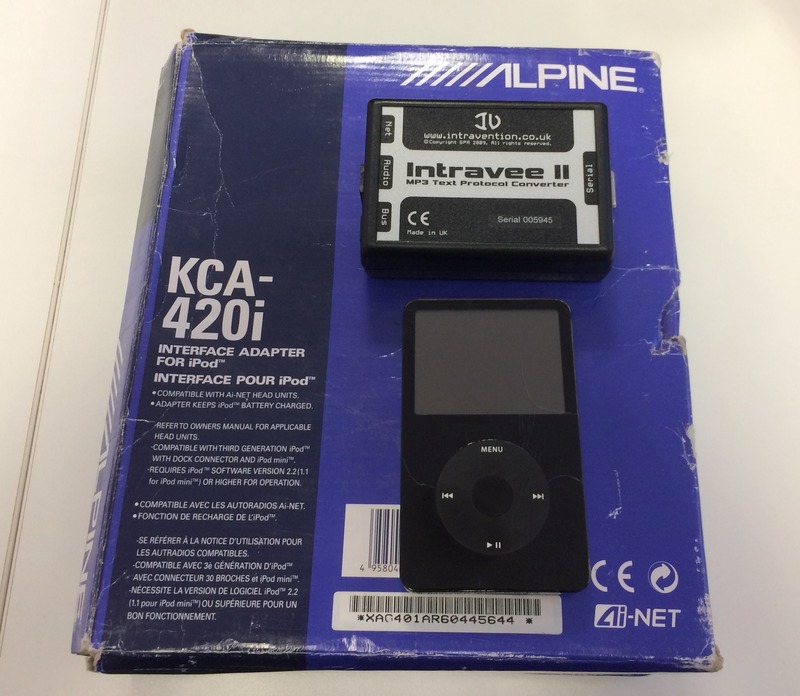

2. Intravee ll, Alpine KCA-420i, 5V adapter, velcro pads & a rear storage tray - so that i can listen to my iPod, & have access to some funky features like setting my auto-fold mirrors, PDC display on nav screen, auto-locking on driveaway, "sticky" indicators, etc etc.
Was going to upgrade my BM54, but the bluetooth music option isn't flawless, & i didn't really fancy pulling the interior apart to route an aux lead to the front of the car - things always seem to rattle more after coming apart!! Me being me, the Intravee setup also seems to retain 90% of its value 2nd hand, whereas the BM54 upgrade would have been £200 that id never get back. No doubt it'll now break & need fixing anyways 😂

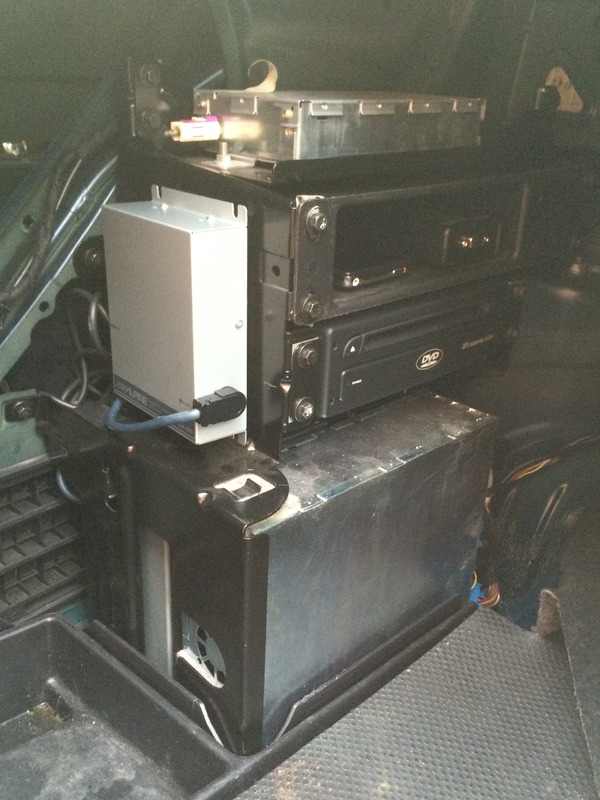

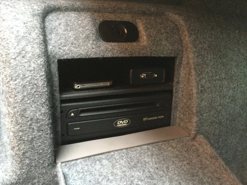

Last weekend i managed to fit my Intravee setup. As i wanted as OEM a look as possible, i ended up buying the storage tray used if the car doesnt come with a CD Changer - the Intravee/iPod then sits in the tray with easy access via the usual opening flap, as below:
The Alpine interface is fairly big so sits on the outside of the accessories cage as follows:
Everything is held on with velcro strips, so no rattles/iPods flying around the boot!
The Intravee interface seems to work pretty well and has given me a number of other useful options such as folding mirrors, sticky indicators & lights on lock/unlock which i had been missing from the M135i. For the £200 or so that it cost, i think its a worthwhile upgrade.

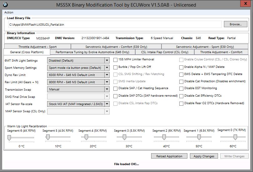

Not sure actually, think its the original version, certainly doesnt have the rev match of the CSL though!! Hopefully over the weekend i will use the Binary Modification Tool (http://forums.m3cutters.co.uk/showthread.php?t=126760) to enable the CSL SMG Shift / Rev matching + Inertia fix on the engine ECU, then at some point (probably after Christmas) ill send off my SMG ECU to get the most up to date CSL software put on it. Not a massive cost (£20 for binary tool/£40 for SMG ECU) and apparently work very well together.
As an aside, the CSL theme will likely continue into 2016, with plans for a GSR carbon airbox in Jan/Feb and full CSL conversion (uses MAP sensor) to run it all - this is now offered by one of the members on M3Cutters, so no need to pay a fortune for Evolve's Alpha N setup. I also fancy taking it on track, so will probably upgrade to a K-Sport 8 pot front BBK & some BC Racing (or similar) coilovers for a little bit more adjustability.

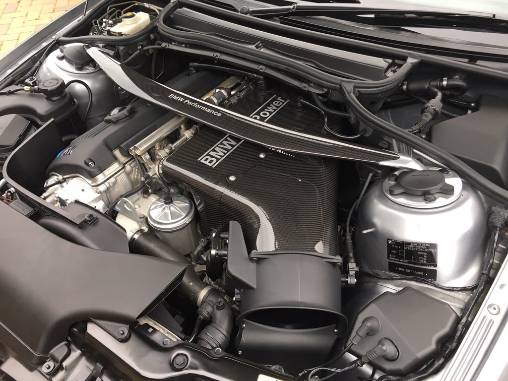

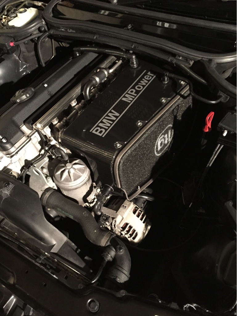

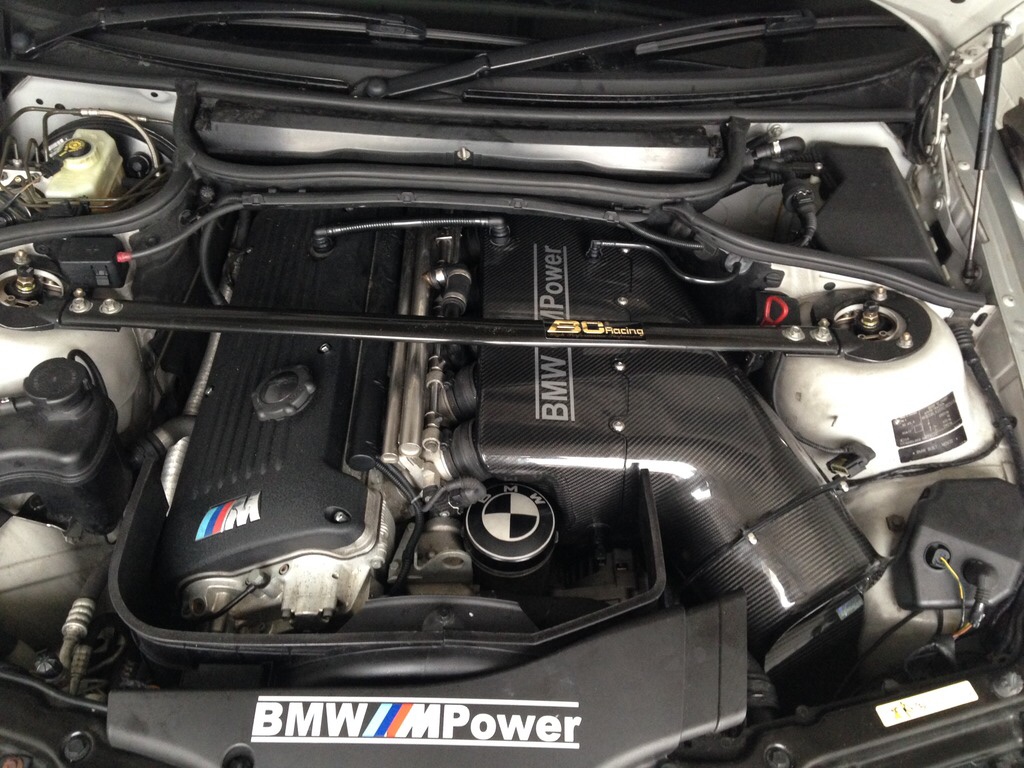

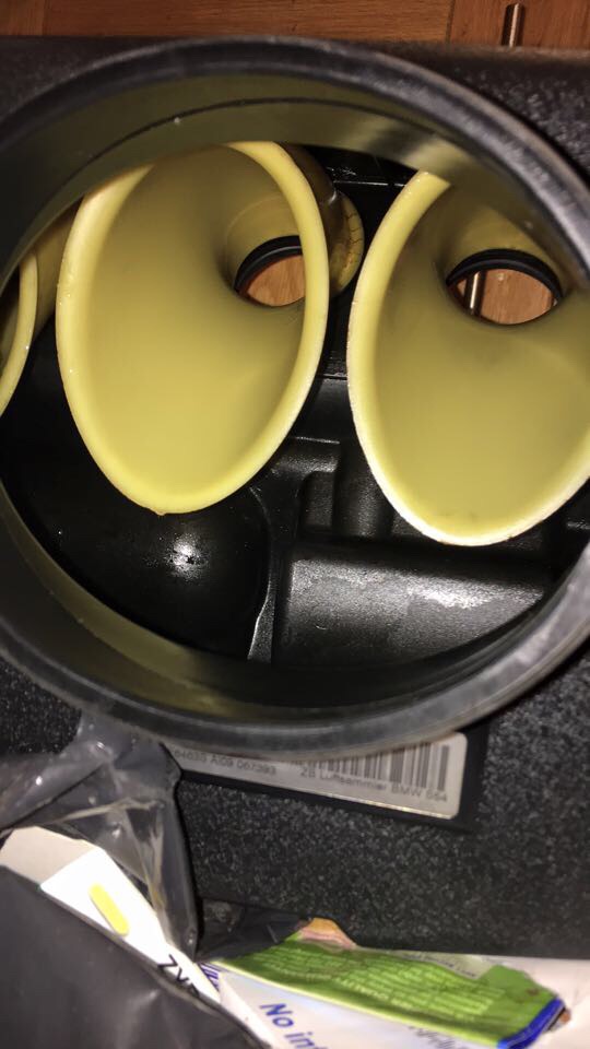

Have you guys seen the inside of the stock intake?
Carbon intake is on a whole new level though!
