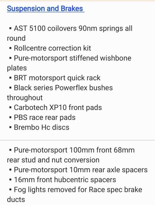

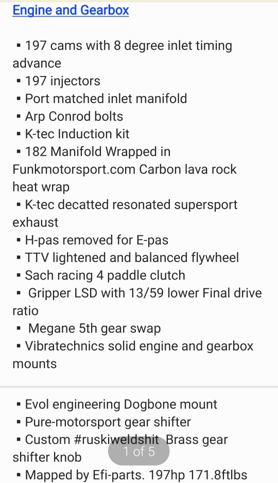

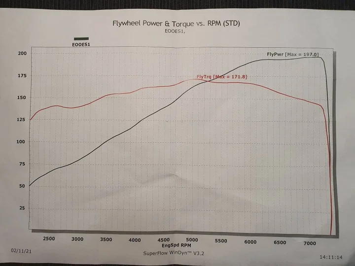

I finally finished what i had planned in my head. The idea i had was to gain as much power as i could using all regular off the shelf/easily acquired parts. So here is the final parts list and final results.
• 182 manifold
• 197 cams with 8 degrees timing advance on inlet cam
• 197 injectors
• port matched inlets
• TTV lightened flywheel
• EPAS
• K-Tec de-cat and Resonated Supersports exhaust
• K-tec induction kit
• ARP conrod bolts

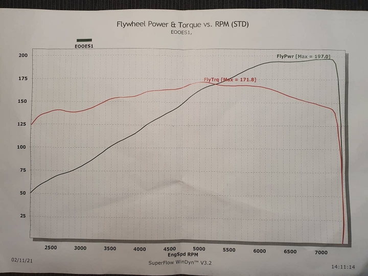

Mapped by Chris at EFi parts. 197hp 171.8ftlbs. Well happy [emoji4]

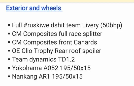

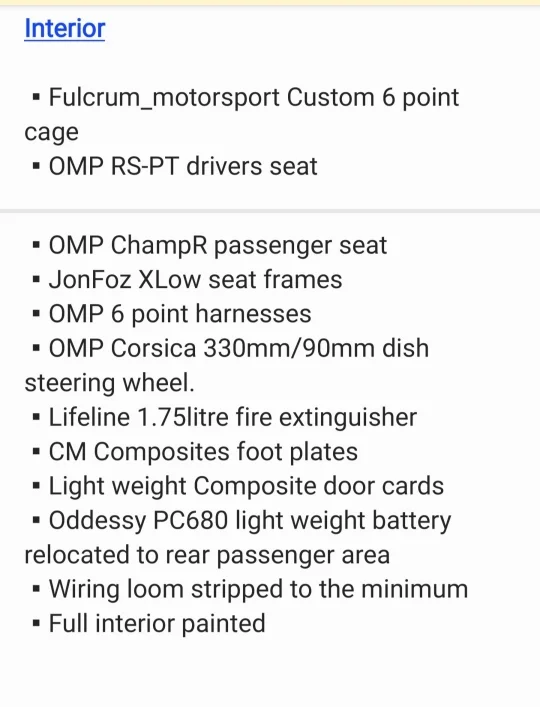

Thought I'd post my full spec as its about as far as i want to take it. Maybe next year i may start doing some weight loss and change all the panels for plastic... but for definitely the remainder of this year I'm just going to get as much use as i can.
