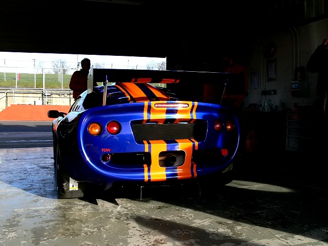

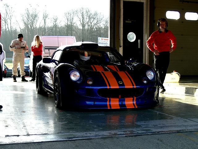

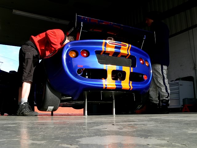

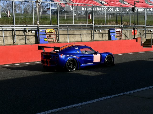

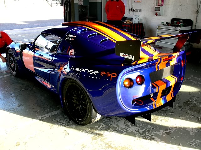

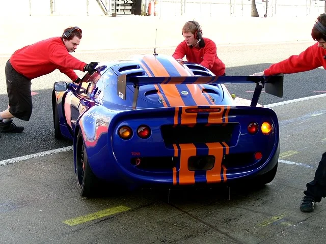

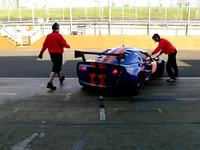

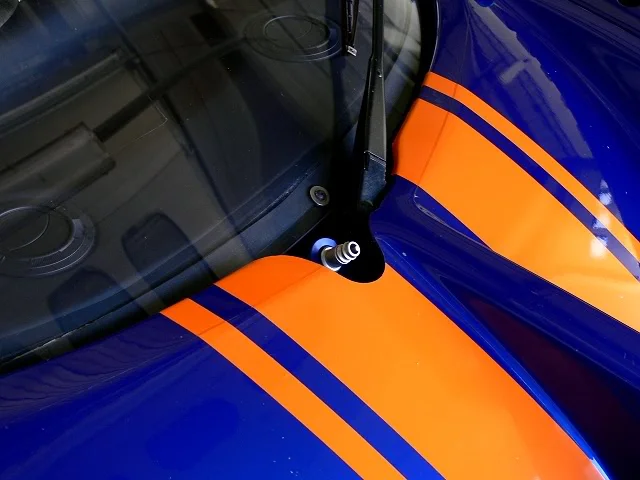

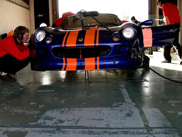

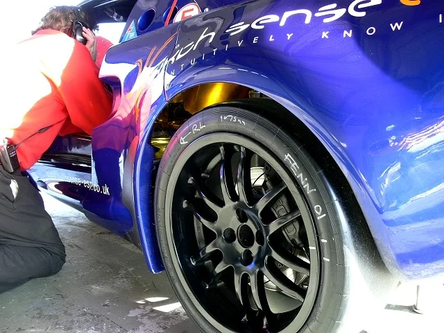

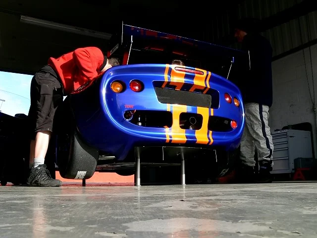

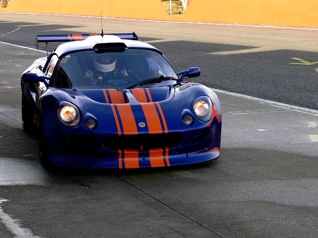

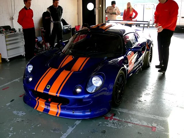

Back early from our first test of the season due to a crank seal going... bloody Lotus! Car is now at 250bhp with lower revs and 697kg despite gaining air jacks and a few other gizmos... pushed Rob Collard's BTCC car along!

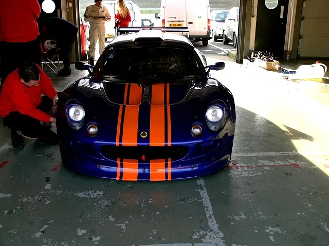

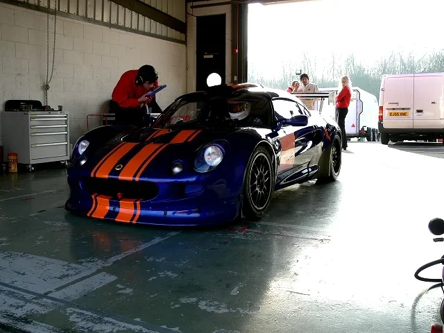

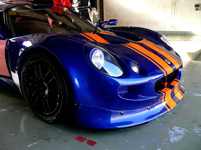

The car also has new uprights developed in-house, lowering the car by an inch. This means we have reverted to a modified road splitter as the motorsport item was too low. The good news was despite only having half an hour in the car, we were already a second quicker than last season so looking forward to the weekend where we have another day booked!

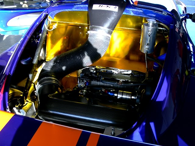

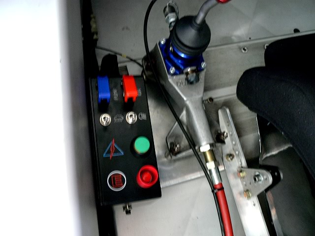

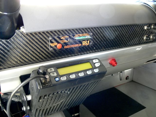

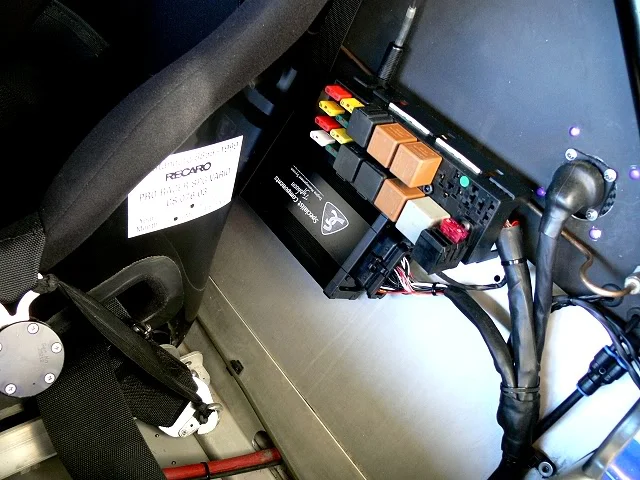

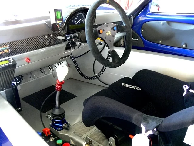

Some piccies... note neater loom (emptier engine bay), ECU inside, major controls moved.
Looking good mate, great result with the power. Loving the gold plated firewall and centre seat.

Still has the motorsport splitter fitted in those pics?
My bad, must have chopped the MSport splitter!

how do you get in it? a normal elise is bad enough with the seat right there when you fall in!

Liking the central driving position. Is it running a standard shift or is it a sequential box?
Thanks guys... its nice to be driving it again but despite all the work we've done to try and make it reliable i can't see the engine and/or gearbox holding for some of the longer races in Britcar this season!
It is a Quaife sequential, well known for being a bit pants when it comes to reliability. Had endless issues with it...

Just spotted you've got a DL1 - whilst they're very much a club level logger and very limited in what they and the software can do it's still enough for you to get a few inputs into for temp logging etc. They logging rate (only 100hz) isn't really high enough for some engine and gearbox measurements but it'll be fine for temps.
For the sake of 250 quid of sensors definately look into it - it will at least give you an idea of where some reliability issues are coming from ;-)
Would be well worth seeing if you could get an old Delta Pro from somewhere - that'll give you 500hz logging and allow you to use Pi Toolbox for analysis..... which is the same kit as the Brawn GP boys are using!
