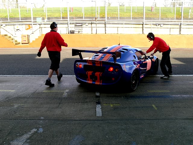

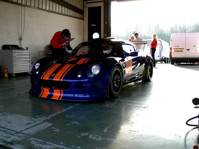

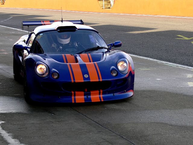

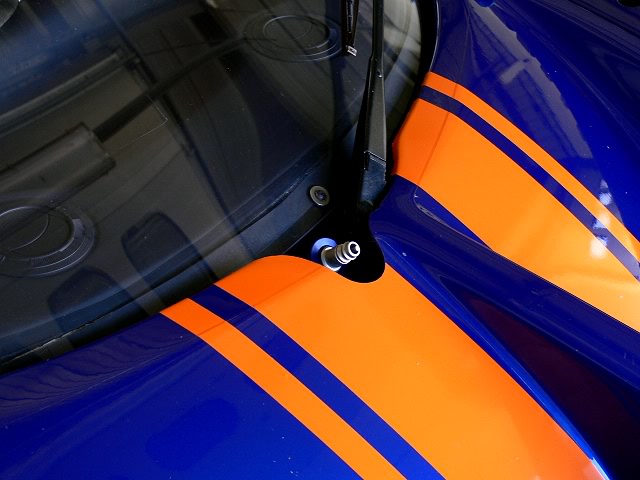

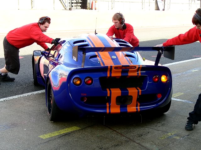

Back early from our first test of the season due to a crank seal going... bloody Lotus! Car is now at 250bhp with lower revs and 697kg despite gaining air jacks and a few other gizmos... pushed Rob Collard's BTCC car along!

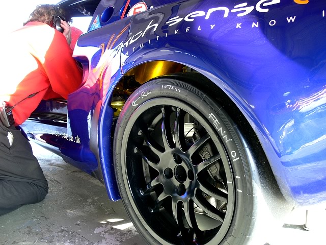

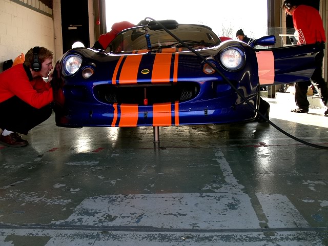

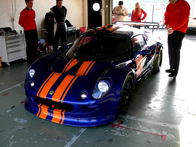

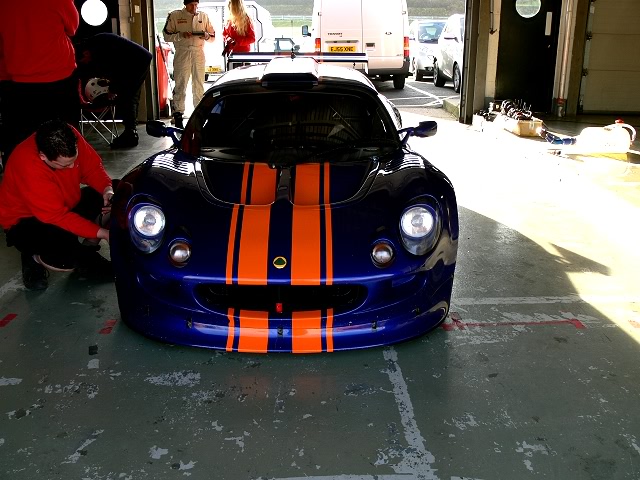

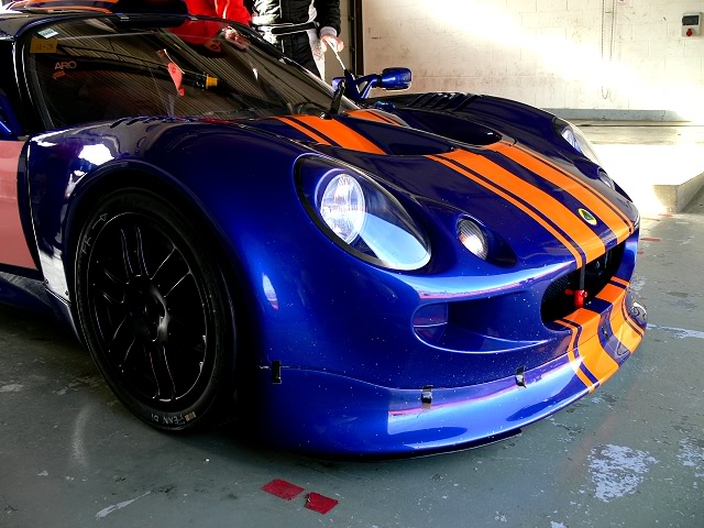

The car also has new uprights developed in-house, lowering the car by an inch. This means we have reverted to a modified road splitter as the motorsport item was too low. The good news was despite only having half an hour in the car, we were already a second quicker than last season so looking forward to the weekend where we have another day booked!

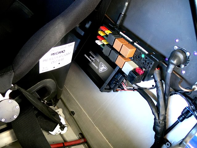

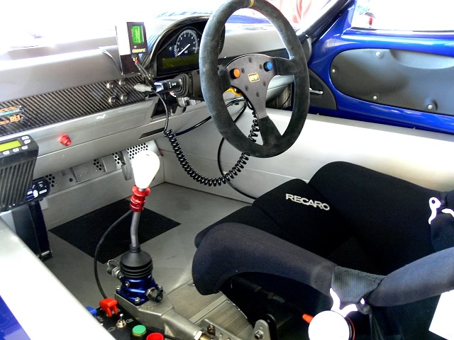

Some piccies... note neater loom (emptier engine bay), ECU inside, major controls moved.

Looking good mate, great result with the power. Loving the gold plated firewall and centre seat.

Still has the motorsport splitter fitted in those pics?
  Turbos.
My bad, must have chopped the MSport splitter!

how do you get in it? a normal elise is bad enough with the seat right there when you fall in!
  Turbos.
I crawl out on all fours! Getting in is ok, being so narrow its not much different from a normal Elise.

Liking the central driving position. Is it running a standard shift or is it a sequential box?
  Turbos.
Thanks guys... its nice to be driving it again but despite all the work we've done to try and make it reliable i can't see the engine and/or gearbox holding for some of the longer races in Britcar this season!
It is a Quaife sequential, well known for being a bit pants when it comes to reliability. Had endless issues with it...
