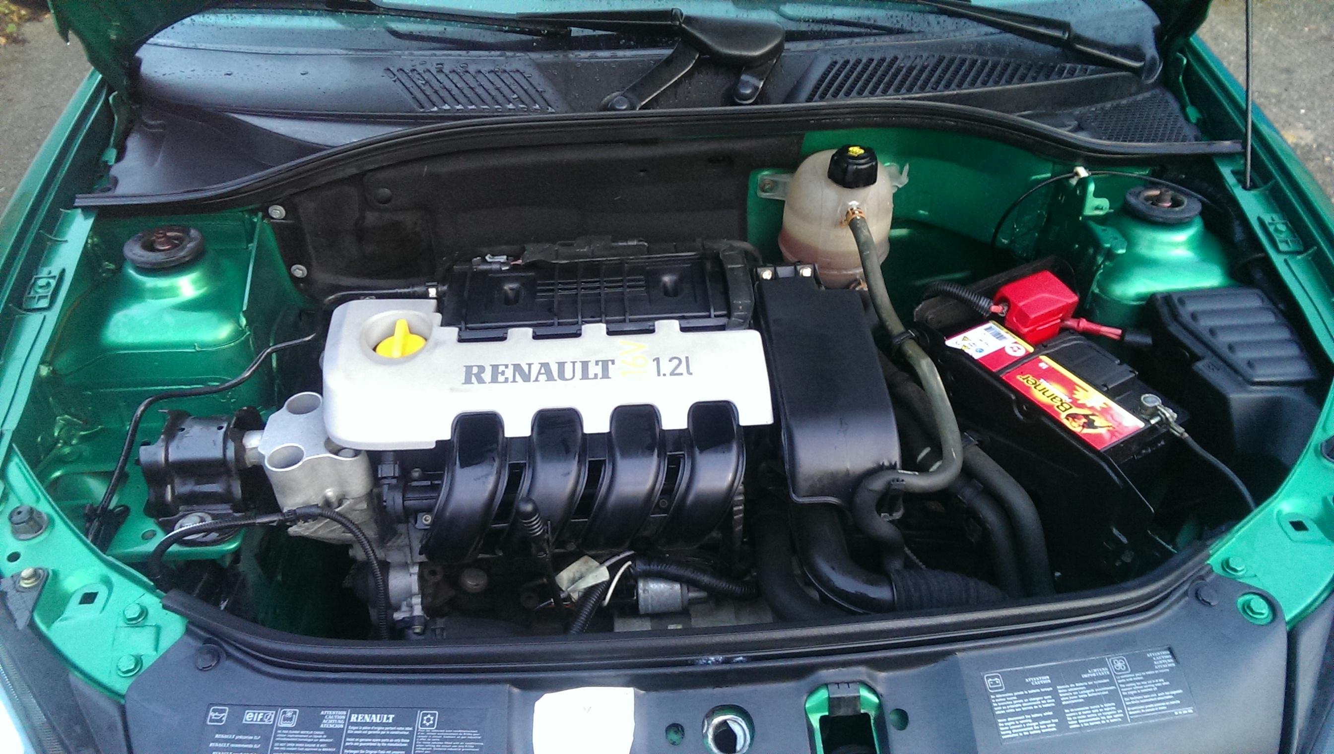

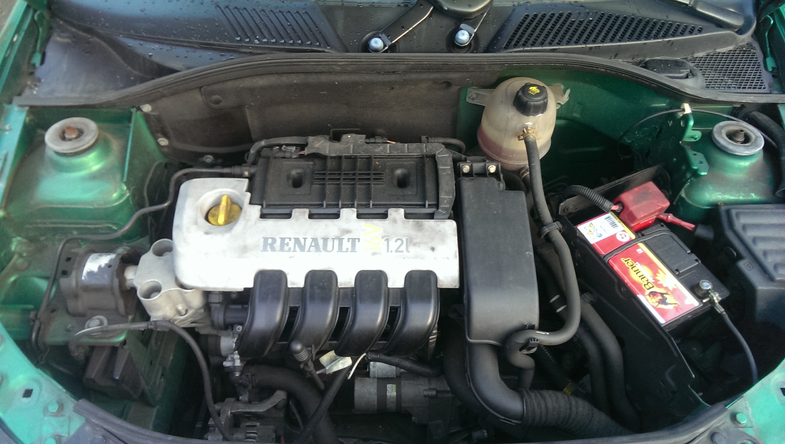

As requested.... before & after! Quickly managed to get the majority of it done, by no means completely done....never will be! But good enough for the quick half hour of light left.
  Renault Clio MK2 1.2
Thats a very very good job you have done there mate :smile:
Cheers buddy! Hosed it down quickly on mist setting, then diluted APC to about 1:1.5 so pretty strong, but still didn't foam up as much as I'd've liked but got in there with a brush and a few rags to all the bits I could reach. Hosed it down quickly on the fan setting then started her up and dried the majority of it off with a rag (or 3) then took her for a quick spin up the road to try and shift the rest of the water that I couldn't reach. Was easy enough! Now the task of getting the grease and muck from my entire forearms....
Looks great! Job well done! Dressing it all would make it even better :smile:
