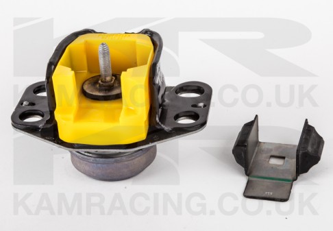

Engine mount, cambelt side. Changed, but feels worse than the old mount.
  Ph2 172, 106 Rallye
I've always had a good bit of engine slap, I fired a powerflex dogbone mount on and it didn't change much so I bought the engine mount insert.
When I went to fit the insert into the cambelt side engine mount I noticed the bolt that runs down the middle had snapped. I thought this would be the cause of the engine slap and, happy days, easy fix.
Bought a new mount, fired it into the car (along with the powerflex insert and the new rubber bumper) and went for a drive. If anything it's got worse.
I noticed when I was replacing the mount that the 4 mounting holes allow for some adjustment, Do you reckon if I adjusted the position it would have much of an effect?

I take it you've fitted the insert properly.
I've seen it where people have fitted them and not put that metal bracket with the black rubber tabs back in ?
This thing on the right
Yeah, I've had loads of 106's and they have the same sort of rubber bumper thing.

I've got so fed up with the vibration that I have just replaced the Vibra technics engine mount with OEM. I see they have modified them slightly in that the front and rear rubber bumpers (the ones on the metal bracket in the photo 8 posts above) are now touching the outer black metal surround whereas before there was a gap. No more vibration, and I can't say the gearchange is any worse, even under hard acceleration.
