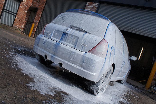

I quickly cleaned over the wheels with Autobrite's Very Cherry then snow foamed the car with the new formula Concours Car Care Tutti Frutii:
DSC05206 by RussZS, on Flickr

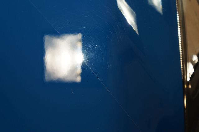

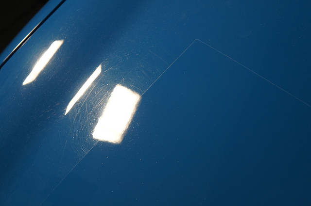

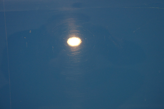

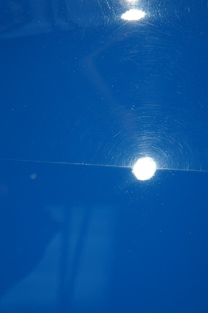

After trialling various combinations, we agreed that the bonnet and roof which were most severely defected would be cut with Scholl S3 and Spider Sandwich Pad via Rotary, and due to time constraints the rest of the car was corrected with D300 and MF Discs via DA. This was all finished down with Autobrite's very impressive new 'Anti Hologram' Finishing Polish, then a final Eraser wipedown to ensure that there was no filling from polishing oils. I have found the Scholl to fill a fair bit at times on some paints...
Some of the correction shots:
DSC05212 by RussZS, on Flickr
DSC05216 by RussZS, on Flickr

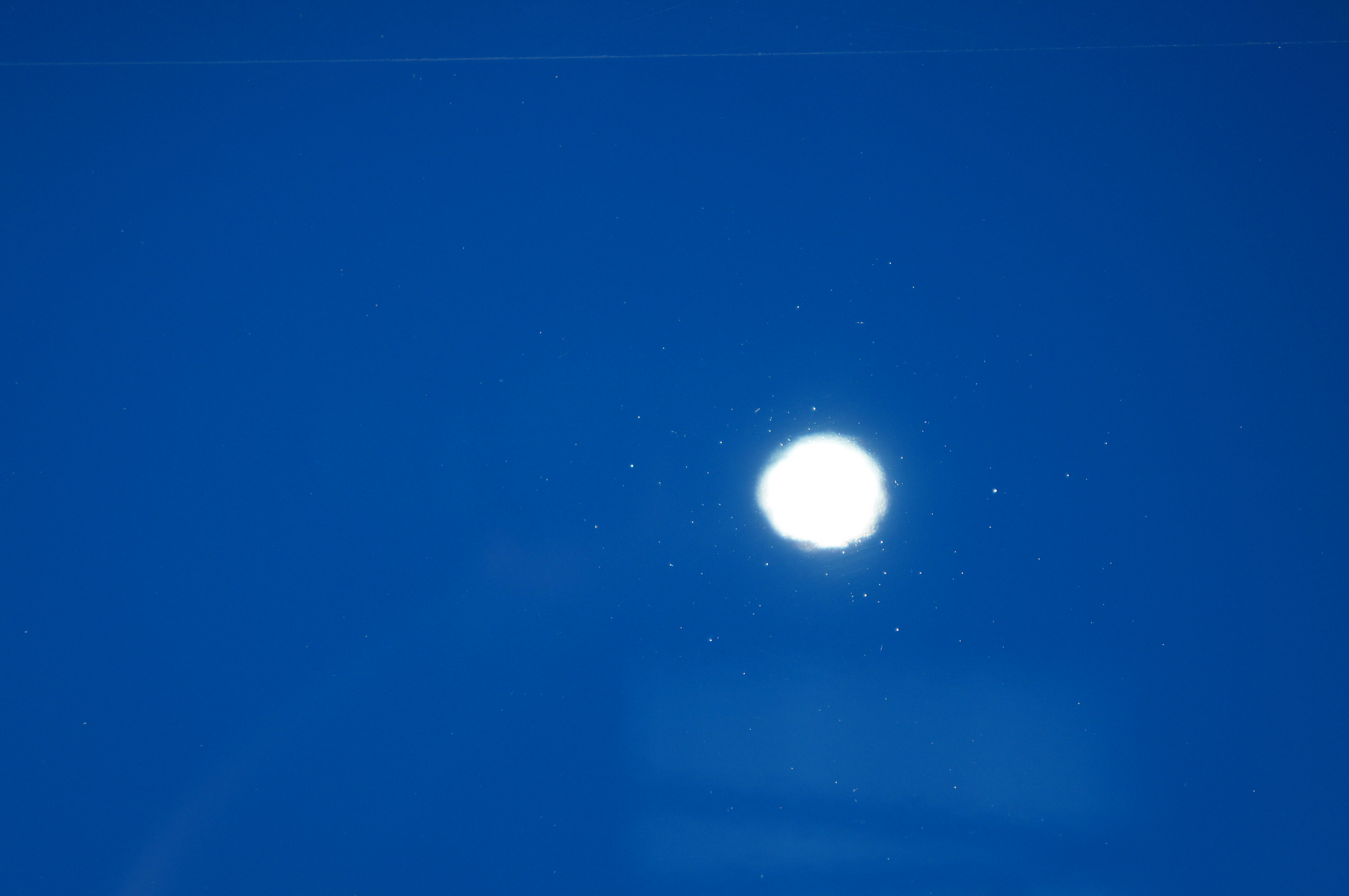

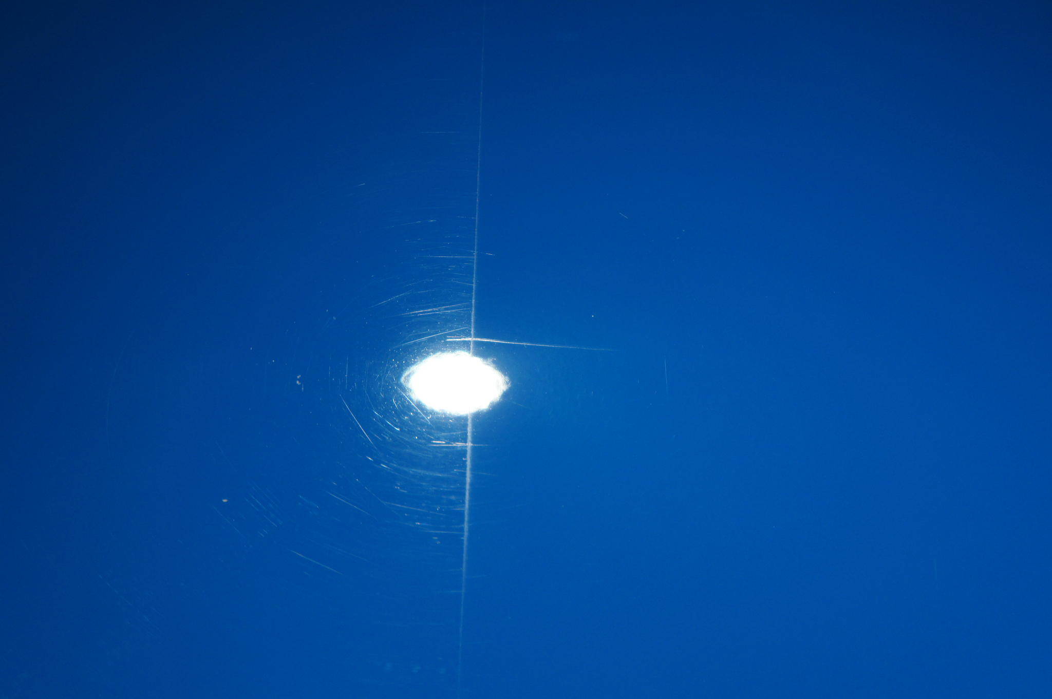

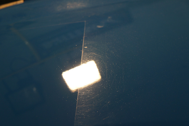

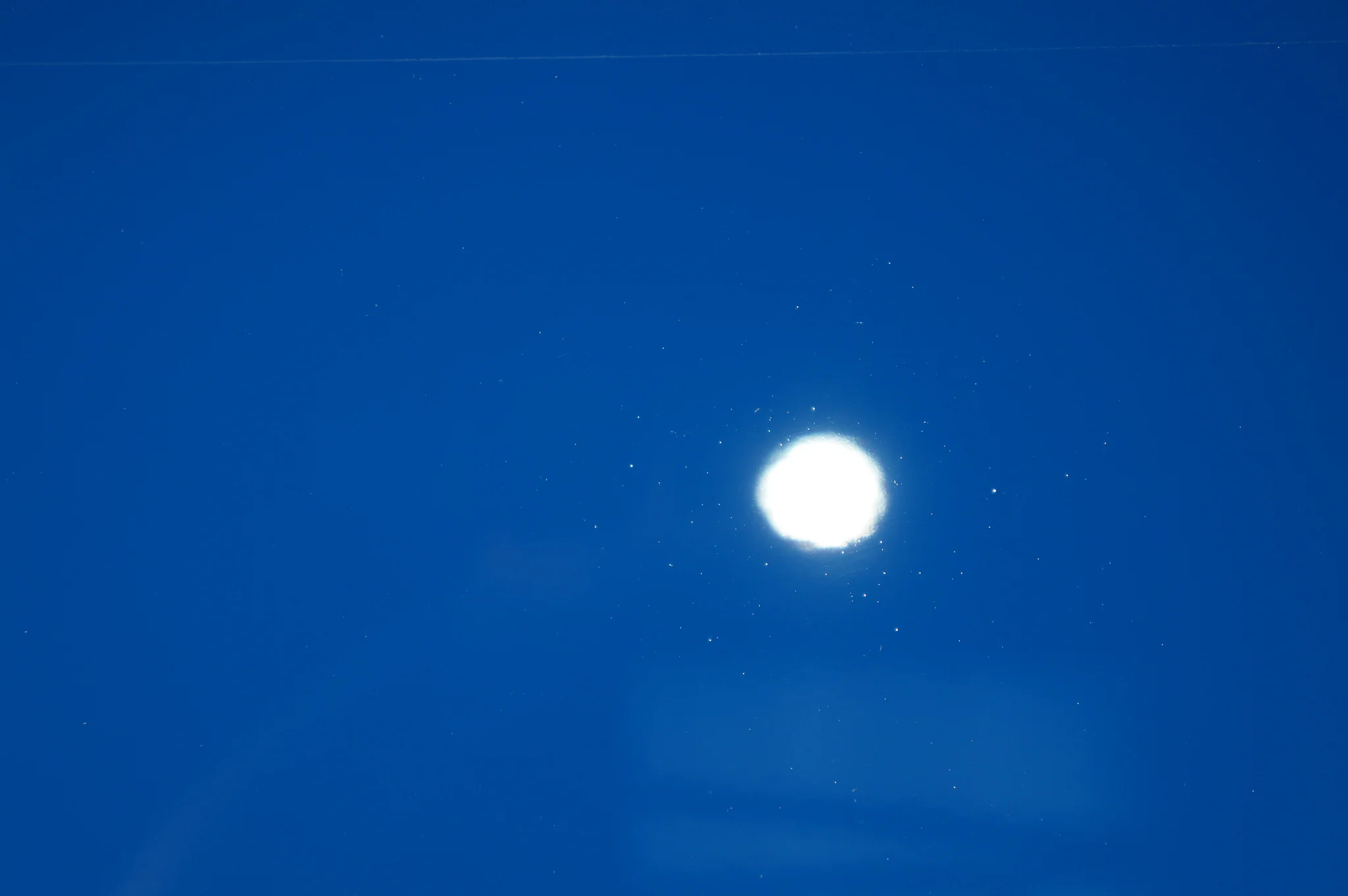

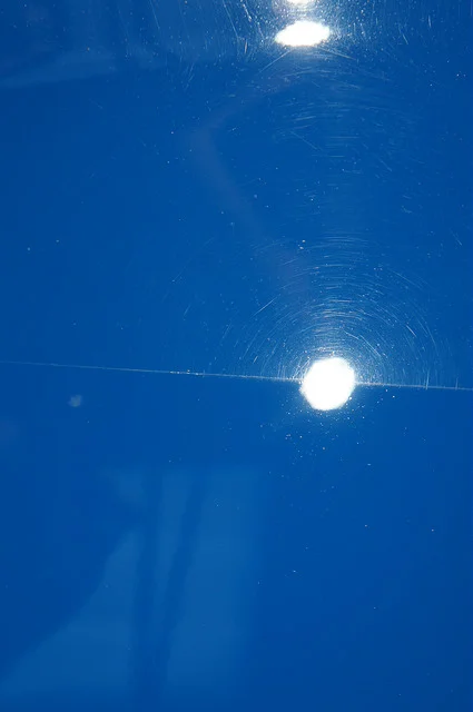

The bonnet was suffering from a fair amount of some form of 'pitting' which is visible in the pics.

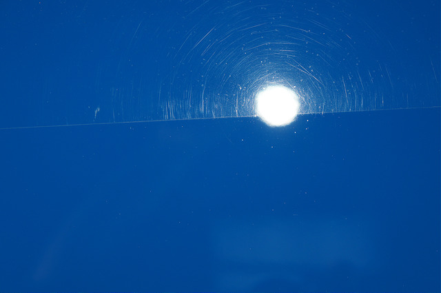

Under Halide:
DSC05219 by RussZS, on Flickr
DSC05222 by RussZS, on Flickr
DSC05227 by RussZS, on Flickr
DSC05229 by RussZS, on Flickr
Some deeper defects remained which were not to be dealt with on this occasion - this was an Enhancement, not full correction:

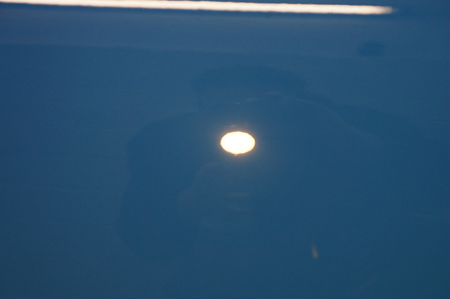

I always find that the MF system whilst technically able of finishing down well in terms of not inflicting hologramming (with the right technique) sometimes the clarity of the paint is somewhat questionable, so I always follow this up with a Rotary and finishing polish pad, which pays dividends to overall clarity and levels of gloss.

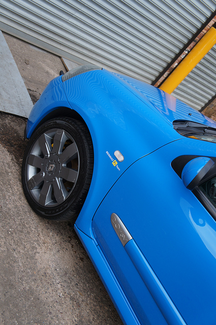

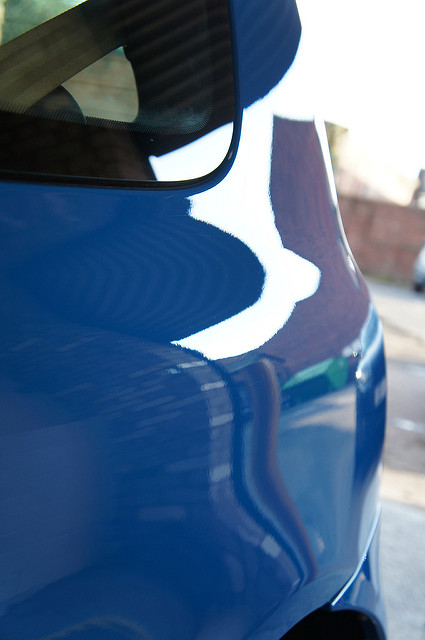

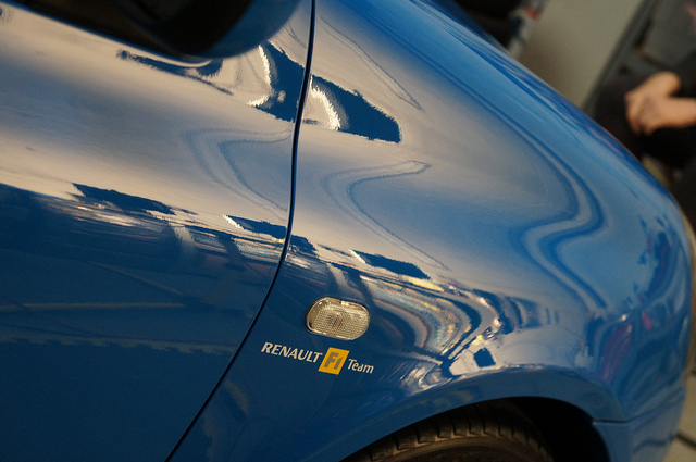

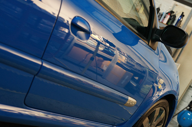

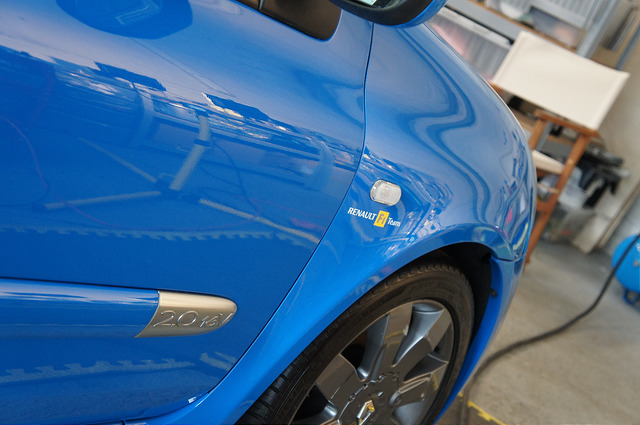

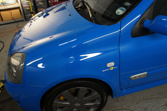

The amazing colour was really beginning to show after the defects had been removed:
DSC05251 by RussZS, on Flickr
DSC05253 by RussZS, on Flickr

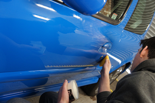

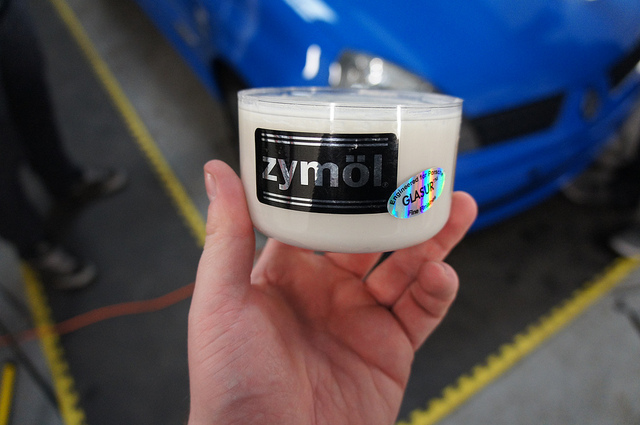

We finished with Zymol Glasur which the owner is looking to purchase at some point, so I showed the owner how best to apply and remove it and assisted him doing so:

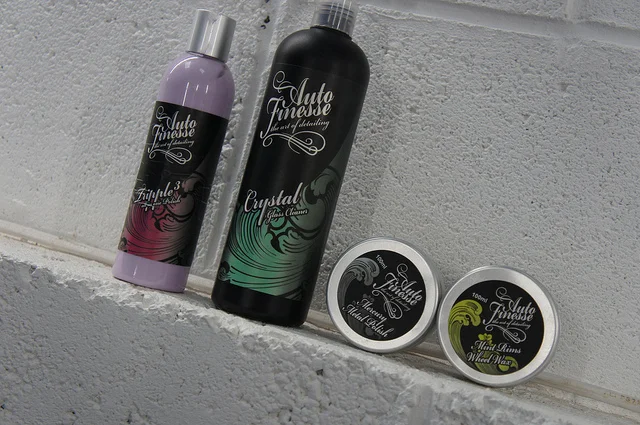

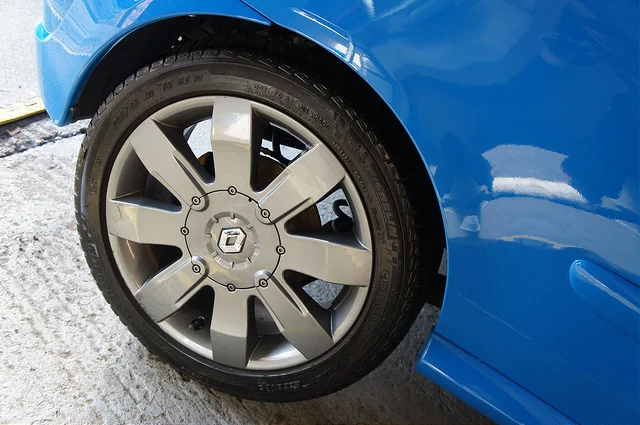

I finished up with:
- Tripple on the more intricate areas which couldn't be machine polished
- Crystal on Glass
- Mercury on Exhausts

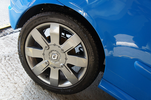

- Mint Rims on Alloys
- CarPro PERL on tyres

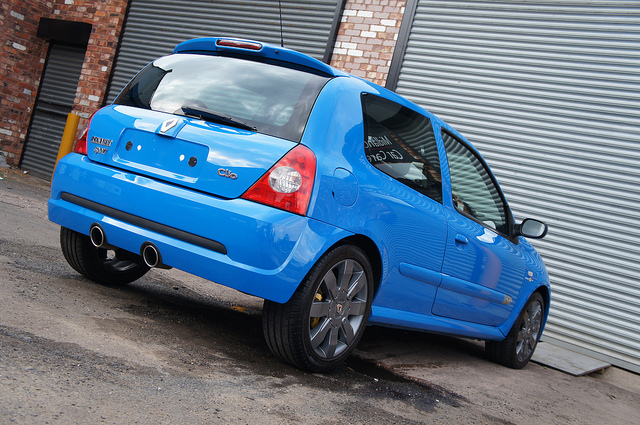

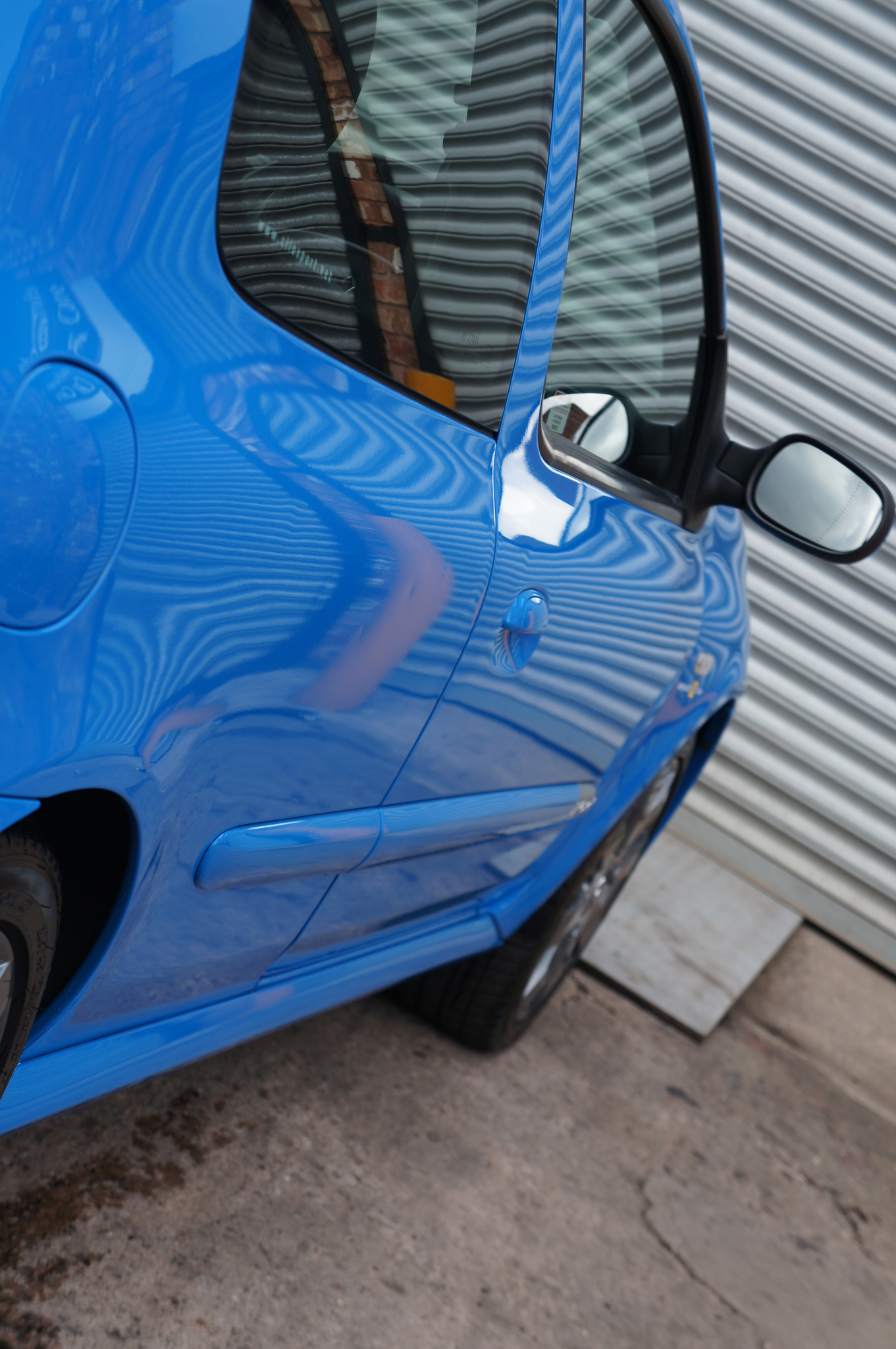

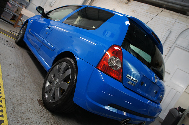

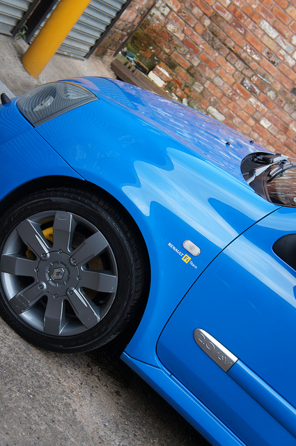

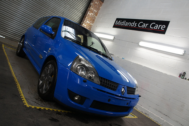

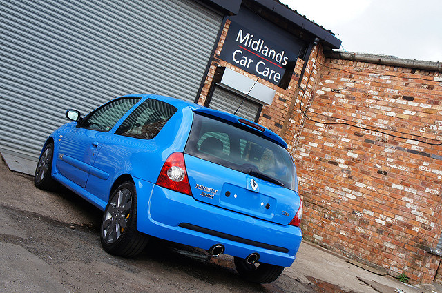

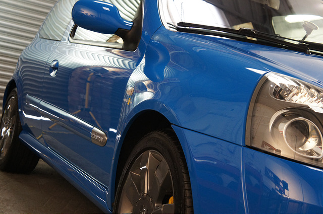

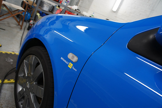

and finally, quite a few finished pics, for the owners benefit... (please excuse the volume)

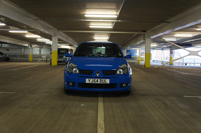

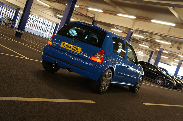

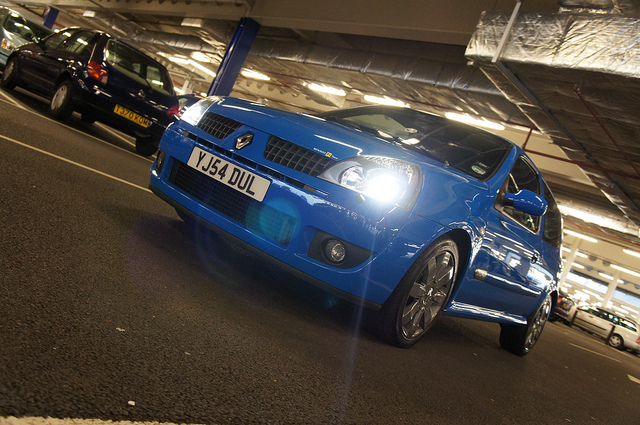

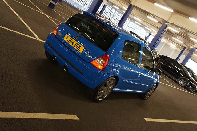

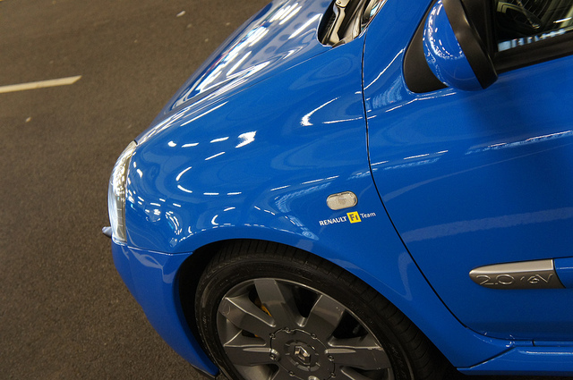

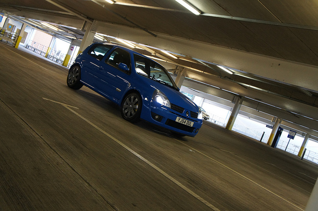

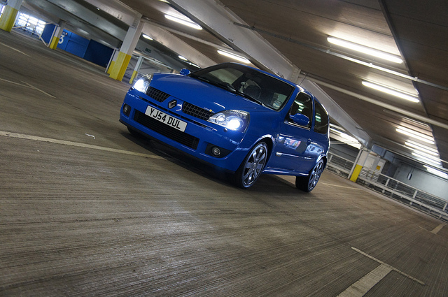

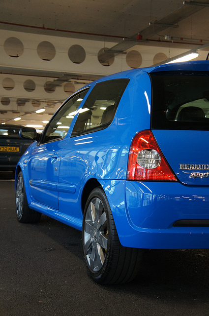

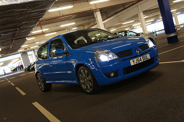

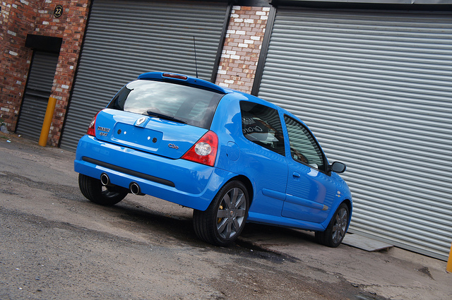

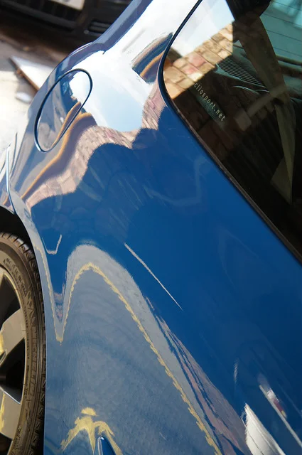

The ever popular Tesco pics...

Great work. May I ask what pitting is? Is it like orange peel?

Wow that looks stunning. Mega glossy in those car park shots.

I don't know the ins and outs of what it is, but it looks like thousands of tiny little dots, all over the car. We guessed it might be damage left over from the volcanic ash from the other year, not much else we could think of that it might be.
I'm sure Russ will be able to explain in more detail what pitting technically is and how it caused.

Also with the "solvent pop" comments, according to Russ there is no chance that those area's have been resprayed.
Re: Enhancement Detail - RenaultSport Clio 182 in Racing Blue finished in Zymol Glasu
I saw the car today and it's superb work that's been done.
"no chance" is a strong phrase, but he was very adamant that the cars clearcoat was very very thin, a portion of the roof has been resprayed, but it would seem unlikely that the rest of the car has.
The sills measured circa 128-130 microns.
The resprayed roof section was around 220-240.
The rest of the car was 132-140.
Russ explained that it had been corrected once before in its life, hence the thin clearcoat. Surely due to the paint depth readings, there is no way it could have been resprayed? Unless when they did it, they stripped it all the way back to bare metal?!?!
