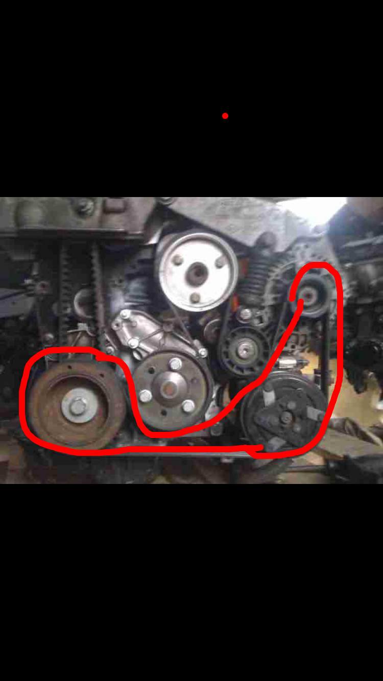

I'm planning on doing the conversion in the next couple of weeks and I want to keep a/c. So I intend to loop the PAS pump back to the reservoir; I know a guy on here has done it before.
why bother doing it if you are keeping the pump?
  FF LY 182
I've replaced the PAS pump twice now; but I want to retain A/C and I don't know another way of doing that other than keeping the PAS pump on as an idler.
The improved reliability and the adjustability of EPAS appeals to me.
  182 trackcar, XC60t6

The sole purpose of the conversion for me was that I wanted rid of the pump , so in my mind, when I would be out on track I wouldn't have to worry about the pump shitting itself and ruining my engine .
As said before - ditch it.
With regard to wanting to run epas and retain the air con , placing an idler where the pump would have been is the only other option to the stretch belt option .
website.
This was my aim too, and I much prefer the feeling of EPAS, my engine revs up a lot easier too now it's not running all the aux systems but I can understand where the guys coming from in wanting to keep a/c if possible.

Just bin the tensioner and use a stretch belt. The tensioners are an awful design, I've had one on a customers car that was pretty much ceased solid after about six months.
  Ph1 172 turbo
Ok I Will have a go of that then. Mite be a silly question, But is the stretch belt physically different or is it just the method in which it is fitted ?
And assume it's just a case of taking a measurement for the length of belt I require ensuring it's a good fit ?
Thanks for everyone's advice.

bin the pas pump, bin the tensioner and fit a stretch belt.
I'm going to try this.
Search for it on the pure Motorsport website.
I can see where you're coming from. The pure Motorsport idler ad states that it won't work with A/C, possibly because it requires a 4 rib belt. Anyway I'm going to try the stretched belt method now;
  dan's cast offs.
it's just a belt that stretches to fit. you can get special tool to fit them with but most of the time you can get them on with a screwdriver to guide it over one of the pulleys.
you can run theirs with ac but you have to flip the pulley round and fit it the other way and then split a 6pk belt down to a 4 rib and bob's your uncle.
