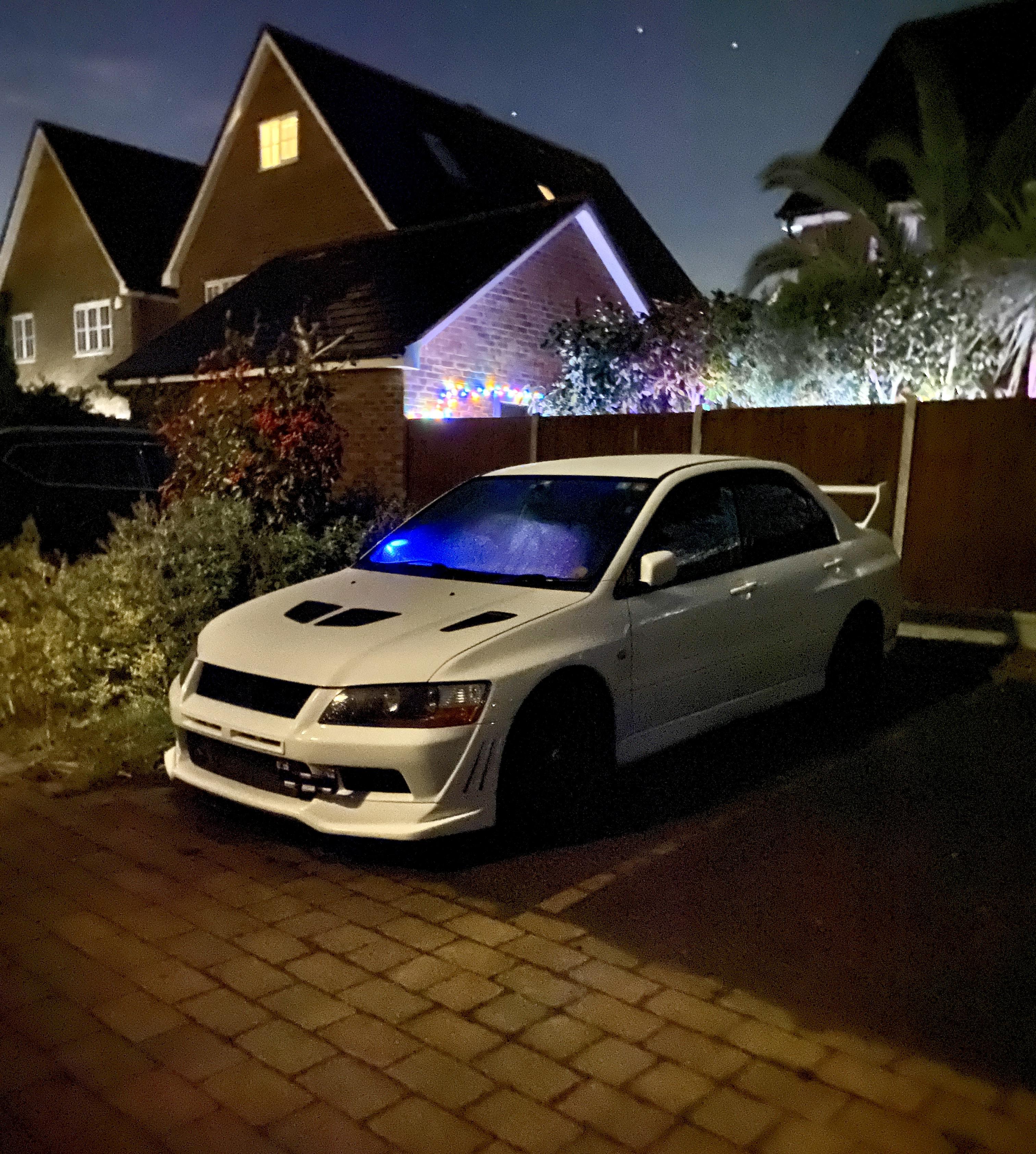

Nice find, didn't see this one for sale. Most of them that have come up recently have been dogs but this one looks tidy!
Good spec, too. Similar power to what I'll be running with the 71HTA give or take 20-30 ponies.
AdDaMan
Yeah the guy posted it up saying it was 'going to be for sale' so i jumped on it within minutes tbh. So so many dogs out there.

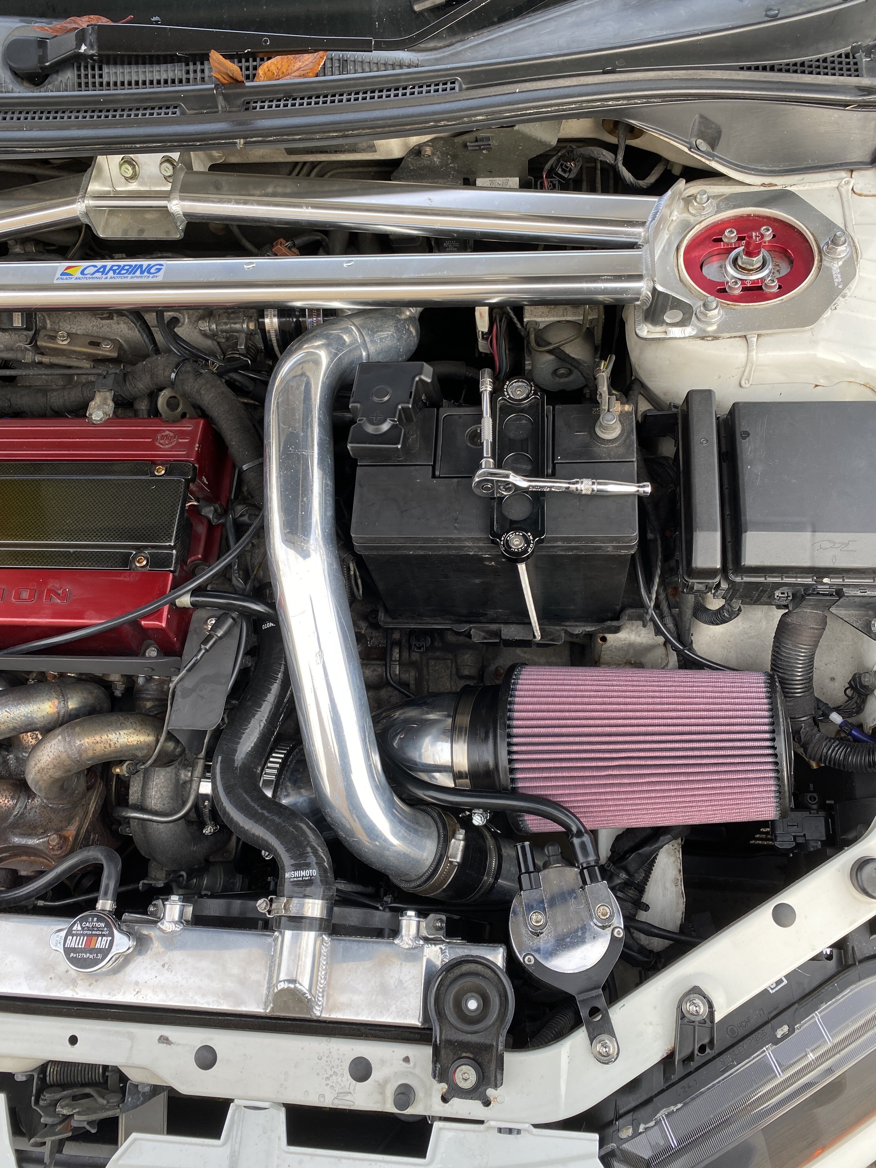

Fit new thermostat housing gasket and o ring due to a slight leak. New upper rad pipe too to get rid of chopped up one for temp sensor.
I am fitting a PLEX USDM and running all sensors direct to ECU and then reading from CAN straight to the PLEX so removing gauges etc.

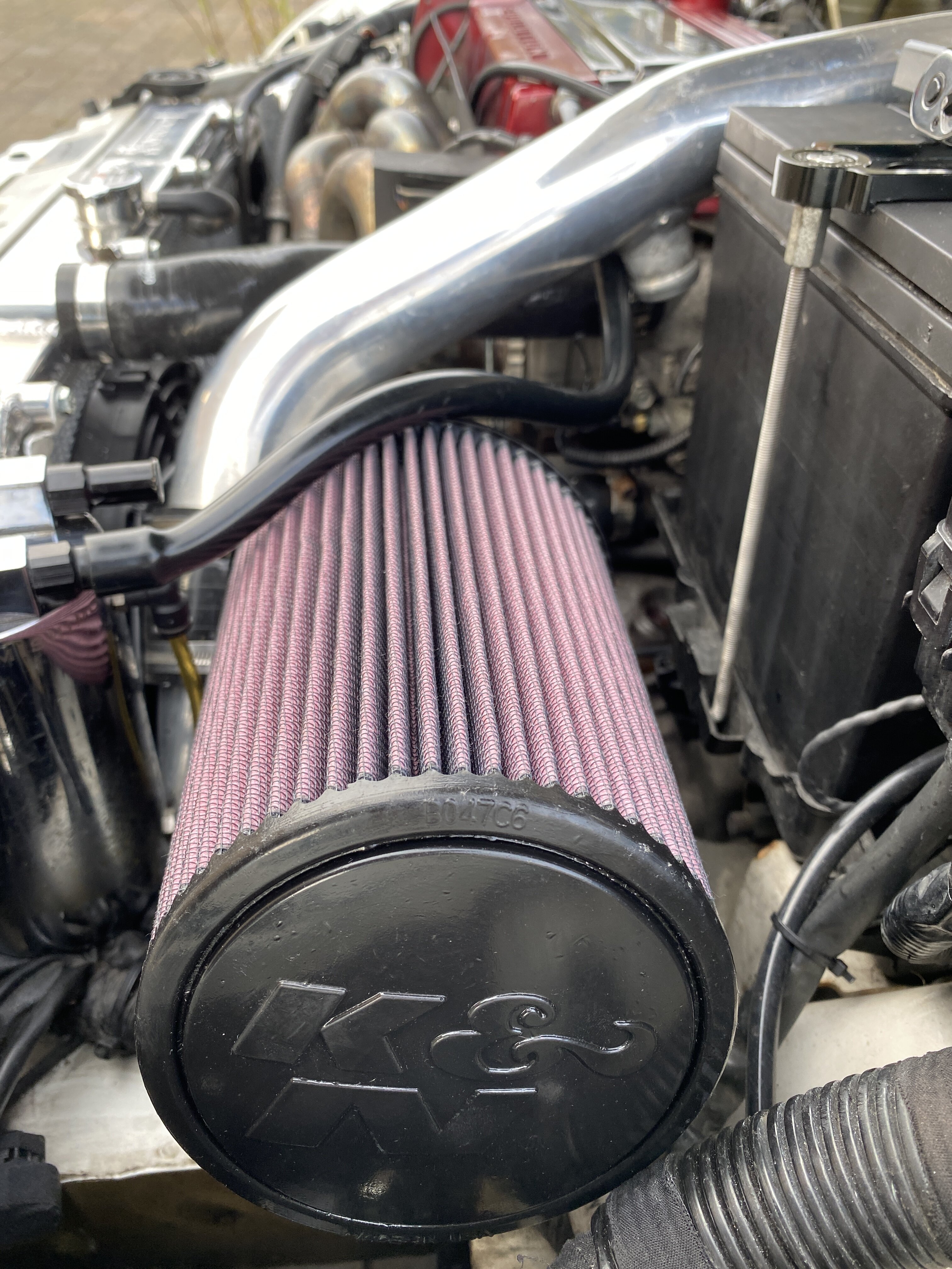

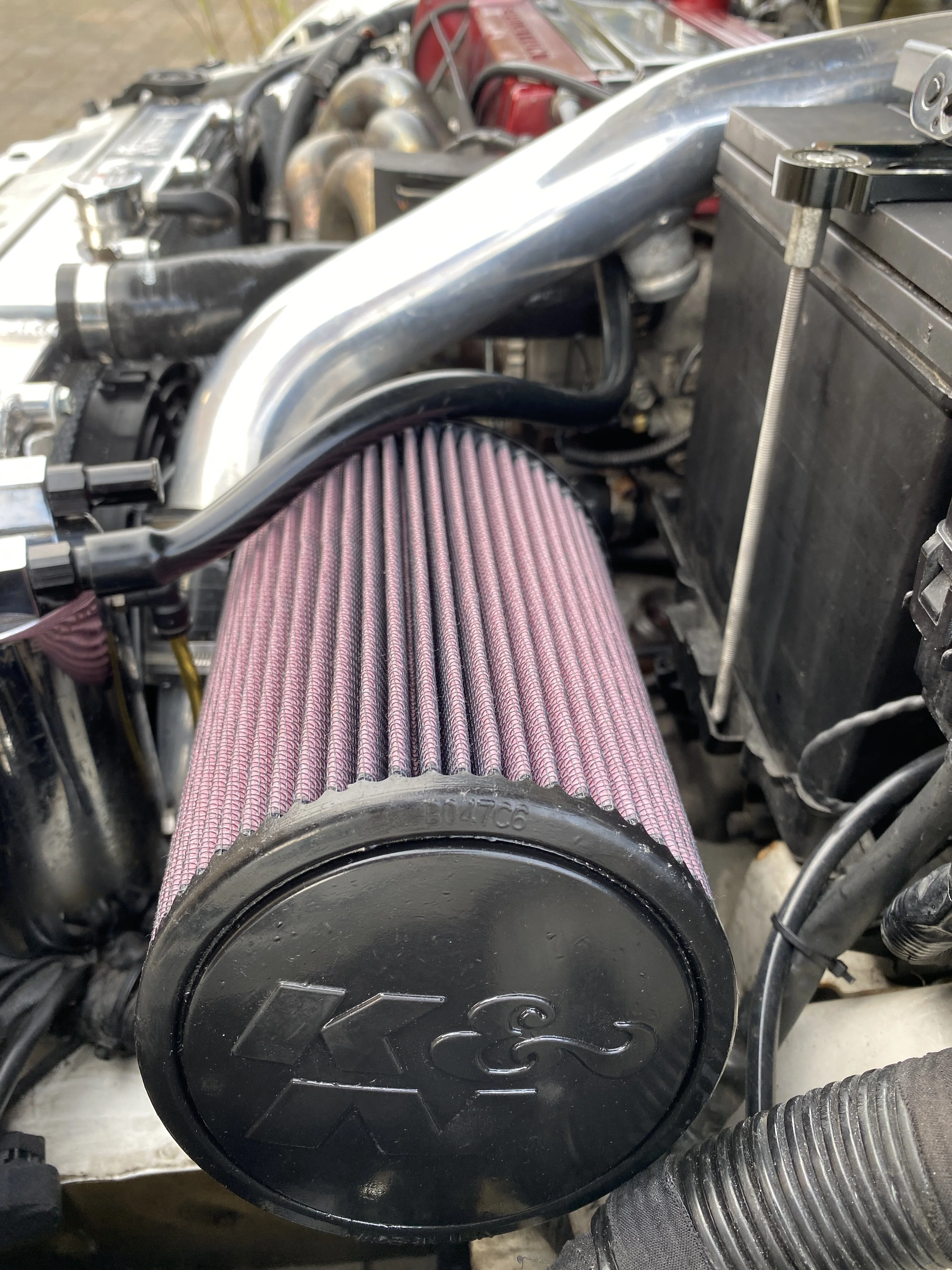

New big boy 4" intake kit too. And a Turbosmart BOV

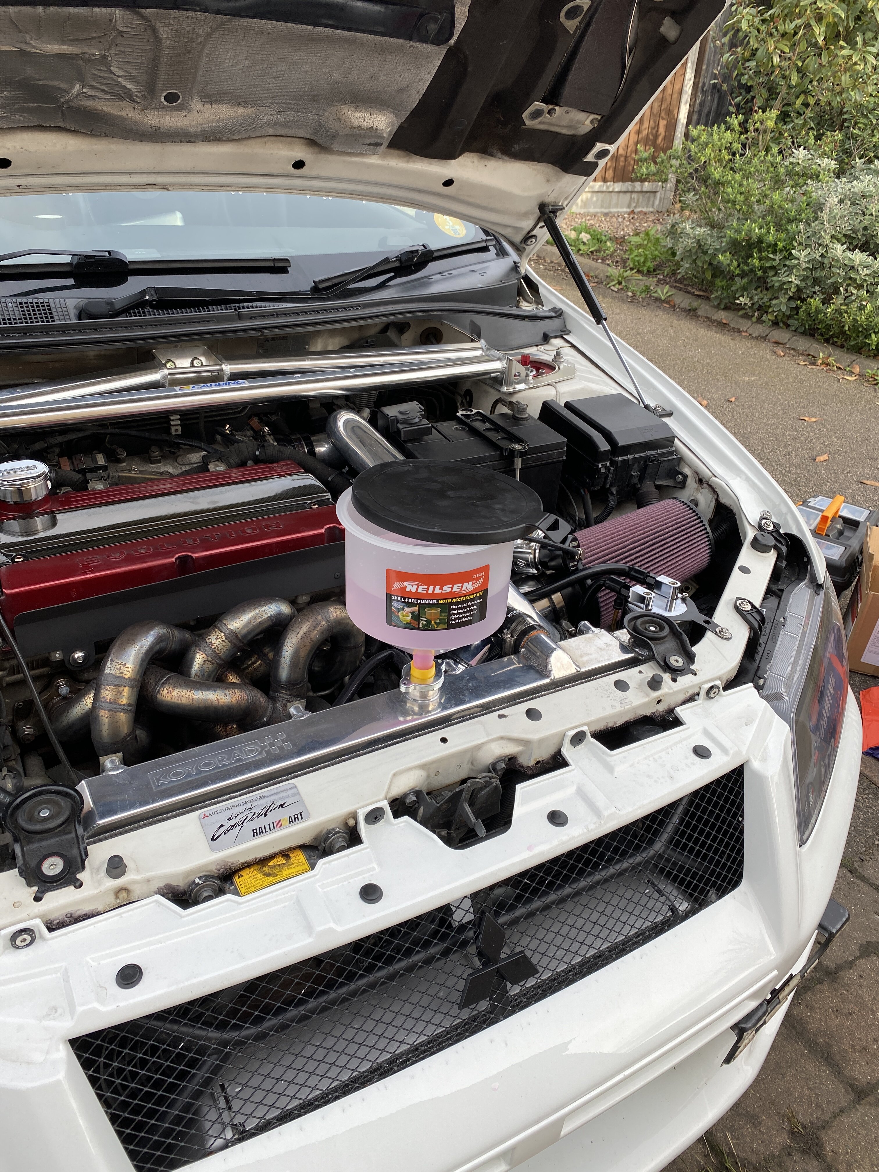

And this contraption is a life saver for bleeding rads. SO good!!

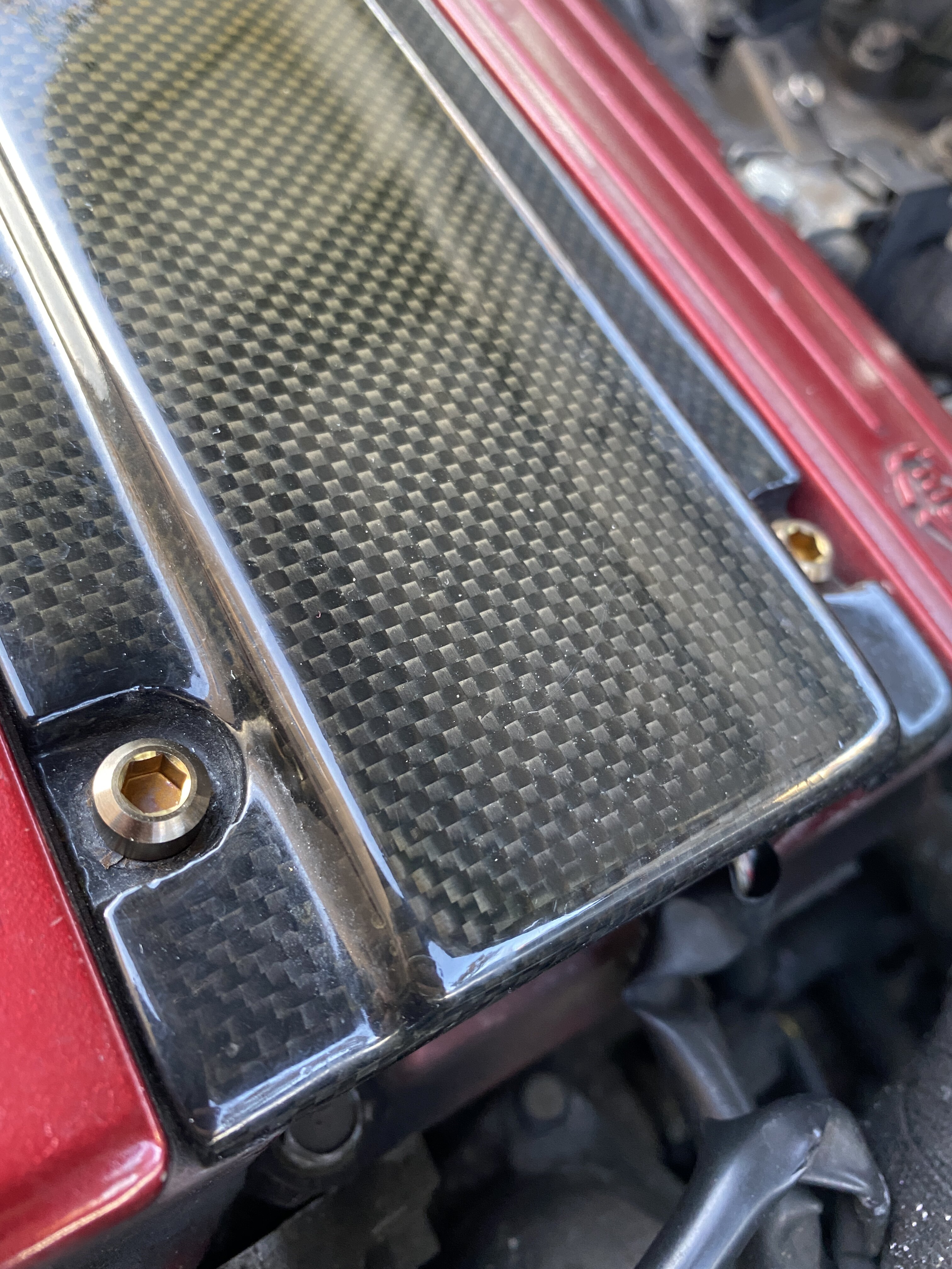

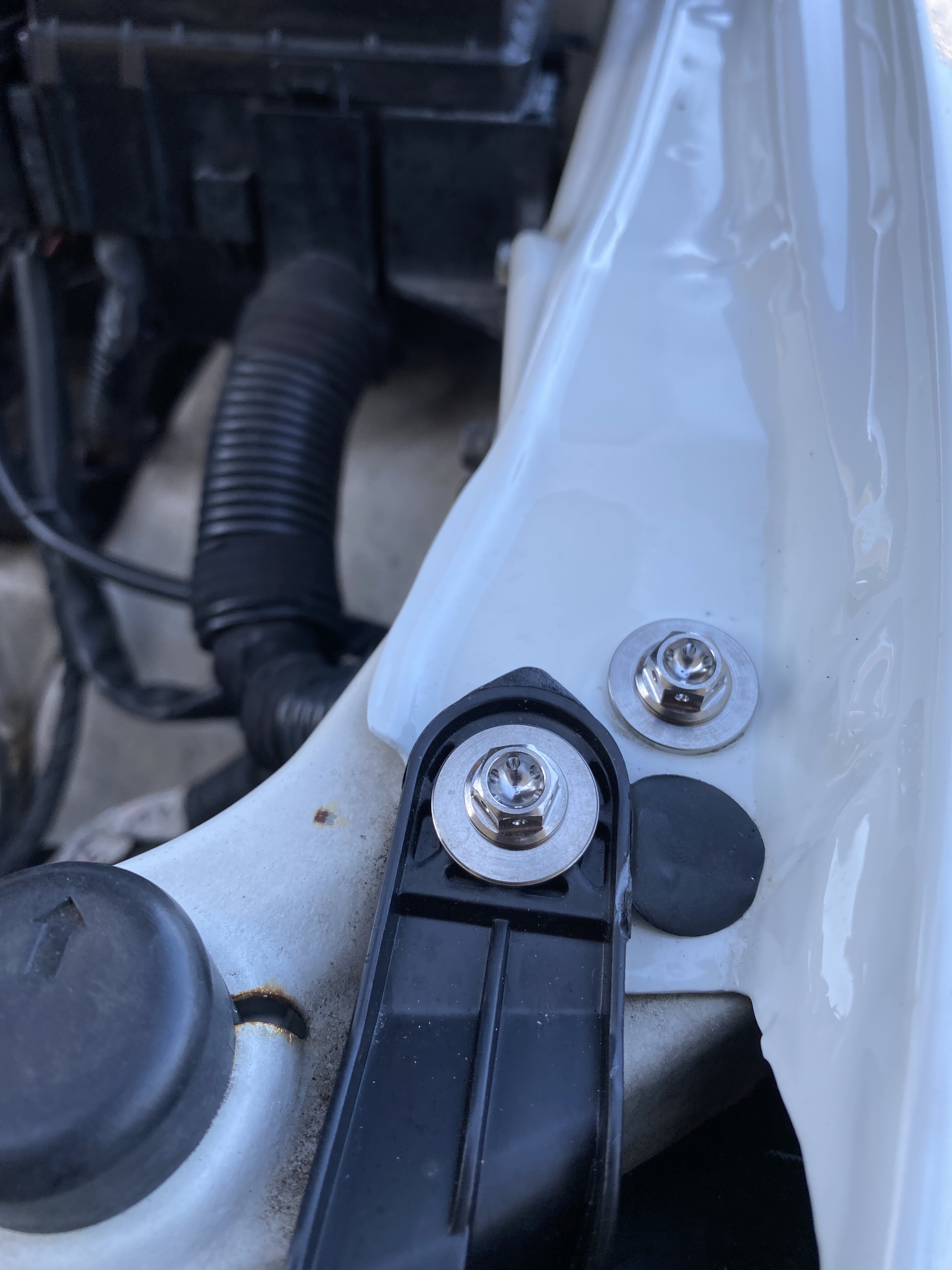

Oh and all the engine bay hardware which was shitty chinese jap rusty alan shitters, i have replaced with Titanium bolts and washers.

You have a link for that bleeding jug thing? Looks pretty cool.
Have you boost leak tested? To find the throttle body is leaking like a t**t?
ha, the throttle body gasket was replaced recently actually otherwise would have been top of my list. Going to boost leak test it as soon as its running. Was laggy as hell before so may be one, although i reckon it was the bov potentially.
This is the one i got. Highly recommended.

It's not the throttle body gasket, thats easy to change.
It's the two seals on either side of the throttle plate shaft, absolute w*****s when the throttle plate screws won't behave.
